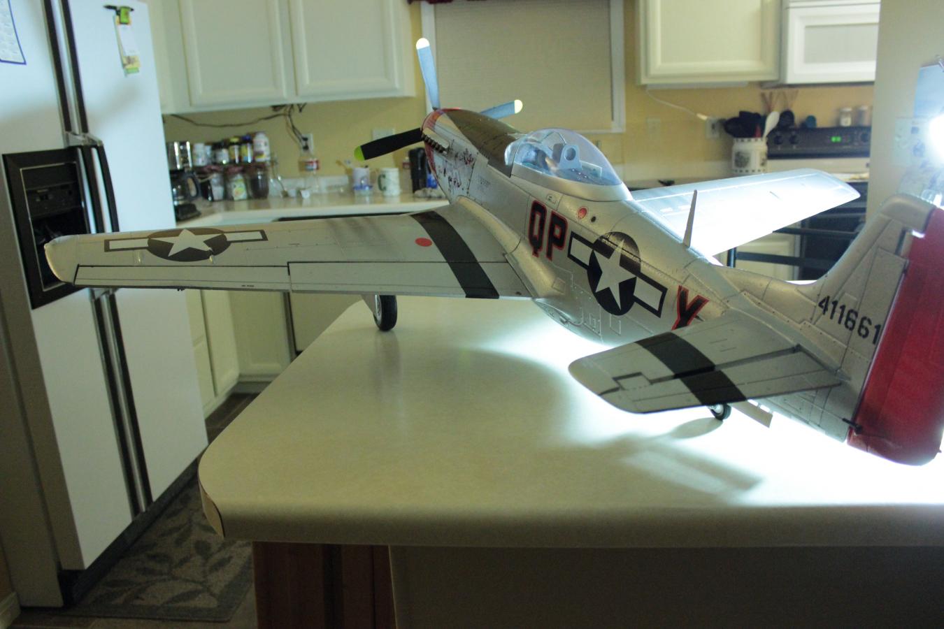

              Hi Boots, run it through a Watt Meter with the 4 blade prop, it should be okay but just to be sure. My 'Old Crow" runs an FMS 650kv with a 85A Mantis ESC, four blade prop with the zip tie mod. We had a big 'to do' when this one was first released on whether it should have come with an optional 4 blade prop.
              I notice that the version with the sound system is not available now, so check your CG, it should sit right on the two squares on the top of the wing that are, in fact the landing light mechanisms. So far, I've had three of the Iron Ass versions. My Old Crow and My Little Gal I and II. Only Old Crow is left which is an IA conversion with the sound system (which I've only used a couple of times as I find it irritating. Basically, it's good for scaring the cats!)
              In comparison to the FMS Mustangs, it's a little trickier to fly, it's more like the real thing from what I've been told. A very nice looking airplane in the air and on the ground. Personally, I prefer the FMS, I still have mine two FMS' and they are in great shape, can't say the same for my FW fleet, may most of them R.I.P.

                Grossman all of your warbirds look amazing!
                The FW Stang is slightly smaller than the FMS, so it is more the same “scale” as my FMS Zero and P-40B. I’m glad it no longer Includes a sound system, I’m not a fan and it seems the added weight would have a negative effect on flyability. You say you like the FMS better but did you ever fly the FW without the weight of the sound system?
