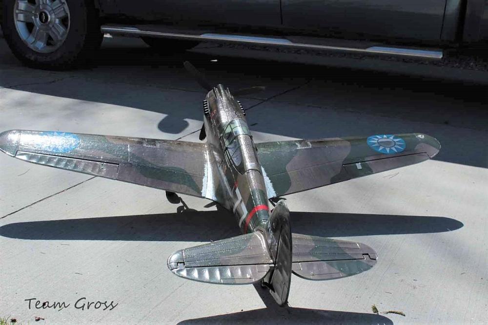

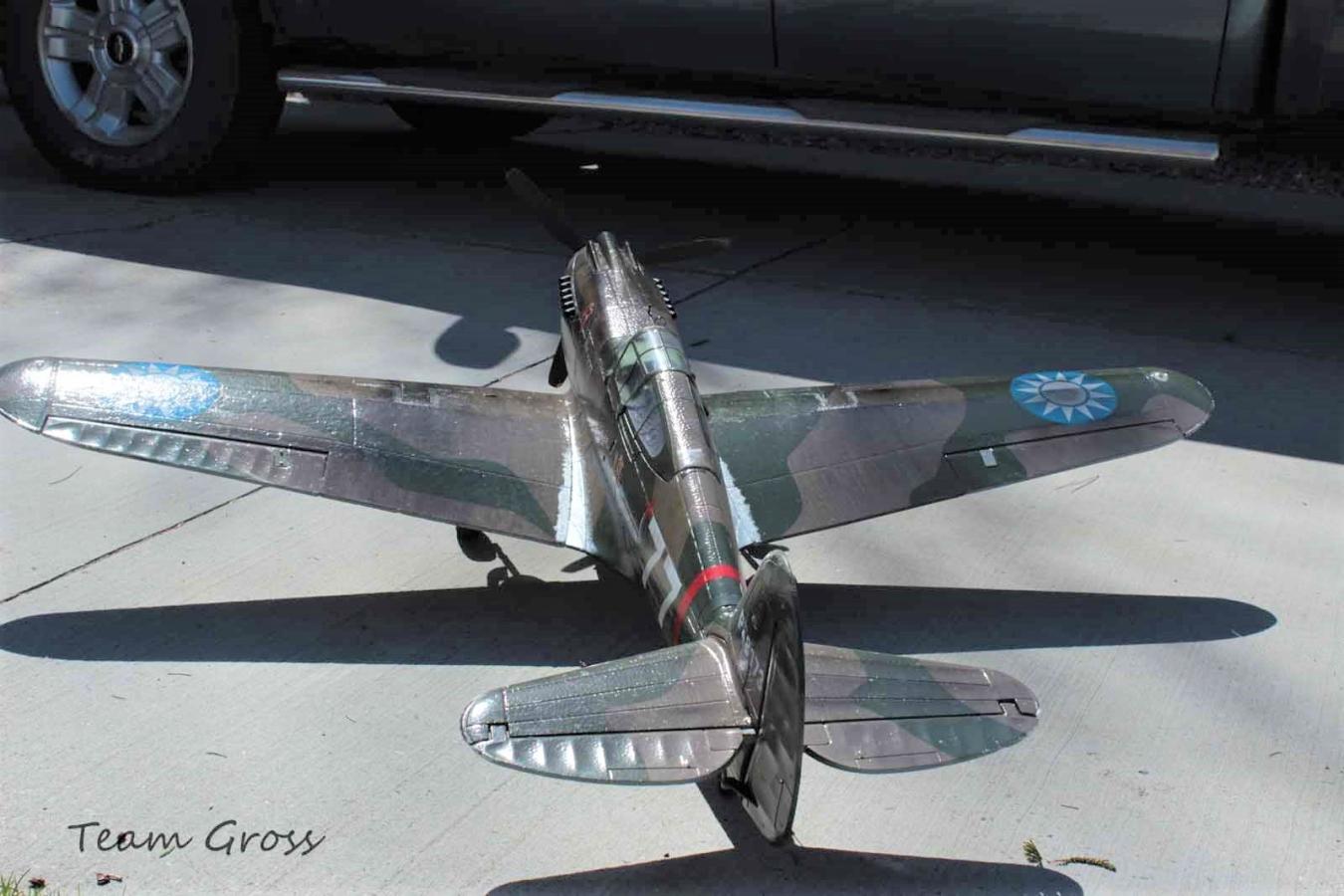

                  • I used light weight spackle for deeper wrinkles, for lighter ones I filled them in using Minwax spar Varathane, it takes a few coats. These particular wings are from My Little Gal II, the Hmmm, was the trigger for the rebuild. Recently, I stripped the nose and resanded and filled with the spackle then recovered it with Flite Metal.
ID:	338479 The paint I used was pretty thick as well, almost the consistency of whipped Cream Cheese. The first one is made by Delta Creative. It's called Ceramcoat Metallic Silver. The second one is Sargent Art Metallic Acrylic paint silver. Both I found on Amazon and have had good success with them the Sargent being ever so slightly darker than the other, both are thick and water based, so they will fill in some minor wrinkles by themselves. I just finished rebuilding a Bearcat that sat in the junk box for 5 years, did what I could with the spackle, painted it black then a dark blue which came out pretty close.
                    • Thanks Gross. How did you get rid of the ridges on the wrinkles, sand them down?
                      • Yep I got a set of the block sander from Wally World and some 220 grit and finer, works great.
                        • Thanks again. I've assembled the necessary materials/paint, ready to tackle the wrinkles and restore my bird to its former pristine appearance.

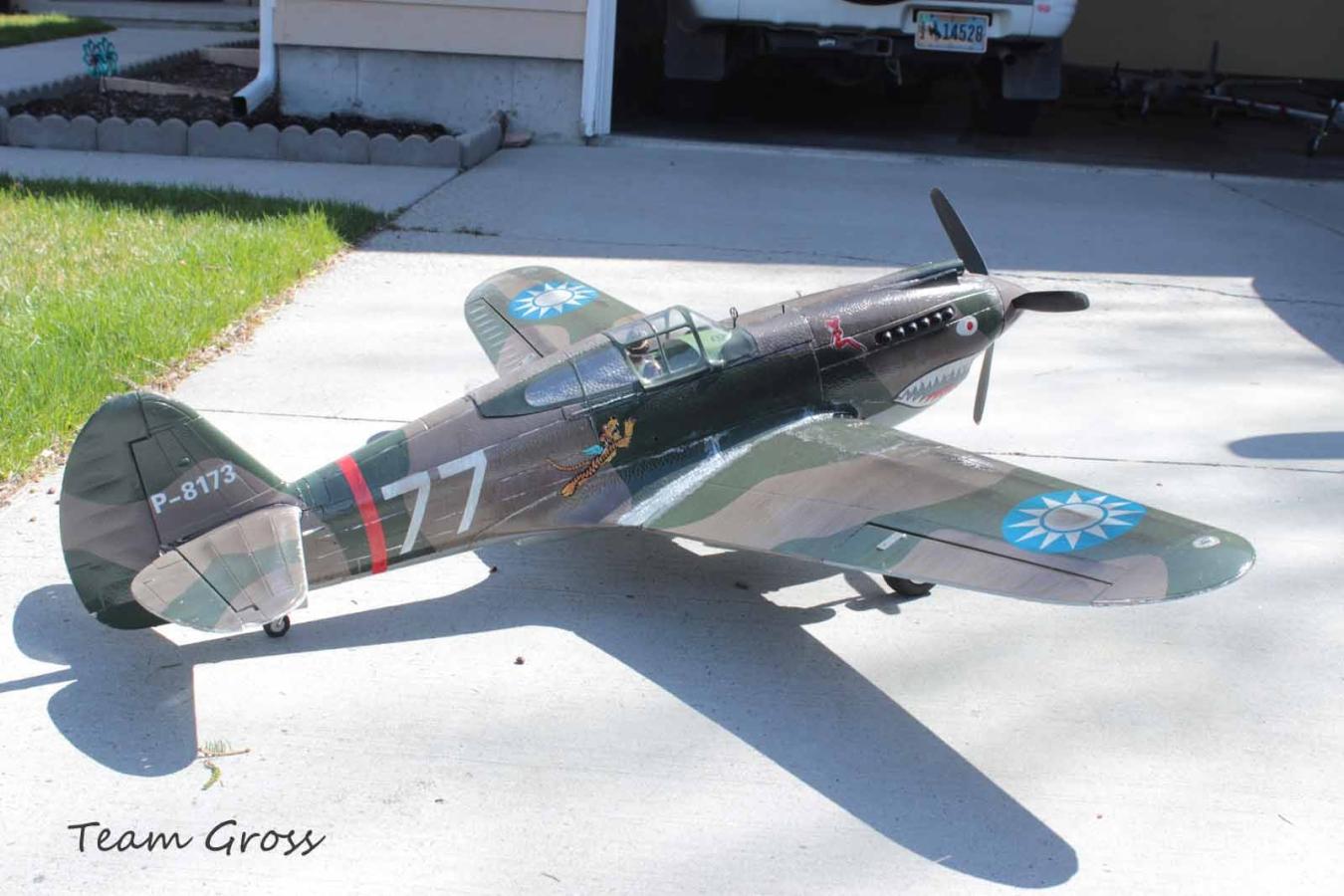

                          • As an example, my old P 40 had some pretty bad gatoring, so I used the Spar Urethane and 220 grit sand paper. Coat, coat sand, coat coat sand. Eight times if I remember right, eventually, the gatoring filled in. I was questioned about the extra weight, but I never noticed any difference in performance.
                            Stupid me, took her outside for some pics on the back deck and forgot about her so she gatored again. I'll have to go through the process again, but I recoated it with Minwax flat Urethane and she looks good, as in authentic good, the P-40's that the Flying Tigers were flying were pieces of junk that would have been scrapped out in the states.
                            Anyway, back on topic, you can work most things out with a bit of patience, heck I even redid the Avanti's leading edge doing the same thing. Click image for larger version
