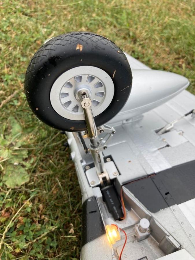

        Hello modellers. Does your P-51D also have heat shrink tube on the electronic main landing gear? What's under those heat shrink tube?​

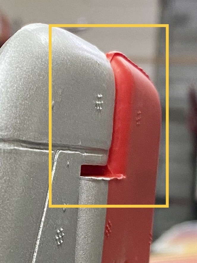

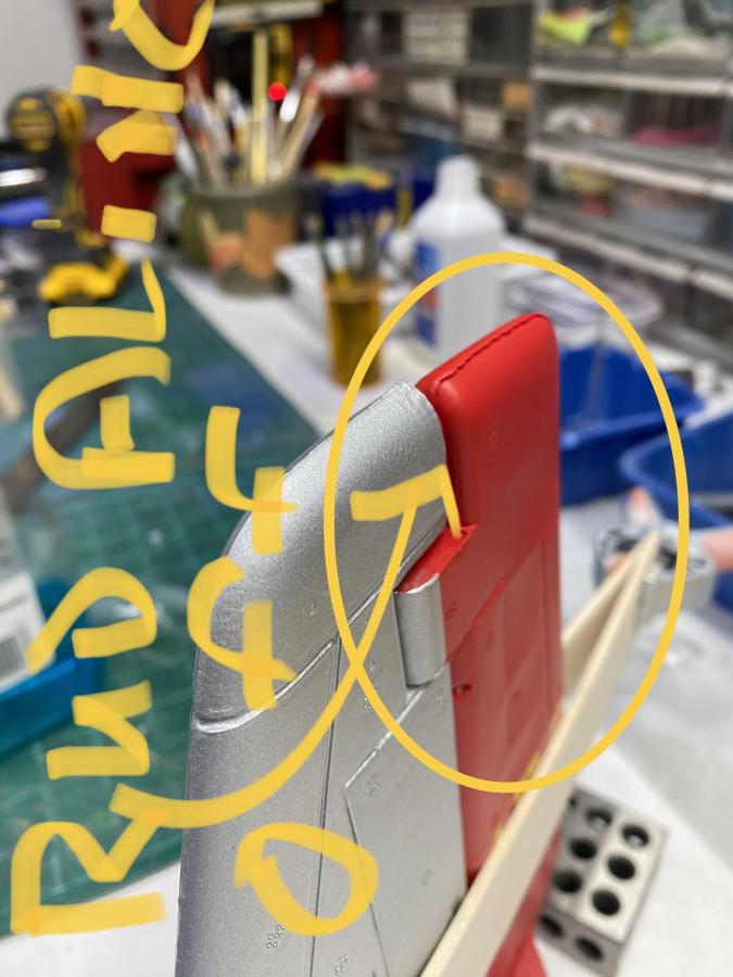

          Rudder alinement is off at top of vertical fin.Is this a big enough issue to have to contact Motion RC or can I fix this myself?

            Not really, if it's off at the top (slightly as it seems in the pic). back the push rod until you have approx. the same amount of deflection at the bottom as at the top. Once you're in the air, you will trim the plane out and probably find that the rudder is deflected slightly to the left or right to maintain straight and level flight. If you look at the motor cowling, you can clearly see the angle that the motor sits is not in line with the fuse, that's because the prop will tend to pull the plane to the right when taking off (P factor) (Balsa planes are notorious for warping when in the sun).
            Is this your first plane? Not implying anything but if you look at your other planes or someone else's you'll see that nothing is perfect, in my experience, a landing that results in the airplane flipping over on its back negates any perfection in the tail!

              #246
              Thanks for your reply ,no this is not my first rodeo just not a foamy guy but could not resist the freewing p51. I’ve read through last thirteen pages and pulled the trigger on this one.look forward to the maiden flight .

                Here's something interesting. A couple of months ago, I ordered a set of retracts, main gear and wheels, the all in one pack as shown in post #242 for one of my FW Mustangs. This time I ordered just the retracts for the other one as the struts and wheels were in good shape. Now, if you order the complete set, you get the retract with the heat shrink tips, if you order just the retract mechanism, you get the ones that the plane came with. I guess the complete set must have an updated retract mechanism while the retract unit itself is older stock. At any rate, both function fine, the only thing is trimming the foam for the heat shrink tip whereas with the other, it's just a drop and plop.
