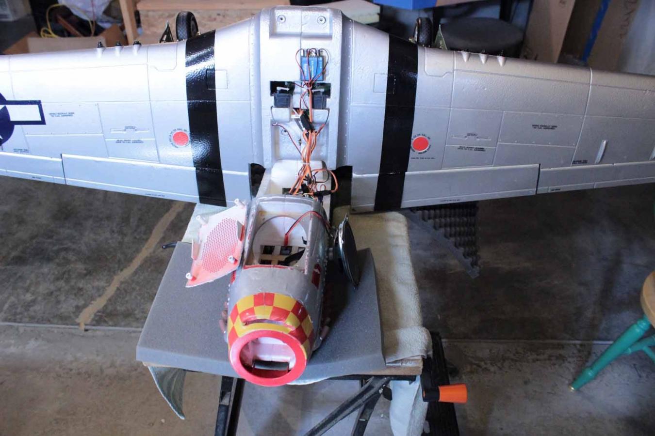

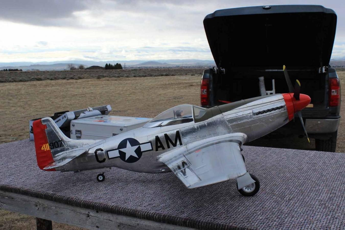

          Wow, been a long time since any action on this thread!
          I had my Old Crow up today for two flights. As a reminder, she was originally an "Iron Ass" with the sound system that I converted to Old Crow's scheme thanks to Callie Graphics. I also swapped out the motor for a 650 kv and did the zip tie mod.
          She flew great today for a bird that can be, well lets just say temperamental. Landing went great but on the last one, she drifted off the runway and snapped a pin on the landing gear door. Don't know how many L/G doors I've gone through, several lets just say. It would be nice if they could somehow be strengthened because it seems to me that you can look at them sideways and they break. The real drag is that they don't sell separately, you have to buy a complete set of gear doors to replace just one. Consequently, I have more spare gear doors than I'll ever need and if I keep snapping the same side...…..well you know where I'm going with this.
          Anyone ever make a mod to these, I'd like to know.

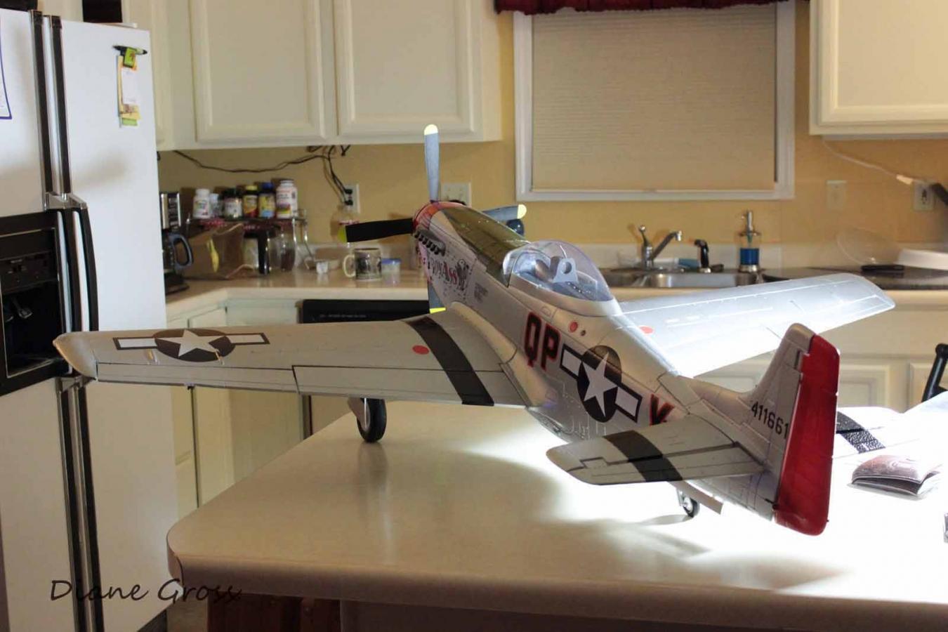

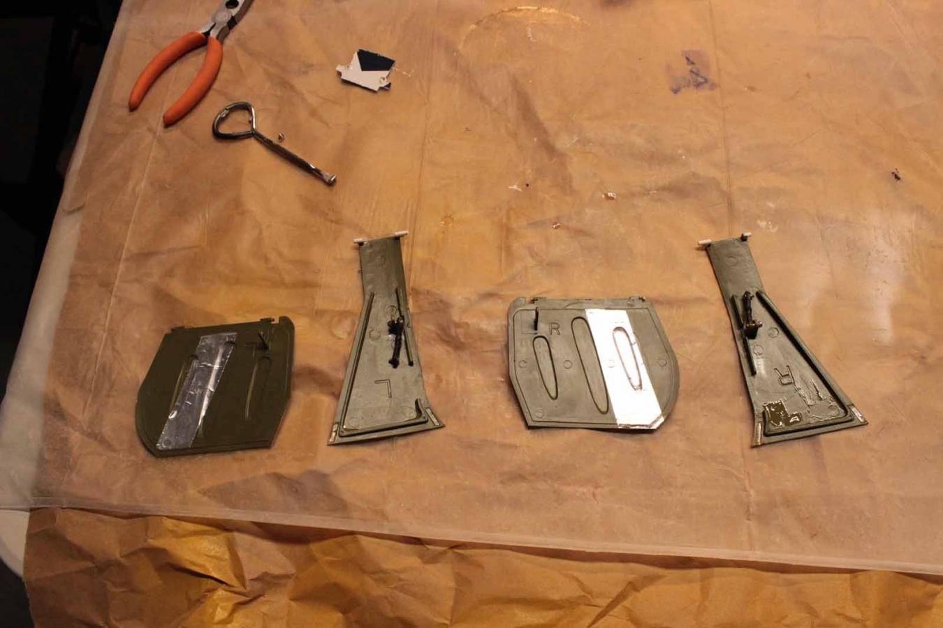

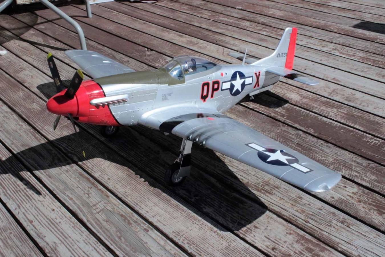

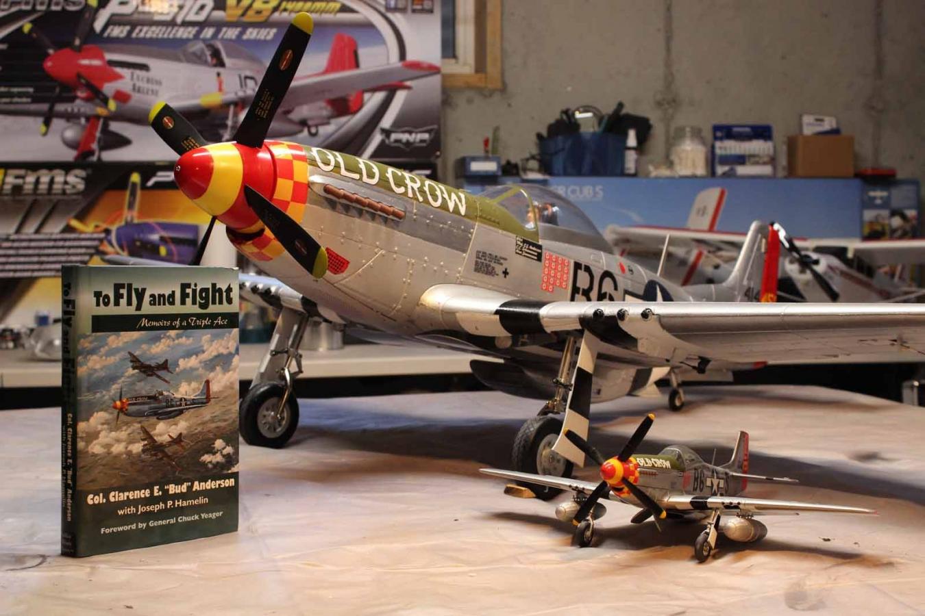

                          Had mine out this weekend and she flew great! Now, mind you, I have a 650 kv in her and she has the stock Iron Ass Sound system installed (because she is an "Iron Ass with and Old Crow paint job) which makes her a tad heavier. Week points, at least to me, are the gear doors and the Landing gear itself.
                          The doors will pop their pins off at the drop of a hat and, unfortunately, you have to buy a complete set, including clam shell doors and tail wheel doors just to replace one main gear door, at $7.90 a pop, it gets a bit expensive!!
                          I'm seriously thinking I'd be better off having some 3D printed.
                          The gear itself will retract very nicely on the ground, but in the air, you have to have your speed way down to get them to retract properly, due to the wind I guess. The set screws in the gear need constant attention as well.
                          That said, she's a tough bird, I still have the original fuse on her, mind you I've also lost two P-51s as well but, I believe, not due to the airplane, but a receiver issue.
                          So. although not my favorite P-51 (the best, in my opinion are the FMS 1400mm P-51D and B) it's still a good solid airplane and visually pleasing as well.
                          BTW, R.I.P My Little Gal I and My Little Gal II
