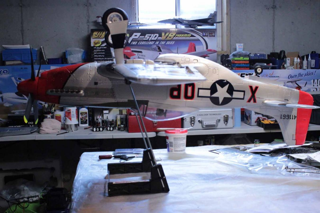

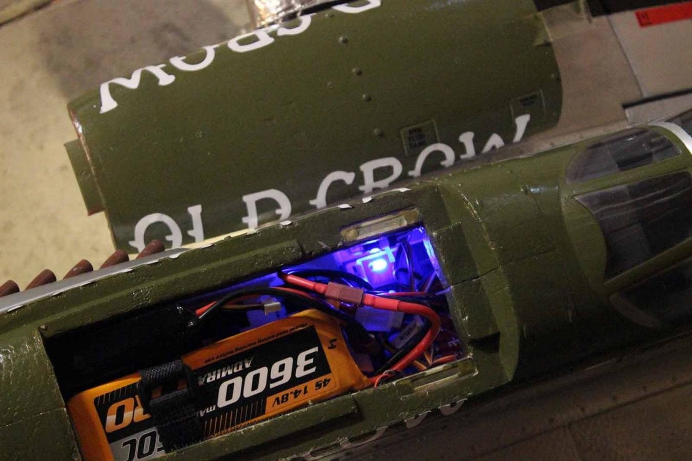

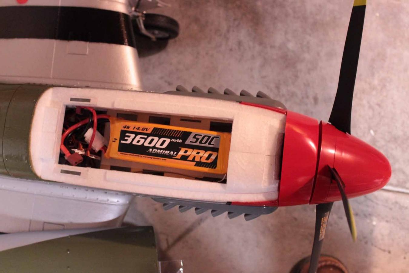

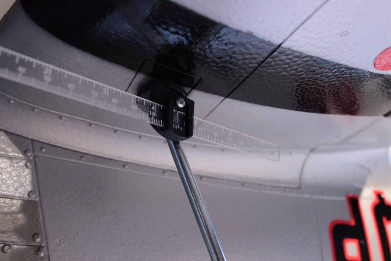

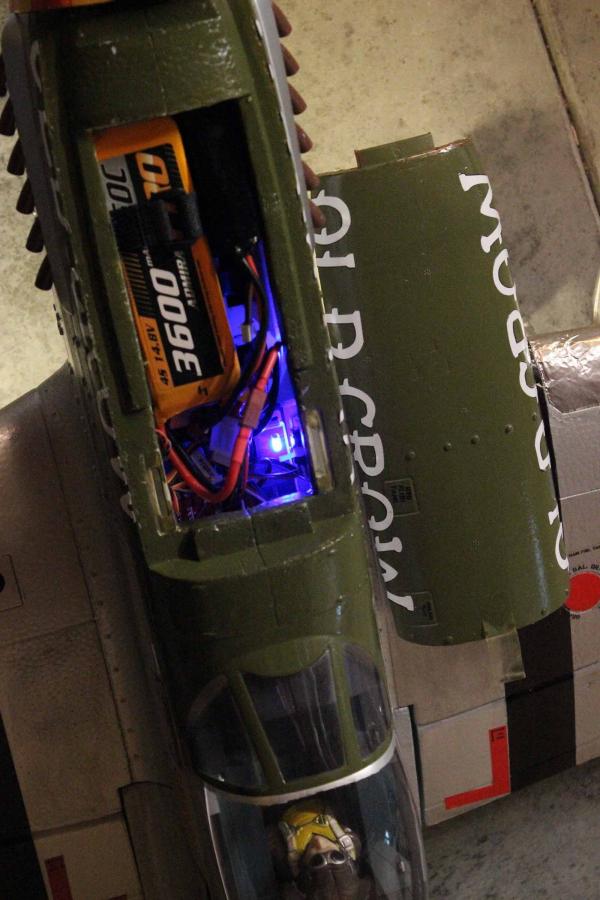

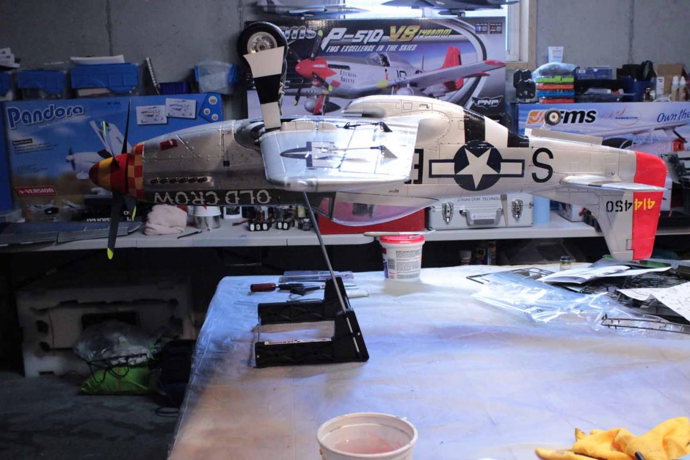

                          Hey Tom, the 2200 and 3600 number refer to the size of your 'gas tank' and will not harm the plane. My Old Crow balances fine with either and I have to keep a 1300 3s in it for the sound system, which I never use, just to achieve the CG. I've flown her on a 4000s before as well, just a bigger' gas tank'.
ID:	119608Click image for larger version
                          The black mass with the wires coming out of it at the top of the last pic is the 1300. You need that weight there if you have the old version stock sound system. As I said, I don't use the sound system, because I don't like it, but I'm not willing to yank it out just yet (if ever).
                          Now with the 4258 kv460 in her, the weight of a 6s, say a 4500, will add some weight to the nose, hopefully eliminating the need for dead weight. All my flights thus far with this plane have been with either 3600's or 4000's
