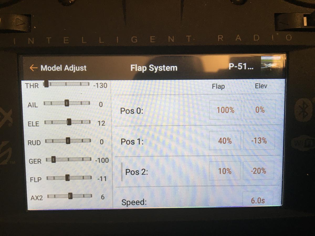

      There are quite a few things that you are doing differently in your Old Crow that will most likely change CG and flying performance compared to my setup--and if CG is different, then using my setup (particularly the zero-flap elevator neutral setting) won't be proper for your airplane. However, if you check your CG with all the sound system components in, battery in position and ready to fly--and the CG somehow comes out to the same place I described on mine (see pics above) then it should work well for a starting point. I guess its possible as you are adding components forward of and aft of the empty/loaded CG (aft speaker and board, front speaker, etc...and will likely be using a different battery weight). I just have no idea how it will come out for you until you actually measure it.
      Lol--I didn't like the 2-blade for scale...but it performs so much better than the 4-bladed prop--and heck, when the motor's running, you can't tell the difference anyway. I've tried the 4-blade twice. Once right after I got it new...didn't like it; tried it again about a year and a half later, did one circuit around the pattern with it and had to land it right away because it seemed so anemic compared to the 2-blade. Oh well, I thought I was a purist also--then gave it up.
      My setup at the CG (gear retracted) shown in post #177 above, with no sound system and the Admiral 4000mah battery all the way forward is:

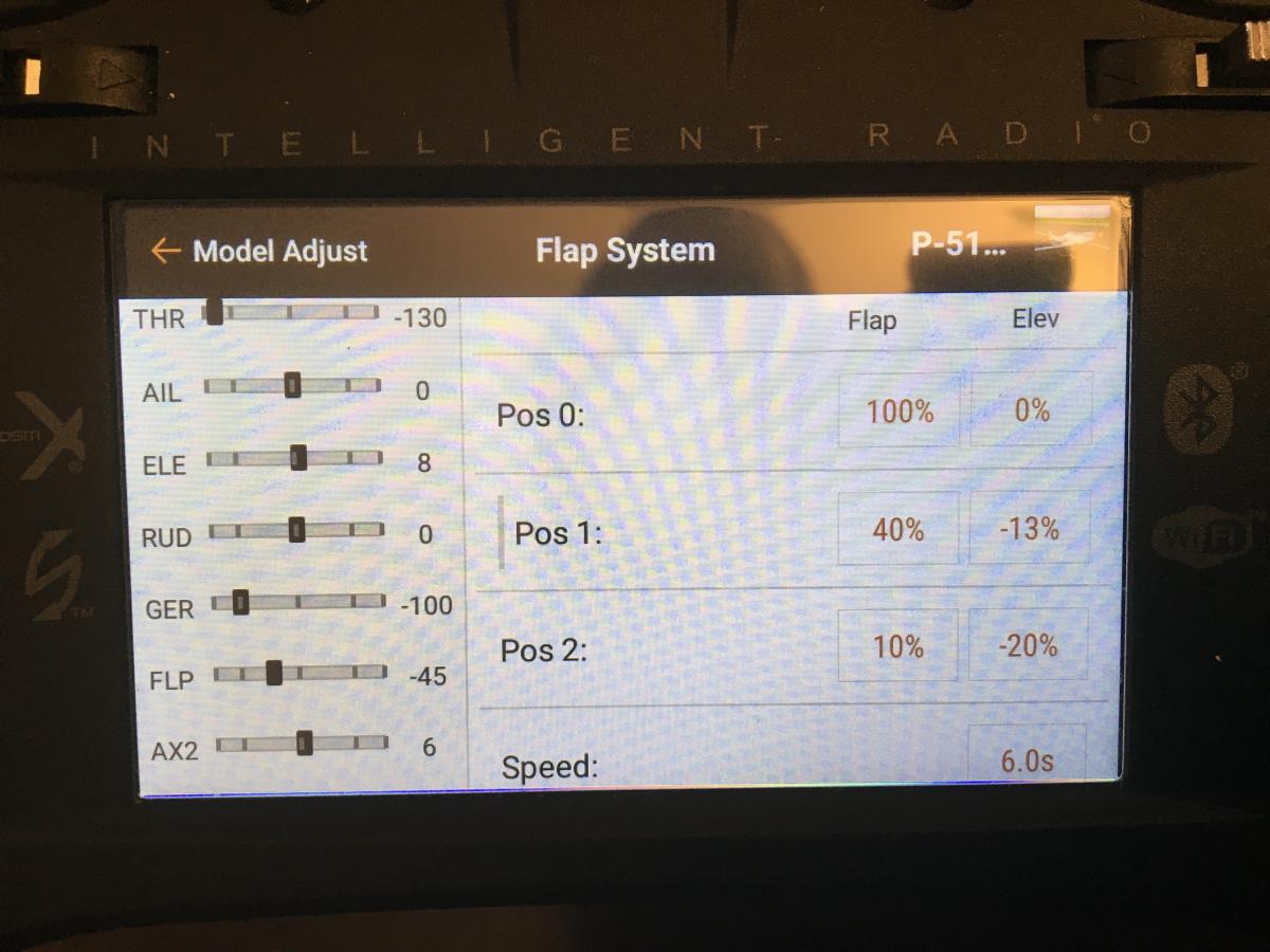

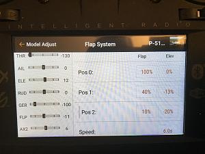

      1. Neutral TX zero with flaps up is 3.78mm downward deflection measured from the center of the trailing edge of the fuselage elevator fairing mold to the center of the trailing edge of the elevator.
      2. AILERON - LOW: 35%; MID: 50%; HIGH: 66% - 30% EXPO on all; ELEVATOR - LOW: 59%; MID: 70%; HIGH:82% - 30% EXPO; RUDDER - 100% ALL RATES EXPO 18%
      3. FLAP/ELE MIX: FLAP POS 0=100% (full up) no mix. For takeoff flaps (40%) I have a mix of -12. For landing flaps (10%) I have a mix of -19 with a speed delay of 6.0 seconds.
      4. The elevator neutral zero-flap position pic is here: https://www.hobbysquawk.com/forum/rc...061#post218061
      5. A couple of takeoff/landing tips for Old Crow: https://www.hobbysquawk.com/forum/rc-airplanes/rc-warbirds/1727-fw-p-51-old-crow?p=218691#post218691
      Finally, there is a big dedicated RCGroup forum on the Freewing P-51 both for those that have a sound system, and those that don't. Chances are if you do a thread search for your question, somebody's asked and answered it before: https://www.rcgroups.com/forums/show...-sound-unit%29
      Good luck with your maiden--let us know how it goes. If you have any questions before you take it up shoot me a pm and I'll do my best to help you out.
      DB

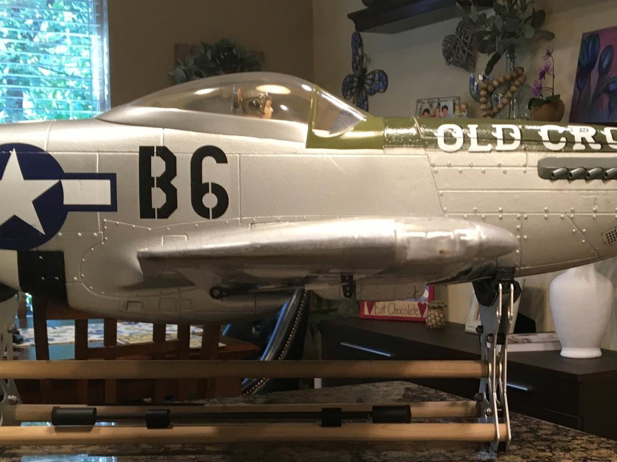

                        LOL you absolutely must've had a sweater or TX lanyard hanging from the tail back then when you checked CG that time and didn't see it... ;-))

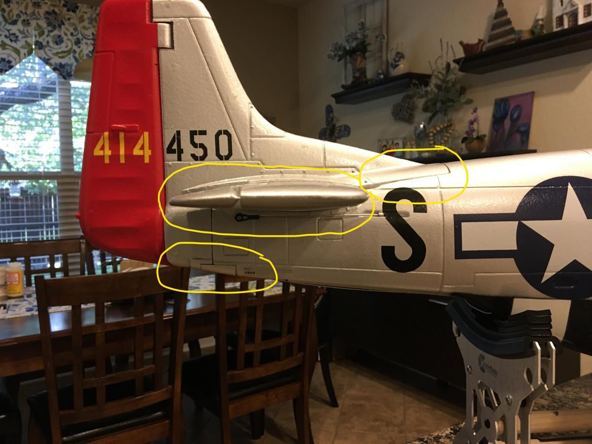

                        Okay--these are the only other things you could check--wings and empennage for proper installation/incidence...if yours checks out identical to these AND you've checked your flaps "up" position alignment with fuse wing filets/form. Then you are good to go. Just program everything as I've given you, if you want to change anything, you could maybe use HIGH elevator rates for takeoff just to ease your mind that you'll have enough...but overcontrolling right at liftoff could be a consideration--obviously your call. Again, with my settings, I use low rates for takeoffs (I've tried MID but prefer low) and LOW RATES for landings. After you re-maiden, adjust to your preference--but at least you'll be safe to fly.
                        EMPENNAGE: IMPORTANT: Check the circled areas for flush/proper installation so that stab incidence is proper--screws all the way in.

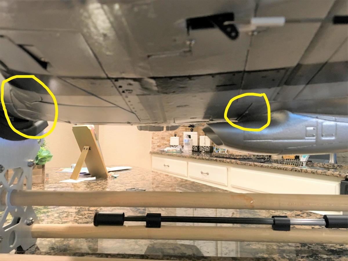

                        BOTTOM WING: check center leading edge and center trailing edge flush with snug screws.
                        Just a look at the other side--mid to check flush installation.

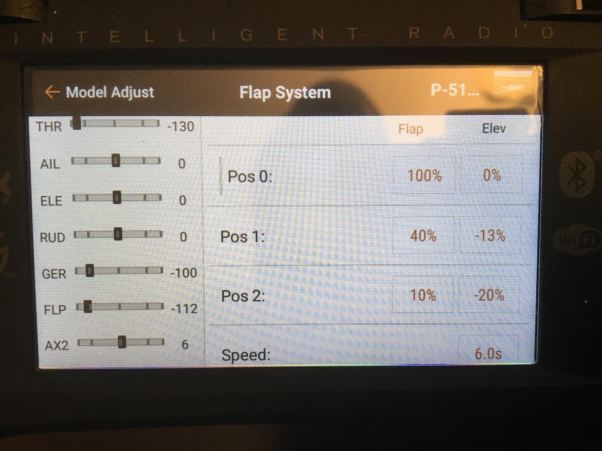

                                So, I got it out to fly today. For the most part everything was good, except your flap setup. I set my flaps to the same mix as yours and the plane had a major float up. It was hard to keep it heading down for landing. I moved them back to the manufacturer settings and it flew much better. Trim was good. Aileron authority is very low at the manufacturer settings. I think I'm going to pump them up a bit.
                                These are my current settings. I'm going to increase the aileron throws though.
                                Flap mix:
                                Up - 100% flap, 0% Elevator
                                Half - 54% flap, -7% Elevator
                                Full - 35% flap, -11% Elevator
                                Aileron: 36% low, 61% High
                                Elevator: -40% Low, -60% High
                                Rudder: -100% Low and High
                                With all that weight out of the nose the performance is much better, as expected. The other issue I had was the landing gear only went up about half way again. I took the doors off for the second flight and everything worked normally. This gear is giving me fits.
                                Happy to say the balance and trim is almost perfect. Thanks for the assist.

                                  #196
                                  Congratulations on the successful flight!! I knew it would work for you.
                                  I'm sure the difference in trimmed flight with flap extension for you (assuming you used my set positions and mixes) was due to a slight CG difference. Also, the more the flaps are extended on this plane, the more UP elevator is needed to be input (or mixed in); and of course the inverse is true. Also, the speed at which you extend the flaps (or fly with them extended) makes a difference as well. With the positions and mixes I have programmed and recommended (see iX12 screenshots below) I fly down final approach on speed, full flaps having to hold a little back pressure on the stick with about 25-40% power. (see also video posted here: https://www.hobbysquawk.com/forum/rc-airplanes/rc-warbirds/1727-fw-p-51-old-crow?p=267915#post267915)
                                  DB

                                    ....Aileron authority is very low at the manufacturer settings. I think I'm going to pump them up a bit...These are my current settings. I'm going to increase the aileron throws though.
                                    Rudder: -100% Low and High...
                                    Here are my rates again for comparison--I noticed your aileron HIGH rates were lower than mine; and the big difference was on the elevator...yours was much lower than mine. I usually am in LOW rates--and I wouldn't want any less than where I have it; my HIGH rate elevator is probably excessive, but I can't remember using it much, if at all.
                                    Now in my programming, I adjust the percentage of elevator different up/down to net the following deflections:
                                    Aileron - 8mm; 11mm; 15mm.
                                    Elevator - 9mm up/8.5mm down; 11mm up/10mm down; 12mm up/11mm down.
                                    Rudder (all measured from the raised dot lower aft rudder) - 23mm right/14mm left; 23mm right/16mm left; 23mm right/17mm left
                                    DB
