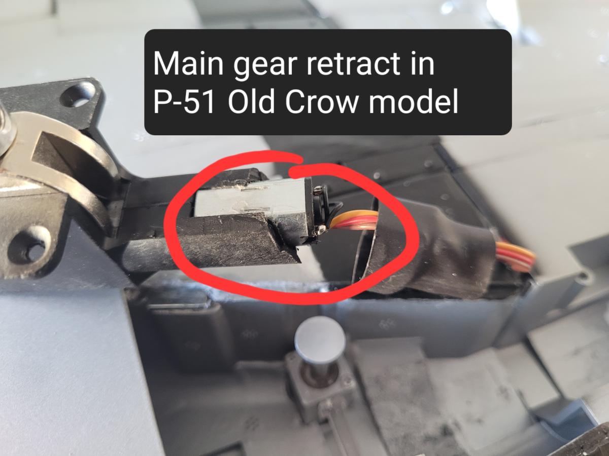

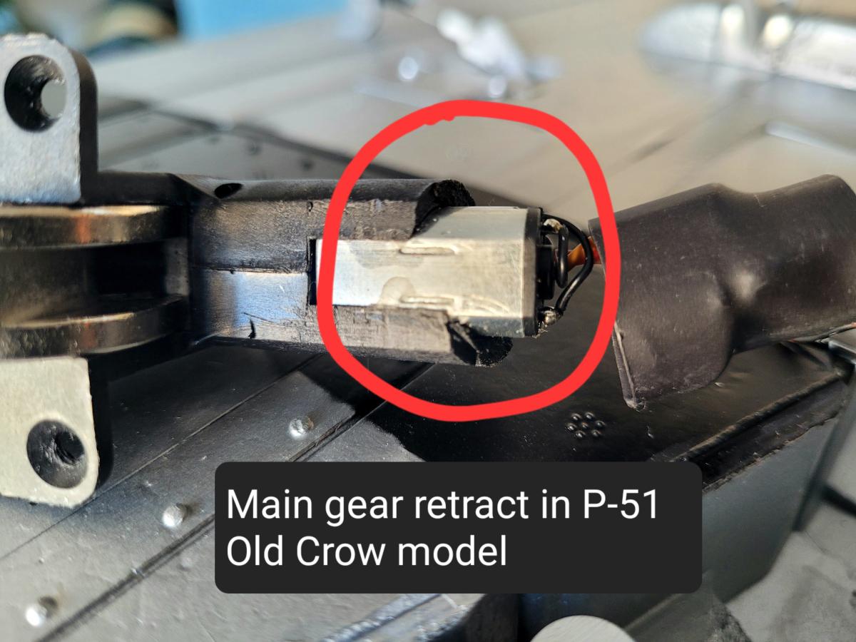

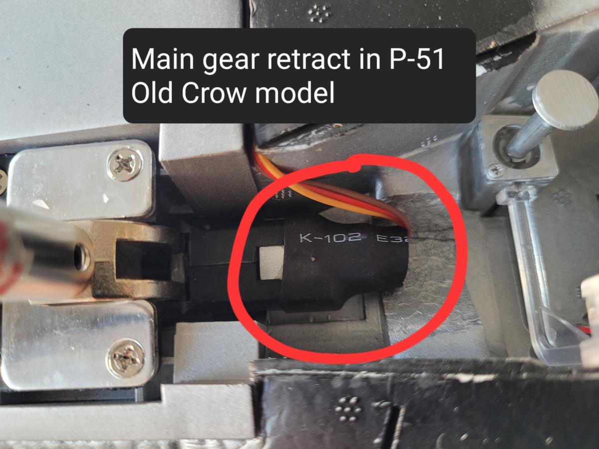

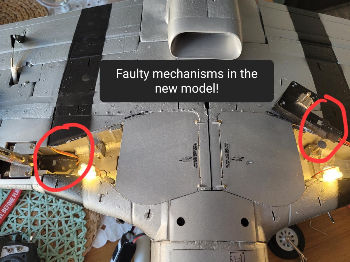

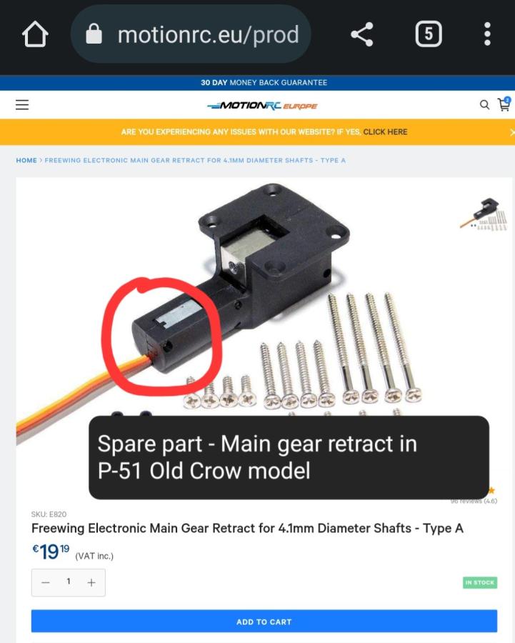

                                    • Why does the main gear retract look like damaged in the new P-51 Old Crow model and the spare part does not? What is it about?
                                      Do you have the same in Your model?​
                                      • Originally posted by RAFALR30 View Post
                                        Its broken. Hidden by the boot.
