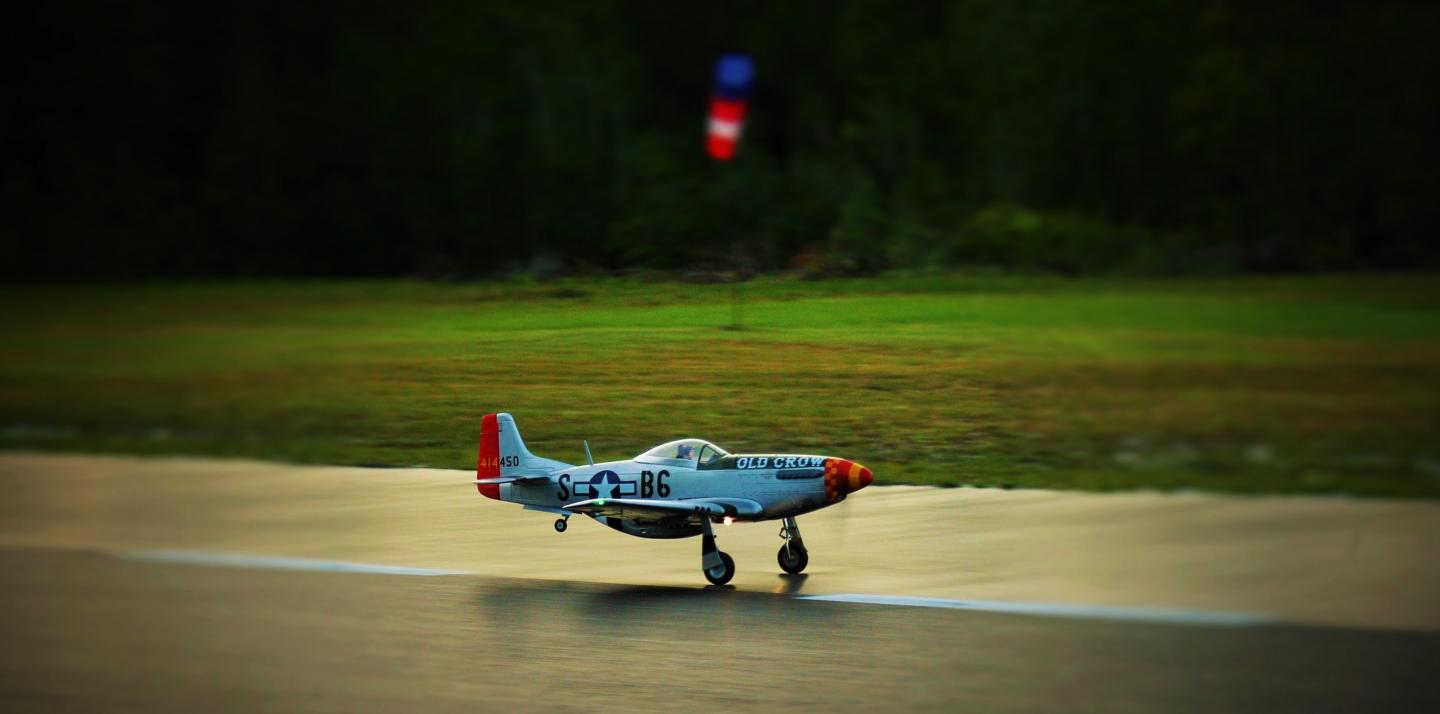

            Hey Tom, that was me!
            With the Iron Ass version, the plastic grilsl are held on with four screws, remove it and you can see the speaker, or the speaker cavity depending on whether it came with the stock sound system or not.
            The stock sound system (Iron Ass version) doesn't 'sound' like a Merlin to me, but with the MRC sound system or the Aspire sound system, they may have more realistic renditions.
            I believe its the
            Aspire system that uses the plane itself as a speaker so the sound would not be so directional. A few of the guys went this route, maybe check back on the original posts on this thread.
            All in all, a good plane (Iron Ass version) and with the updated power system, it should meet all your expectations
            The landing gear hard points on the wings are a weak point and you might want to reseat the retract to the strut with some Foam-Tac, they have a habit of backing off sometimes.
            Also, I'd suggest that you use a diversity receiver with a satellite antennae, give yourself all the insurance you can.
            I put the invasion stripes on mine, even though Bud was still flying his B model on June 6, I like the extra visual.
            Funny thing was that he mentioned that the airplanes paint scheme changed from week to week as a bunch of 20 year olds with 'hotrods' were prone to do. He was positive that the D model, for instance, didn't have white wall tires until his son found a picture of her with them!
            So a certain amount of liberty can be taken.
