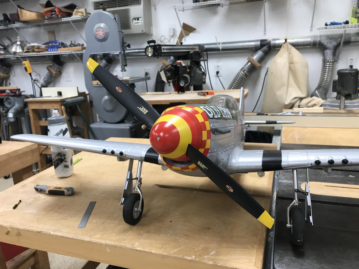

              • I think I've made peace with the 2-bladed prop. So I blinged it up from the stock black. (Guess what? Frog tape doesn't work on Testors ;)

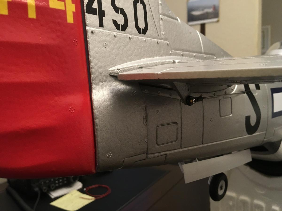

                  On takeoff it went for the moon. i dialed in massive amounts of down elevator. Got it going straight and this thing acted like it was so out of balance for the crazy flight around to get it back on the ground.
                  So what gives? its virtually un-flyable. Stalled out on landing and popped a gear assembly out.
                  I took two other aircraft up today for their first flights Bf109 1100 and A6M5 1100 and they were perfect. this thing is terrifying.
                  Any suggestions on keeping it in the air?
                  • Yes...since this plane was built with a sound system, and you don’t have one installed (nor do I) you can't have the elevator aligned with the fuselage per other planes. A substantial downward deflection needs to be mechanically added. Of course, zero out your TX trim first. The deflection needs ti be at least as much as I show below on mine.
                    Then try again. My CG is in the same place as yours, right on the wing squares. Mine flies beautifully with an Admiral 4000 all the way fwd. it flies even better with a Ternigy 5000 in the same place. I'd also check your engine thrust angle and motor mount installation. Its all prefabbed, so it shouldn’t be a problem, but I’d still check it.

                      I had the same "go for the moon" experience on the maiden. Ran almost full nose down trim. Came in OK. Then checked the elevator and it looked like the pic above, so adjusted the linkage to position it that way with neutral trim. The CG is fine. I just think the horizontal stab is set a little wrong. Has flown fine since.
                      I was taking all my taildraggers off in full power in an effort to get rudder effectiveness as soon as possible. But they didn't look smooth, or scale. An old guy talked me through using far less power. Add it slowly and start with full up elevator to keep the tail wheel on the ground, for steering. Ease the elevator to neutral as it accelerates. It still happens fast. If you hold it back too long, the airplane gets airborne too quickly. If you don't hold it long enough, you lose rudder effectiveness.
                      It's a learning curve. But I do WAY prettier takeoffs than when I cobbed the power.

                        • Kept telling myself the two blade prop was fine, but never liked the look. As I ordered the 4-blade with the model, I finally put it on. I see maybe a very slight reduction in speed. Little affect on battery duration. And it just plain looks way cooler. Not going back to the two.

                              • Mine has never had a two blade prop, she spins a four with a 650 kv motor driving it, as do all my Mustangs. The only way to go if you want the best of both worlds with a 4s system.
                                • Oh, BTW, if you change out the prop shaft as well, you can get a nice tight fit as shown on My Little Gal
