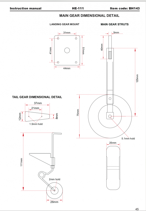

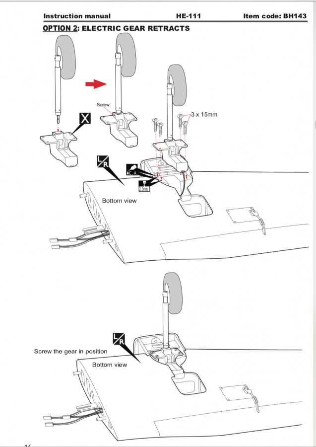

                    quick question just crossed my mind.
                    https://www.motionrc.com/products/xw...tronic-retract
                    are these retracts specificly catered for the he-111 kit? meaning are they direct drop in fit with struts included and fitted with the wheels that come with the arf kit? or is there some additional work involved, which then would make one ponder about alternatives which they might already have in the hangar...
                      It is my understanding that those retracts will be a drop in fit for this He111, yes. But don't kill the messenger, I'm just MRC's pixel pusher. ;)
                      I would ask Alpha or Stuart who would be in better position to answer definitively.
                        Off the top of my head, 10-15 size retracts work but I'd use 25 sized or even slightly larger, something like what the F7F Tigercat or Freewing 80mm A-10 uses. The plywood mounting plates aren't predrilled for a specific model/brand of electric retract so there's lots of versatility in selecting the exact retract unit to use based on your preference as long as it can handle the weight. Fixed gear is an option, too, although I'd make Tigercat main retracts fit if I planned on flying the He-111 as a daily driver.

                          Hi Guys, I'm in Europe so have just got up, good to see plenty of chatter though.
                          Regarding the RM400-90 retracts, they are intended for use with the He-111 and PC-9 (as well as future BH offerings.....;)) and should fit with very little modification, if any required. The strut supplied with the He-111 can be seen in the manual, screen grab attached (can be downloaded from our site also). Its not a full scale unit, but is an oleo so is a great place to start to get you flying. The RM400-90 does not come with a wire strut, simply a retract unit.
                          Hope this helps.

                                Alpha, the only thing that bothers me are the main gear struts. The he-111 had struts more like a Mosquito, Lancaster or DC-3. After market struts are hard to find
