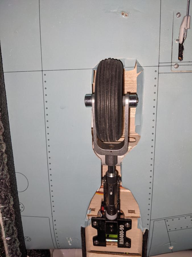

                            I've been slowly plugging away on the He-111. The covid lockdown means I can't just run out for a part here or there.
                            Anyway, I've come up with a set of landing gear I'm happy with.
                            I used some struts I found from a company called RC Aerodyne.
                            I only needed the mains from the set. I didn't think to call to see if I could just order the mains alone, so I have an extra xtra nose strut for another project someday.
                            For the wheels I used an extra set I had for the flightline P-38.
                            After cutting the axle to size and installing new longer strut pins to fit the xwave retracts, I installed them in the plane.
                            I'm still waiting for the prop adapters to come back in stock. In the meantime, I'll button up the wings and start work on detailing the cockpit some.
                            Very nice airplane and pleasure to work on

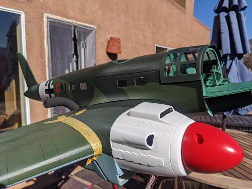

                              Little more progress toward finishing this beauty.
                              The prop adapters finally came back in stock so I'll soon be buttoning up the wings and calling them done.
                              Landing light is installed. One bit of advice, don't just look for airplane accessories. The RC car guys had a light system perfect for landing lights that use regular receiver voltage.
                              The resin printer I've been waiting for all summer finally shipped. I managed to snag an elegoo Saturn before they insta-sold out. Thanks to Spinetti I've got a perfect control yoke. I've also printed a pilot, a commander, a gunner and two torpedos The MG-15s have been tricky and I'm still working on remixing the file to suit a model.

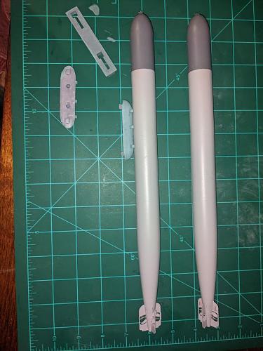

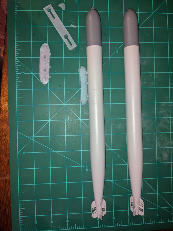

                                    Ordinance update
                                    Almost done with the torpedoes. The model for the torpedo came from a collection of WWI Austrio-Hungarian torpedos where I resized a suitable model to fit the plane.
                                    The mount I custom designed and embedded a standard freewing attachment design so that I may remove the torpedoes for transport.
                                    Next up is installing the mounting plate into the fuselage.

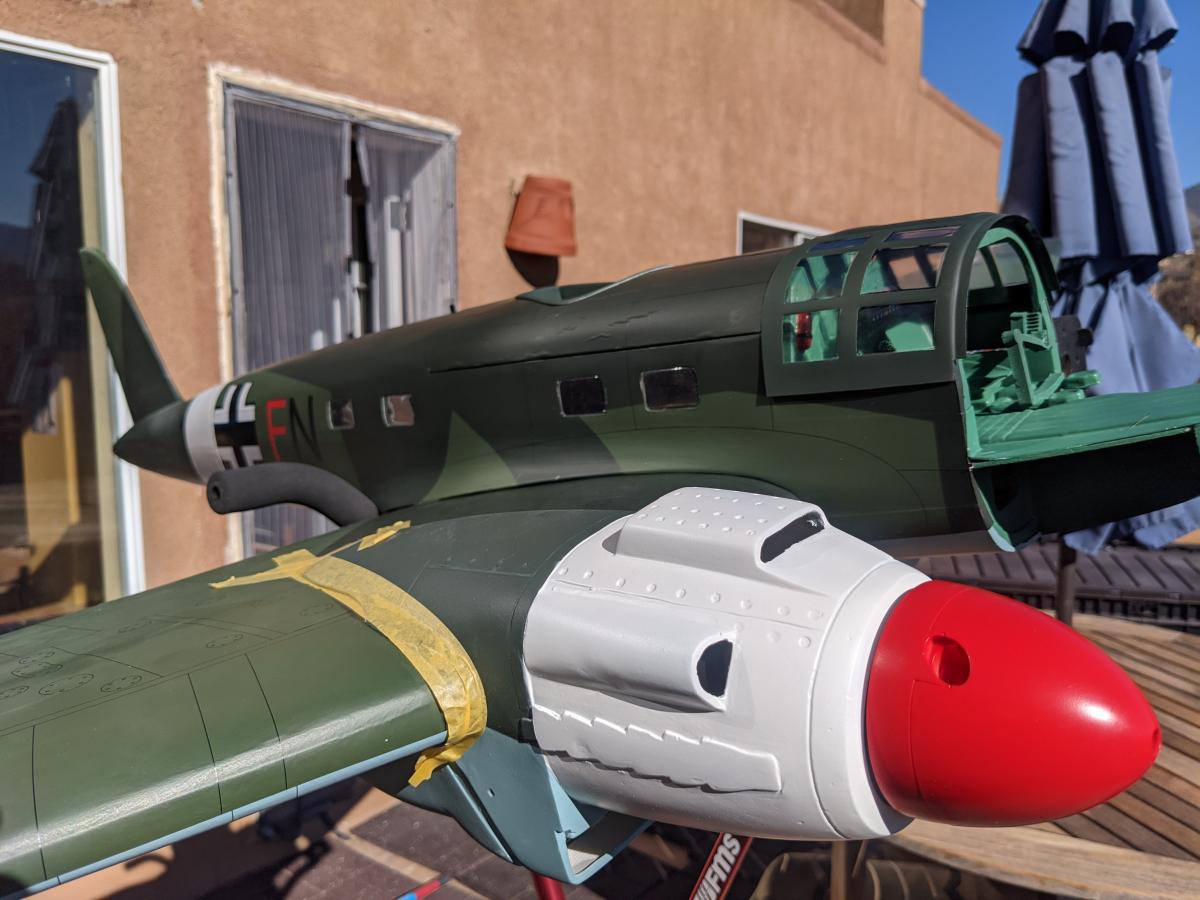

                                      Some winter storms has given us a bit of a build season, and so I've been working on the fine details of my He-111. I finally have a decent remix for the guns that I will post on Thingiverse at some point.
                                      The dorsal gun position iss done, and the flight commander is painted. My painting skills are definitely lacking, and I need more practice.
