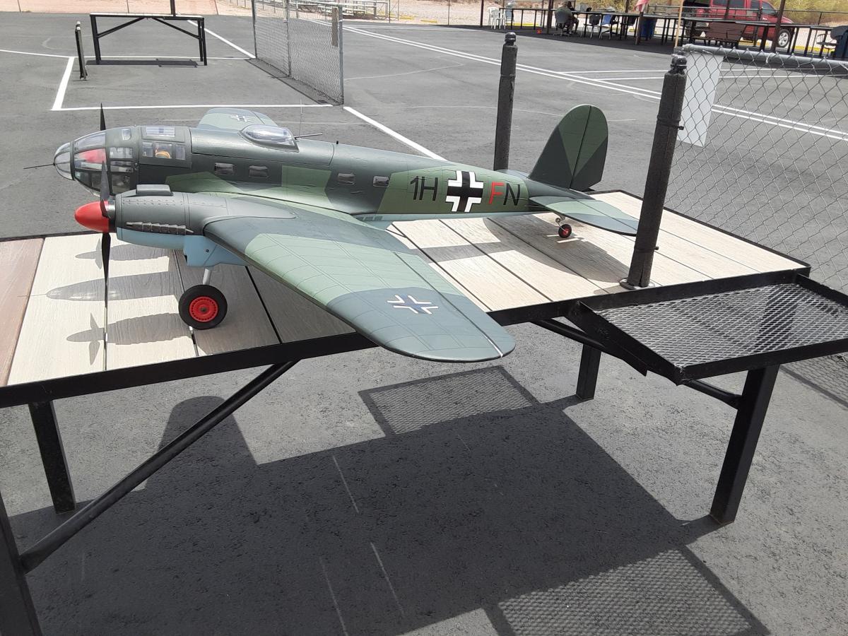

        This is getting old. So I hooked it all up and both my esc seem like they have burnt. For each motor I have 4s 3000mah batteries. Motors are the ones from the flight line ta152. Plugged into to receiver is a 2 cell life battery to run the servos. The one thing I did not do was unconnect one red wire from one of my esc's. I have had just about enough of this aircraft. Ready to throw it in the trash.

          WIth just the LiFe battery, 2 cell 2300mah, connected everything was working. Then I connected the 2 4s batteries and it went south. Any ideas?

            Which ESCs were you using on this He-111?

              They are ZTW Mantis 65A ESC with 5A SBEC. I suspect the extra battery is the issue. Its shows it in the pic but not the schematic. I was told to use it to run the servos. But the 2 4s also run the servos. The goal was to have aux power for the servos in case of a problem the the esc's. Since both batteries go into the receiver this may cause an issue??

                I have 65 amp ESC's in both my He-111s. I also use a 2s BEC battery to power the receiver. I use 10 amp CC BEC's in both. I do not understand how your ESCs burned. Very baffling.

                  What about disconnecting one of the red wires from one of the esc's, going to a y harness, to the receiver?
                  does the receiver battery being a LiFe have anything to do with it?

                    I plugged in each component back in one by one, not all at the same time. In all. 1 esc is damaged. 1 seems to be working correctly. Both motors work.

                      On my twins, including the He-111s, I disconnected both red wires when using a separate BEC battery.

                        I think this was my failure. Damn, I did it to my own self. Thanks for the replies. It was very helpfull.
