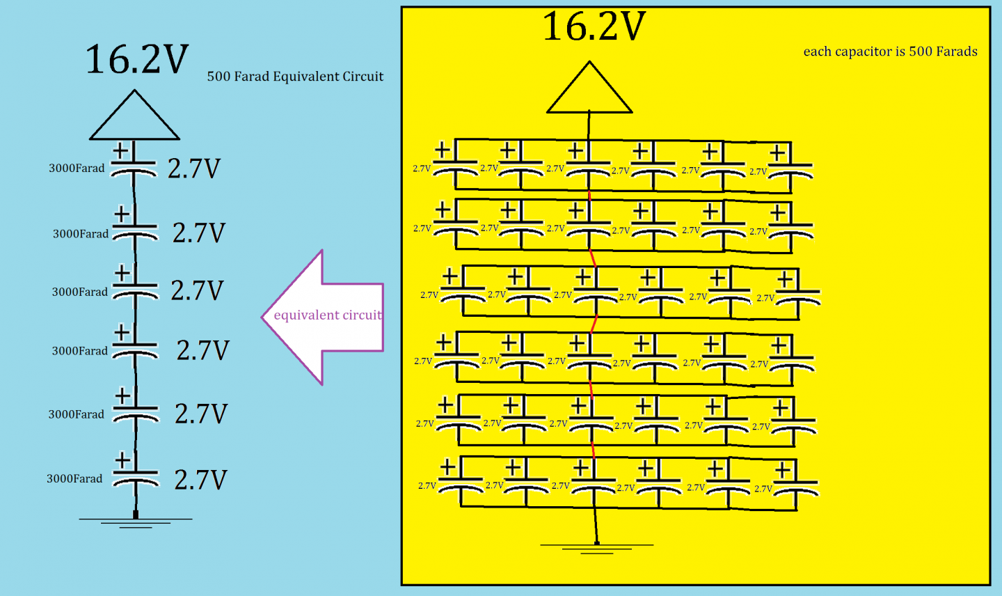

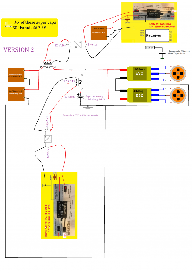

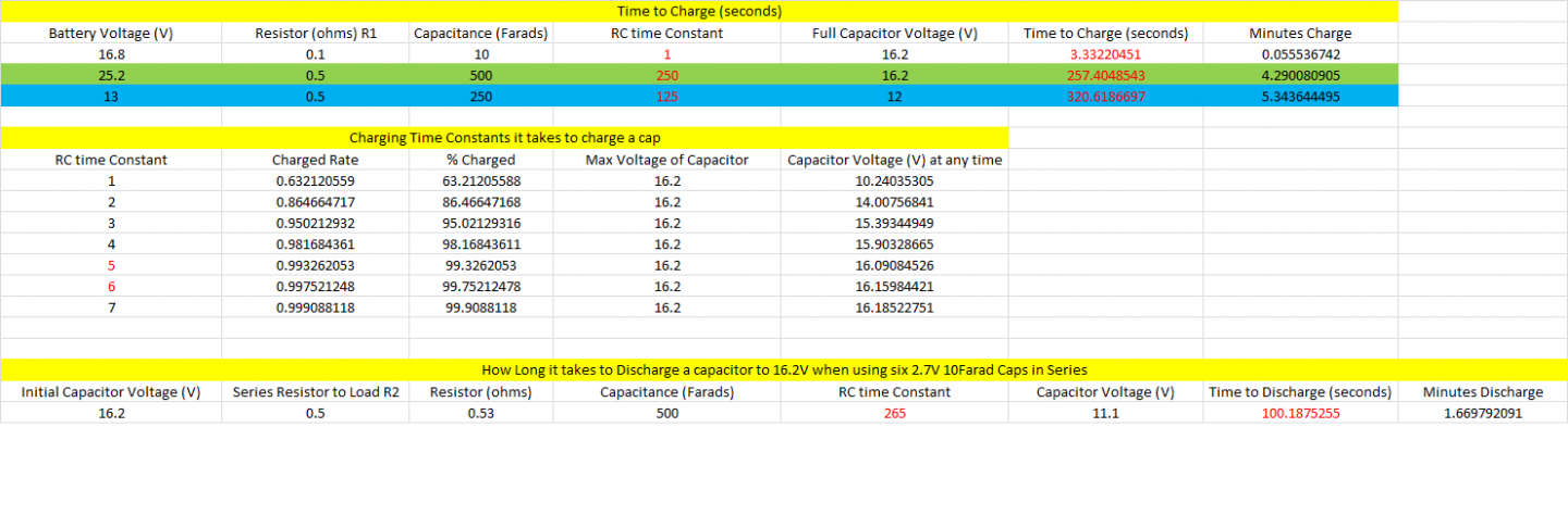

                            Since the Black Horse Heinkel He-111 1750mm (68.9") Wingspan model will be my first balsa model, I want to make absolutely sure there is plenty of security features in the event of any possibility of battery failure to the ESC and motor load. I will be building a supercapacitor network circuit to charge and if needed in emergency cases, discharge the high capacitance capacitor network in series by utilizing a couple of external components. The key here is to pick optimized resistance values for the charging and discharging circuitry which will be toggled by a high power automotive relay rated at 100Amps with a 12V coil voltage. It's unfortunate that there aren't any relays that accept 5V coil drive, which means I'll need to put in a 5V to 12V DC to DC step-up converter to mitigate this issue. The 5V input will be driven by the hobbyking Dr. Mad thrust UBEC with 2A output load at 5V, I will be sourcing this module with a 2s 2200mah lipo for driving the ubec driver as well as powering the receiver via the ubec itself. I chose the 2200mah 2s pack because of the high torque servos I plan on using for the ailerons and the high accuracy digital elevator servo, as well as the B-17 1875mm, retract setup. and will utilize a 4800uF cap or this one will work (bind port) to decouple the output SBEC 5V to the RX in conjunction with the Dr. Mad thrust regulated 5V out as well, in case any set of BEC's fail there are sure to be more that are going to be active to ensure a brownout will not occur.
                            Note: there will be two relays and two Dr. Mad thrust UBEC's which will be sourced by the single 2s 2200mah pack, the relays will need to be individually switched for the supercapacitor circuit to proper charge and discharge as I do not want the battery connected during the discharge phase, and also during normal non emergency operation, I want the capacitor to be an open circuit condition after it is fully charged at 16.2V.
                            Note: in place of the Dr. Mad thrust UBEC module a DR. Mad thrust On-off switch may also be incorporated in place as a substitute but this also means an external BEC such as the Castle Creations BEC 10A will be used as the main BEC module in conjunction with the integrated BECs of the ESC's
                            The output of the 5V driver from the Dr. mad thrust module will be the input voltage of the 5V to 12V DC to DC step-up converter which will drive an automotive relay mentioned above. I will set the driving circuit to the AUX2 for the main supply relay, and AUX3 will control the supercapacitor relay. Therefore a Lemon 10 Channel RX with Satellite will be incorporated for this operation, with an external eagle tree stabilizer.

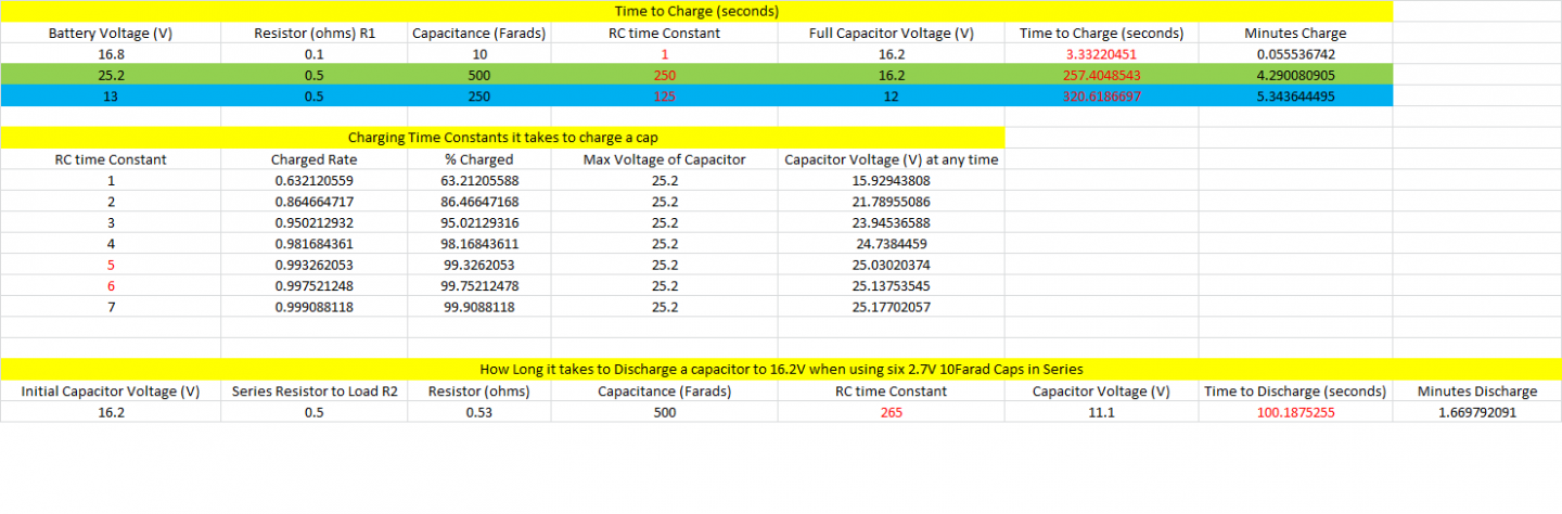

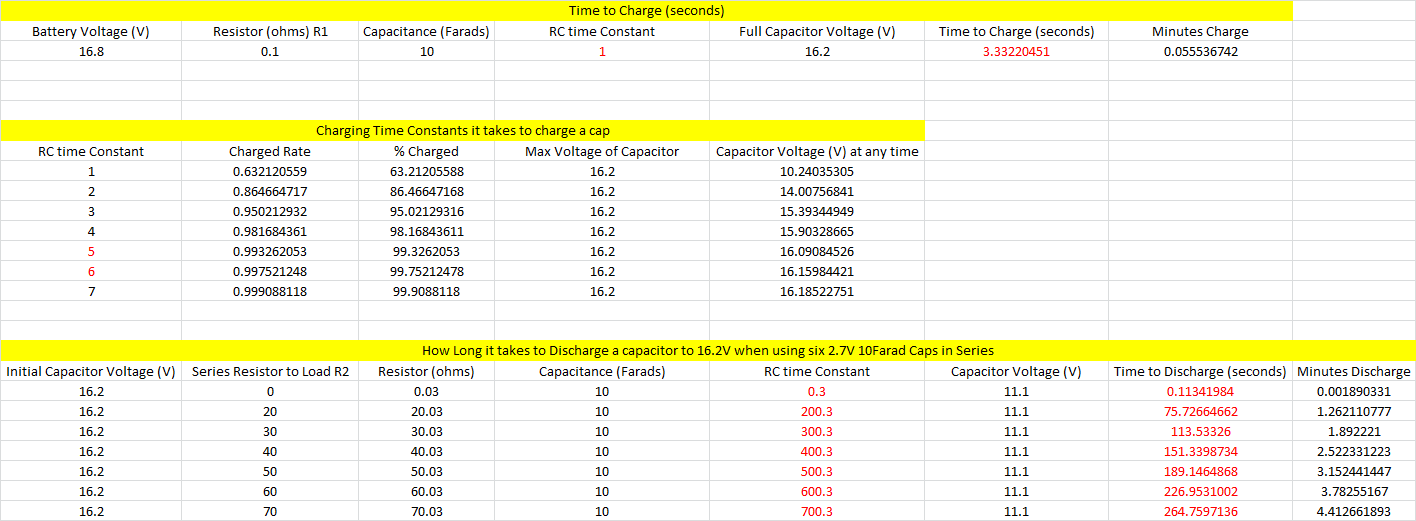

                            For starters, I plan on using a 0.1 Ohm 1% tolerance resistor and a series (Capacitance is the same and voltage gets added, just like a battery) network of six 2.7V 1Farad capacitors to achieve the desired RC time constant in order to quickly charge the capacitor in about ~3.3 seconds before the flight begins. After the capacitor is done the charging, the current across the R1. With a charging characteristic of Seven, RC time constants will essentially have zero voltage drop across it which will terminate its way across R2 into the active load ESC and Brushless motor loads.
                            Now for the discharging part of the circuit:
                            If should the discharge circuit ever be needed, in case if a battery happens to be bad or if the runway is too crowded or if its too windy (and therefore multiple attempts to land is needed requiring emergency energy); an act of God determines that the battery is gonna quit and there's nothing left, beyond Low voltage cut off for the ESC's to suck on, then we will simply hit the AUX2 switch to open the battery relay, and immediately close the AUX3 switch to close the capacitor relay which by now is fully charged, via the Dr. Mad thrust unit modules to and energize the relay coil by driving 12V to it via the DC to DC step-up converter. The supercapacitor initially is at 16.2V terminated by R2 (50ohms this value will be calibrated upon experimentation) with a wide tolerance resistor which was chosen to achieve an RC time constant to reach a ~3minute discharge (theoretical at 50Ohms) characteristic. But this being an active load with variable throttle should keep enough to buy enough time to bring the aircraft down safely should a battery network give up.
                            I will create a debug board and simulate which R1 and R2 values will really be feasible. Because the active load is going to be variable with throttle input, it might be noteworthy to increase the value of R2 to 70ohms (or more) to reach a higher RC time constant and discharge time, but I will stick with these theoretical values to start with to see what might happen until I get a debug session going.
                            Click image for larger version  Name:	Heinkel Super Capacitor Version 2.png Views:	1 Size:	282.8 KB ID:	198467
                            Click image for larger version  Name:	Super Cap Charge Discharge.png Views:	1 Size:	39.7 KB ID:	198468

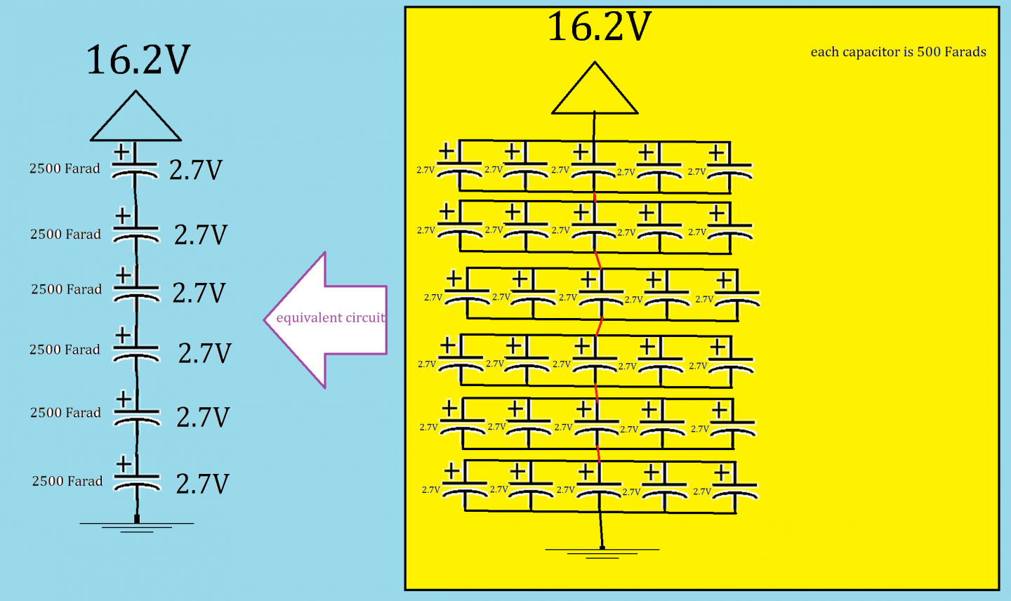

                              #54
                              Ive updated the circuit diagram to have 30 of these super caps at 500Farads to achieve a near equivalent energy density of a 1000mah 4s pack fully charged for emergency purposes

                                #55
                                This will be the equivalent circuit to that of a 4s 1000mah fully charged lipo which has comparable energy density. For an emergency, in the event, the battery will fail or disconnects from the main flight.
                                FYI for a fully charged 4s 1000mah (C rating wont matter) has an energy density of 16.8 Watt hours
                                For the equivalent super cap network shown i have calculated 15.2 watt hours.
                                Plenty of juice to do what needs to be done to bring her back to the runway safely.
Name:	2500Farad Super Capacitor.png

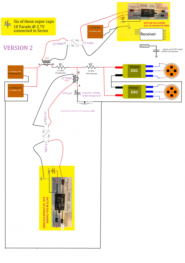

                                        #59
                                        Since the Black Horse Heinkel He-111 1750mm (68.9") Wingspan model will be my first balsa model, I want to make absolutely sure there is plenty of security features in the event of any possibility of battery failure to the ESC and motor load. I will be building a supercapacitor network circuit to charge and if needed in emergency cases, discharge the high capacitance capacitor network by utilizing a couple of external components. The charging and discharging circuitry will be toggled by a high power automotive relay rated at 100Amps with a 12V coil voltage. It's unfortunate that there aren't any relays that accept 5V coil drive (for the 40Amp job), which means I'll need to put in a 5V to 12V DC to DC step-up converter to mitigate this issue. The 5V input will be driven by the hobbyking Dr. Mad thrust UBEC with 2A output load at 5V, I will be sourcing this module with a 2s 2200mah lipo for driving the ubec driver as well as powering the receiver via the ubec itself. I chose the 2200mah 2s pack because of the high torque servos I plan on using for the ailerons and the high accuracy digital elevator servo, as well as the B-17 1875mm, retract setup. and will utilize a 4800uF cap or this one will work (bind port) to decouple the output SBEC 5V to the RX in conjunction with the Dr. Mad thrust regulated 5V out as well, in case any set of BEC's fail there are sure to be more that are going to be active to ensure a brownout will not occur.
                                        I plan on using a 14AWG gauge wire to the 500F capacitor network. After the capacitor is done the charging, I will disconnect it from the circuit during normal operation of the bomber.
                                        As soon as the battery fails due to the will of God the discharging circuit will be engaged and the battery will be removed from the loop.
                                        If should the discharge circuit ever be needed, in case if a battery happens to be bad or if the runway is too crowded or if its too windy (and therefore multiple attempts to land is needed requiring emergency energy); an act of God determines that the battery is gonna quit and there's nothing left, beyond Low voltage cut off for the ESC's to suck on, then we will simply hit the AUX2 switch to open the battery relay, and immediately close the AUX3 switch to close the capacitor relay which by now is fully charged, via the Dr. Mad thrust unit modules to and energize the relay coil by driving 12V to it via the DC to DC step-up converter. The supercapacitor initially is at 16.2V terminated by the esc and motor load. But this being an active load with variable throttle should keep enough to buy enough time to bring the aircraft down safely should a battery network give up.
                                        Click image for larger version  Name:	Heinkel Super Capacitor Version 2.png Views:	0 Size:	277.6 KB ID:	199131
                                        Click image for larger version  Name:	2500Farad Super Capacitor.png Views:	0 Size:	678.9 KB ID:	199132
                                        i would be using a fully charged 6s pack as an external power supply to charge the 36 cap network in order to get a ~4.3 min charge time. In this case i wont have to tax the main 4s flight packs at all, and if needed use the cap as needed in emergency.
