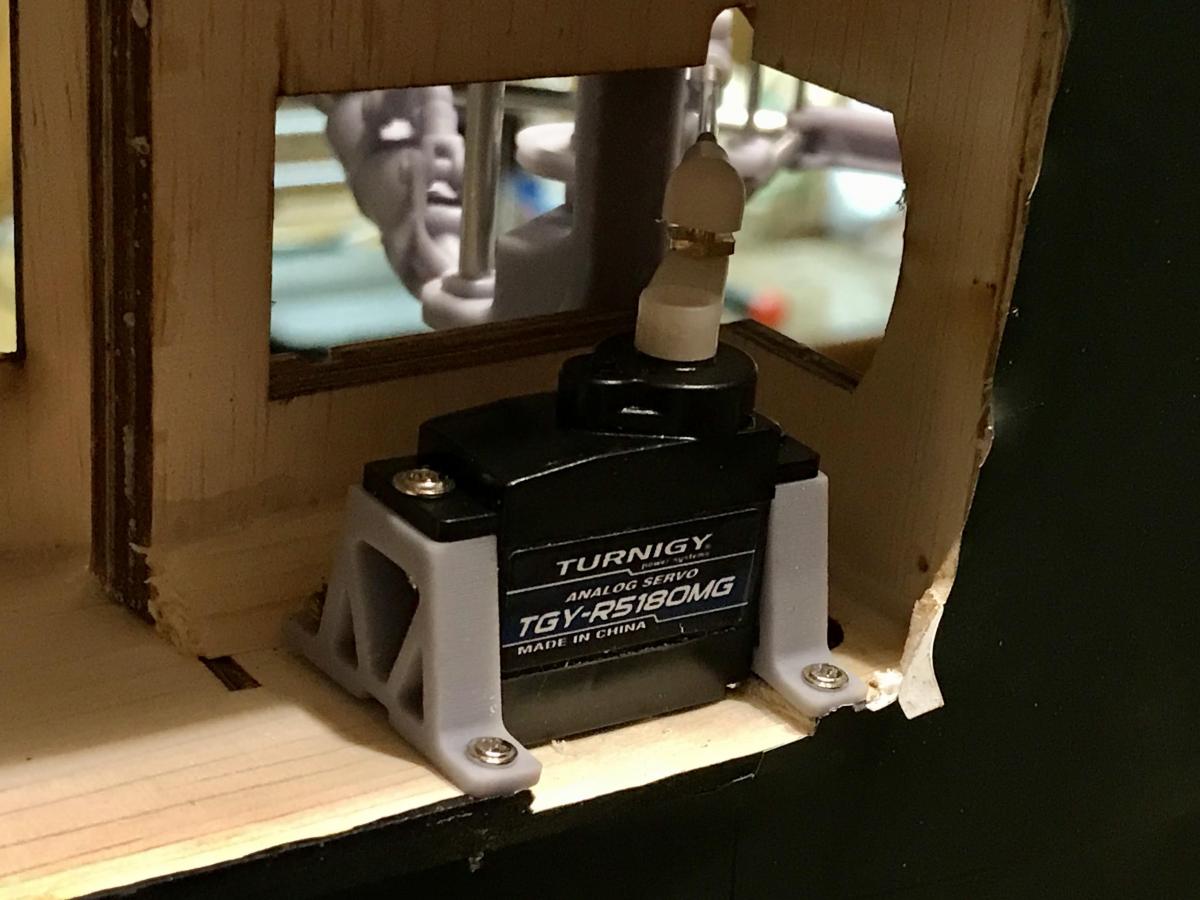

      #102
      Figured out the last bits of the install. Designed some servo Mounts, got servos and linkage stuff and gave it a go. Couple caveats - I just used a servo tester to run it, so its a bit herky jerky. I also don't have the rear mount support glued it so its a bit creaky :) Looks like I can't upload a movie, so I'll put that on Youtube under my username - Spinnetti

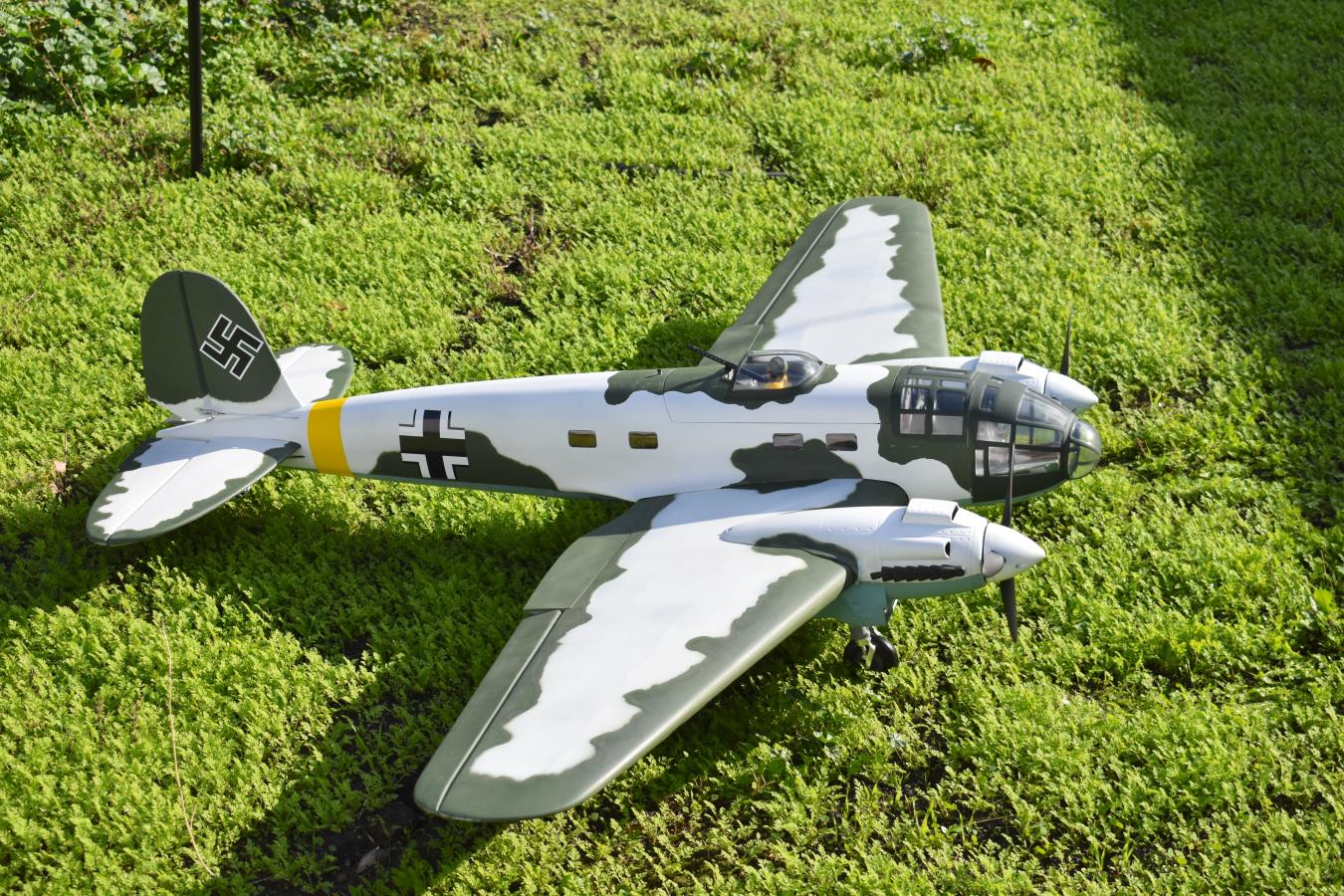

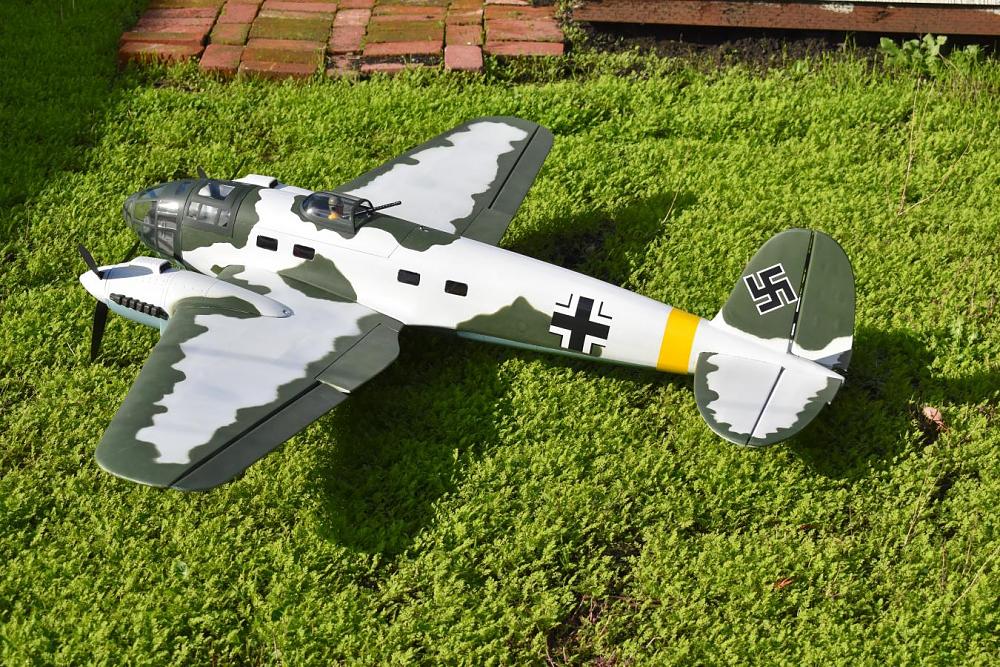

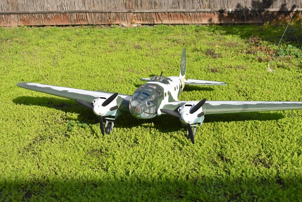

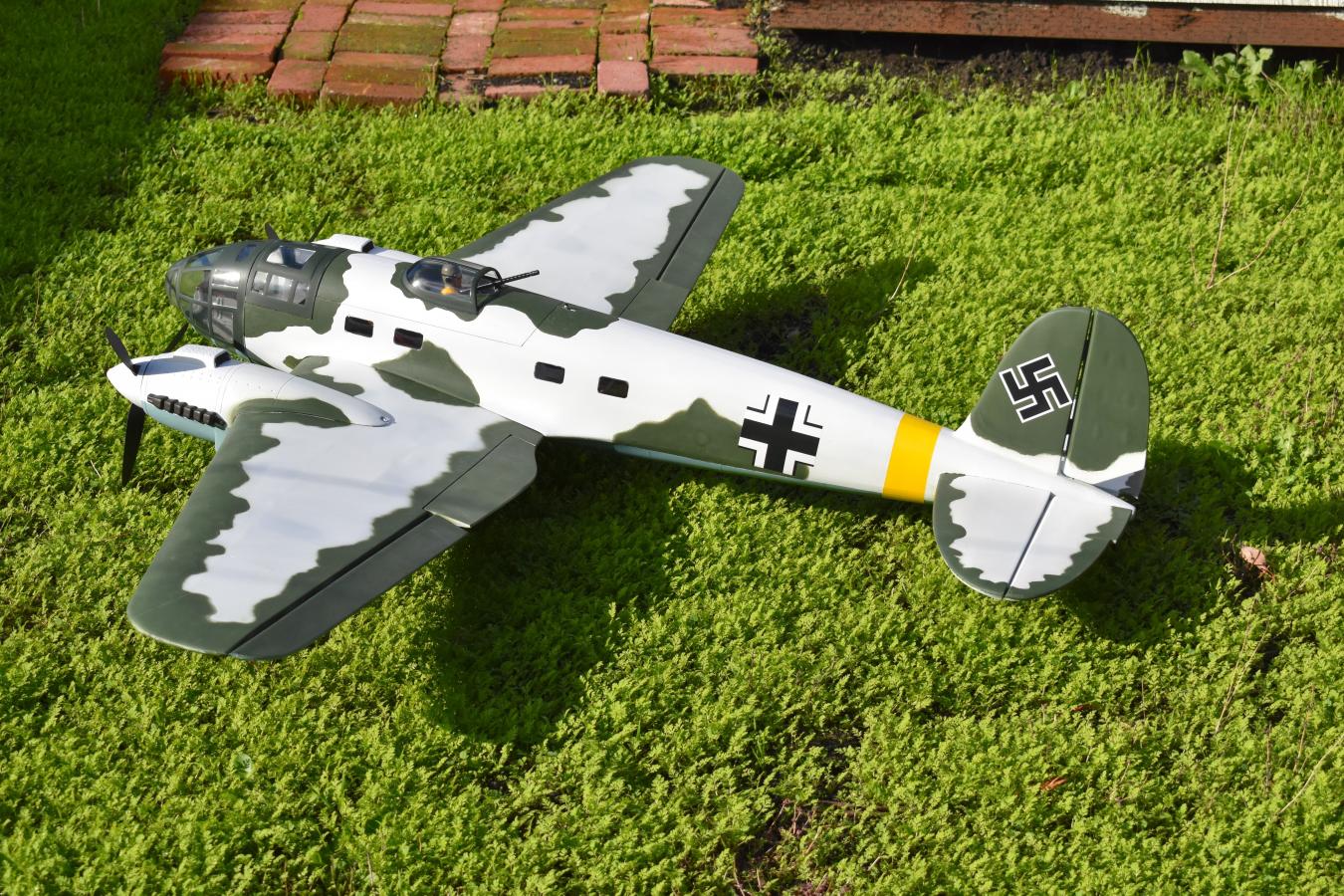

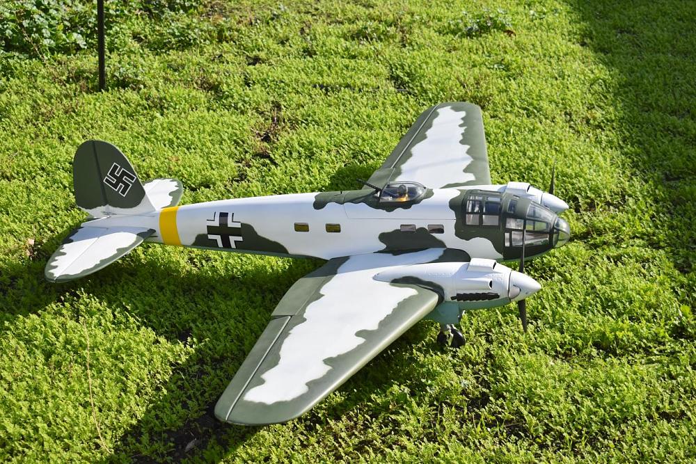

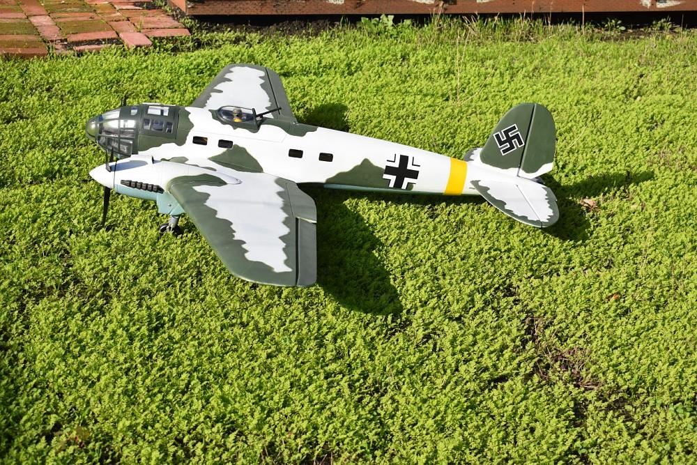

        I am nearly finished with my second He-111. I decided to make this one in winter Eastern front camouflage. I am sure it is not perfect but I had fun doing this one. I just need to get some re-sized decals for her wing.
        Bob

          #104
          That's a sweet look Bob
          • borntoolate
            Bomber Bob
            • Mar 2013
            • 424
            • California
            #105
            Thanks! She looks better from 10 feet away!
            Bob
              #106
              I like it a lot, Bob! Great job. When is the maiden of Heinkel 2?

                #107
                Hi Alpha, Thanks! Weather permitting, the maiden should be this week - probably Thursday. I love these Black Horse kits! Thanks for bringing them to us!

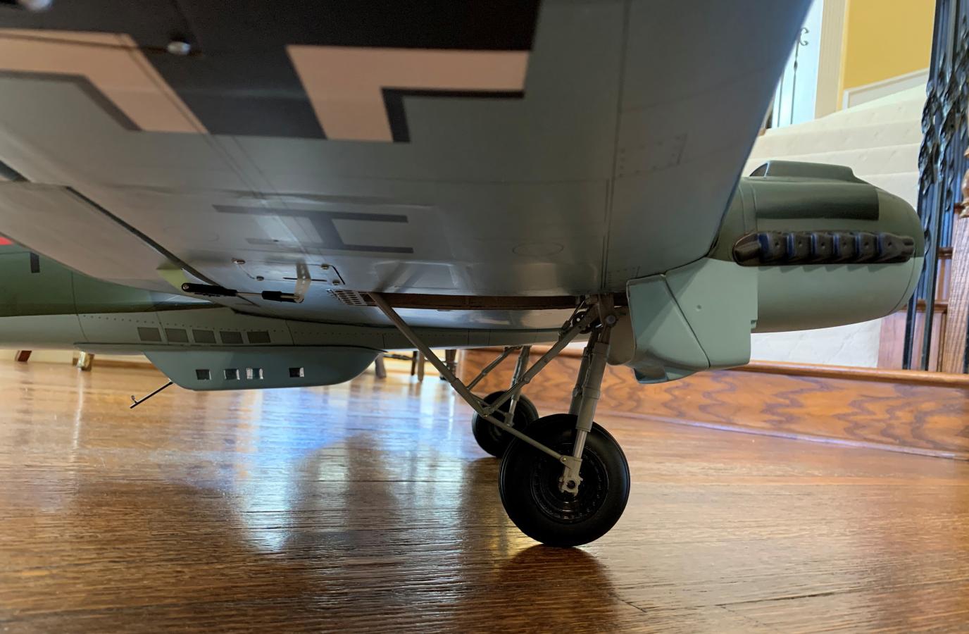

                  #108
                  With the main gear all figured out, time for the tail. Cutting up the factory rear wire provides all that's needed to put on a scale one. As with the mains, the tail wheel is way too small. Need to order the right size yet (1.5")

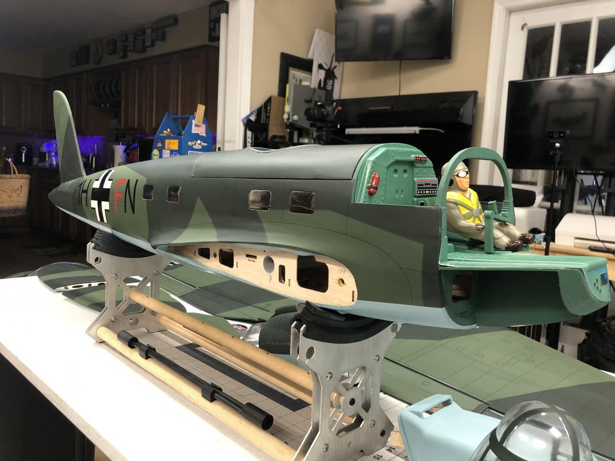

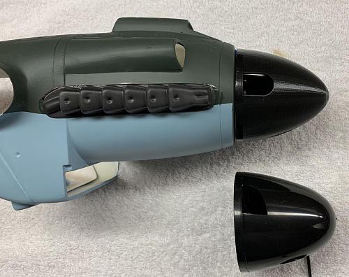

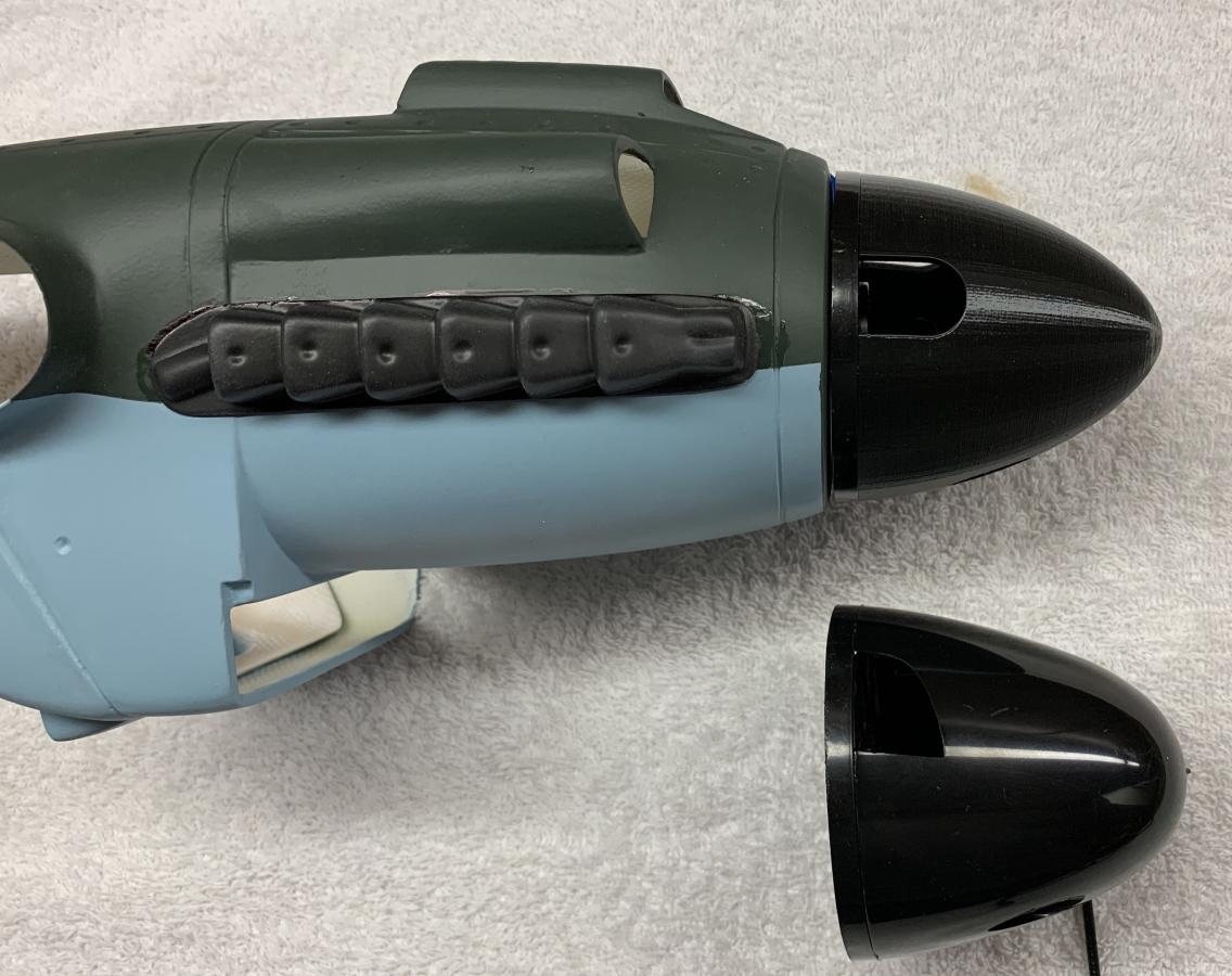

                      Gear is done and all the servos installed, first time on the full gear today (waiting on motors, props escs and batteries). In a rare event, I got my spinner design exactly right on the first print. Its for 3 blades, the profile is close to scale as I can get (the stock one is too bulbous) and still uses the stock back plate. The Gun emplacements are done using Tom Hunt's MG15 off Thingiverse, scaled to size then added ring sights and ball mounts where needed. I have a feeling that belly gun will be an early casualty! A scale control column is next. The exhaust bugs me, but I don't want to cut the fiberglass cowl apart.
                      I'm a little unclear on how to mount the nose glazing - there's no mounting tabs and it seems too small to fit over the nose section. How does this work?

                        #111
                        Originally posted by Spinnetti
                        Looks good Bob.. Latex for paint or?
                        Gear is done and all the servos installed, first time on the full gear today (waiting on motors, props esc and batteries). Printing a scale 3 blade spinner now using the stock back plate, and a scale control column is next. The Gun emplacements are done using Tom Hunt's MG15 off Thingiverse, scaled to size then added ring sights and ball mounts where needed.
                        I'm a little unclear on how to mount the nose glazing though - there's no mounting tabs and it seems too small to fit over the nose section. How does this work?
                        The white paint is Rustoleum flat white primer. The green and yellow are both latex paint from Home Depot. I really like the detail you are putting into yours! The nose glazing is pretty much a pressure fit. Mine is held on using the rubber-type cement that comes with lots of planes. it goes on pretty easily. Once I got it in place (with glue) I taped it down until cured.

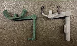

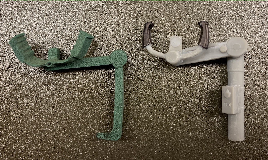

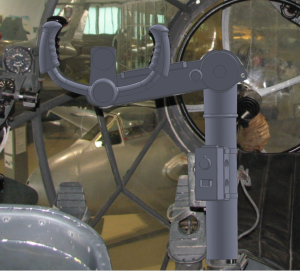

                          #112
                          Control column is up on Thingiverse if you want to give it a spin. Scale the STL at 130% to fit the tubby Budda pilot. https://www.thingiverse.com/thing:4180841
Name:	He-111 Column.jpg

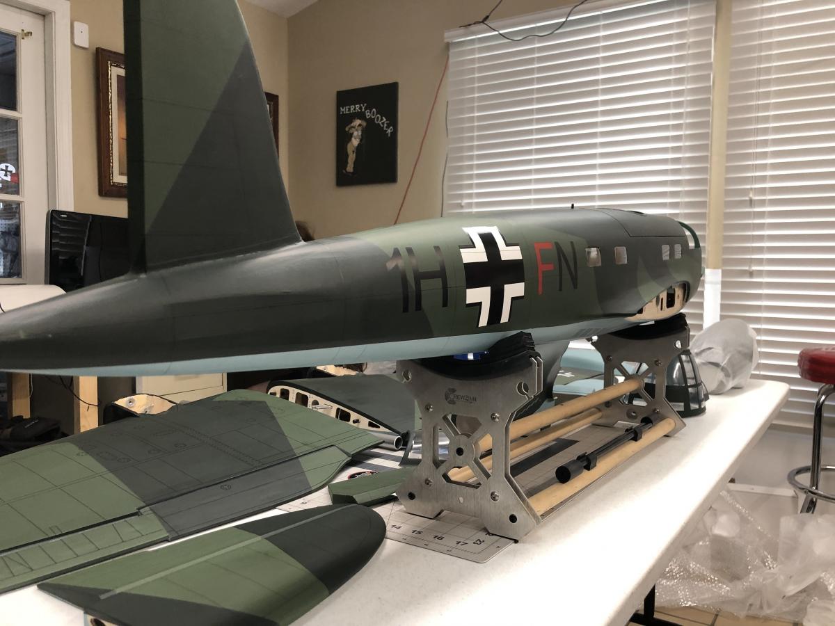

                            #113
                            Today my bomber bug is getting squished again. Was so excited to se the HE-111 come out from Motionrc. I’ve been eyeballing this kit for some time now and it’s finally time to make the dream a reality. It’s definitely a gorgeous model and I can’t wait to fly this at Nall this year. It’s absolutely beautiful as to be expected from a product found on Motionrc. I will start a build thread on this once I get going. Coming off the Nexa P-47 I can definitely see this ones going to take a little more time. Nothing bad just a little more to assemble on this model. Can’t wait to see this one in the air I’m sure it will be an absolute sweet heart.

                              #114
                              Stuff has been out of stock forever, but thinking about the following for power.. Thoughts? I want scale diameter 3 blade props, so everything has to work with those

                                        #119

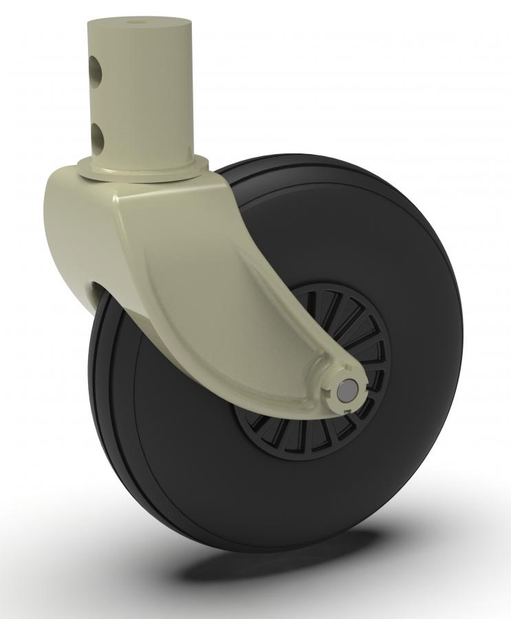

                                        I designed and 3d printed my own spinners so that's no issue, and of course designed my own landing gear which is all installed. Just need to install the power system, make scale gear doors and its ready to go.

                                          #120
                                          Excellent work creating the gear. You have some very good skills! The best I could do was to use the Freewing Mosquito gear.
