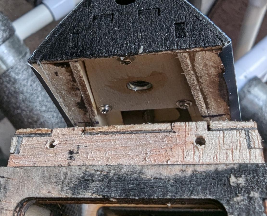

    OK, first up is my tailwheel: on full scale Corsairs the tailwheel does not retract completely, the wheel it self partially protrudes from the bottom of the fuselage. That said, I installed 2 nuts on the work drive which causes it to stop before going up all the way, pictures show it in both positions. It took a LOT of time and fine tuning to get it there, but worth it IMO

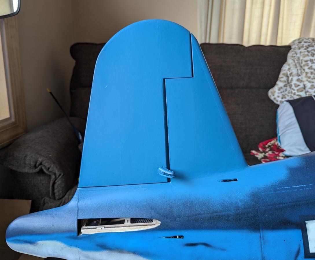

  • CorsairJock
    Since I had to re-cover the rudder, decided to re-cover the fin also, AFTER re-shaping it to a more accurate scale profile.
    Painted both with rattle can Rust-Oleum Ultra Matte Nantucket Blue.

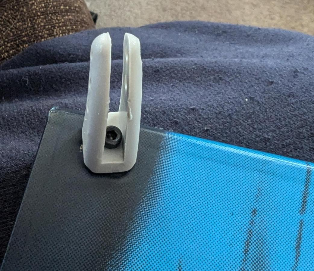

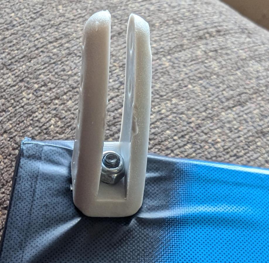

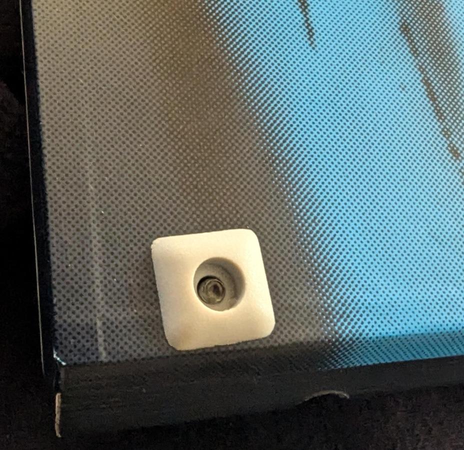

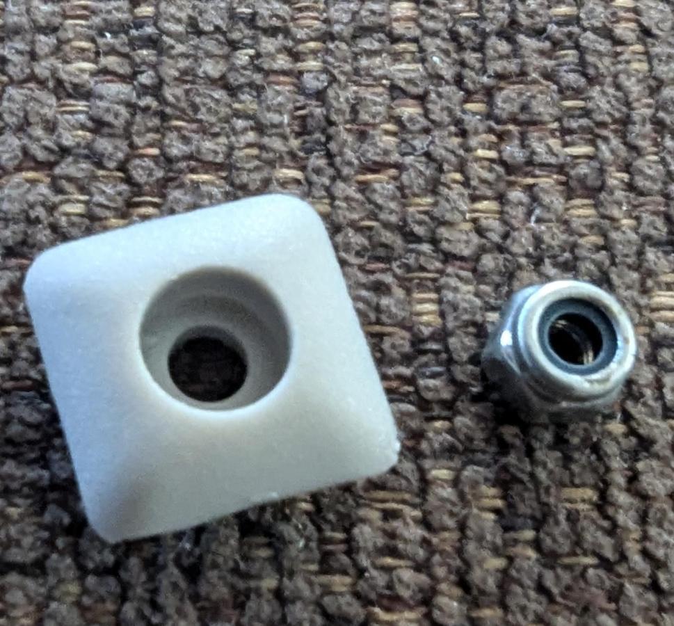

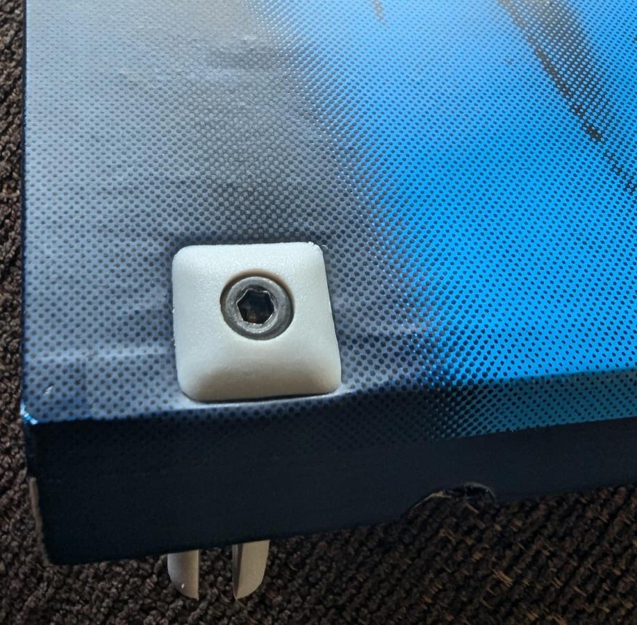

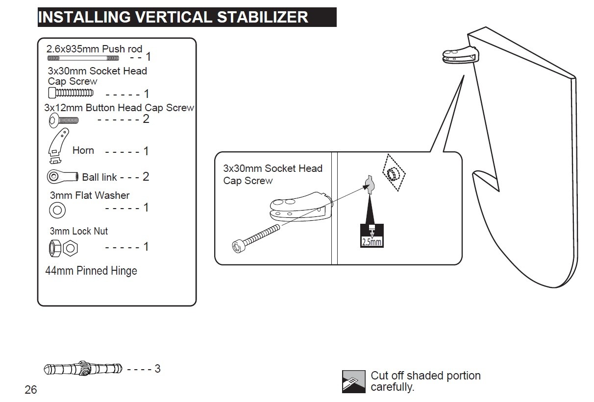

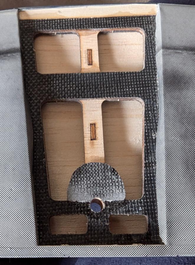

    BEWARE!!! ELEVATOR & RUDDER CONTROL HORN INSTRUCTIONS ARE WRONG!!!
    First pic is screen shot of how to attach control arm to the rudder. The diagram shows a M3 x 30 bolt being inserted into the control arm, and screwed into the rudder. Nothing more, thats it.
    SO, that's what I did, screwed into the rudder until it protruded out the other side, it wasn't getting any tighter and the control horn had obvious slop.
    Looking back at the instructions, I see a nylock nut mentioned, and altho it didn't mention the square piece with a hole in it: I assumed it should go on the other side where the bolt was sticking out, then the nut should be added.
    NO WAY that nut was going to fit into that hole in the square piece, and even if it did there would be no way to tighten it.
    SO, I reasoned the screw must go into the square piece, then thread into the control horn, THEN somehow thread the nut on.
    Well, that did the trick, only because I could not see the sides of the rudder, I didn't realize until too late that I was crushing and distorting the balsa. UHHHG! Now I am bummed, I figured the rudder was ruined, and being less that a week from completion and the weather up here turning colder, I need a new rudder NOW!
    Instead, I stripped the covering off, repaired and reinforced the damaged area, covered in some old flat gray MonoKote that I had, put everything back together the RIGHT way, and now ready to install after I throw a cote of paint on it. The paint doesn't match, but I eventually want to paint the whole thing anyway so that'll do for now.
    SO, in summary: the M3 x 30 bolt goes thru the square piece, then the rudder, then the control horn. Good luck adding a nut, I just added a regular M3 nut and put CA all over and around it, but the bolt threads nicely into the control horn anyway.
