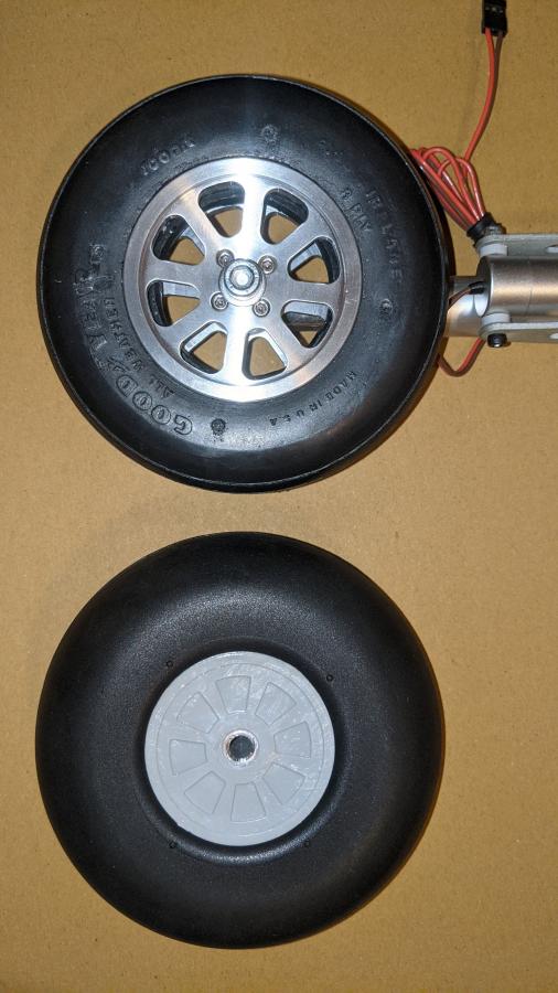

    Ordered my Black Horse Corsair today. I will put the larger wheels on and fab some main gear doors. I have a very nice UMS 75cc 5 cylinder radial that should fit just fine.

    What is the largest main wheels that anyone has put on their Black Horse Corsair? I want one of these planes but I just can't get past those tiny wheels.
    I'm using 5 inch Dubro treaded inflatables. Larger diameter will hit the retract motor housing. Plenty of room in the wheel well.

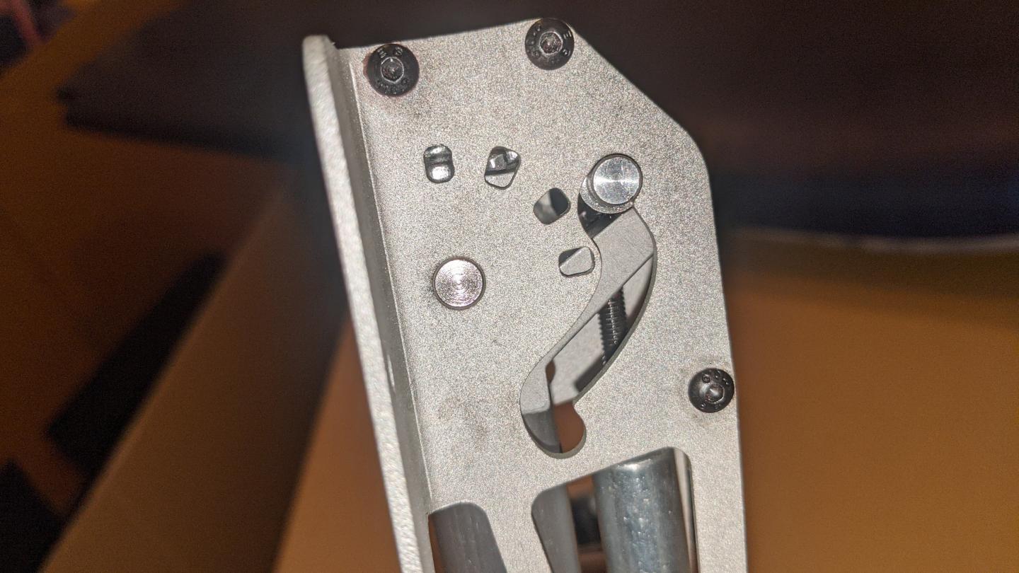

    I recently got this kit in the last shipment. The gear look different from what you describe in previous model versions. These have a gear cog engaged in sideplate to do the rotating action. The only thing is the wheels. First thing I'm changing. I got some Robart 4.5" 8 spoke aluminum mains......

    I have built three Blackhorse Corsairs over the years. Each one came with supposedly improved landing gear, but they were all useless.
    I have thought of building this new version, if the "new gear" is good. The company say it is completely re-designed, but then they said that before.
    Can anyone post their opinion on the new gear & perhaps some photos of the main gear, especially the method they use for twist & turn.
    The last version I bought, had a pin on the top of the strut, that slid in a curved groove causing the twisting motion. Sometimes they worked & sometimes not. The whole set up was full of sloppy play.
