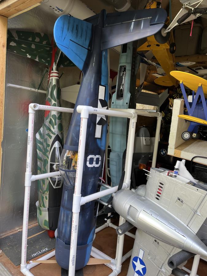

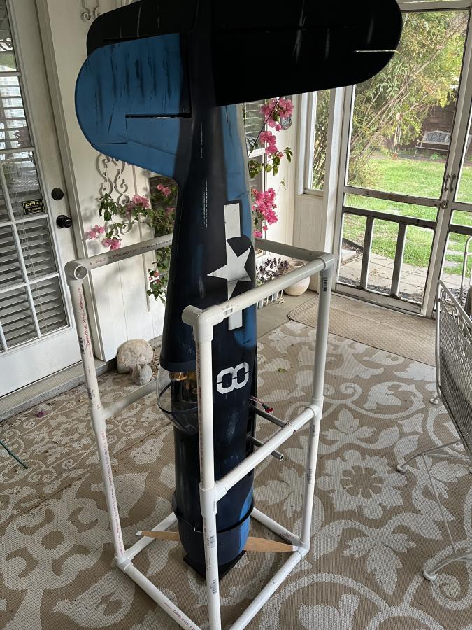

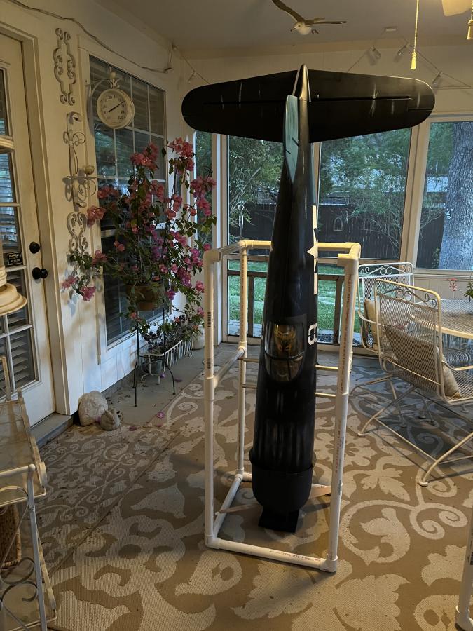

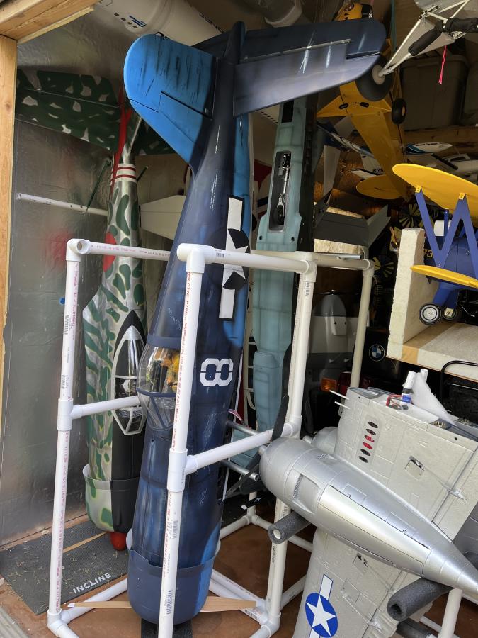

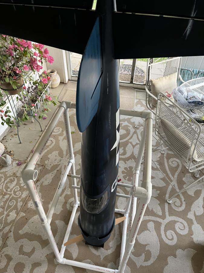

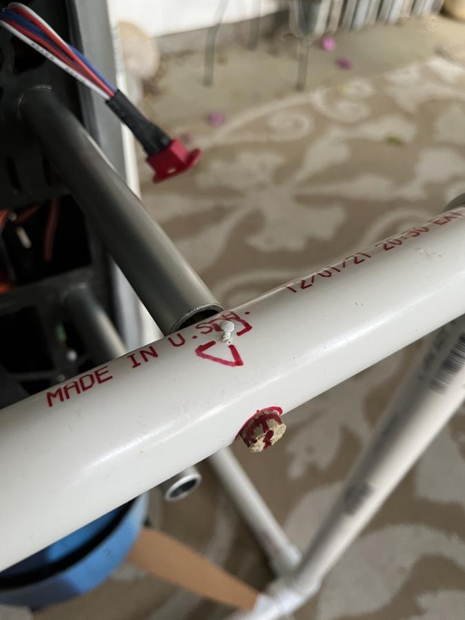

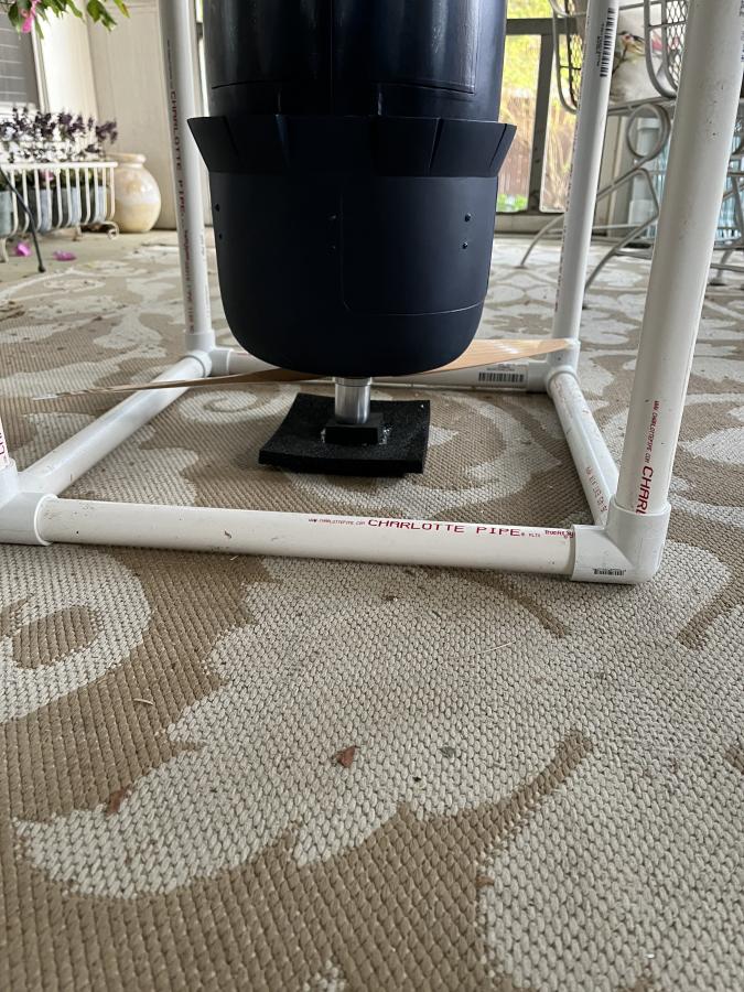

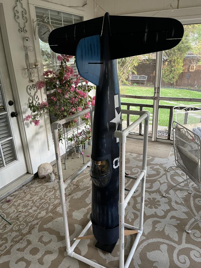

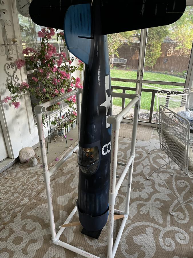

  • TwistedGrin
    Storage challenges.....PVC balance rack. Uses the wing spar tube as a balance catch, spinner resting on high density foam block. 1inch PVC with easy acces.....a wooden dowel goes through the wing tube and held captive in the PVC frame with a small wire nail. The frame is only meant to hold the model balanced while resting on the propnut. This is NOT for transport. Click image for larger version

  • TwistedGrin
    Ya - I followed your lead and measurement for a base line to confirm .....I too will fly about 6-7min per flight. Let the batteries, ESC and motor cool down between flights
    Had to triple check my numbers to cut the motor mount extensions right....after moving the cowling forward as desired....then find the blasted bolts with enought threads to work correctly. Lots of process there for a minimal task - LOL
    Looks good and proper.....now
    Thanks again for posting up !!
    TwistedGrin

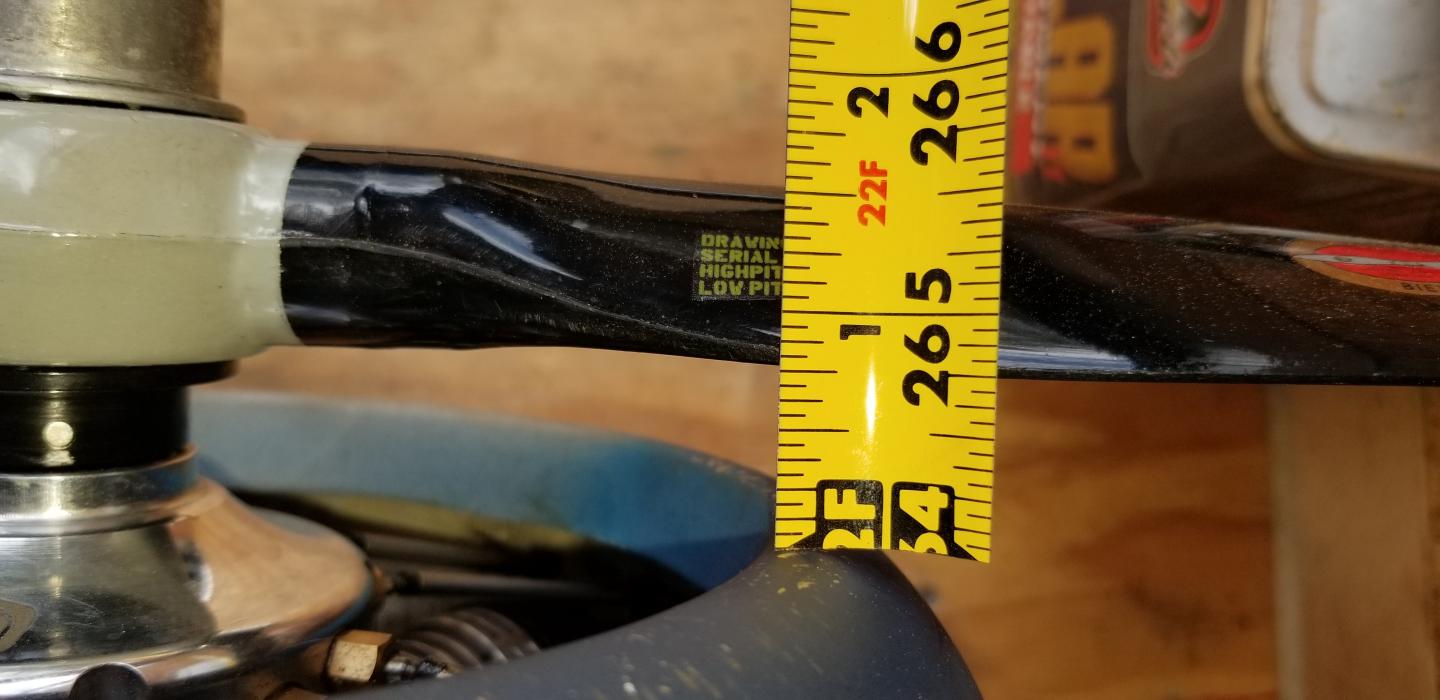

  • Rccen44
    Your cowl appears to be spaced about like mine. My gas radial does not get hot at all. Granted, I don't fly 15 minute flights, I tend to fly 5 or 6 minutes maximum.

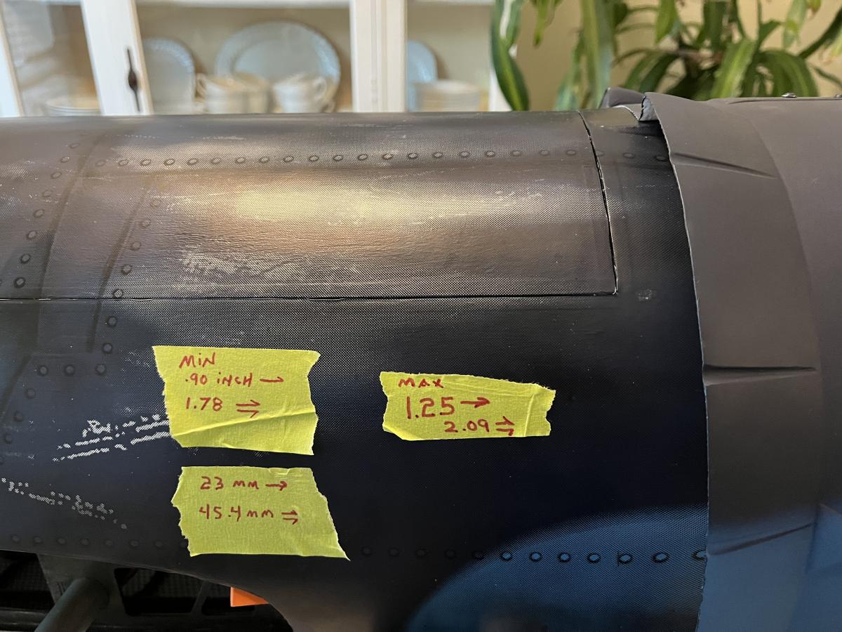

  • TwistedGrin
    OK ...measure 10times at midnight and 10times again at 10:00am then drill....then go find new bolts with long enough threads and new blind nuts to match the bolts.
    Thank goodness for the local farm implement hardware feed store...both Lowes and HomeDepot failed me....had to change out from metric to SAE and from fine thread to corse thread.....but I got it done without chewing up the internal plastic cowl mounts.
    I don't have enough motor clearance to have the prop very far out from the cowling face as this 60cc electric motor will grind on the faux motor backside.... the new cowling spacing is matched again with the motor prop offset.
    I do like the space that is now open to pull some airflow.....good as can be for the Texas triple digit dawg days of summer now
    I chose to fill in the original cowl mounting holes with flathead screws backed with popcicle stick wood on the inside to help hold them in.
    All that I need now is for the prop nut to arrive and then triple check the CG.....wondering if I will see any difference with the motor forward about an inch

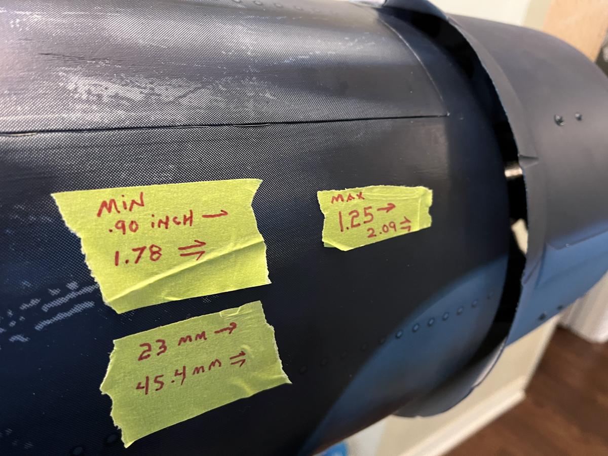

  • TwistedGrin

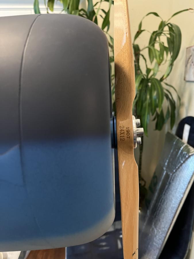

    10:4 Thanks for these photos and measurments RCCN44......
    I removed my prop...pulled the cowling forward .23mm/.9inch and I like the gap spacing much better...looks like some air can now pass through. Your prop clearance is very close to what mine will be if I move everything forward. I am making plans to make this adjustment. Hate to drill new holes in the cowling...but can probably hide the original holes with filler and paint.
    I feel a little "short" for not realizing this during my initial set up....would rather fly cool than not...so the adjustment is justified.
    Thanks again sir!

  • Rccen44
    My cowl is an inch from the hatch and my prop has about 3/4 of an inch clearance between it and the cowl.
    Corsairs always seem to have a lot of prop to cowl clearance.

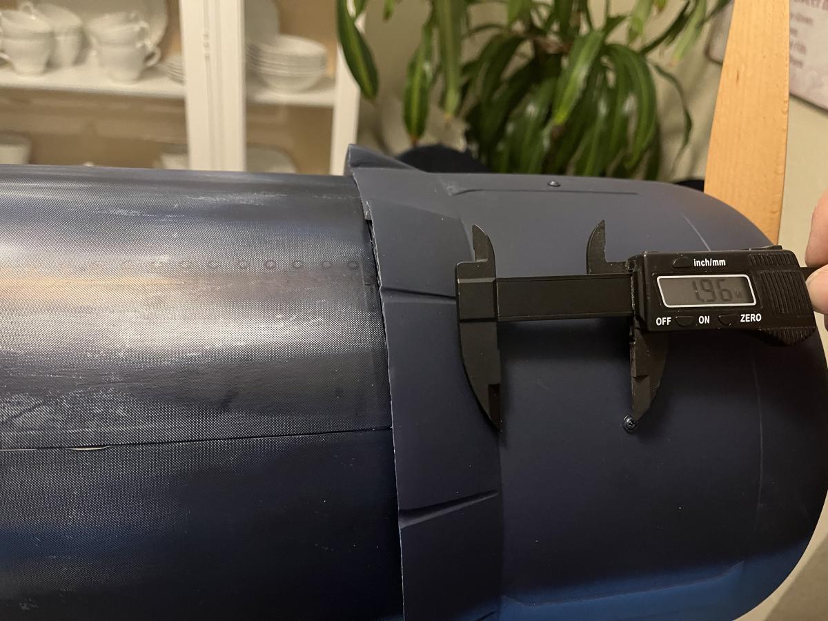

    I just discovered that I have my motor or Prop set up a little shorter to most photos I see. The GP60-180KV motor is pretty long....too long for the motor and the larger motor box supplied with the kit.....therefore I had to use the shorter motor box mount and cut my own motor mount extensions.....I could have made my motor mount extensions a little longer perhaps. My cowling is dead even with the front of the forward hatch line....so I figure I am set back a little shorter most perhaps!
    Looks like I can go about 1.96inches further out perphaps by cuttting some longer motor mount extensions
    Not sure if this will affect flight performance or not
