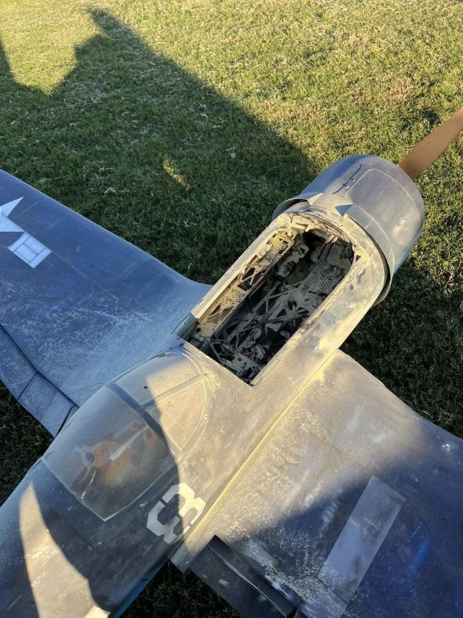

    Quite the story, and pretty impressive handling!
    I'm amazed about the fire extinguisher, though. AFAIK, Lipo fires are chemical fires, meaning they don't need oxygen to continue burning. I'm trying to understand how you were able to extinguish them.
    Anyway, I'm really glad and happy for you that the plane wasn't destroyed with such a serious mishap!

    Good work getting it down in one piece with an inflight fire(s) going on!! Hopefully you can get it all sorted out and fly it again.
    I've had a couple of battery fires, one was at home on the charger when I was away on an errand and my wife was home. I think the smoke alarm in my shop downstairs came on and she put it out with a ABC rated fire extinguisher that was nearby. No damage, other than to the battery, which was destroyed. After that, I usually hang around nearby while I'm charging batteries.
    Another time I think I had some plane, maybe a 1400mm P-51 or something, and just as I plugged it in as I had 100 times before, a fire broke out and a jet of flame went right through the side of the fuselage but somehow I was able to get the fire out. I don't think I flew the plane again, although it was probably fixable, with a lot of work. These batteries can and do misbehave sometimes!
    Best of luck getting your Corsair flying again.

    Well I am sure glad to hear it wasn't a total loss! Good on you for bringing her down successfully and for the club to have the appropriate safety tools necessary to extinguish the fire!
    Love your ideas for her new name, lol. And I gotta say, looks like you have some new very convincing weathering!

    My beloved BH Corsair suffered a LiPo fire while in flight.....as I noticed a smoke trail I was able to shout to my fellow pilots to get ready for a ground fire, put it into an immelman and come around for a perfect soft landing.....as I was able to rush out and remove the battery hatch as flames instantly roared out.....we used up an entire fire extinguisher in short blast each time the (4) batteries flamed up. The battery hatch is pretty well cooked and all of the electronics (wiring) of the surrounding area where the batteries were fastened down are melted...but the fuselage itself is unharmed....stinky and messy but with clean up...totally repairable. I have ordered all new electronics for the refurb...this bird is flyable with repairs.
    While the cause of the fire will never be known....the Lipo and LIFE batteries all caught on fire....had our club not had fire extinguishers and easily accessible from multiple locations my Corsair would have certainly been incinerated for a total loss
    This airframe will fly again peraps under a appropriate Callie Grahics name such as: Stinky; Smokey; Fire Ball, Char Broiled, Blazing 8, Smoking 8 - etc etc
    I plan on stepping down the prop from an XOAR 24x14 to an APC 24x12 ...this will reduce the Amp load and speed by maybe 5mph according to eCalc....but I have real time observance the APC prop can increase speed without increasing the Amp loads....
    Here is a photo of the plane on the runway maments after we had deployed the fire extinguisher to the batteries and flung them out of the battery tray....by the time we were able to snag them out of the airframe they were already cooked off though

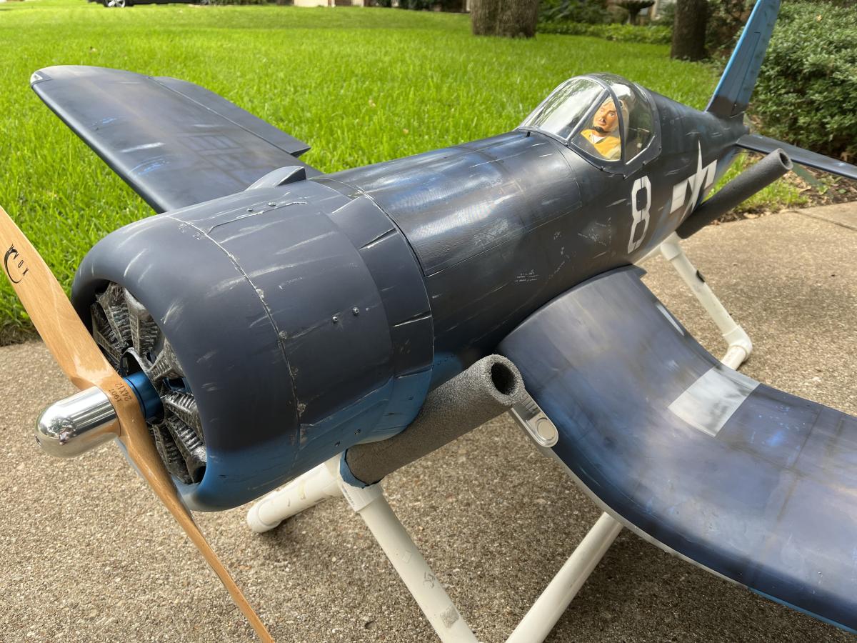

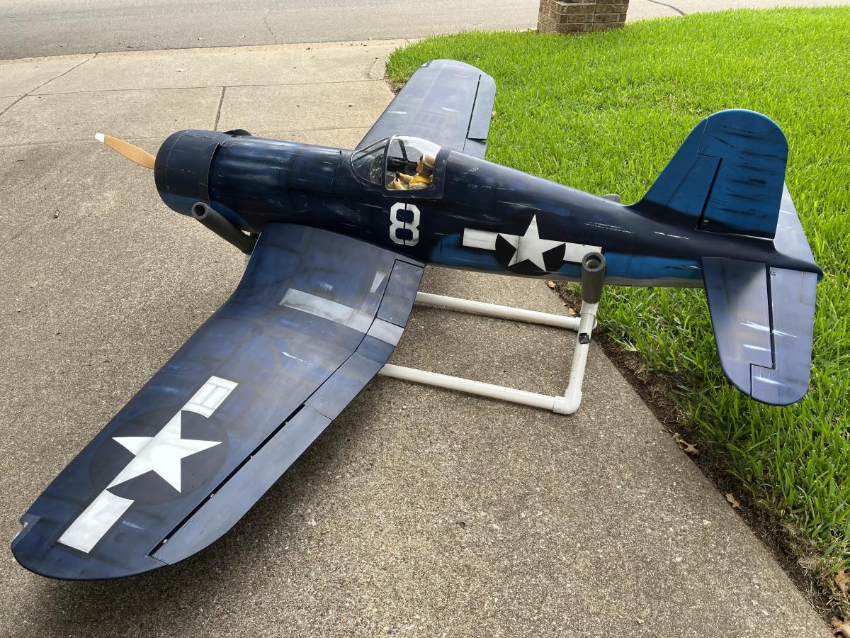

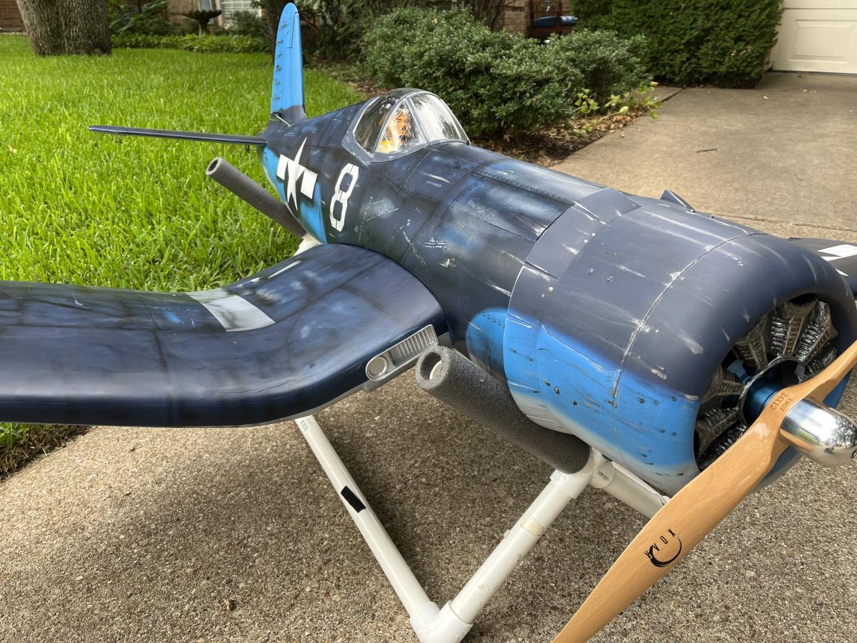

ID:	353763 Now that I have 6flights on this airframe with my Electric set up.......can honestly report it is a supurb flying aircraft. Probably due to the power to weight ratio (270Watts per Pound) and acceptible wing load factor. This power package puts the wing fully loaded for flight in just a few feet... withouth penalty. In fact you have to concentrate to take off slowly and looong for scale appearence - otherwise it's fully on the wing like a smaller high wing airframe. Once in the air.....the covering does not matter....in fact it looks excellent. The bottom weathering along with the color contrast is spot on. My BH F4U is flying true and straight as an arrow....the only trim I needed was a couple clicks of up trim with the elevators assembled and set absolute zero deflection. There is no tendency to roll or pitch or dive. The flaps slow this aircraft down to a crawl and landings are effortlessly smooth and consistant. However.....the motors of the stock (Phoenix) retracts are weak, the actual struts and carrier metal is just fine. I replaced the stock retracts with the $525.00 Robart Electric 14E-108 full retract assembies which took minimal effort to retrofit into the wings and work very nice.....however even with perfect level smooth greased in slow speed landings one of the Robart Electric Motor actuators stripped....the motor spins just fine but an interal gear is stripped. Robart has this as a replacement part available in stock so this will be an easy repair swap.
    I was and perhaps still am a little skeptical about the fiberglass sandwhich plywood webbed support frame as it looks and feels ....crispy.....fragile. I think the only balsa could be the wing sheeting. Wheras other WarBird giants I fly are much heavier using standard plywood balsa construction which looks and feels like they could suffer much more abuse. However the BH airframe is light and stiff with the gull wing dual wing tube designed to handle normal stress loads.....so far. The wing saddle cross support structure just appears to be fragile - but then again the dual wing tubes may be preventing force loads from translating to that cross section.
    I will state since the model flies so well...any percieved detratction of the printed covering for me is a non-issue. I simply weathered the nose cowling a little and it brought the entire airframe into a different perspective. I used a silver paint pen to rub on some contrasting weathering effect to the fuselage as well and it took without issue. This leads me to beleive a little bit of sanding and the entire airframe could painted over. However after just weathering the cowling I don't see the need. In fact the airframe was well received by my clubs master builders stating the flight performance and the airframe itself is impressive.
    I also fly the Hanger 9 86inch wingspan Ki-43 Oscar with the same power plant....this BH F4U Corsair is on par if not more nimble than the Ki-43. Both are truely amazing performing airframes....only one is available for purchase at this time.
    You can doll up a poor flying airframe and dread flying it or you can doll up a great flying airframe and love flying it....if you don't like the pre-printed covering on this model it is well worth the effort to doll it up to your satisfaction.
    It does not have the gear doors for the mains nor a bomb drop or canopy pull....however for those that obsess with master building....this should be an airframe that could be infinately modified.
    I think BH added some washout to the wing tips and maybe added some beef to the vertical stabilizer....I challenge anyone to actually prove it against 100% scale. My point is Black Horse has delivered a true performance flier and not a hanger queen.....this is what I tend to enjoy rather than hesitating to fly a high percentage scale model that is a brick to fly.
    My2Cents and observation

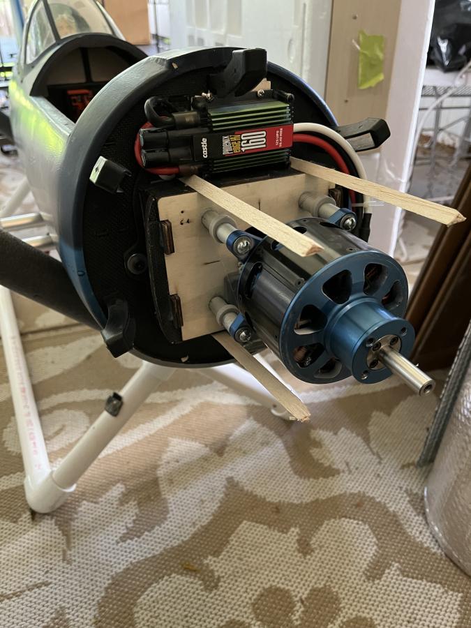

    This is my power train.... respectible speed and sound, gobbs of power and more to spare.
    22lbs flying weight
    6134 Watt power
    270Watt per pound
    Wing Loading 38.3/oz/sqft
    RC Juice / HobbyStar dual 6s (12S) 8000mAh 100c LiPo (891grams each)
    Agressive throttle with 82mph highspeed passes 5.30min - Landing at Battery at or near 3.77v per cell
    Scale cruising throttle with mixed aerobatics 6.30min - Landing at Battery at or near 3.77v per cell
    ZYHobby 1.75inch 44.5mm Two Blade Spinner assembly drilled for DLE30/55 (TrueTurn is no longer in business)
    https://zyhobby.com/products/175inch...mld35-us-stock
    24x12XOAR Prop
    Admiral GP60-180Kv Motor
    Castle 160amp ESC
    Dual 6s 100C 8000mAh LiPo (12S)
    3200mAh Life receiver battery
    2200mAh LiPo retract battery
    Robart Electric 14E series 90 degree rotating rectracts with controller board and wire extensions
    Stock Wheels
    Auroa 8 Stabilizer
    Spektrum DX8 Gen2 Transmitter
    TwistedGrin
