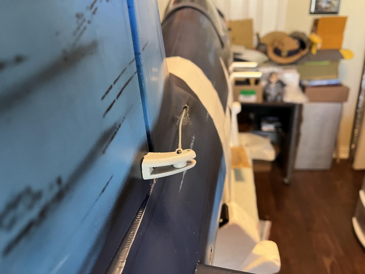

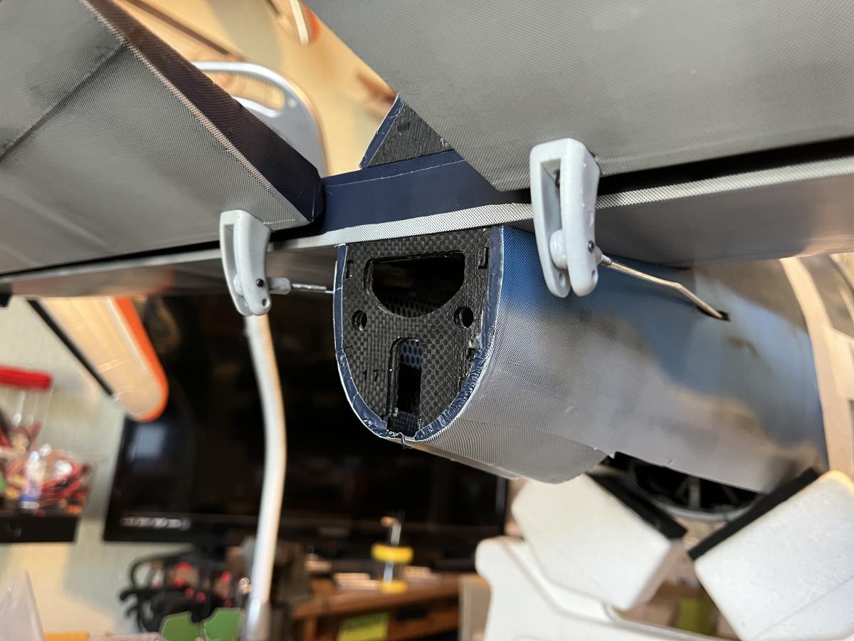

        Ran into the first snag tonight...the tail wheel will not screw the second phase rotation to bring the assembly all the way back in....it stops at the 50% rotation. The motor will wind all the way down...but the mechanism has a secondary screw that is meant to extend the motion.....it extends OK but jams on the way back in...thus it only retracts 50%.
        If you refer to the assembly manual where is shows the tailwheel break out....you will see TWO shaded screws....the smaller srews in and out of the larger, the larger then pulls both into the larger housing....this is where the system falis...the secondary large screw
        I dinked around with it for about three hours to understand it and find out out to release it.....if you take the worm gear off of the retract and turn it....it releases and will work once or twice then hang up again.
        This is not a motor issue as it continues to work in both directions ...it's only the secondary screw that goes 100% down but fails to allow the retract complete the second 50% into of the up cycle.
        FAIL FAIL rrrRAtts
        Will just unplug it and fly with the tail wheel down..... doors open.
        Suggest you run the tail wheel retract on the bench and understand it first before deploying....once you get the pull pull wires attached you can no longer remove it without snipping those pull pull wires. There is enough slack to unbolt the tail wheel assembly and pull it back enough to at least dink with it.....but not much else.

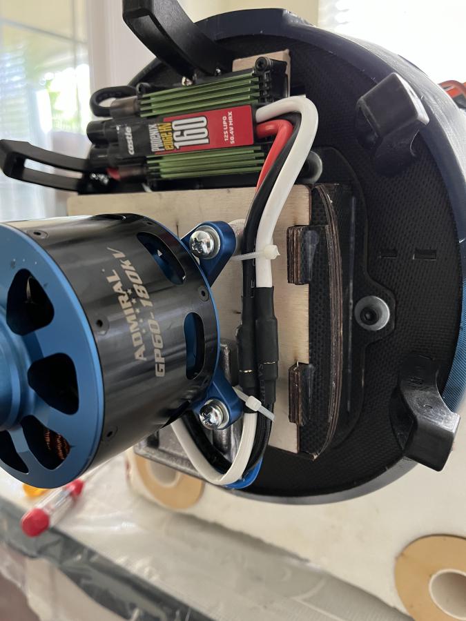

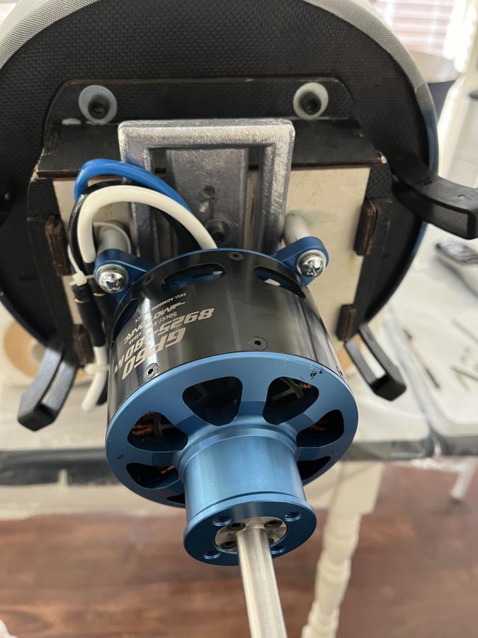

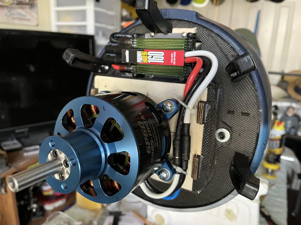

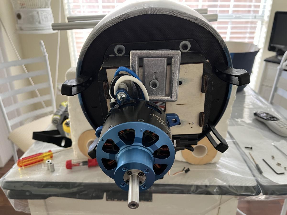

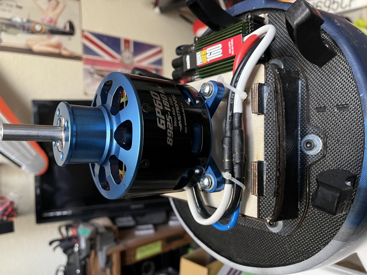

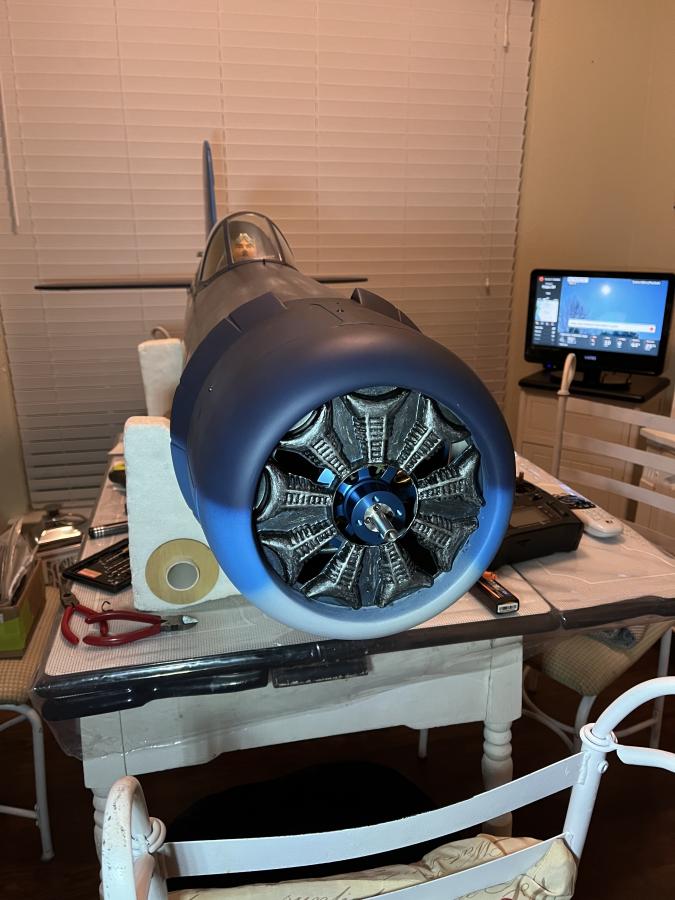

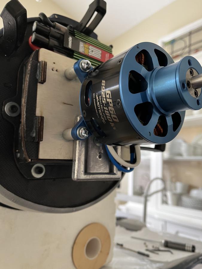

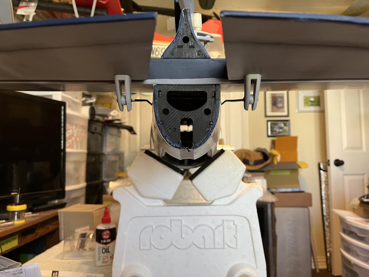

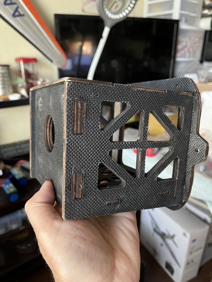

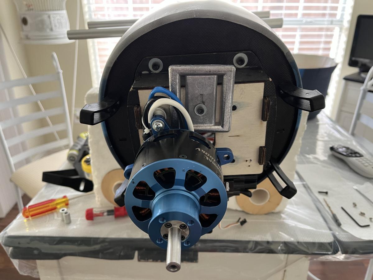

            Click image for larger version  Name:	IMG_0064.JPG Views:	0 Size:	118.2 KB ID:	342521Click image for larger version  Name:	IMG_0064.JPG Views:	0 Size:	118.2 KB ID:	342531Click image for larger version  Name:	IMG_0073.JPG Views:	0 Size:	95.3 KB ID:	342522Click image for larger version  Name:	IMG_0071.JPG Views:	0 Size:	80.2 KB ID:	342523Click image for larger version  Name:	IMG_0068.JPG Views:	0 Size:	137.2 KB ID:	342524Click image for larger version  Name:	IMG_0070.JPG Views:	0 Size:	101.3 KB ID:	342525Click image for larger version  Name:	IMG_0067.JPG Views:	0 Size:	62.3 KB ID:	342526Click image for larger version  Name:	IMG_0069.JPG Views:	0 Size:	114.0 KB ID:	342529Click image for larger version  Name:	IMG_0072.JPG Views:	0 Size:	113.3 KB ID:	342530Click image for larger version  Name:	IMG_0069.JPG Views:	0 Size:	114.0 KB ID:	342532Click image for larger version  Name:	IMG_0071.JPG Views:	0 Size:	80.2 KB ID:	34253304-11-22Continuing progress this week end....about another 10hrs for me working on this ARF. I had chosen the larger motor mount basket for the Admiral GP-60 8925-180KV motor without being able to mock up the motor to the plane and fit up the cowling. Once deployed the motor was way past the cowling....so had to remove and deploy the "Short Box - Motor mount" ...the 60cc plywood alignment board is another inventive by BlackHorse....it fits in one way only and is foolproof for drilling the motor mount holes. Once again the alignment of for the motor mount holes is spot on....however the motor now needs shims in order to space correctly for the cowling. I used the washers to help measure the proper spacing...then translated that spacing to cut four extensions out of the supplied aluminum spacers. My spacers were final cut at 21.8mm Each for proper fitment of the motor spacing.
            Bear in mind these spacers look to be supplied for the electric motor mount as noted at Motion RC for the electric conversion. I profer that flat round cut plywood peice is meant to be used with the aluminum extension spacers of the electric conversion.
            Also in this motor mount effort the supplied 5mm bolts are too long for the motor mounting .....so a trip to Lowes and Home Depot found #5mm bolt 40mm long phillips bolts would work.

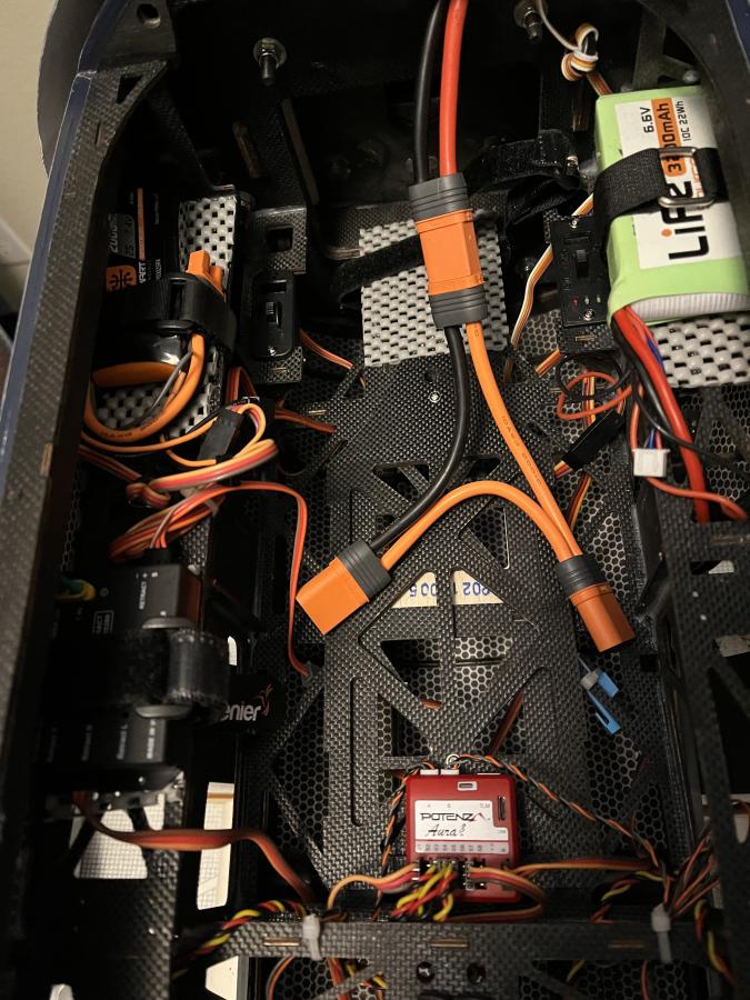

            After the motor box and motor assembly was completed I mounting the Castle Creation 160amp ESC to the top of the motor box ....was ready for CG measurment with the supplied hardware.
            I was betting on needing extra weight to the nose even with the two 6s 8000mAh Lipo, 2s 3200mAh LIFE receiver battery and 2s 2200mAh LiPo for the electric retracts all up front mounted on the top side railings of the interior fueselages shelfs.....true and similar to other ARF's this size using the same exact power package....I found the CG was level with a 1lb diver belt weight placed on the nose. I mounted the diver weight between the motor and motor box inbetween the exension spacers.
            The motor itself looks to be lower than center of the cowling....so take extra hours time to triple double dawg check your cowling placement with the fuax motor pre-cut and in place to validate ...then use a propeller to make the final placement setting for drilling your cowling to final. There is a built in motor offset pre-manufactured into the motor box.

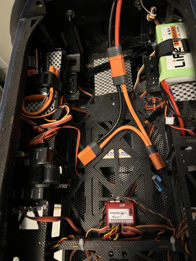

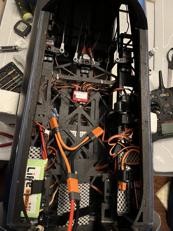

            The next step for me was then to start finding ways to mount all the electronics....I chose to glue down non slip perforated and use velcro straps to fasten the reciever battery, rectract battery and retract controller to the upper deck as far forward as possible. My receiver (Aura 8) is mounted to the battery deck just forward of the leading wing spar tube. (Note: I hard screwed on the removable plate to the battery tray for added support to that deck. I chose to mount my electronics battery and retract battery to separate isolated switch for easy On/Off at the field using the two lower servo slots at the in the front of the fuselage.
            I chose to mount my Spektrum antennae in the cockpit to help prevent any signal loss of all the Carbon Fiber in this model.....I can't for proof tell if the re-inforced plywood inter decking and skeleton is just fiberglass or Carbon Fiber....therefore I chose to screw on my Canopy instead of gluing in case I need to remove it for repairs or radio work.

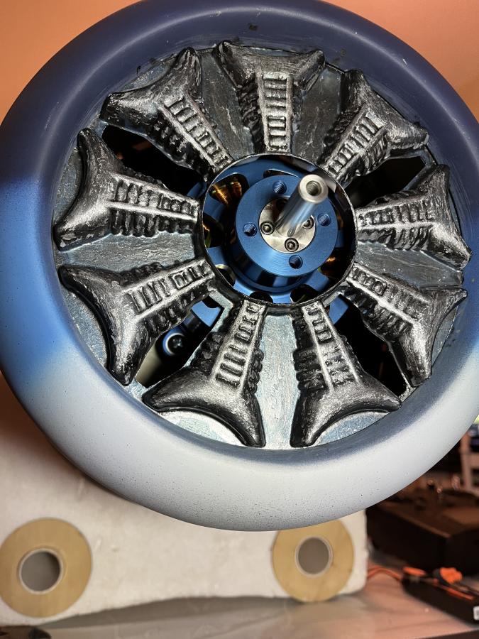

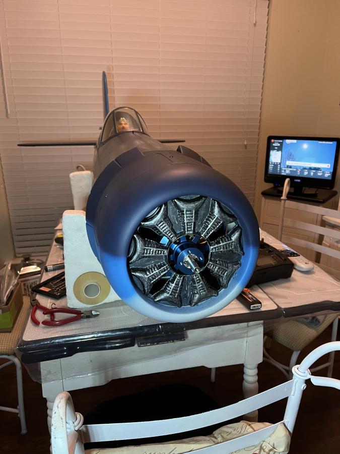

            I did paint up my faux motor front and cut out four slots for cooling effort....(NOTE: there will be minimal cooling to the nose of this aircraft as there is extremely limited passage for airflow if any at all.
            I found the skeleton frame work provides ample scenario to attach servo leads, antennae wiring etc etc....however please note the Fiberglass re-inforced skeleton are razor sharp edges so take extra care pulling and arranging all of your wiring detail.
            I still have the wings to finish deploying wingtip LED and bolting or gluing in the wheel wells.
            The assembly continues this week...very close to finishing with the last step drilling out the propeller and balancing....then setting up the control surfaces for travel and rates.

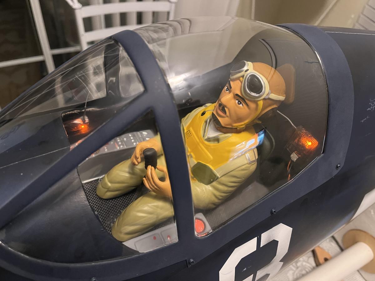

                I have 4 satelite recievers mounted in my Corsair. One is on inside, opposite side of the instrument panel. One is half way from the cockpit to the tail mounted on the side of the fuselage. One is mounted right beside the tail retract. Last one is mounted on the floor of the fuselage under the fuel tank, batteries, servos, electronic ignition box, and sitting beside the electric fuel pump. Obviously you shouldn't put a reciever where I put the last one. I have telemetry and after a flight I usually have 2 or 3 hundred fades on the poorly located reciever but only 1 or 2 on any of the other ones.
                Marine and aviation nav lights are oriented the same. Red on the left. Green on the right while you are sitting in the cockpit.

                  I am now working on cleaning up my interior wiring....placed the wings all the way in and fired all electronics in last night. All good and stabilizer is working as desired. I need to drill and balance a prop...set my throws and get primed for the maiden.
                  I'll have photos of my electric gear box controller mounting....and bottom wing shots as I decided to screw in my wheel well tubs instead of gluing. I found it much easier to make landing gear repairs if the wheel tubs are removable on the BH Dornier 335

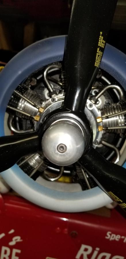

                        I am at 1100 feet above sealevel. The flaps slow it down nicely, just keep a little power on and fly it all the way to to ground. It lands easier than most warbird type planes. No tendency to nose over at all. Yours is lighter than mine, so it may want to float a little on you.
                        The prop is a 22 x 12 Biela scale-ish propeller. They do look good on the front of the Corsair. Click image for larger version  Name:	20211002_151048.jpg Views:	0 Size:	45.3 KB ID:	342680
