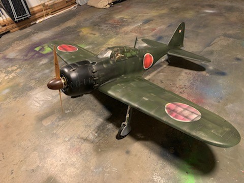

    I am not anti weathering just the way it was executed.
    I am hack, I am not saying that I am good at it but I follow the plastic guys and you can see from that hobby heavy weathering done in a very realistic manner.
    This is my Phoneix Corsair ( 70” Version ) and my CMP Giant Zero, the Zero was on the edge of over weathering so it had to be toned down.

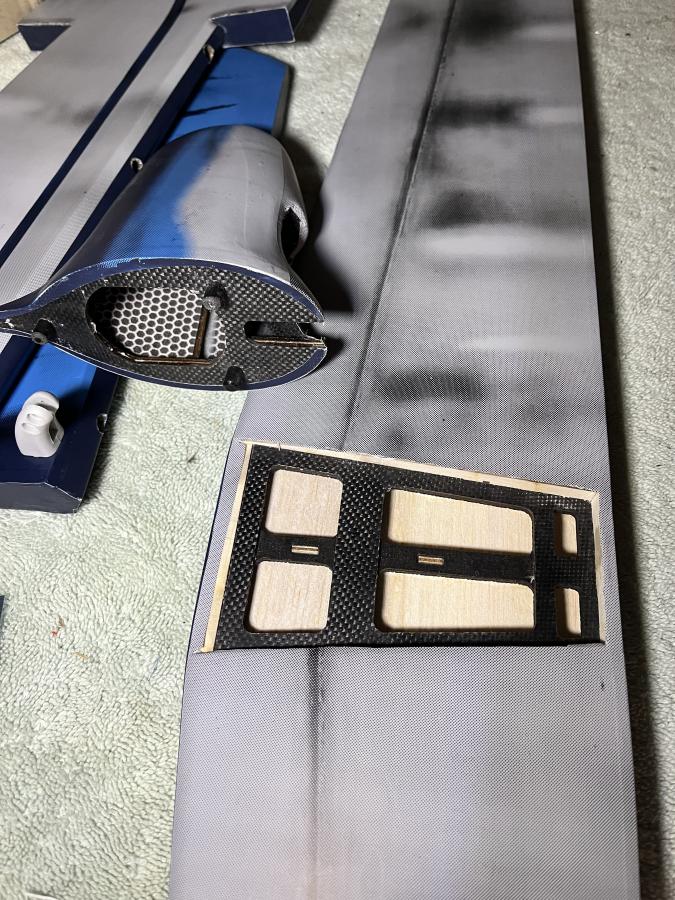

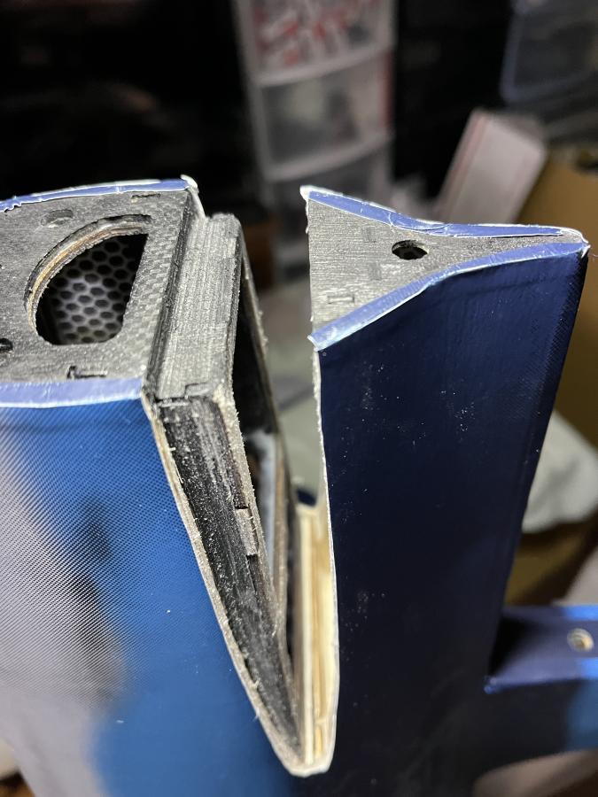

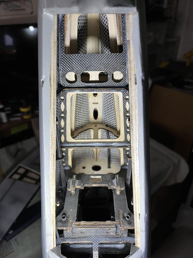

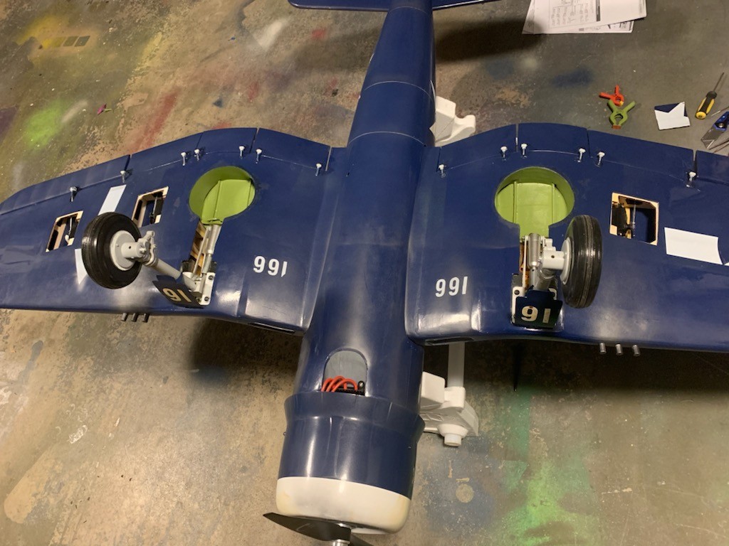

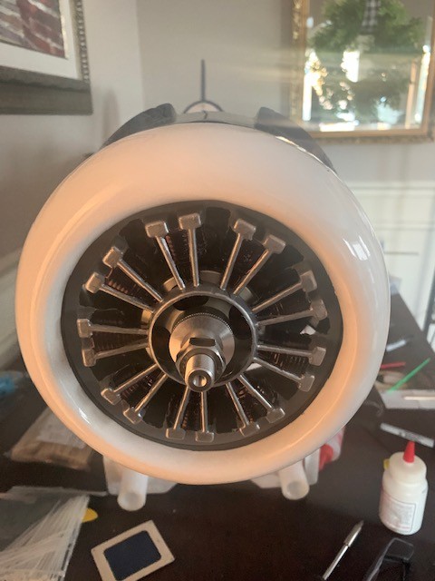

              It looks like the covering is actually adhered to a fiberglass or resin type sheeting material on the fuselage....balsa sheeting on the wing surfaces .......the covering is not adheared to a skeleton framwork on any part of the airframe.
              The fiberglass/resin sheeting is printed "Honeycomb" on the underside.....covered by the pre-printed vinyl type material on the outside.
              I guess this new airframe is truely a "Composit" build.
              Hopfully these photo's might illustrate

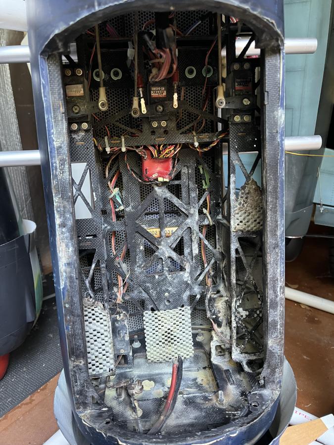

                        Folks - I have to say this bird is one of the best flying giants I have ever seen or flown......I put it up there with the Hanger 9 88inch Ki-43 Oscar......although I deployed the same exact set up in the BH Corsair as I did with the Hanger 9 Oscar....the BH Corsair has more drag so the flight times are shorter - although it is much more nimble and lands so softly. Love it. It is simply a monster in flight and super smooth...silky smooth.
                        My beloved BH Corsair suffered a LiPo fire while in flight.....as I noticed a smoke trail I was able to shout to my fellow pilots to get ready for a ground fire, put it into an immelman and come around for a perfect soft landing.....as I was able to rush out and remove the battery hatch as flames instantly roared out.....we used up an entire fire extinguisher in short blast each time the (4) batteries flamed up. The battery hatch is pretty well cooked and all of the electronics (wiring) of the surrounding area where the batteries were fastened down are melted...but the fuselage itself is unharmed....stinky and messy but with clean up...totally repairable. I have ordered all new electronics for the refurb...this bird is flyable with repairs.
                        While the cause of the fire will never be known....the Lipo and LIFE batteries all caught on fire....had our club not had fire extinguishers and easily accessible from multiple locations my Corsair would have certainly been incinerated for a total loss
                        This airframe will fly again peraps under a appropriate Callie Grahics name such as: Stinky; Smokey; Fire Ball, Char Broiled, Blazing 8, Smoking 8 - etc etc
                        I plan on stepping down the prop from an XOAR 24x14 to an APC 24x12 ...this will reduce the Amp load and speed by maybe 5mph according to eCalc....but I have real time observance the APC prop can increase speed without increasing the Amp loads....
                        Here is a photo of the plane on the runway maments after we had deployed the fire extinguisher to the batteries and flung them out of the battery tray....by the time we were able to snag them out of the airframe they were already cooked off though
                        Here is a video of the plane two flights earlier...https://youtu.be/aOHy4-RE-pY

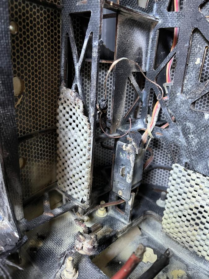

                                  The fire extinguishers did NOT put the fires out...but did snuff them out repeadly instead of just cooking all the way down at once.....think of multiple times for flame out instead of one long burn. We did fling the batteries out but by the time we could see where to grab a power lead they were already falling apart. The fire extinguisher did help....convinced it kept the flames and heat down. Short repeated burst of the fire extinguisher each time the flames roared up worked.....
                                  Make no bones about it though....the airframe stinks and the powder from the fire extinguisher is a real mess. I spent a good hour at the barn blowing out the powder then wiping down the exterior with Windex and paper towel....I have yet to unscrew the canopy and get the cockpit cleaned up...
                                  Both sides of the upper deck lattice work of the interior shelving close to the motor firewall will need plenty of new support bracing
                                  The servos are all good - but the wires are melted....so of course everything needs replaced except the servo arms and cables and rods
                                  I have inspected the wing saddle looking very closely at the wing tubes....it looks good with no damages...the wing saddle looks good as well. So far the damages are just where the flames were licking the battery hatch and either side of the battery tray......
                                  NOTE: Due to the long motor box not working with my set up......I used the short box with motor stand offs which placed the batteries resting just aft of the motor firewall....the rest of the batteries were open laying flat on the lower deck just under the battery hatch......this also probably saved the airframe as the flames would have melted the nose off if the LiPo's would have been underneath the firewall.
                                  I do like my planes in clean shape tidy and pretty inside and out....so I am torn not to get a new bird......will see how the repair efforts go....and I still have not removed the cowling yet for final inspection....although I am confident it will be good to go
                                  Wish I could report what started the fire.....I check all batteries after and before each flight.....all voltages were in good nick and the batteries were well balanced none had a sleeper cell. The motor is grindy but I am thinking it is full of Fire suppressent powder
                                  Interesting I had motor power and all surface control including the retracts as I pulled an immeleman to circle back for the landing....greased the landing on power and control to final stop....flames were already licking out from the battery hatch gaps
                                  I'll be sure to make a photo journey of the repairs

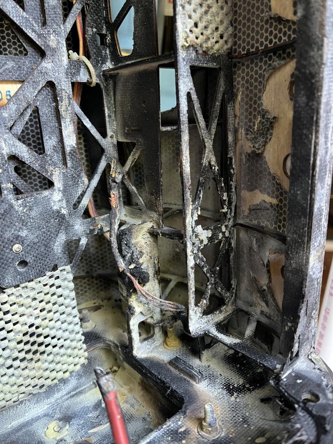

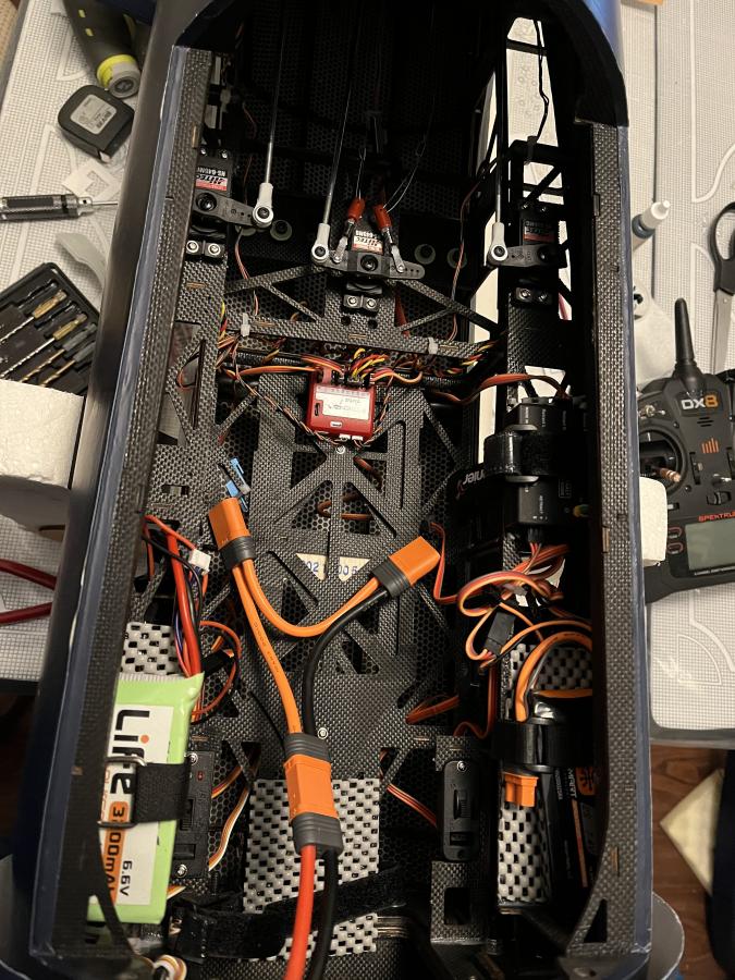

                                        Just for information and observance....the inner covering of the fuselage is some sort of printed vinyl perhaps the same material as the outer covering. I really think this makes the fuselage really strong but still very light. The battery flames melted the inner cover and it peeled back in some places while the outside covering is undamaged.
                                        The inner lattice and bracing decking is a fiber glass sandwhich to plywood....in some places the plywood burnt away but the strands of fiberglass weave is still present.
                                        While the inner latice and bracing looks nasty (and it is) the most damage is to the left side....this can easily be rebuilt/re-inforced with balsa stock.
                                        The bottom tray where I had switches for the reciever on one side and the retract on the other...is still strong and servicable with no repais needed.
                                        The bottom tray where both 6s 8000mAh Lipo for the motor is servicable with no repairs needed.
                                        I am amazed the materials suffered minimal damages...a testimate to the manufacture and design structure.
                                        Most likely as I continue to use a brush next to break away and remove more Fire Retardent Powder....the interior front fuselage will look much better of course. I plan on spray painting the affected area in Gloss Black once I have everything fortified and ready for flight.
                                        This is an amazing flying airframe and much sturdier than it appears thanks to the dual skinned fuselage
                                        I am including photos for now just for archive purposes.
