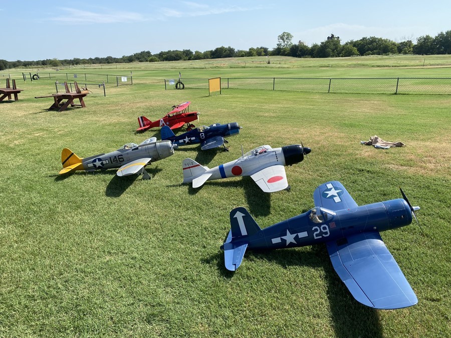

          During our clubs July 4th Picnic - I flew two sorti's with similar wingspan Zero, P-47 and Corsair gassers.....each with a flight weight of near 30pounds. They are loud and proud and have no whims to fly in heavy weather winds, their flight times are usually 6-8minutes. I could keep up with them but at expense of flight time duration.....the winds would cause me to lift a wing in the up wind banks and force me to tighten up when trying to complete figure eights.....my landing speeds were half speed to thiers. Runway passes with the three of us hauling down the runway for display passes were thrilling but I was a bit shy to loop with them as thier Kinetic speed is much more prevelant on the way down from the top. It was evident for me to observe the weight of those beast require and carry speed much more than my electric set up.....I am sure if not for the depletion of battery reserve I would not have flown so timidly with them

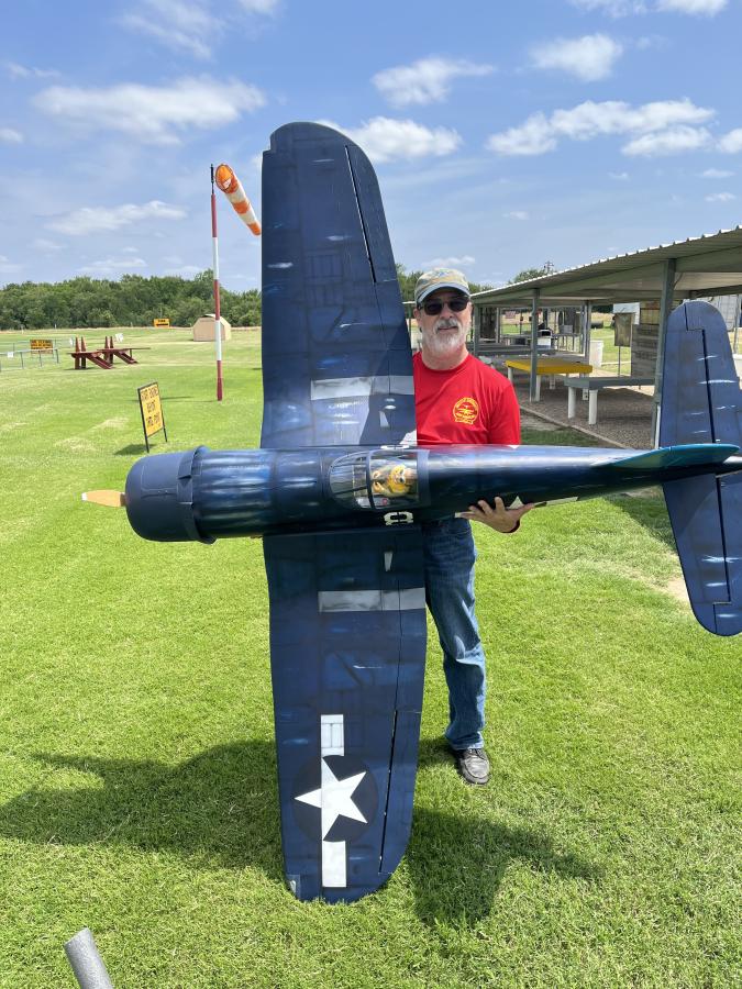

                This model has become problematic.....I can't prevent myself from flying it excessively every day. The only model of this size (88inch) that comes close is the Hanger 9 Ki-43 Oscar which is a beast that lands like a butterfly with sore feet. I prefer the electric landing gear over pnuematic of the Oscar.....with the Oscar no longer in production the notion of damaging it is always in the back of my mind.....the BH Corsair parts are on line ready to go

                    10 Flights on ol' firebird today....such an excellent flyer.....

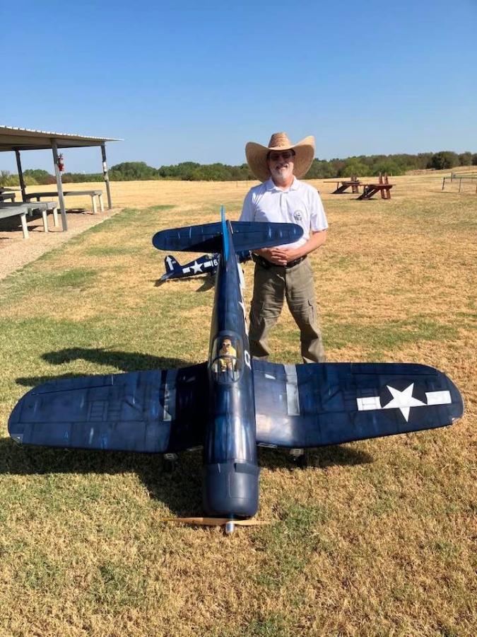

                        That pik shows the incredible size of the bh corsair,, looks like its well sorted now... how much flight time u getting? Have been following a bit,, its electric? Awsome aircraft
                        • TwistedGrin
                          Hobby Squawk..... CLEAR!!
                          • 376
                          #232
                          Yes Electric
                          Flight times at or near 6minutes....very smooth and powerful (140Watts Per Pound) Thrust. Take off and Landing with ease

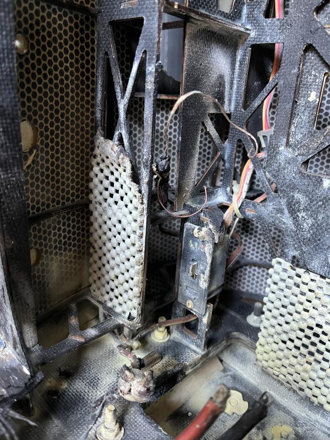

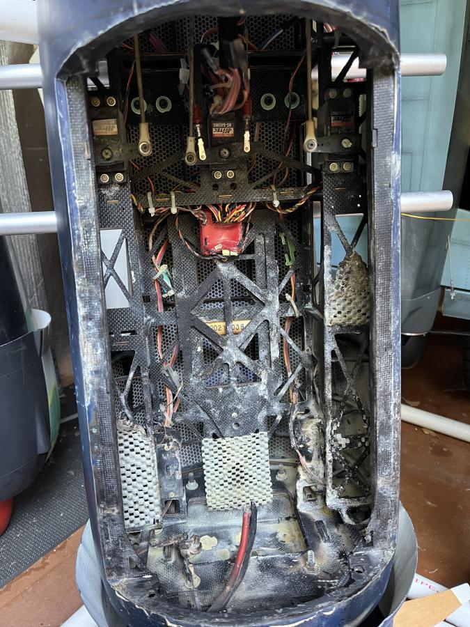

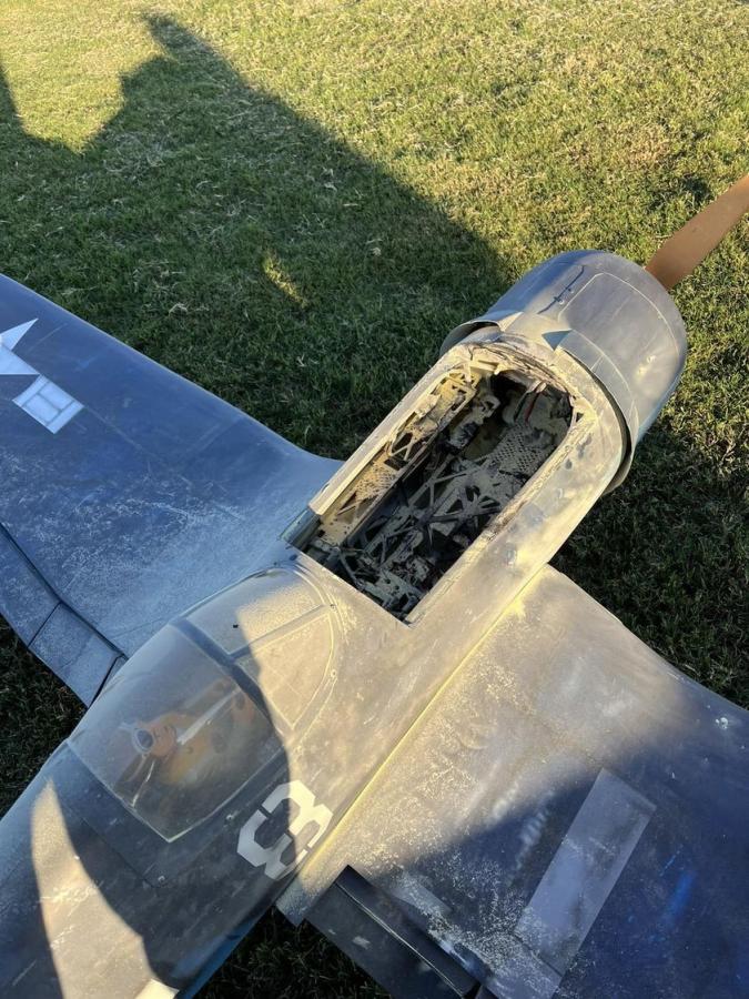

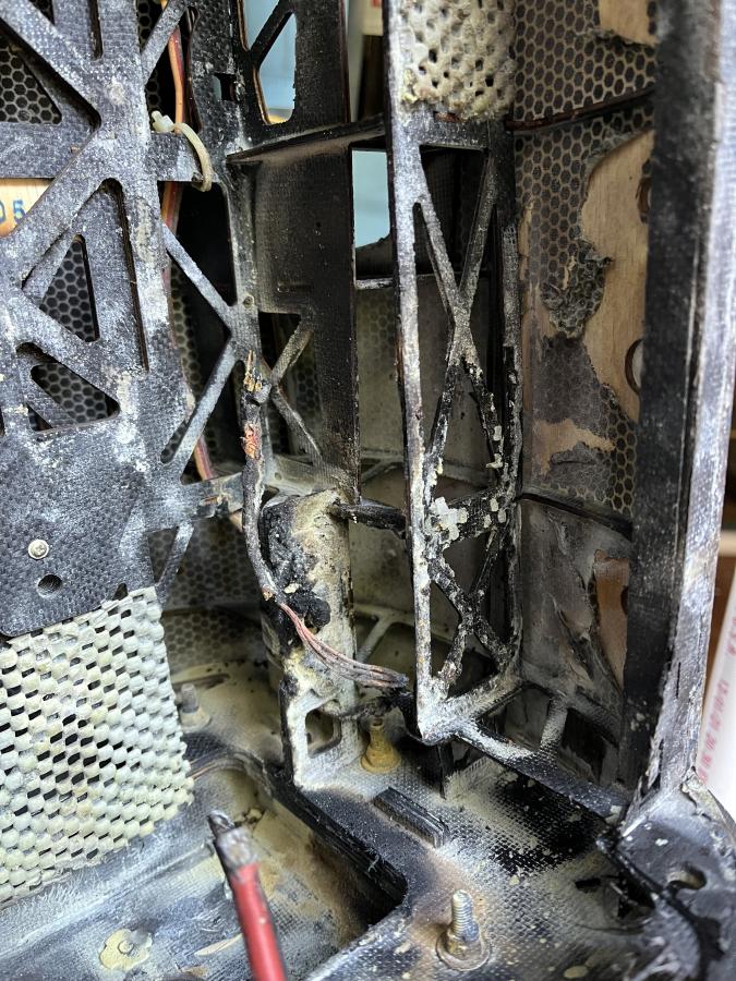

                              Yep but please take note.....I think this aircraft's inflight fire was caused by a LiPo flight battery failure.....possibly due to prop amp overloading.
                              After repairing the FireBall I propped down to an XOAR 22x12 which still has gobs of power....Wonderfully balanced and quiet performing R/C....I have standing offers to sell it each time I fly it.
                              Having said all of this - the fire melted everything...so a positive identification of exactly what caught fire first was not possible. Since I had full control of the burning bird in flight and after landing.....I am surmizing one of the two flight batteries had over heated and popped off.....either flew it too long or it got too hot from amp load....or Both !!
                              Respect the power train - Find the amp load and set up Prop-motor-ESC within electronics specification
                              Fly in your numbers - don't fly the LiPo down to the red zone (Below 3.7v per cell)
                              Check your Batteries - Always Balance Charge
                              Check your power connectors - look for arching or color disfiguration
                              Set up landing at projected 3.8v per cell
                              Ensure your field has fire extinguishers on hand
                              Pre inspect and Post inspect every flight
