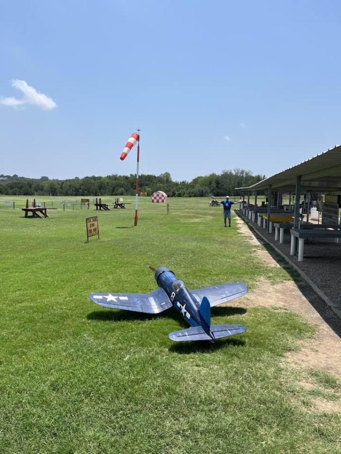

      06-19-23 11:00am CDT to 2:00pm CDT Heat index 112degrees, furnace winds at or near 8-12mph choppy gusting conditions but on the nose down the runway......fitting today for 4 flights on Fireball 8. Confirmed performance is excellent with the reduced prop size down to the XOAR 22x12PJN. Still has plenty of power and bite....flying at my transmitter setting high rates with the Aura8 stabilizer gains at the dial 1'Oclock position. Robart retracts and new controller board worked perfectly. This is a top tier performing R/C aircraft.....hands down excellent flyer. I would have liked to fly it all day but it's just too hot for me....I can do 101degrees but once 110 is breached I'ma outta that.
      No video of today's flights but did take a photo of the field today while another pilot and I had the field to ourselves before locking the gate and leaving the surface of the sun

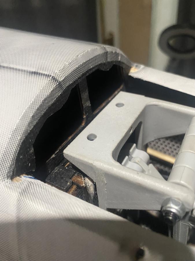

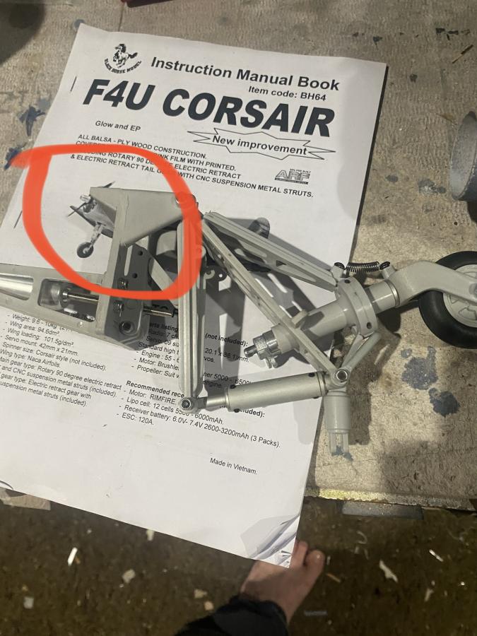

          Another issue surfaced with the build, the tail retract u it does not sit flush in the mount in the fuse. The tail retract has angles where it seats, amd the mount on the fuse is not designed for this so it will not seat flush. Has someone else experienced this?

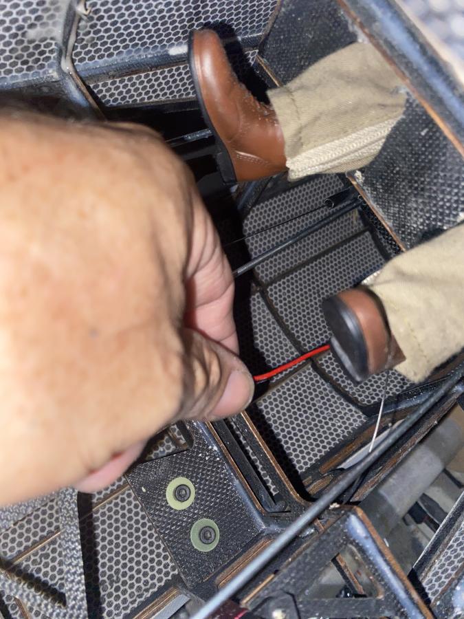

            Really starting to think my kit was a refurb, installed the tail retract and the retract wire barely reaches to under the canopy area, way too short to reach to plug into the controller in the correct location. See pic!

              Of course another issue, tail retract failed! This bird is still on the bench amd not even fully assembled! I have the BH P-40 and have zero issues with the mains or the tail retract. The p40 mains have the “duck foot” instead of the pins to rotate the main struts. Also the tail retract on the p40 has the “bell crank”. The Corsair I have received just recently I believe has the old gear, which has already failed before even completing the plane. I do know how to build and fabricate but for this price I shouldn’t have to! Pictured is a topflite corsair I’ve built from wood, fiberglassed, panel lines, rivits, painted insignias etc. I’m not a pro, nor newbie but this bh Corsair is making me second guess my purchase. I am relying on motionrc now so o can get this bird flying.

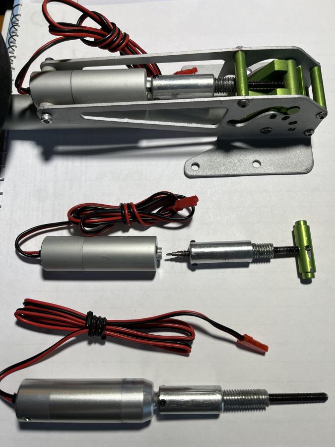

                The BH Retracts struts and twist-turn housing are fine....the motor actuators are the weak link one of mine broke. The motor actuators received from Motion did not have a means to attach to the retract. I replaced the mains with Robart electric retracts - even one of their motor actuators failed. After replacing the failed Robart electric retract motors - the mains seem to be holding up just fine. The tail wheel retract was failing to run its secondary screw output....several occasions I had to deburr and grease it up...run it several times to make it run both stages....working fine now.

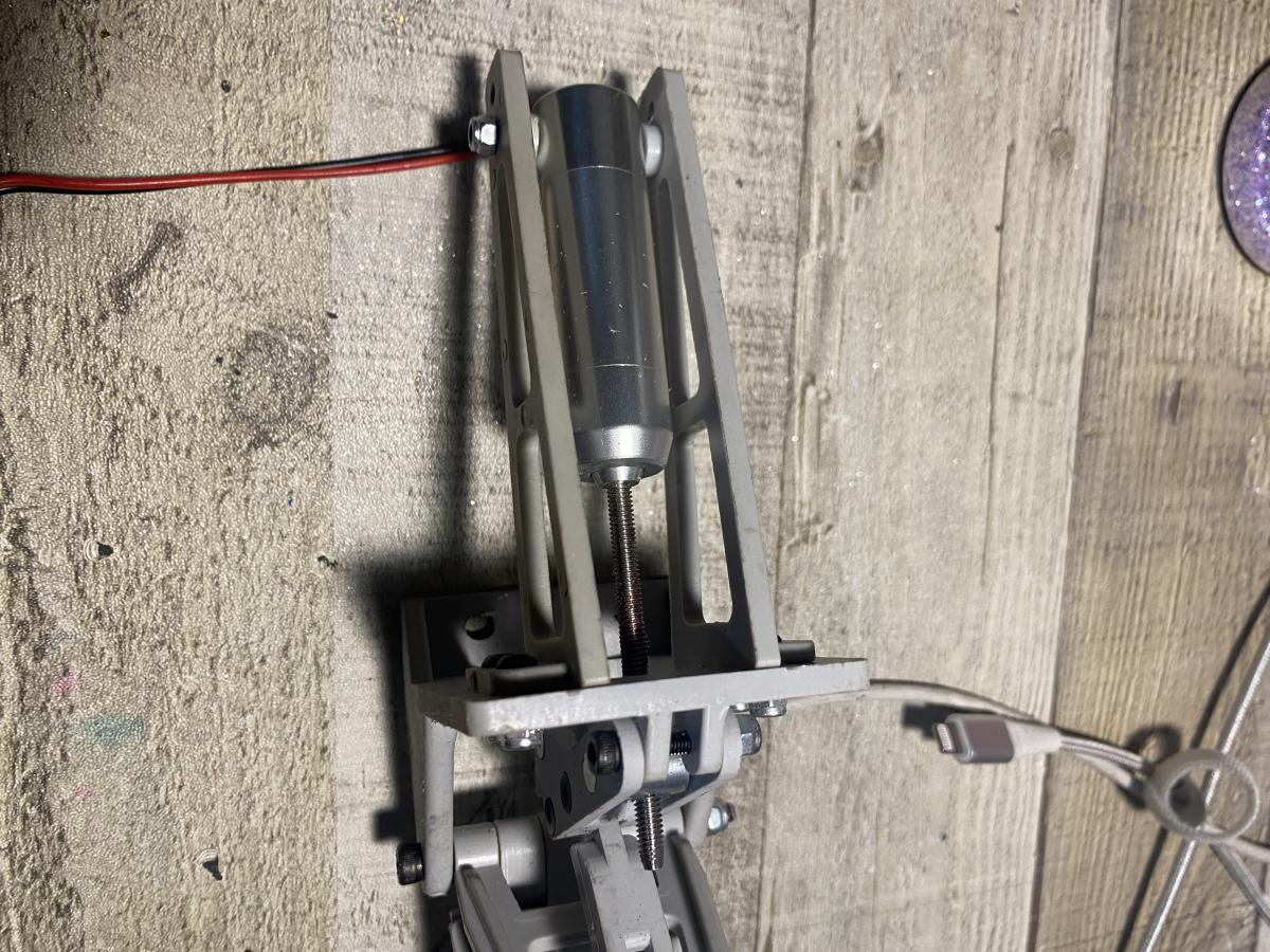

                  I believe the Blackhorse retracts are Phoenix hardware and electronics (as with the retract controller board)......I have the 80inch Phoenix P-40E so far the main gear is holding up just fine but the tail wheel failed. The trunion itself stripped out...whereas the motor and two stage screw works just fine. I overcame this by fastening a nut onto the trunion.....very tedious. I tried to solder the nut onto the trunion but could not get the metals hot enough for the solder to hold. I overcame this by cutting a slot on both side of the nut to hold a wire on each side and twisting it onto the trunion then running up the retract assembly to get everything in sync.

                      Correct....this airframes retract are "Electric Worm Gear" both mains and tail.
                      I am nearly certain they are Phoenix hardware:
                      Tail Retract: http://phoenixmodel.com/AccessoryDetail.aspx?id=689

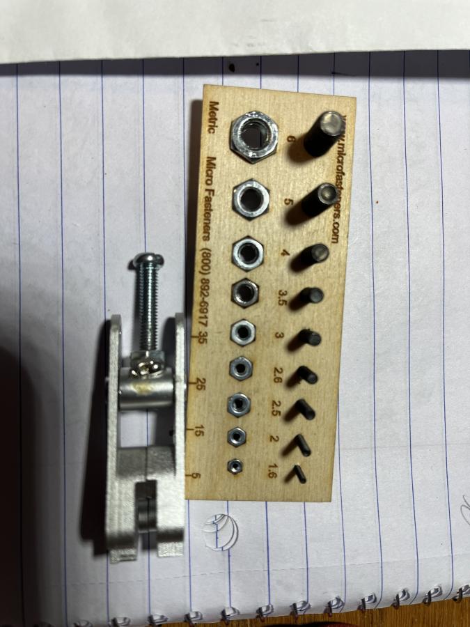

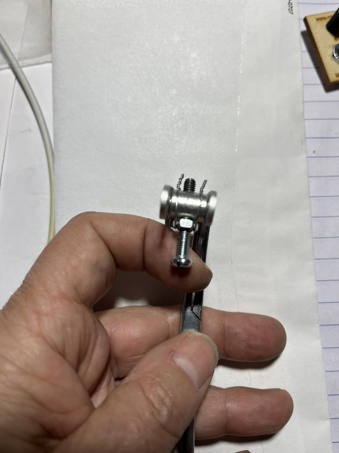

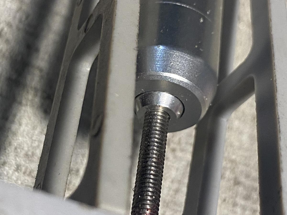

                      MotionRC Main Retract: Replacement motor actuator is different from original; does not ship with the trunion barrel; can't get the set screw out of the original trunion barrel
                      Photo attached
                      Top:Original Retract assembly
                      Middle: Original Motor Actuator shaft to the worm screw failed
                      Bottom: New Replacement Motor Actuator....needs the worm screw trunion barrel
                      I then purchased the Robart electric retracts for the Main gear
                      TwistedGrin​

                              I am not sure what is old or new......I ordered my airframe in 2022 which shipped with the two stage motor actuator worm gears. Motion RC replacement motor actuators I ordered and received are also "two stage" worm gear.
                              The tailwheel assembly is exactly the new Phoenix Corsair hardware...however it shows the "single stage" worm gear: http://phoenixmodel.com/AccessoryDetail.aspx?id=689​
                              The new Phoenix Corsair looks to be a "single stage" worm gear:
                              It looks like we can order Phoenix parts as noted above but not the airframe.....I think Tower Hobbies owns the retailer vendorship for Phoenix...the Phoenix Corsair is NOT available.
                              If I could have found a way to remove the set screw from the original retract Motor Actuator Wormgear Trunion....I would have kept going with the stock retracts. In fact only one side broke....the other side was just fine. I did have to monkey with my tailwheel a couple of times removing it from the airframe and running the assembly in and out to clear some burrs then applying some grease .....it too is now functioning just fine.

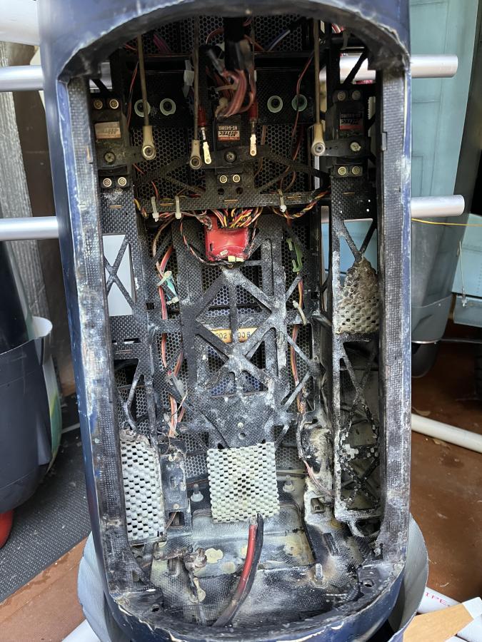

                              Agree to the angst and frustration of purchase price for failed components......I felt the same. Then ordering spare parts that I could not use. Then purchasing Robarts to get the aircraft in flying condition. Then catching fire in mid flight. Then rebuilding the airframe with new prop, new motor, new ESC, new connectors, new Switches, New Servos, new batteries, new receiver and rebuilding the lattice work behind the motor bulkhead.
                              It still stinks like fire-extinguisher powder and burnt plastic and high temp black spray paint.

                                Yes the gear you posted are the newest and offered on the spare parts list on motionrc website. The older “problematic “ gear that came with my arf that I just recently recieved. The gear that came w my arf are the twist and turn with the pin and single worm gear. Now when I ordered my arf this was supposed to be the latest shipment. If I knew I was going to receive this Corsair with the old gear I would not have purchased it. I do have a few sets of the newest gear I purchased from motionrc on the corsairs “spare parts” list for other projects and they work fine. I should not have to take a chance on belly landing, prop strikes or cartwheeling this plane because the gear supplied is the older set with issues.
