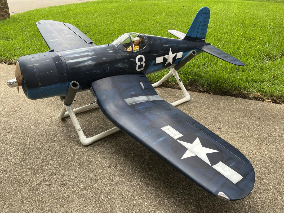

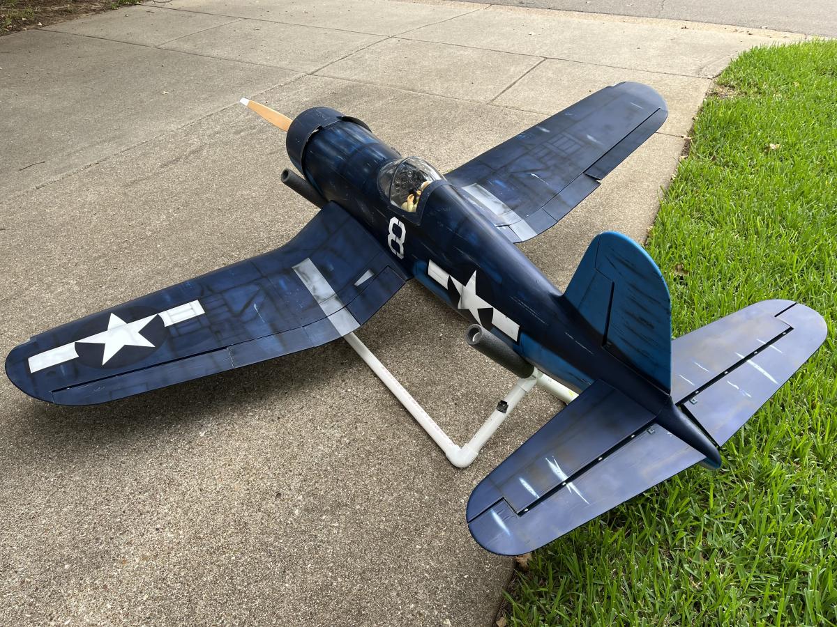

ID:	353763 Now that I have 6flights on this airframe with my Electric set up.......can honestly report it is a supurb flying aircraft. Probably due to the power to weight ratio (270Watts per Pound) and acceptible wing load factor. This power package puts the wing fully loaded for flight in just a few feet... withouth penalty. In fact you have to concentrate to take off slowly and looong for scale appearence - otherwise it's fully on the wing like a smaller high wing airframe. Once in the air.....the covering does not matter....in fact it looks excellent. The bottom weathering along with the color contrast is spot on. My BH F4U is flying true and straight as an arrow....the only trim I needed was a couple clicks of up trim with the elevators assembled and set absolute zero deflection. There is no tendency to roll or pitch or dive. The flaps slow this aircraft down to a crawl and landings are effortlessly smooth and consistant. However.....the motors of the stock (Phoenix) retracts are weak, the actual struts and carrier metal is just fine. I replaced the stock retracts with the $525.00 Robart Electric 14E-108 full retract assembies which took minimal effort to retrofit into the wings and work very nice.....however even with perfect level smooth greased in slow speed landings one of the Robart Electric Motor actuators stripped....the motor spins just fine but an interal gear is stripped. Robart has this as a replacement part available in stock so this will be an easy repair swap.
                                      I was and perhaps still am a little skeptical about the fiberglass sandwhich plywood webbed support frame as it looks and feels ....crispy.....fragile. I think the only balsa could be the wing sheeting. Wheras other WarBird giants I fly are much heavier using standard plywood balsa construction which looks and feels like they could suffer much more abuse. However the BH airframe is light and stiff with the gull wing dual wing tube designed to handle normal stress loads.....so far. The wing saddle cross support structure just appears to be fragile - but then again the dual wing tubes may be preventing force loads from translating to that cross section.
                                      I will state since the model flies so well...any percieved detratction of the printed covering for me is a non-issue. I simply weathered the nose cowling a little and it brought the entire airframe into a different perspective. I used a silver paint pen to rub on some contrasting weathering effect to the fuselage as well and it took without issue. This leads me to beleive a little bit of sanding and the entire airframe could painted over. However after just weathering the cowling I don't see the need. In fact the airframe was well received by my clubs master builders stating the flight performance and the airframe itself is impressive.
                                      I also fly the Hanger 9 86inch wingspan Ki-43 Oscar with the same power plant....this BH F4U Corsair is on par if not more nimble than the Ki-43. Both are truely amazing performing airframes....only one is available for purchase at this time.
                                      You can doll up a poor flying airframe and dread flying it or you can doll up a great flying airframe and love flying it....if you don't like the pre-printed covering on this model it is well worth the effort to doll it up to your satisfaction.
                                      It does not have the gear doors for the mains nor a bomb drop or canopy pull....however for those that obsess with master building....this should be an airframe that could be infinately modified.
                                      I think BH added some washout to the wing tips and maybe added some beef to the vertical stabilizer....I challenge anyone to actually prove it against 100% scale. My point is Black Horse has delivered a true performance flier and not a hanger queen.....this is what I tend to enjoy rather than hesitating to fly a high percentage scale model that is a brick to fly.
