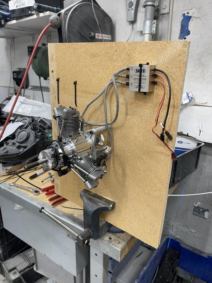

          Is saito fg60r a good choice for this model ?
          and how about the landing gear for the 2025 model ?

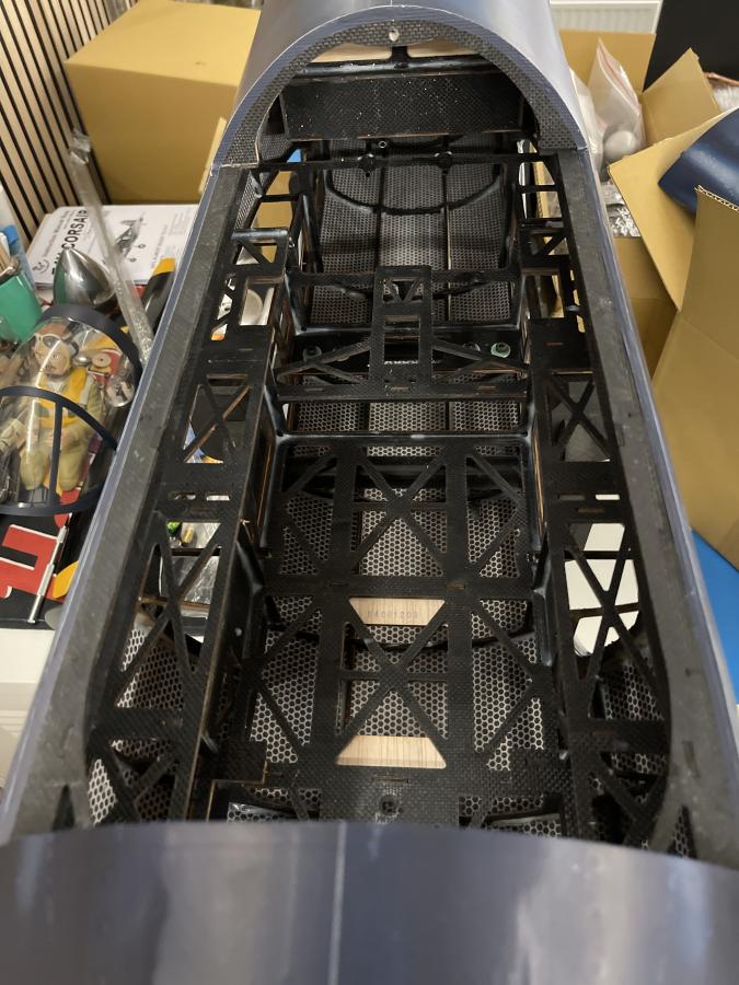

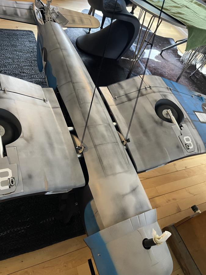

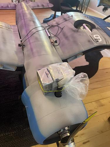

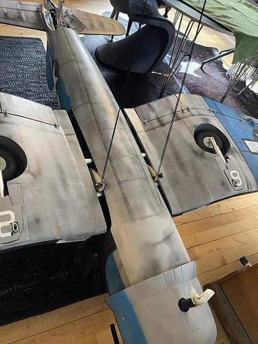

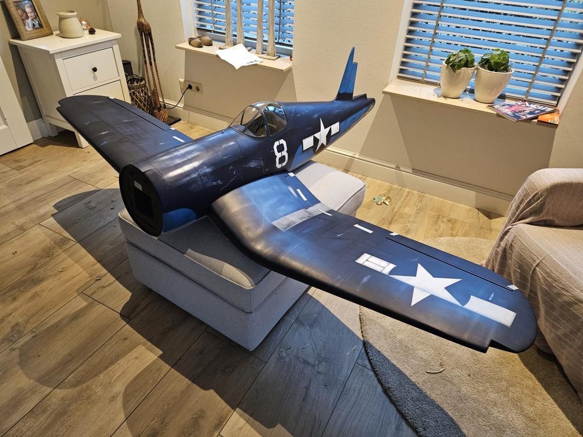

            Receiving my new BH corsair thursday. 😀 can’t wait to get started.

              #266
ID:	439598 Click image for larger version
ID:	439596 Click image for larger version
              • Fizeman
                • Oct 2025
                • 14
                #267
                Looks good and very light. Fuse only wheighs 1600 gr.

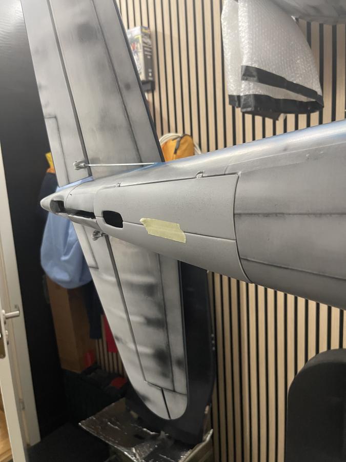

ID:	443857 Click image for larger version

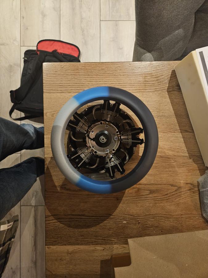

                            Couldn't help myself. Ordered the BH Corsair. Will post some pictures of the fitment of the UMS 5-100. First I have to wait for the delivery truck...
                            • Reennie the second
                              • Jan 2026
                              • 15
                              • Varsseveld, the Netherlands

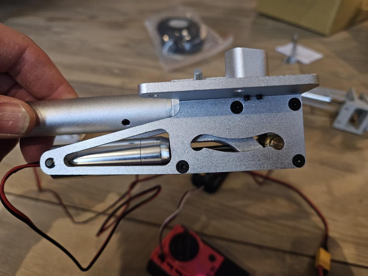

                              #274

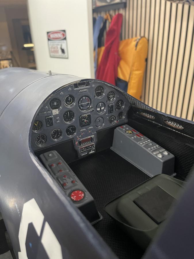

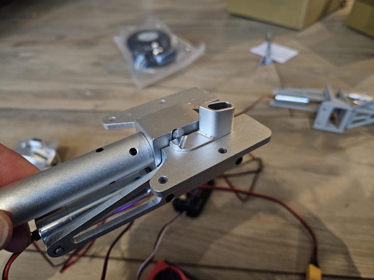

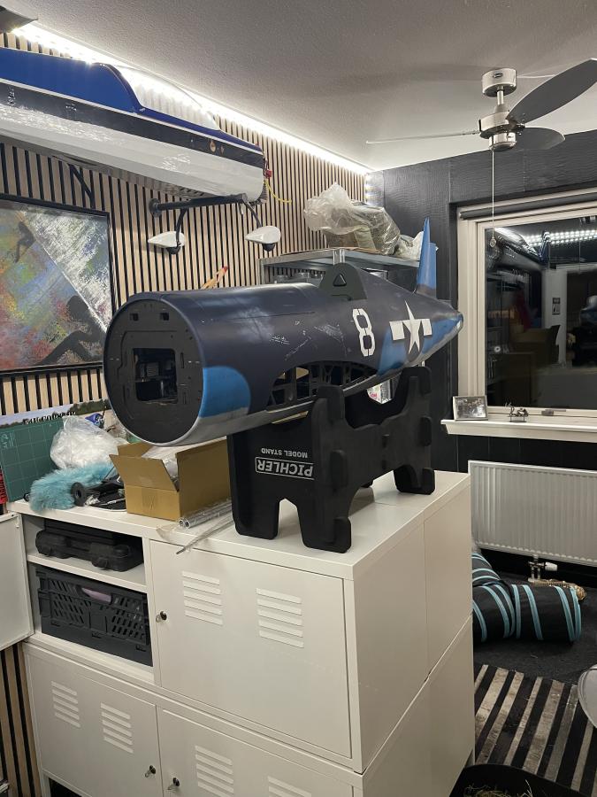

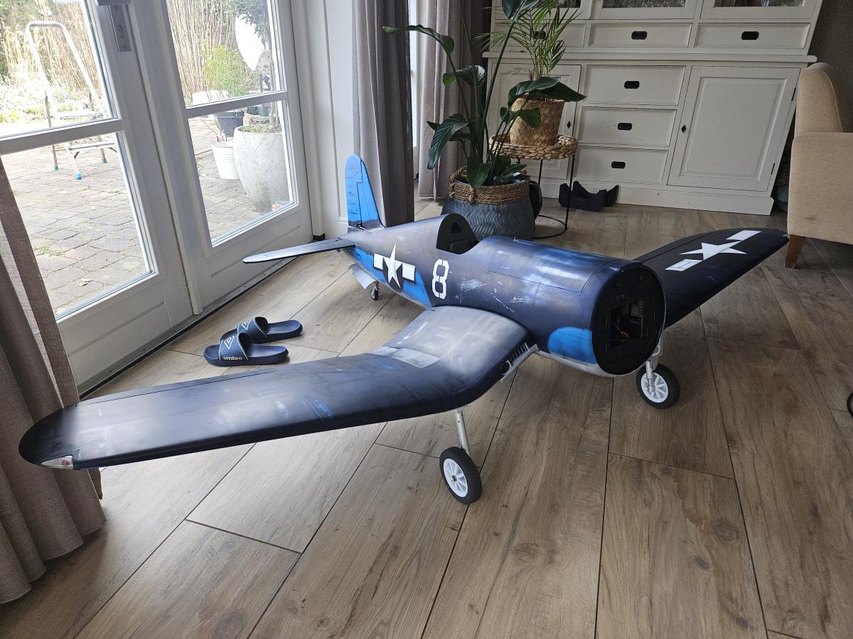

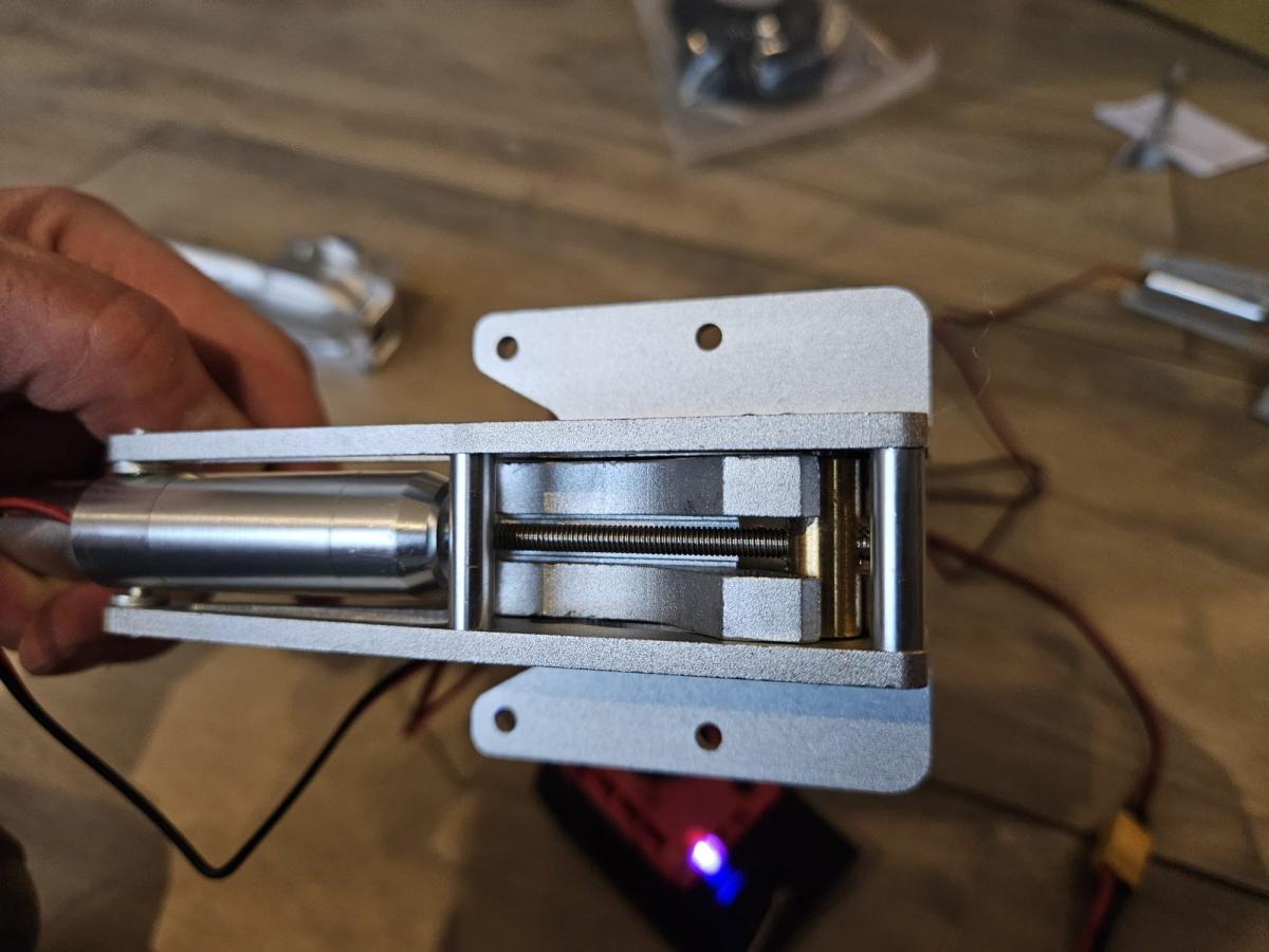

                              Corsair came in today. What a nice kit, really impressed. Landinggear is different than I saw in the forums. Hopefully finally stable and working. Included some pictures for those that might be interested.
                              And the UMS 5-100 seems to fit!!
                              Now printing some wing inlets to replace the ugly vacuumformed thingies...

                                #275
                                Looks nice already... Some painting and then it's really nice...

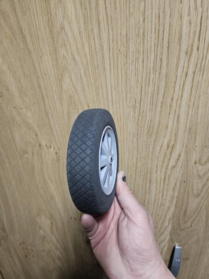

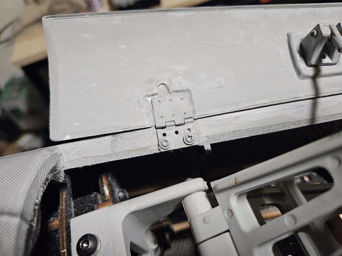

                                  #276

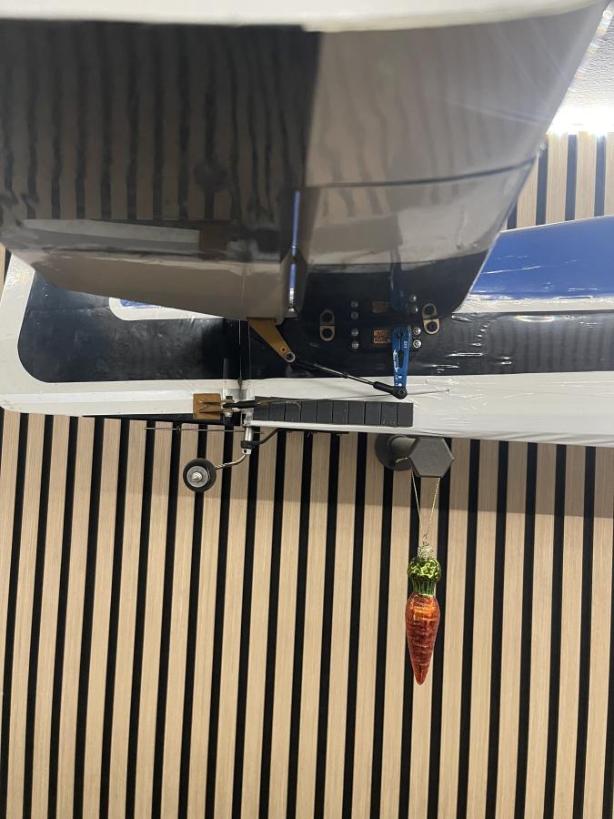

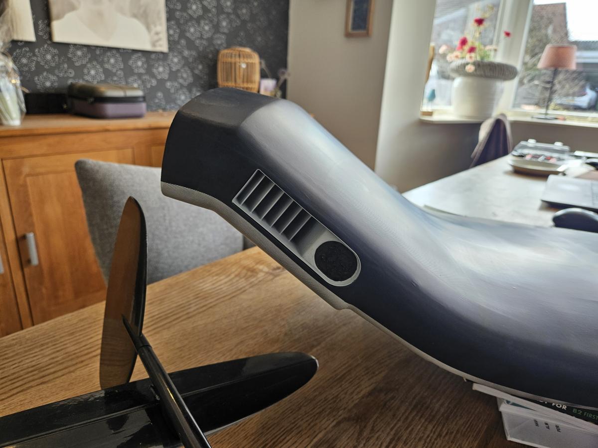

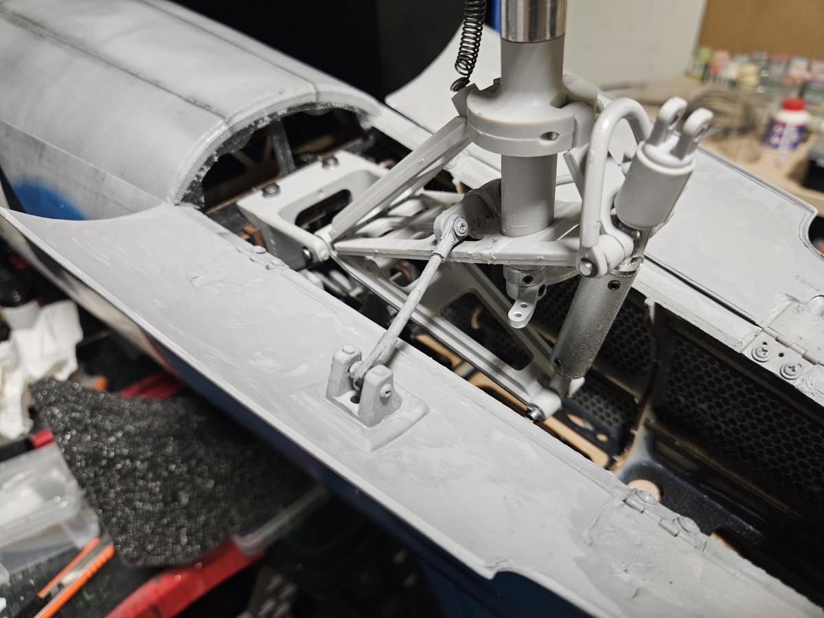

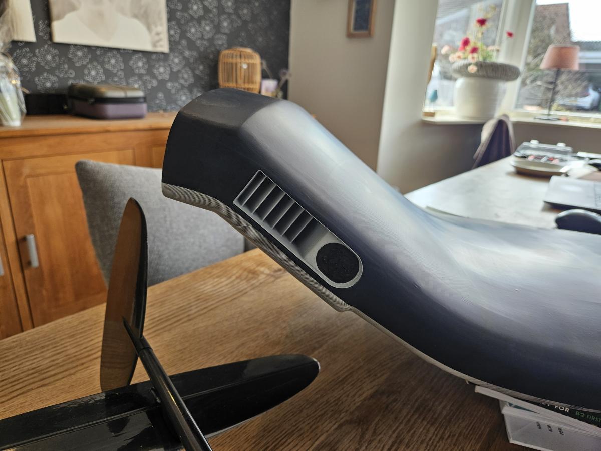

                                  Some progress on the tailwheel and doors. Testprinted some wheels and Quick & dirty painted the wing inlets...
                                  Tailwheel with new hinge point for the door rods.

                                  Little bit of paint on the wing inlet

                                  New hinges for the tail gear doors:
                                  Doors closed
                                  Wheel testprint. Rubber is still somewhat to hard, gonna reprint. Material of the tire is TPU Varioshore, rim is from plain PLA.

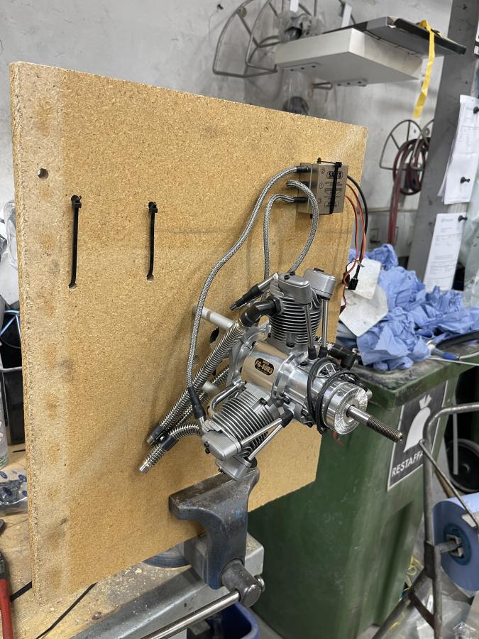

                                    #277
                                    The doors looks good 😎 you did a lot of work on that Retract 👌🏼
                                    • Fizeman
                                      • Oct 2025
                                      • 14
                                      #278

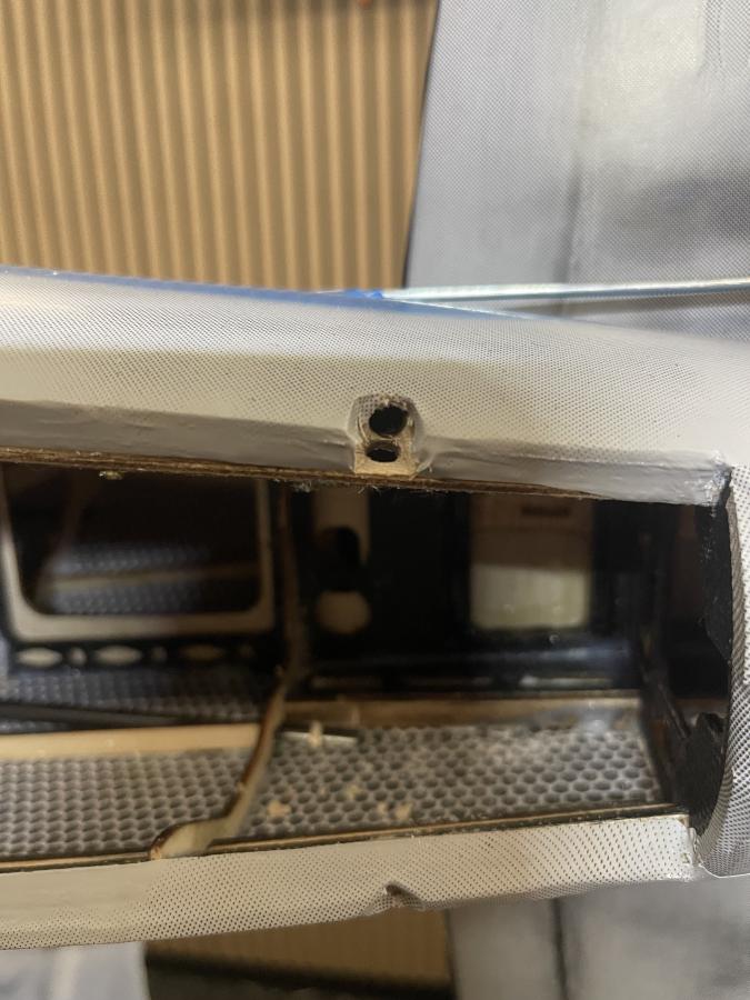

                                      Not a lot of room left 😄 Click image for larger version
                                        • Jan 2026
                                        • 15
                                        #279
                                        Whoah! You're progressing nicely! When are you going to maiden?
                                        What engine did you decide on? The FG60R3? How does the CG pan out? For me it is going to take a few weeks before the engine gets mounted...
                                        Mine was on its own legs for the very first time this morning.
                                        • Fizeman
                                          • Oct 2025
                                          • 14

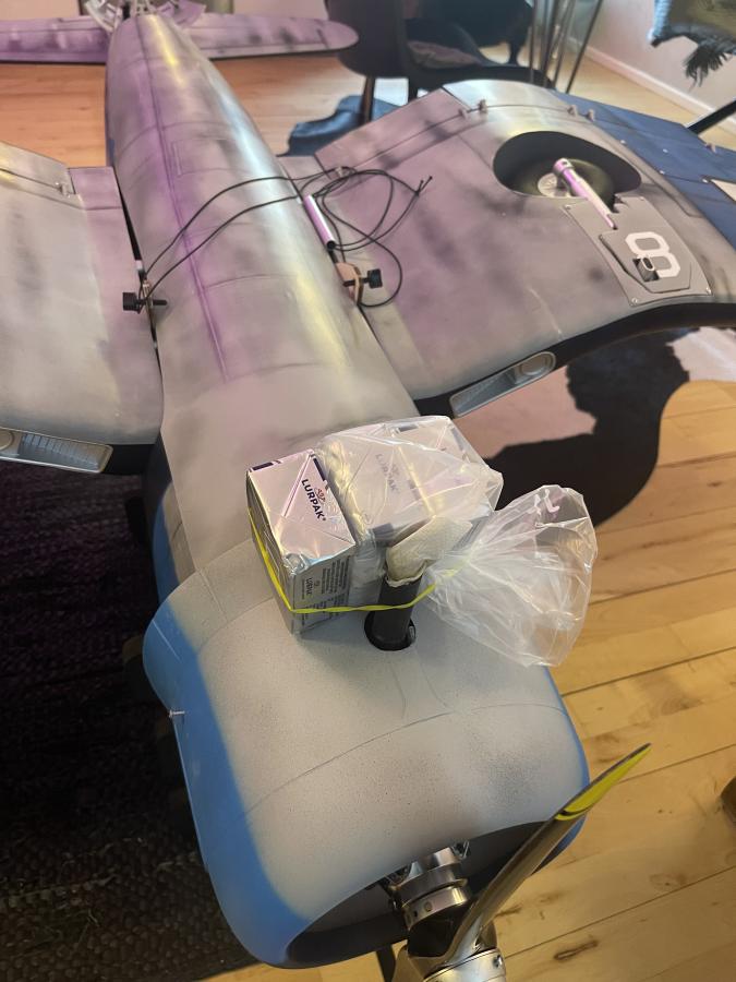

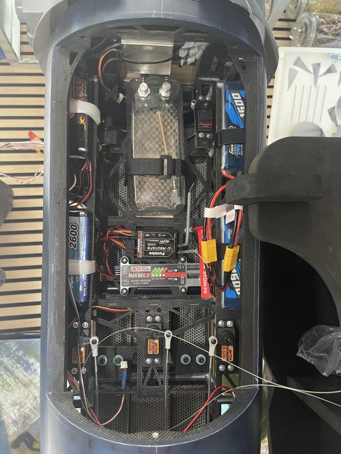

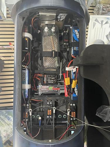

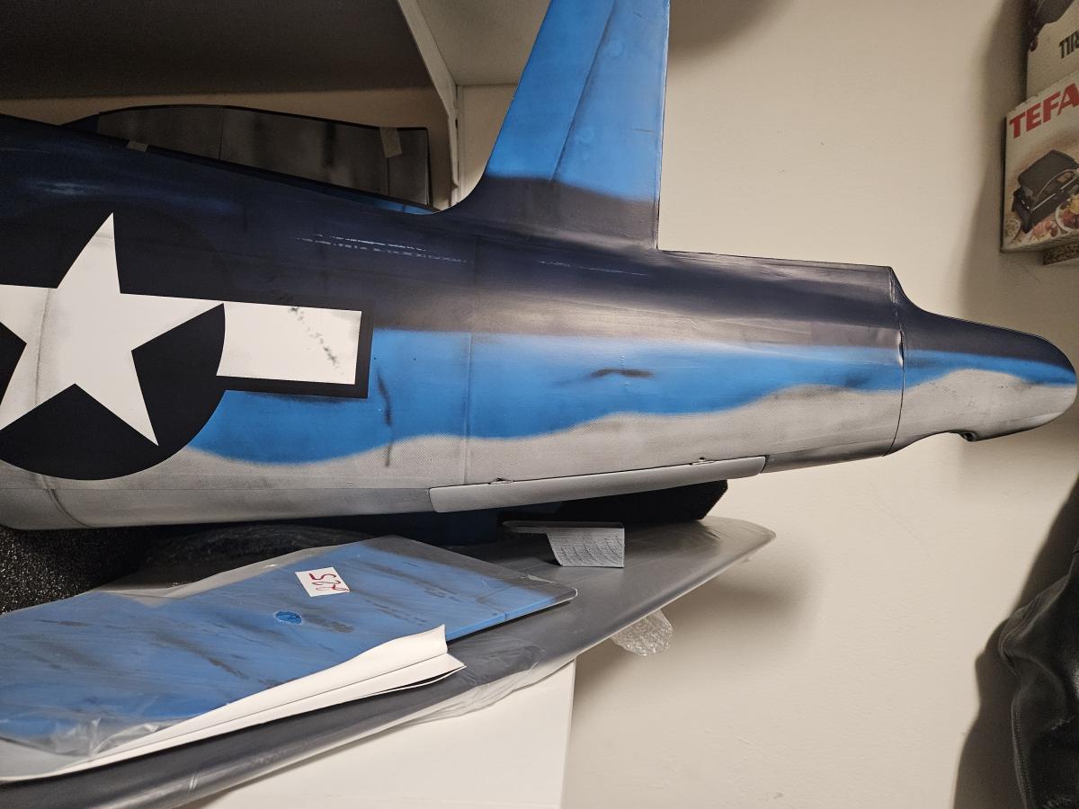

                                          #280
ID:	447139 Click image for larger version
ID:	447140 600 grams to get the cg right. Still under 12 kg’s flightready.
