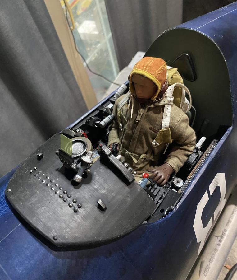

    Cockpit redone! 3d printed with a nicer detailed pilot! Now she looks great!

    I started working on mine finally as I finished my topflite GS Corsair kit. I did however did not like the stock cockpit that comes w the BH! I do appreciate and glad they do include it but it wasn’t going to work for me. So I 3d printed cockpit pieces to get it a little more scale(see pics) you can see my progress at RCDUDES

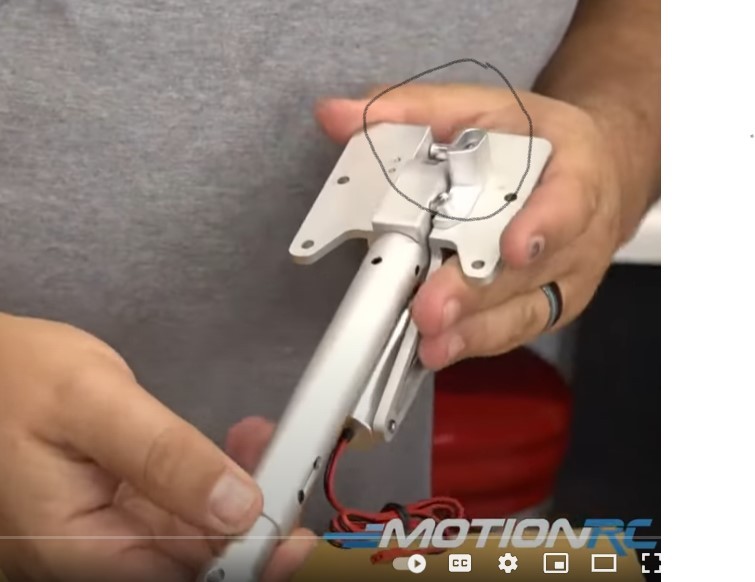

    Are all the new retracts have the new turn design like this one? This is a screenshot of the unboxing video motion did recently.

    The BH stock electric retract housing and struts are fine but the actuator motors failed twice on me.....I replaced with Robart electric retracts to which one of those motor actuators failed.....replaced that motor with a Robart motor. All good. I think the BH Corsair predrilled retract mounts matched the Robart set.....but I do remember having to open up the holes of the retracts to match the mounting blind nuts size and thread.
    If I see and read correctly it is interesting to see your replacement or "Second" set of parts ordered retracts are different.....the mounting holes appear the same pattern though!!

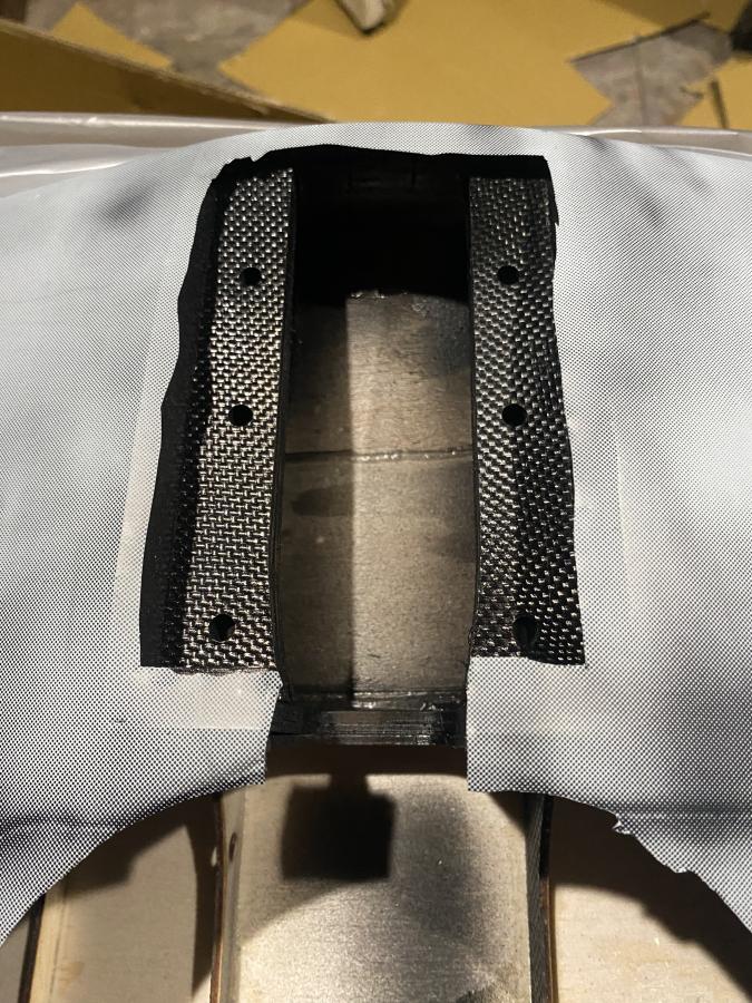

    I have a question just recieved mine today. What do the 1st version gear look like and was there a second version of main gear? I’ve heard there was issues w the first version and changed them? Also on the gear there are 6-holes on the gear mounts in the wing, and yet there are only four holes on the gear? Gear shipped to me with the Corsair on the left, gear I ordered for the bh from motion for 50cc on the right. 2-different types of gear!
