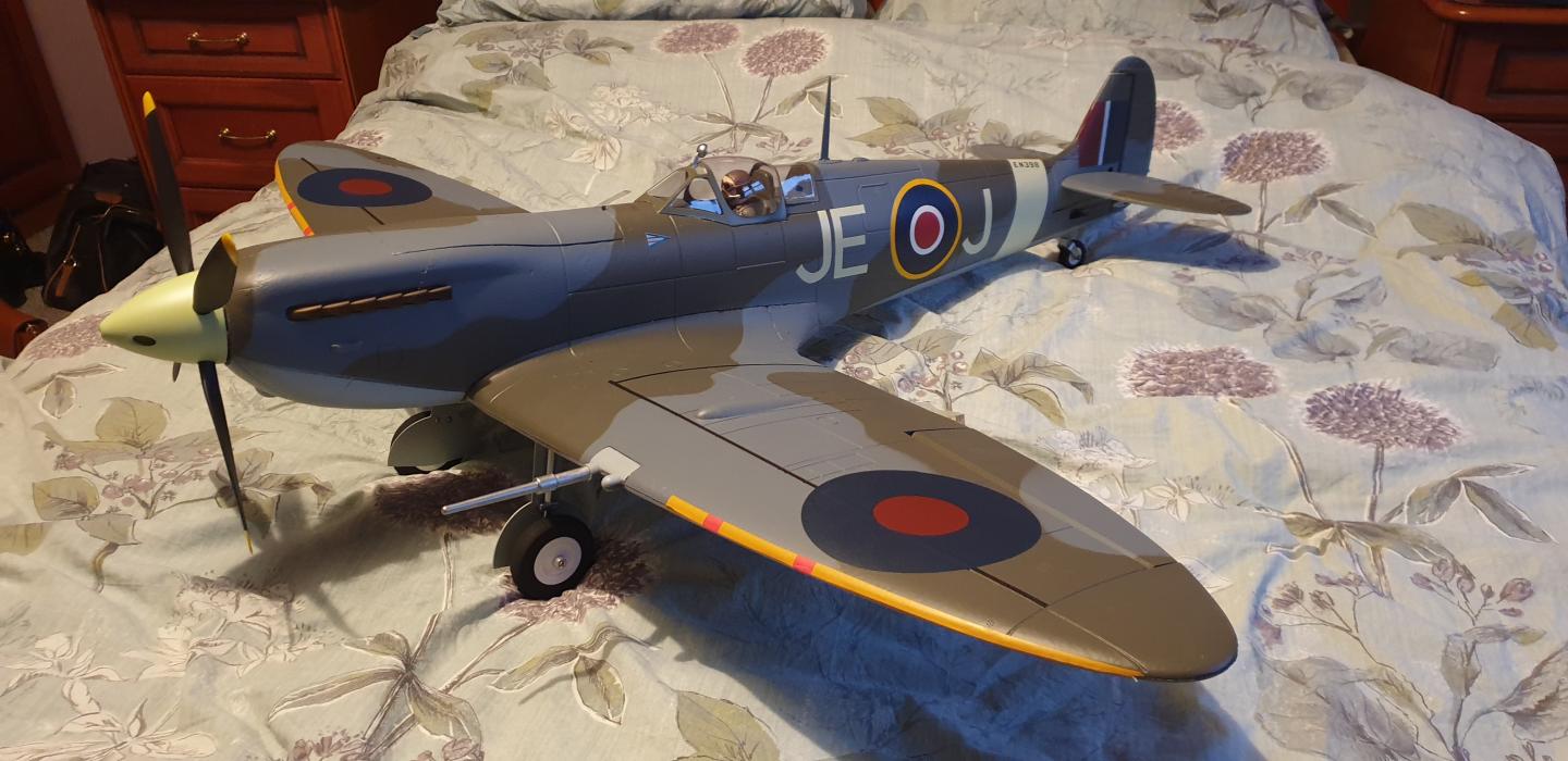

                    Got my Spit on Christmas Day and built today Boxing Day. I also got a 50GBP Christmas card from FedEx for customs from Holland to UK,I didn't receive a bill from my previous purchase back in July on a P51 800mm . Anyway she looks great, just need some weather now for a maiden flight.

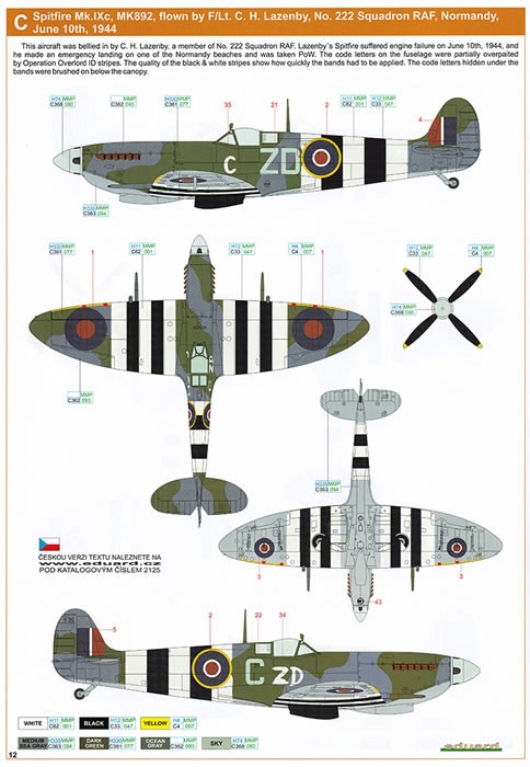

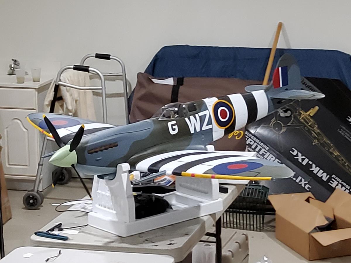

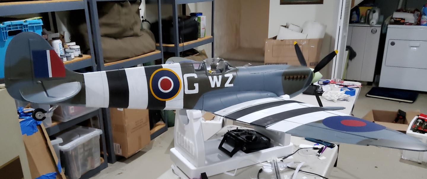

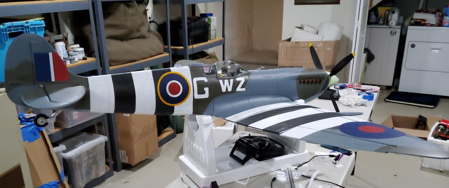

                          I last flew RC 25 yrs ago and had, the bug pretty bad back then. I scratch built and flew a 1/5 scale Waco biplane back then. I am retired now and have the time and the thought of flying a Spitfire has rekindled my interest in flying again. I always flew methanol gas powered airplanes .40 to 1.20 two and four stroke engines. Going electric is a challenge for me. I has meant a real change in thinking, lithium batteries and their care and feeding are a completely new technology for me, but I am making progress in this direction. I am also amazed by the brushless motors and their control system. My only issue with the kit, there was an unequal amount of throw between the left and right wing flaps, which I could not balance out, with the ball clevis's provided. I went on line an ordered some straight linkage with a z bend for the servo arm and through type clevis for the Bell crank. I was able to trim out the imbalance that way. I think when model was assembled one servo arm was one tooth off from the other and there was no way to pull the servo to correct this error. I don't have the full flap throw that was recomened but I thought the recommended amount of flap was excessive anyway.
                          Not one to leave well enough alone, when I first unboxed my plane, I knew what I wanted to put my own mark on the build. I decided, I wanted invasion stripes. I did some research and found a historically correct paint scheme and proceeded. I masked the areas using painters blue masking tape. This turned out not to be the best choice. After applying my flat white base coat and masking and painting the flat black stripes. When I lifted the blue masking tape, some of the camouflage paint I had been protecting and some of the flat white paint lifted away with the tape. The effect wasn't all that bad, where the paint had been lifted it left a silvery streak, which almost looked like natural wear and tear with the aluminum showing through, if only it had been horizontal in stead of vertical. Now the problem was to repair the camouflage paint and flat white areas needing attention. I am not experienced with air brushing, so I decided on brushing in the affected areas. I couldn't find a source for exact match paints, but I do have a supply of acrylic art supplies. I mixed my own paints to match the camouflage, flat white and black were no problem to match. The under and top grey's and the kaki brown were a more of a challenge. After a little bit of trial and error, I was able to match both the grey's and kaki almost perfectly, but I couldn't quite match the matte finish. No problem I decided to roll with what I had.
                          The next issue were the graphics. The large self sticking graphics such as the roundels were fine and I have no experience with air spray and they out of my comfort zone to tackle. But the real issues were the body lettering, the Invasion scheme was offset from the original, leaving the striping area free of lettering, and used two different sizes of letters. I used frisk paper to make stencils for the letters and this worked fairly well but some areas with compound curves on the body made sealing the frisk difficult and air brushing may have worked better than brushing and the sealing problems led to bleed over. Good thing I had made an ample amount of touch up paint to tackle the bleed over.
                          When you do a job like this, you are your own worst critic, and you know were all the faults and mistakes were made. Truthfully the paint job will not stand up to a super fine inspection, but if you stand a few feet way it looks pretty good and in the Air, nobody will notice anything. And I am perfectly good with that. And what I gleamed from the starboard side of my example below, is that the invasion repainting of the actual aircraft was a hurried affair and not at all times perfect, if you notice the Z and it shows a bit on the other small size lettering. I am assuming the drawings are rendering from an actual photograph of the original aircraft.
                          The lettering GWZ lead me to name the plane Gee-Wiz. She is ready to fly, but I am not, being twenty-five years out of practice. I have the Motion RC, Tiger Moth biplane ready for assembling and plan to practice with it before flying my Spit. So do wish me luck and I hope to have video before too long of my maiden Gee-Wiz flight.

                            Looks great. Good luck with your maiden.
