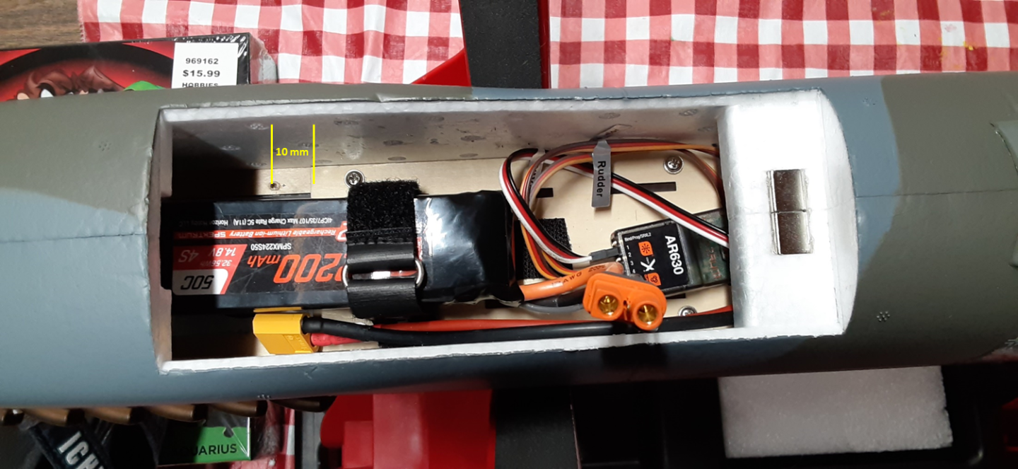

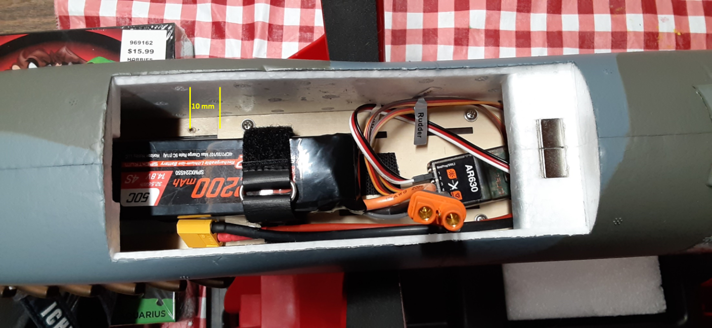

      • Hi,

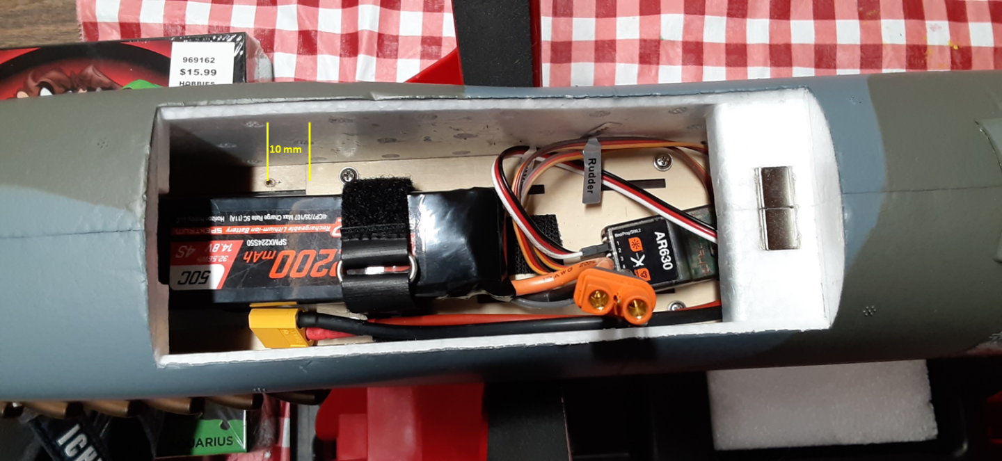

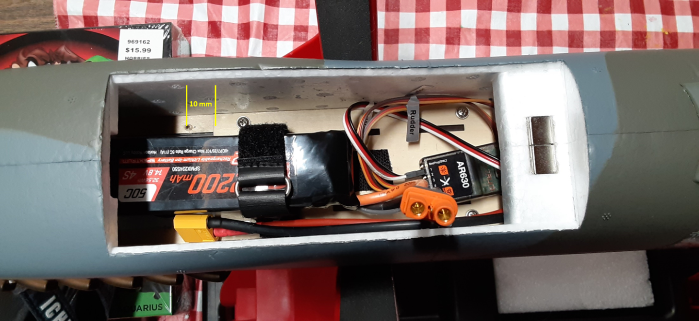

        I noticed a couple of folks asking about RX mounting.
        Here's my work in progress with my New 1200mm Spit.
        1. I unscrewed the plywood mount from its staves
        2. I shifted it back about 10mm from the front edge to the center of the original front hole.
        3. I used a 1/16" drill bit and a pin vise to drill 4 new mounting holes
        4. I moved the fastening strap to the forward position
        5. Installed Velcro on the mount
        6. I think I'll add another piece of 1/8" plywood to extend the front edge of the mount
        7. It looks like I'll have plenty of room to mount my AR630 with this mod.

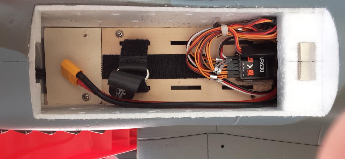

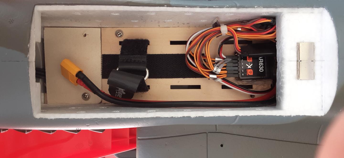

        • To continue on with my Spit story:
          Here is the final compartment buildout:
          Click image for larger version  Name:	20230212_100658.jpg Views:	0 Size:	89.0 KB ID:	370858
          You can see my AR630 installed, and I extended the plywood floor using some hobby
          plywood bought at Hobby Lobby (below)
          Click image for larger version  Name:	20230212_100848.jpg Views:	0 Size:	133.0 KB ID:	370859
          I paid about $3.50 for these.
          I wound up adding a few more zip ties to the Servo Wire bundle and re-positioned the
          bundle to the opposite or "bottom" side from what is shown above.
          Tucked the wires to the right to get them out of the way of the ESC battery cable
          and I was done.
          I used an Admiral 4S 3000 mAh 35C battery and pushed it all the way forward.
          This put my CG at around 76.6 mm from the wing edge ( which is 1/2 way between
          the Manual's recommendation of 73 mm and some others of 80 mm). This is slightly
          behind the black line on the wing of the PNP version. I use a $10 digital caliper from
          Harbor Freight. Works like a charm. (BTW they also sell a 3" line level for $1.29 that
          is great for making sure your plane is level when measuring cg).
