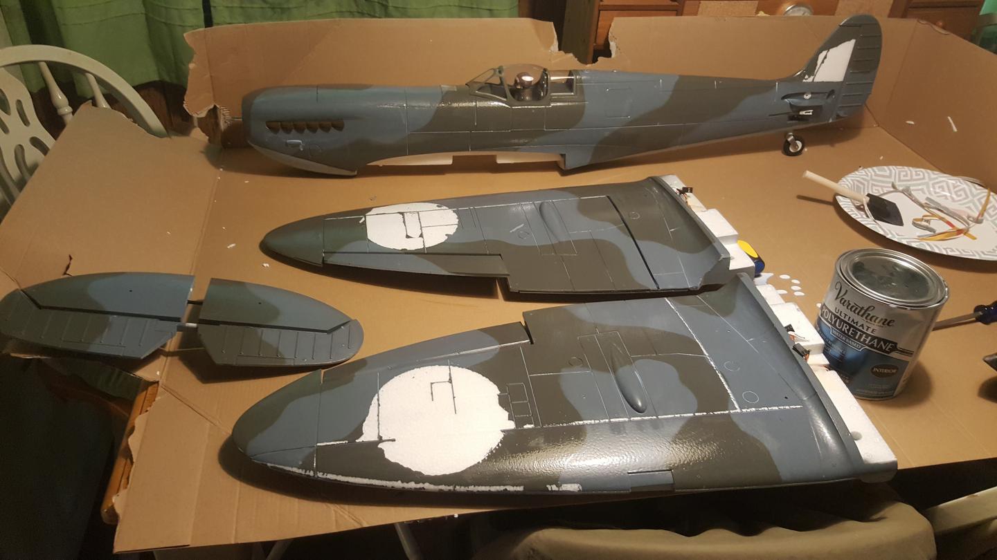

                                      #178
                                      Just started on my Spitfire, going for a total repaint in Russian Scheme...Wanted to do something different and my first foam repaint and mod, starting off by giving the whole thing approx 6 coats of Poly and sand between coats, will give updates as the project continues. Click image for larger version

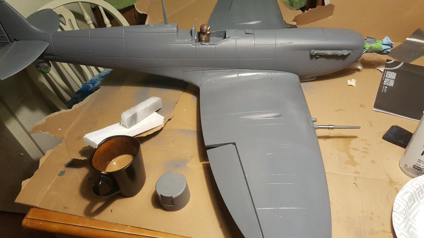

                                          #180
                                          Got it all coated with Polyurethane and wet sanded, and Primed. Click image for larger version
