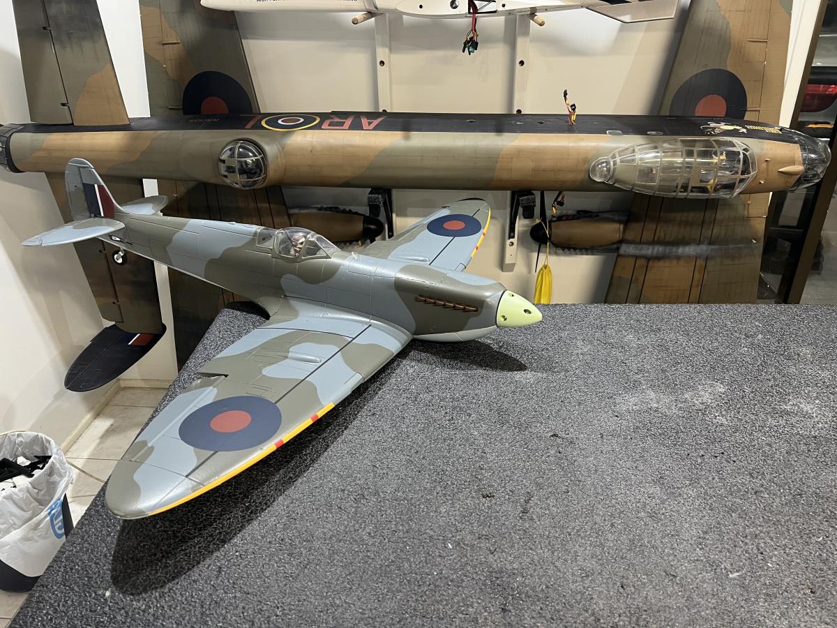

              Late to the party, but I just got my hands on a un-started 1200mm spitfire! I really wanted this smaller one as its the same scale as my Lancaster.
              She will get a bit of love to make her look a little more scale, and then one of my flying buddies will have the job of flying her around while I steer the Lanc.
              Just need the new XFly Hurri and I have the BBMF flight sorted!
