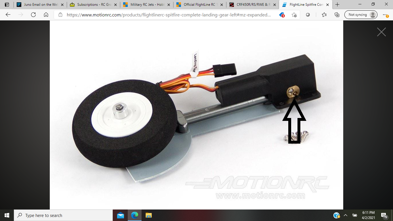

                              Hi folks - hey Highland, ( Or indeed anyone else ) do you think you could post a picture of where that grub screw is? I am wondering if I am missing something or just being dense. Thanks !! :-)
                              EDIT:
                              Found them! Thanks.
                                • 5385
                                #215
                                When you extend the gear the set screws are in one of these holes...

                                  Thanks Evan, I had found them ( Having misinterpreted your first description) but I'm sure someone else will get it wrong like I did :-) Really appreciate your help.

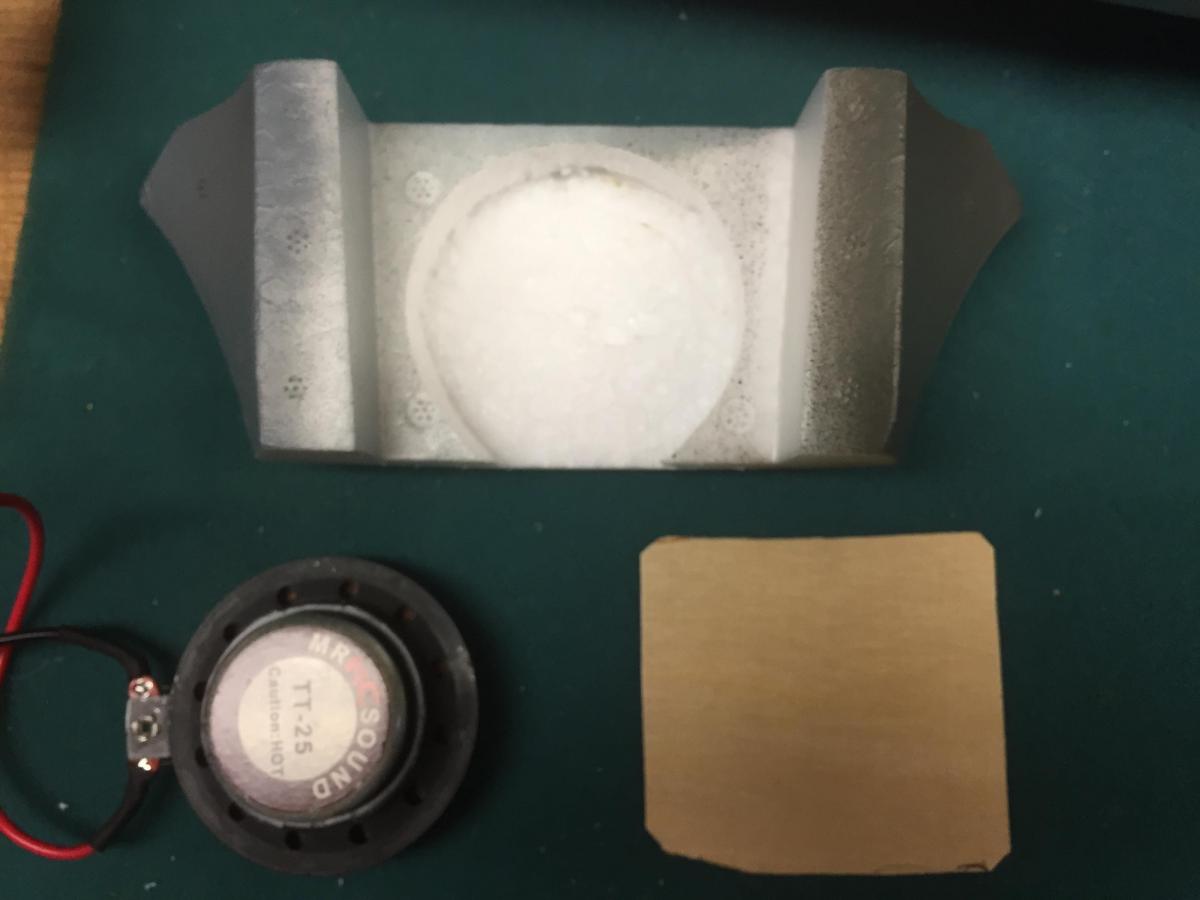

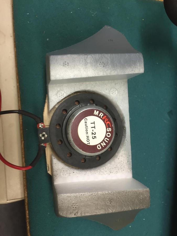

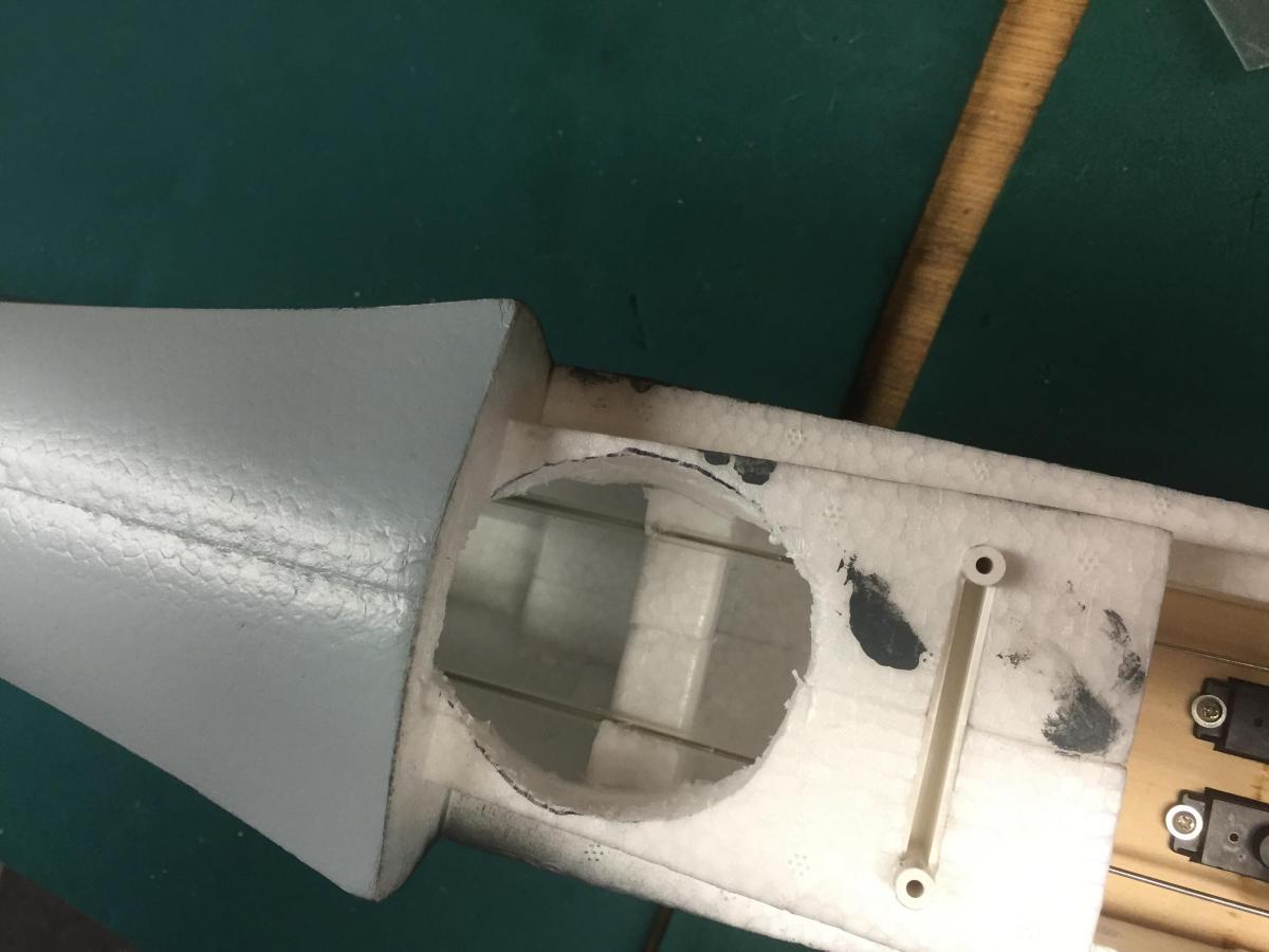

                                          #220
                                          I put a MR RC Sound in mine early on. The transducer was in a cutout in the block behind the main wing at the center of the fuselage and the board was at the rear of the battery area. I’ll see if I have any pics….
                                          I made the cutout and added a ply floor. Worked well. Later on I got more into FPV and got the 1600 Spit so I removed the system from the 12 and put it in the 16, where it still is. And I put a FPV system in the 12...
                                          . Click image for larger version  Name:	image-51e16a23.jpg Views:	0 Size:	55.8 KB ID:	314893Click image for larger version  Name:	image-e506614b.jpg Views:	0 Size:	52.5 KB ID:	314894Click image for larger version  Name:	image-169315bb.jpg Views:	0 Size:	72.3 KB ID:	314895
