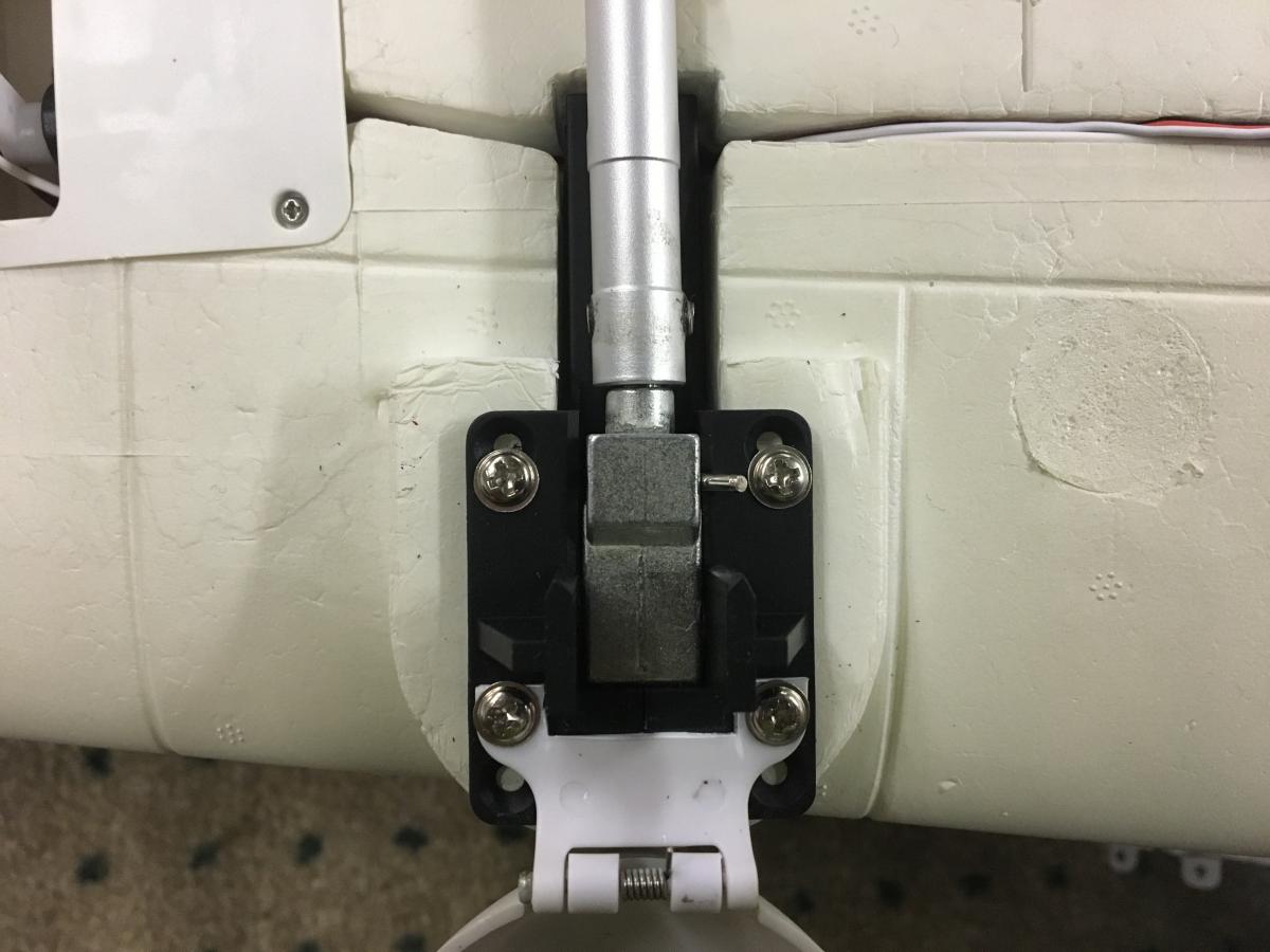

        I can confirm the FMS 1400mm P-40 retracts work great on the Skyraider, I had to cut a small amount of foam out at the front and rear of the retract cavity in the wing and re-drill the holes in the retract housing, the cover hinge needed some trimming and new holes as well.
        Click image for larger version  Name:	20171216_214740927_iOS 1.jpg Views:	1 Size:	87.5 KB ID:	109460
          That is most excellent news. She lives again! I was able to purchase one of th last remaining sets of HSD gear for the Skyraider, but hoping not to have to use th m for a while. Still on the originals, but not without pin hang-up issues.
          Thanks for for this great news TI!

            awesome! Thankyou TI .. I assume its also the struts from the P40 as well? can you take a photo of the whole assembly like that installed?
            www.TSHobbies.com
              #106
              No, I used the stock struts and wheels.

                      I had to drill out the strut tube to fit the FMS retracts.

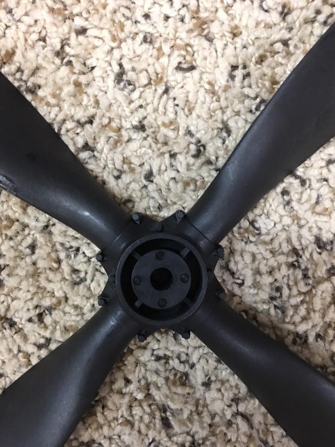

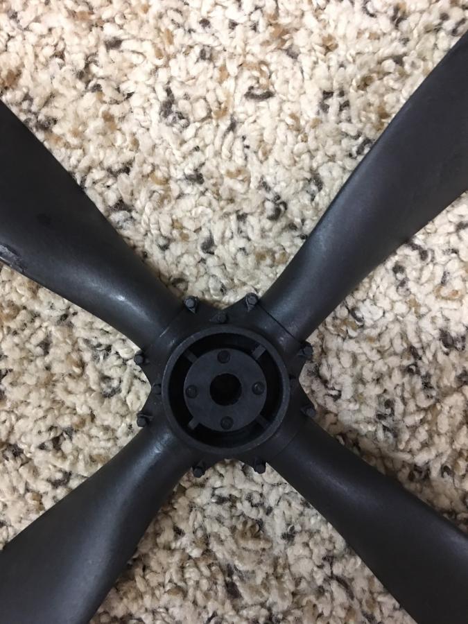

                        BearCat and TI, the HSD A-1 prop looks different from the previous versions on the site. Doesn't have the scale looking center. I hate that they've jacked up the price a little more and took the scale look away. I hope it's the same hard carbon-like plastic and not just regular soft plastic. Let us know what you think of it when you receive it.
                        Thanks!

                                Just ordered a couple of the props. The appearance isn’t as scale from the previous release, but gotta have it.

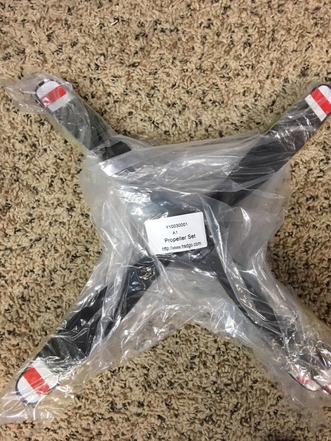

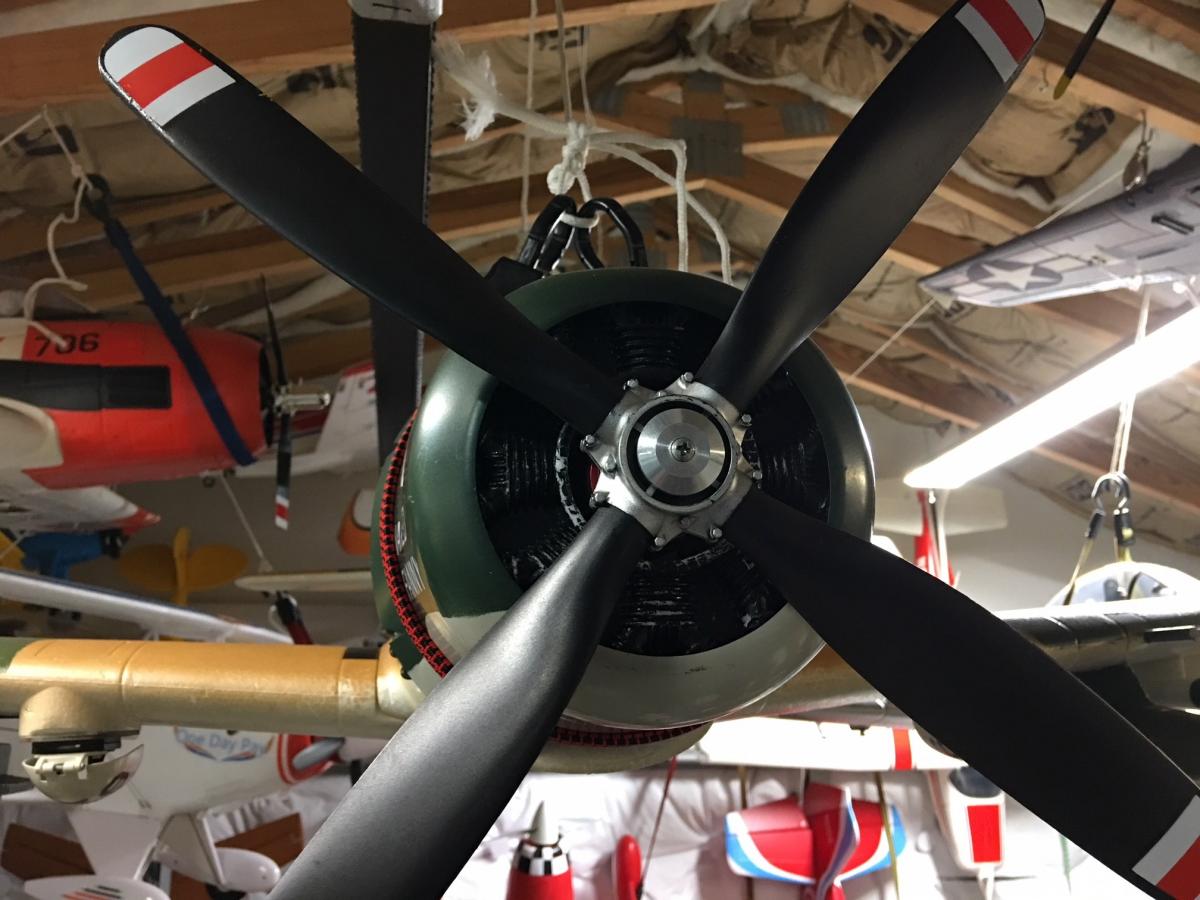

                                  Received my order extremely fast from HSD.GO for the A-1 props. Very surprised how quickly the order was processed, shipped and delivered. They could give BH some lessons since they are related now.
                                  Any-who...so glad to have gotten another set. Didn't realize that I had 2 back ups already. But can never have enough of this particular prop. We'd be in trouble without it.

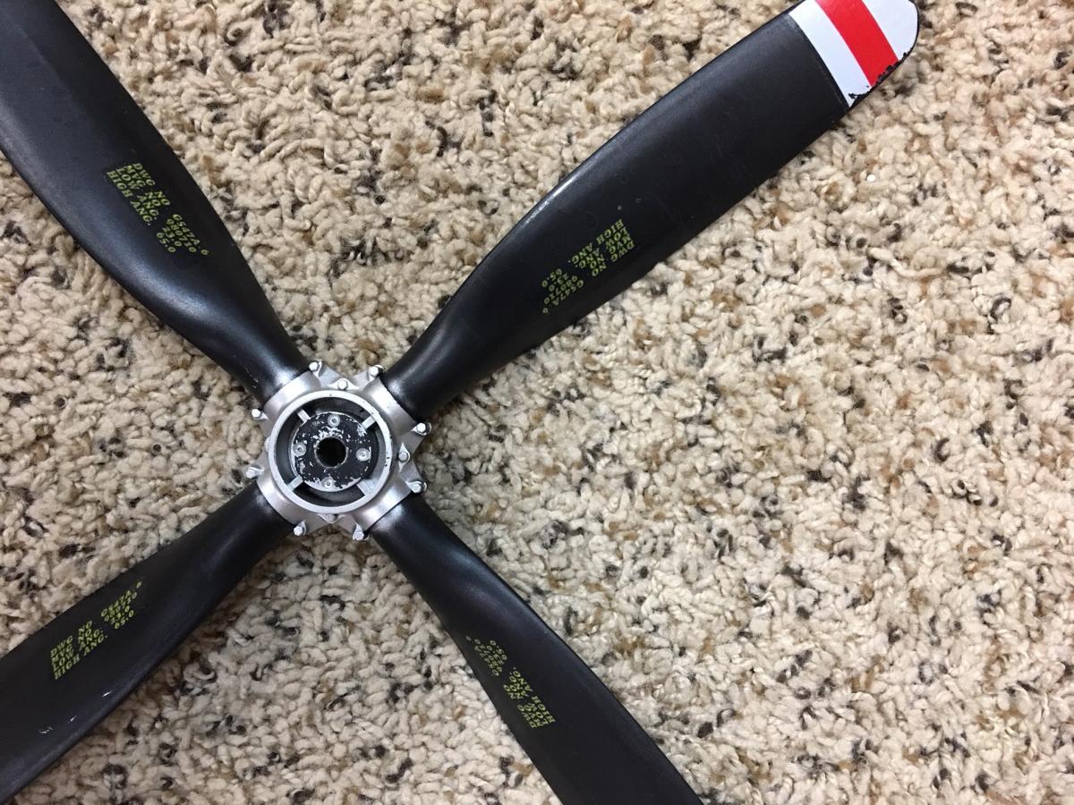

                                  I have the original Starmax version in the camo scheme, with the original retracts still operating. Will be doing the pin modification on them soon though. I do have a back up of the new retracts waiting for the day they decide to crap out or break.
                                  I was afraid that the replacement prop would not be the same quality, but it is basically the same. The only difference is that they are no longer painting the hub in silver color, and not quite the same build (structure). I'll work on getting mine lightly painted to give it that more scale look, while keeping it in balance.
                                  NEW PROP WITH NO PAINT ON THE HUB
                                  Click image for larger version  Name:	New prop no paint.JPG Views:	3 Size:	97.0 KB ID:	114865
                                  TWIN PACKED VERY NICELY (TWO PROPS IN THE PKG)
                                  Click image for larger version  Name:	Twin packed.JPG Views:	1 Size:	139.9 KB ID:	114866
                                  CAMO SCHEME WITH PREVIOUSLY REPLACED PROP (PAINTED)
                                  Click image for larger version  Name:	Camo scheme.JPG Views:	1 Size:	113.1 KB ID:	114867
                                  ORIGINAL PROP THAT CAME WITH PLANE (The structure of the blades were more carbon-like, not the softer plastic. Made an incredible sound in the air. Engine type sound!
                                  Click image for larger version  Name:	Original prop.JPG Views:	1 Size:	215.5 KB ID:	114868
