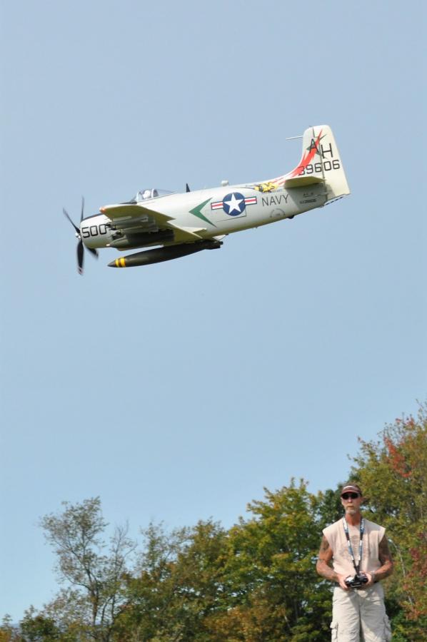

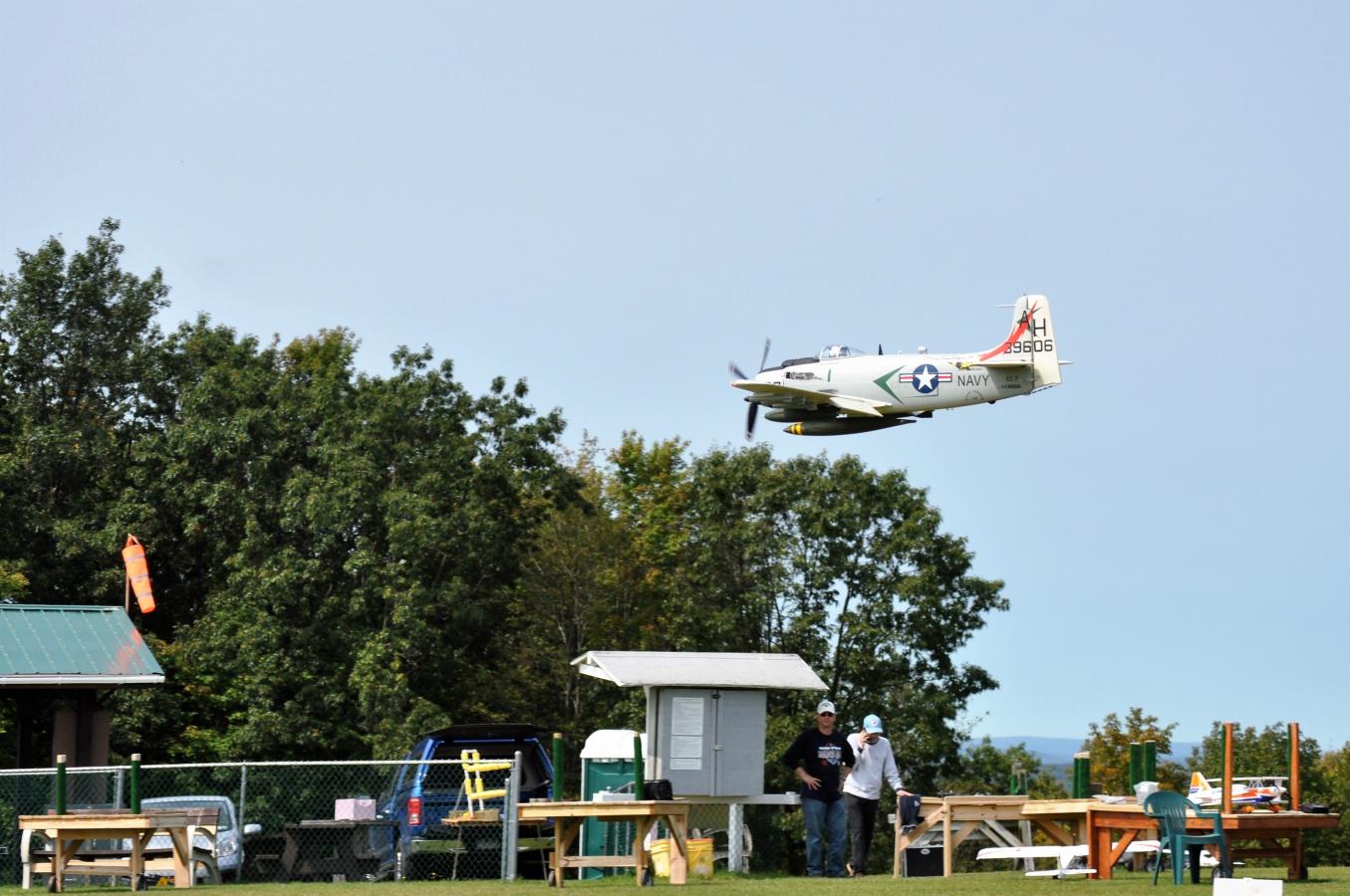

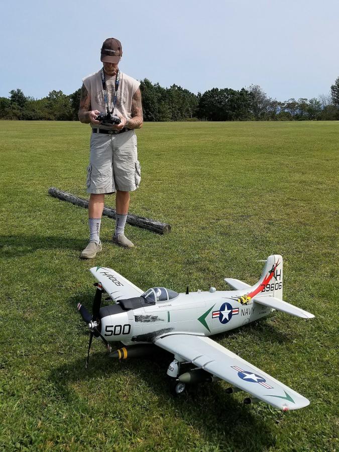

                Here are a few pics of my newly complete A1. I love the foam this plane is made with and really look forward to flying it this spring!

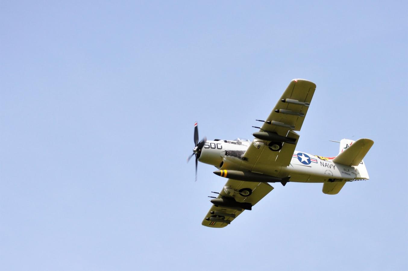

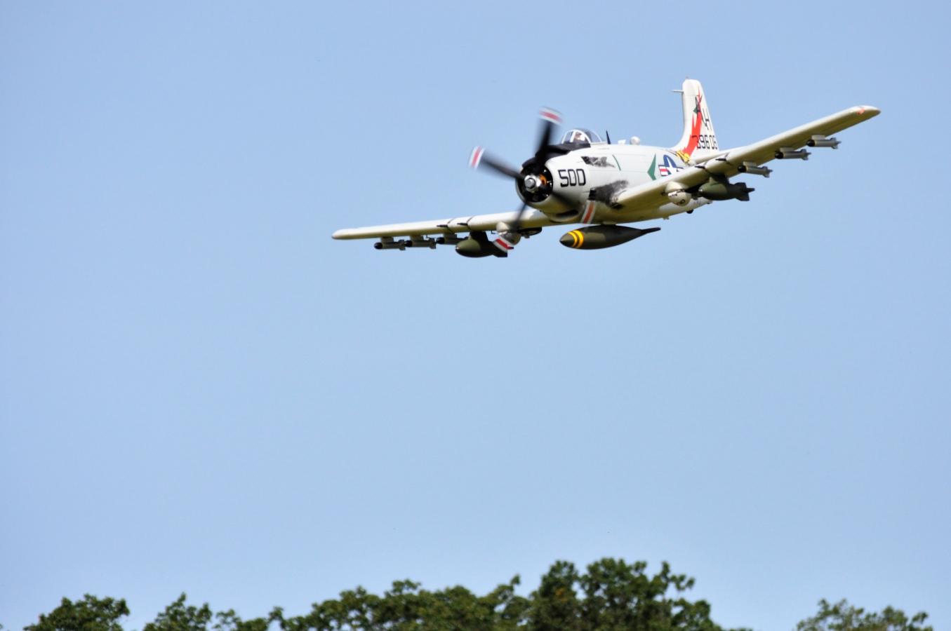

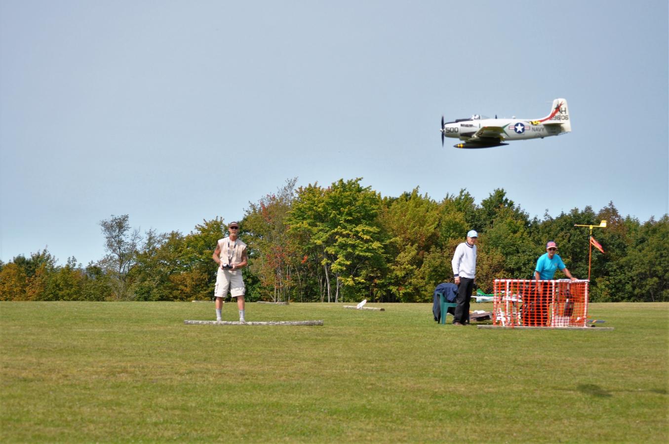

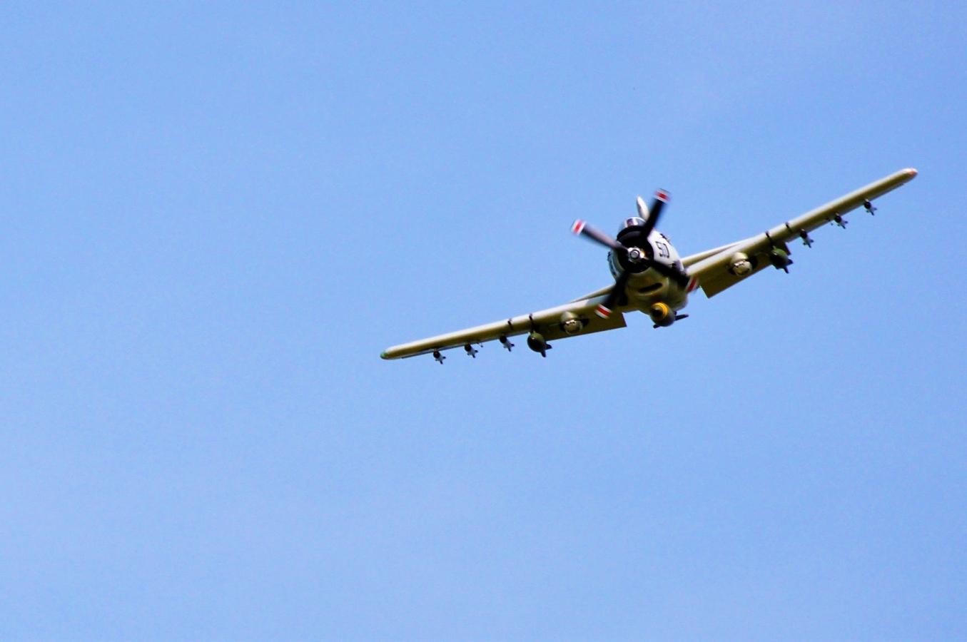

                    The HSD Skyraider is one of the best built planes I've ever seen, I just don't understand why it had such a short lifecycle...I wish Flightline would buy the molds and refine it even more.
                    I had also indicated this back in post#28 so just wanted to keep this thought alive for Alpha by posting some Sandy "blast in the recent past" flight pics.
                    Alpha, give us 1700 Sandy...........plzzzzzzzzz.

                      Yeah! I like it!

                        That’s a VA-176 Thunderbolt’s A1.
                        I was a Thunderbolt from 1981-1984... A-6E Intruders and KA-6D Tankers
