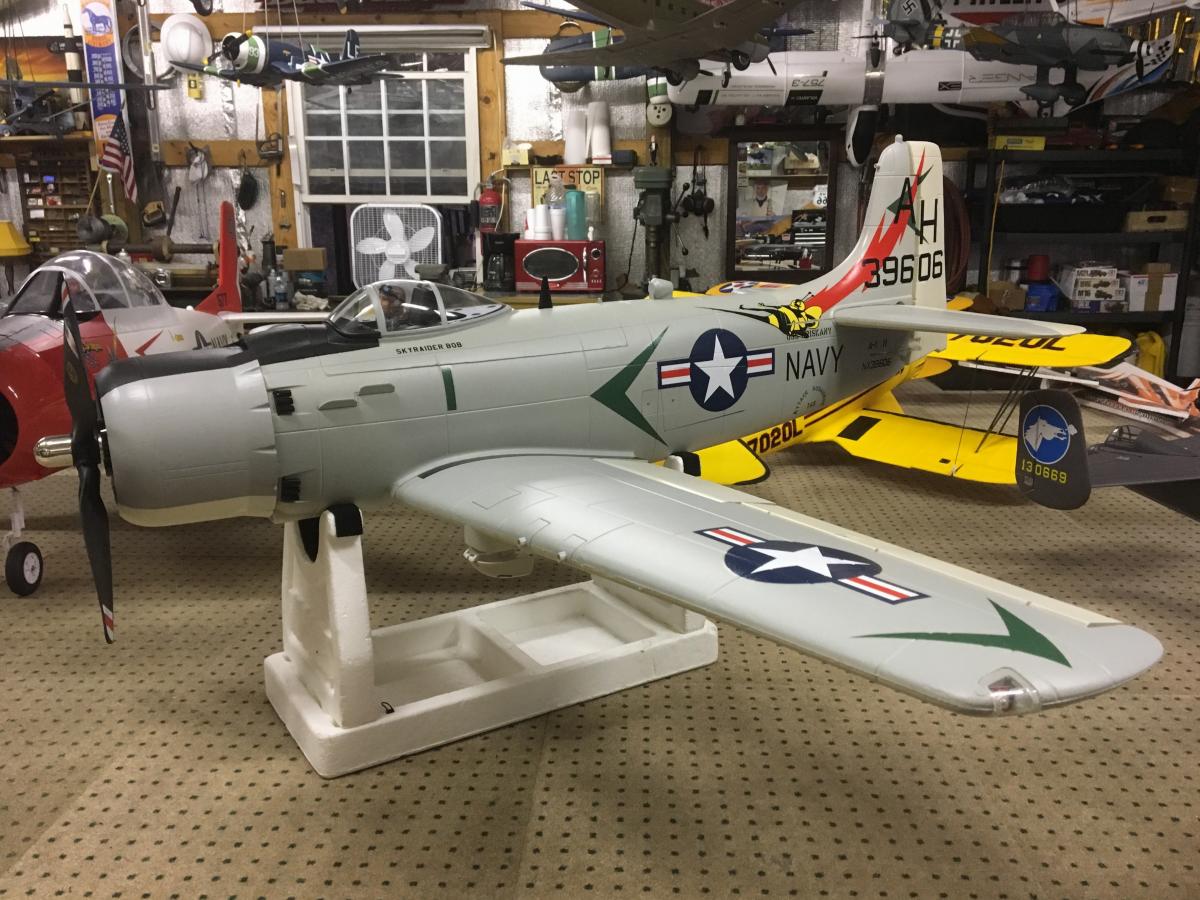

                            I picked up one of these at eWeek that was new but had been robbed of the ESC, right retract (retract only), prop and cowl...I have replaced everything except the right retract.

                                  #56
                                  Where did you get the cowl from?
                                    #57
                                    In a pinch that Corsair cowl looks really good on it. :Cool: and the scale police can go buggar. :PLOL
