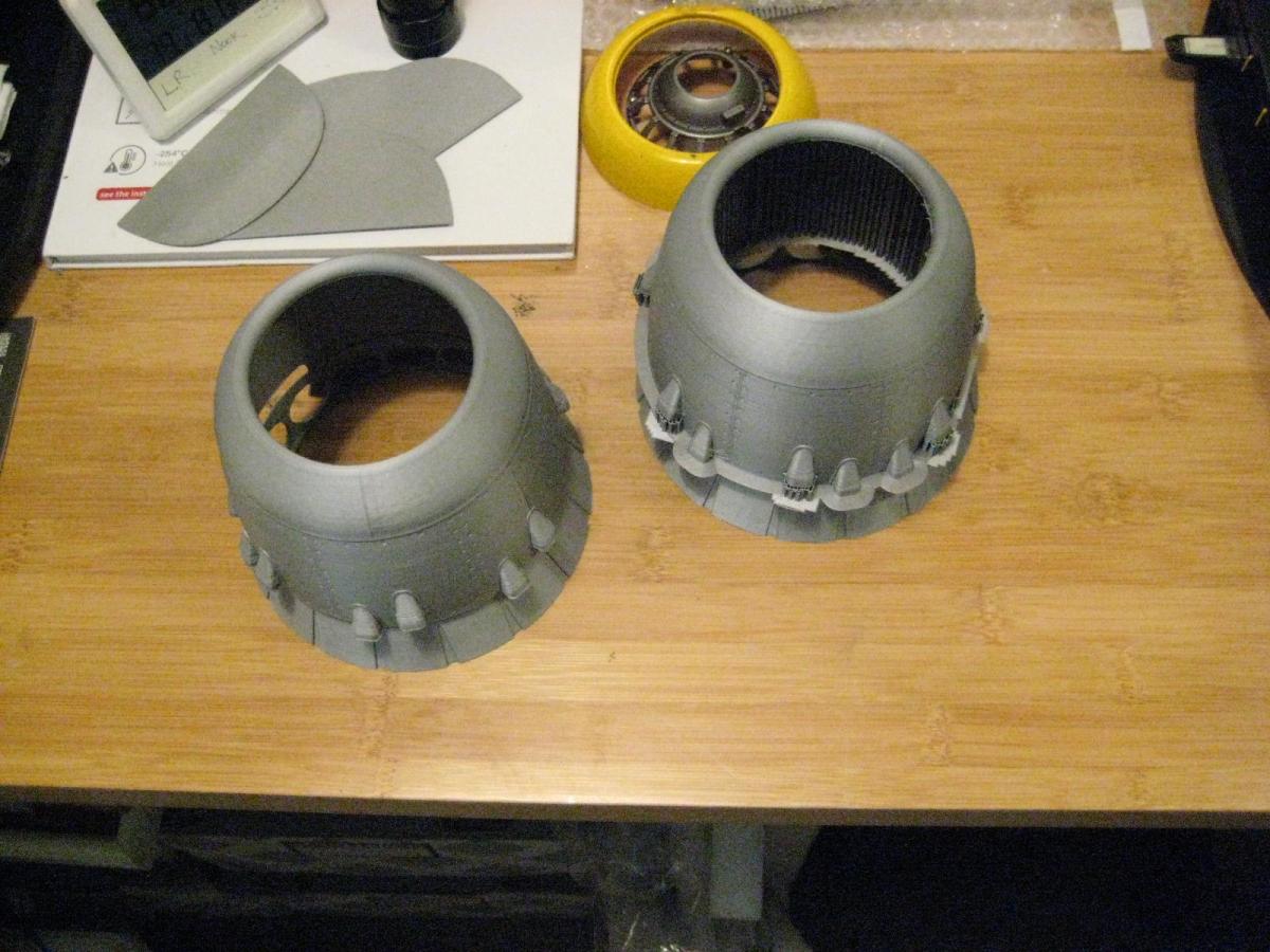

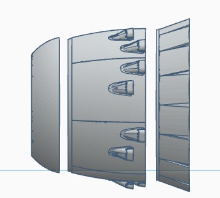

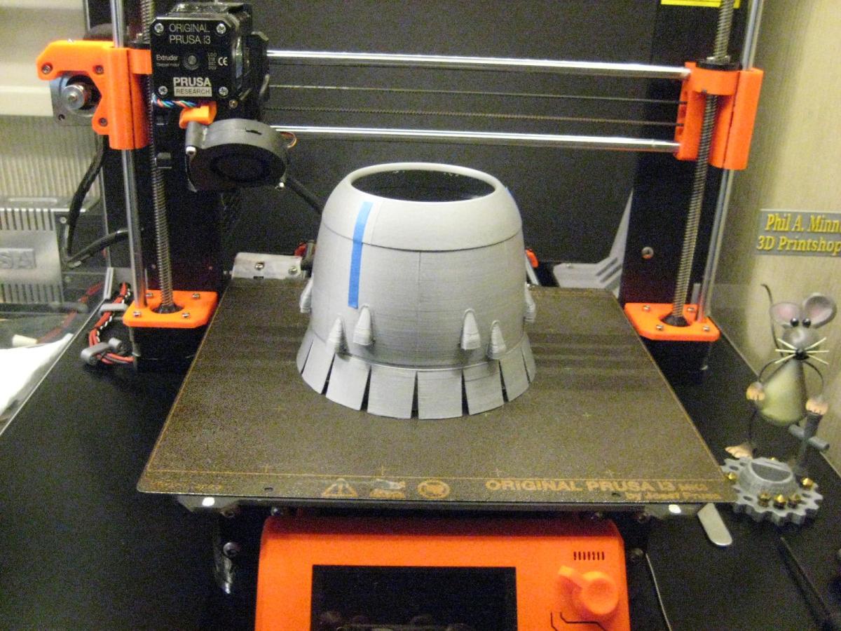

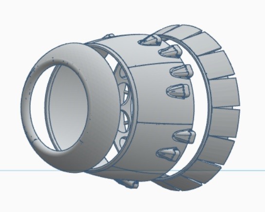

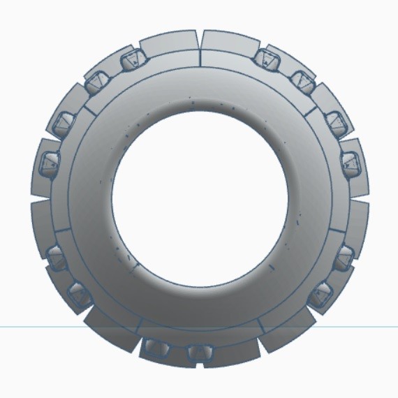

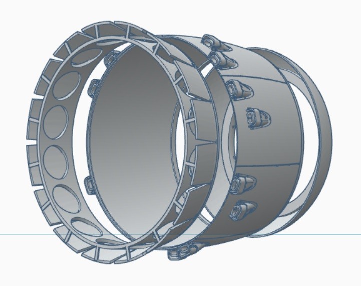

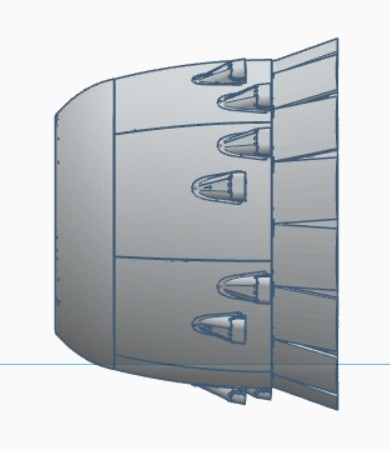

    Those are 2 parts, the cowl ring and engine cover panels.
    It could be printed in one part, the whole assembly could be printed as one part.
    I like to break designs into parts, I get better results and it is faster to reprint a change to the design.
    This project will be 3 parts, Cowl Flaps, Engine Cover Panels, and Cowl Ring.
    The images are screen shots of the Isometric View in TinkerCAD and a photo of the printed assembly.
    I have a couple ideas for mounting with simpler foam surgery versus the Corsair.:rolling_eyes:
    This is fun for me, Tamms thinks I should just assemble these models, mow the yard, and then go flying.
    She may be right.
    We did buy 4 Kayaks, don't ask, and all the Kayaking stuff :moneybag:"OUCH", so I'll have some other distractions this Fall.

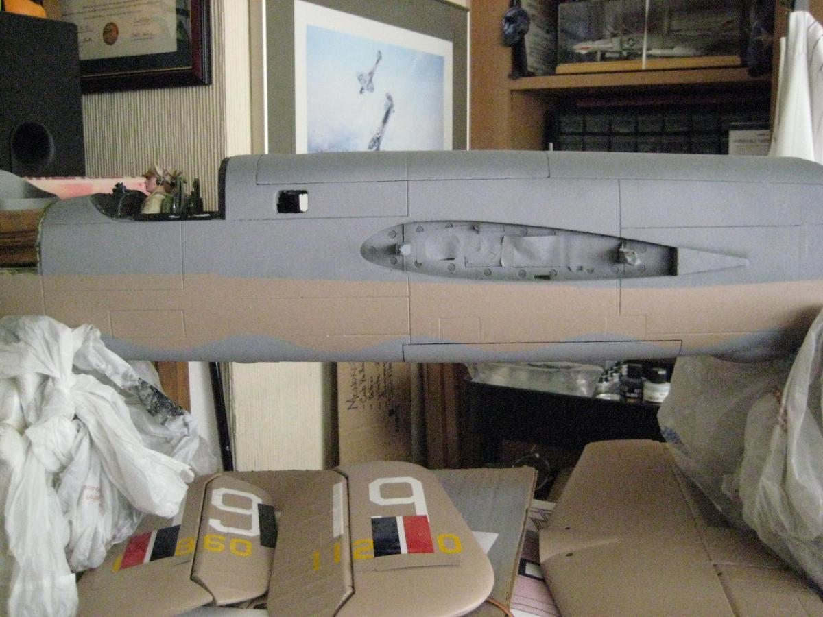

      I noticed that the Desert Warrior had the 'scalloped' line between the upper and lower colors.
      I thought it was straight.
      In any event, I counted the ups in a reference pic and cut a template using a circle template (the lid of the Yellow Frog Tape container) to height of 3/4 inch up to down, if that makes sense.
      Looked pretty good, so I used it and I like the outcome.
      Next, cutting the engine panel and cowl flaps from the wing section and adding the 3D Printed parts.

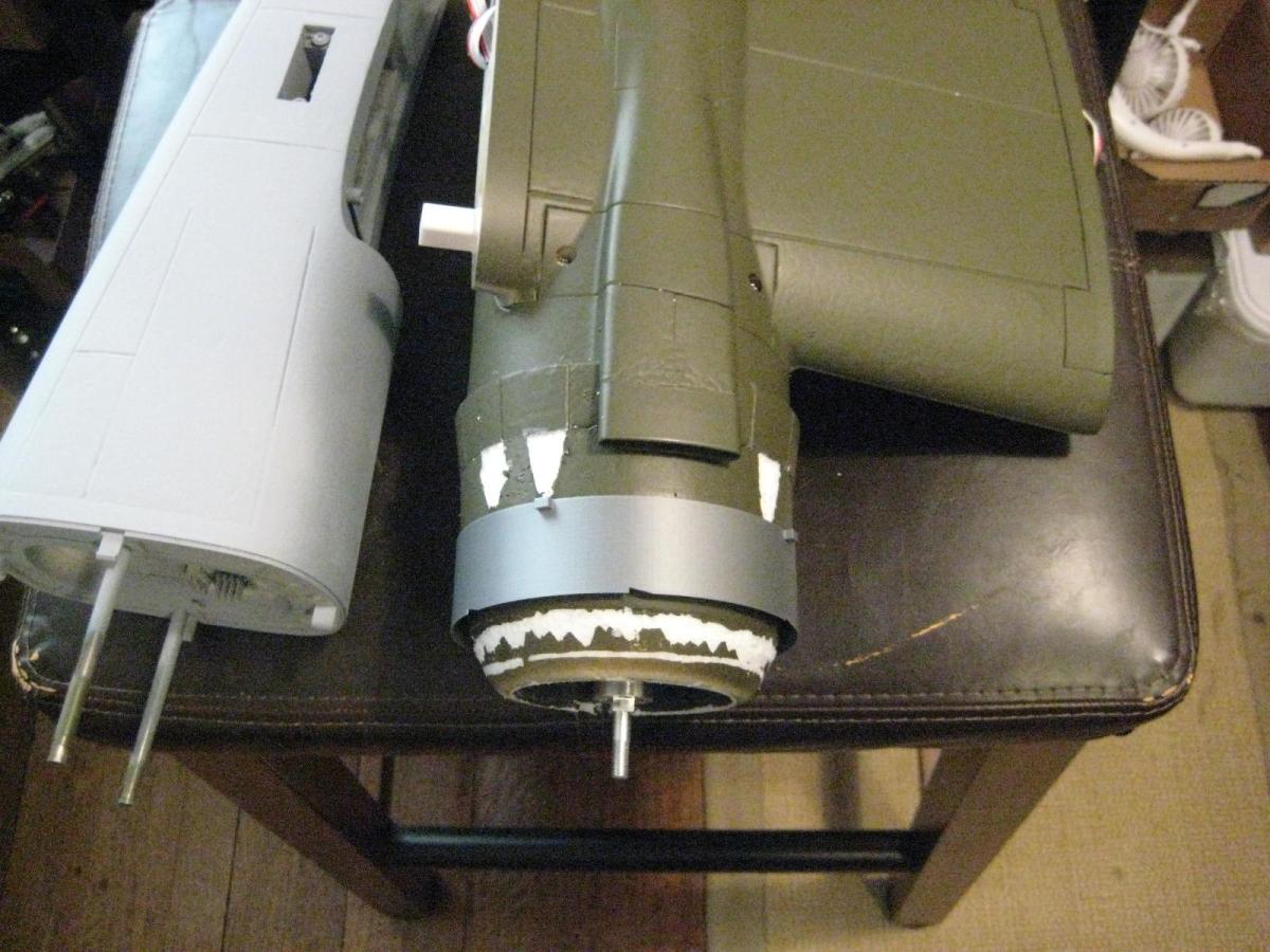

            All,
            Quick update, got all the cowl parts printed and glued.
            Foam surgery completed on one side.
            Designed a little alignment tool to keep the cowl on the thrust line.
            I had reported earlier that there was 'no' down thrust built in and that is just plain wrong.
            Quite a bit actually, but when looking at the nacelle, the cowl ring lined up square to the prop line, however, that has maybe 3 degrees of down.
            In any event, I was wrong and had to design an alignment tool for gluing and do a little more foam surgery for fitment. (is that even a word?).
            Next some clean up, then primer and paint for the cowl parts, maybe even a little weathering before gluing those on the nacelles.
            Best, LB
