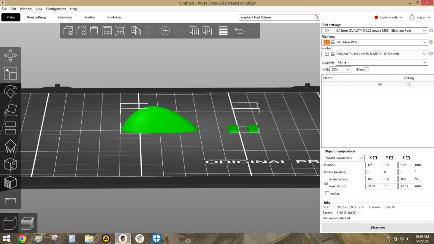

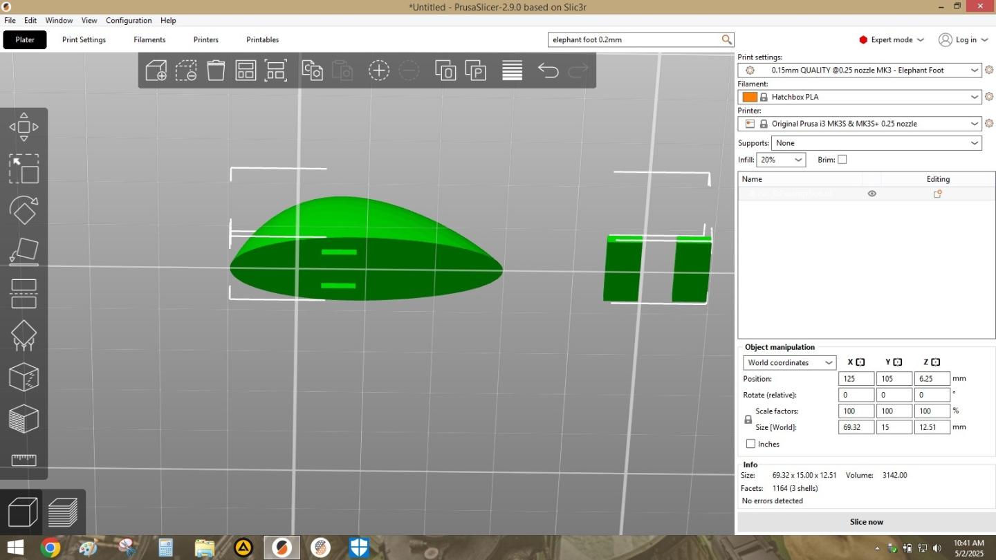

      B-25C_RrFuselageSkid.stl
      Hey All,
      Quick post.
      In the process of working on the empannage for this beauty, I naturally mushed the foam tail skid into an unrecognizable something.
      So, I figure so have you in one form or another.
      Quick print and I recommend using 'elephant foot' compensation of 0.2mm so the pins will fit easily into the skid.
      Frankly, you can simply glue the part on without the pins using 'kit glue'.
      More when there is more.
      Best, LB

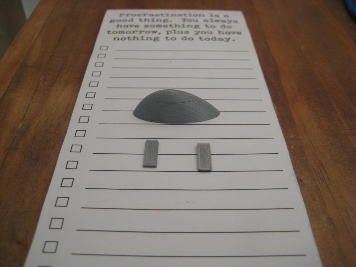

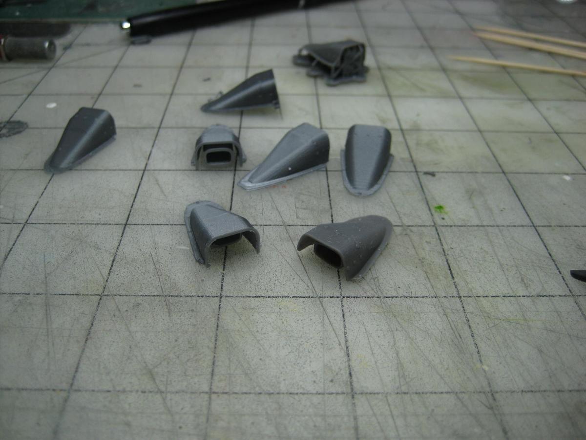

        Hey Y'all,
        Experimenting with FLM v SLA parts of the same design.
        What detail I designed in is not gonna show much, but it is there.
        I am having some issues with warping on the SLA parts pre-curing which might require a design change or a resin change.
        Cracks me up to see the differences, even though it isn't much.
        As of today, if I had to choose, I pick the FLM parts considering once primed and painted, whose gonna see the differences?
        Best, LB

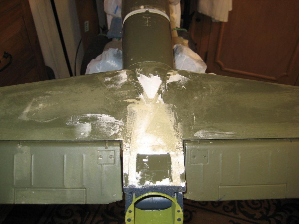

          Hey All of who are still with me...
          Started on some filler work.
          EPO is just not much for sanding, however, filler is.
          So I have taking the foam down and refiling it where I can.
          Click image for larger version  Name:	IMG_2176.jpg Views:	0 Size:	96.2 KB ID:	425999
          Worked well on the Corsair, but adds a little bit-o-weight.
          More after Memorial Weekend, enjoy and "Never Forget".
          Best, LB

                  • 4870
                  #150
                  borntoolate
                  Thanks Bob,
                  I like the Sherwin-Williams light weight spackle as recommended by The RC Geek but it is NOT intended to be structural.
                  I designed a little reinforcement box for that area, Looks okay.
                  Best, LB

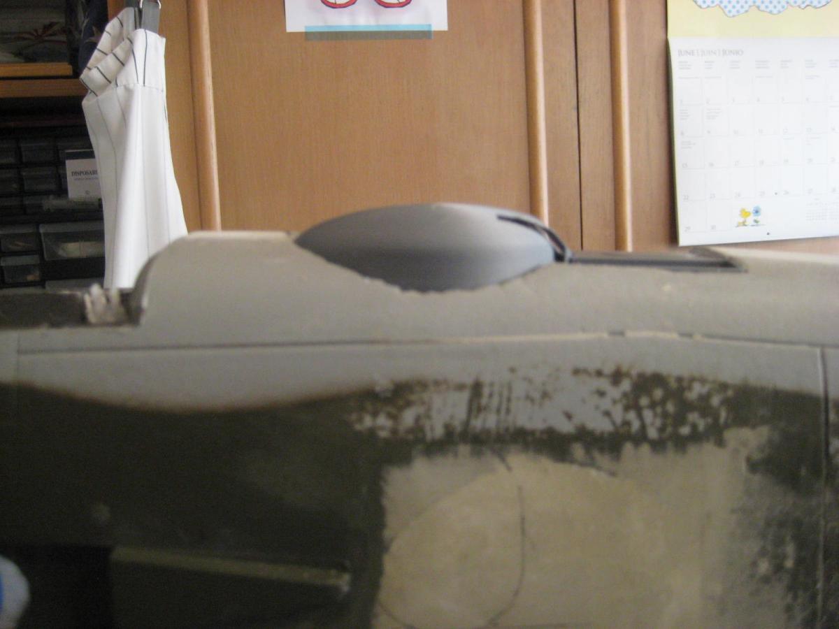

                    Hey All,
                    I did not like the way the 'free hand' fairing looked, so I scaled the part off of my decal placement sheet and printed a little template to form the filler.
                    Won't be all that noticeable, but this covers more exposed foam I had cut away and is closer to correct.
                    Next is cutting the hole for the bottom fuselage gun turret and start the filler process on the fuselage and the first Minwax Poly coats.
                    Best, LB

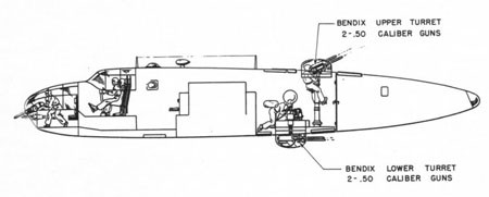

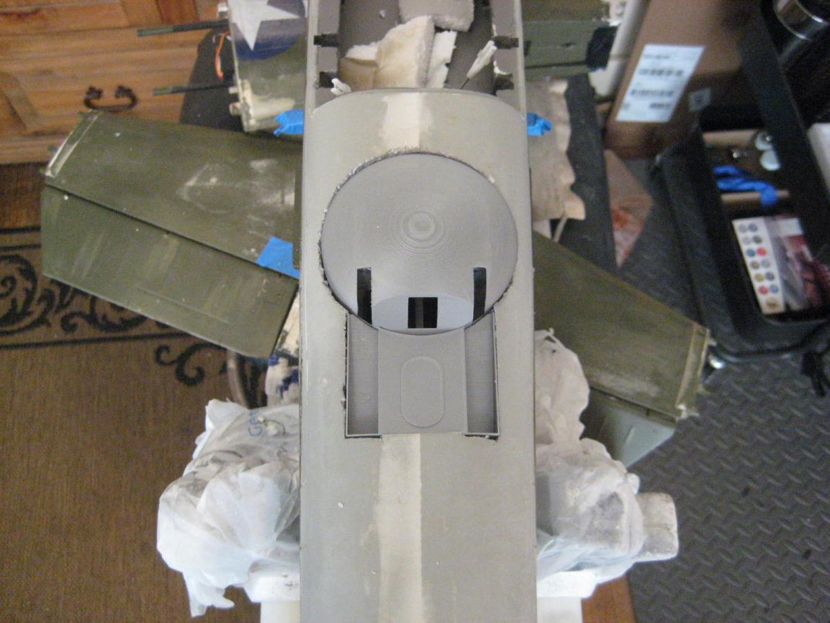

                        Mitchell Mob.
                        Quick update on the turret design.
                        Dry-fit the Bendix Model K Ventral Turret.:face_with_raised_ey
                        It had a scanning lens gun-sight with the Operator inside the fuselage.
                        I can see why this was later modified to a tail gunner.
                        Best, LB

                                • 4870
                                #157
                                Originally posted by borntoolate
                                Very nice, LB! Looks good.
                                Bob
                                Good to hear from you, Bob.
                                I'm currently priming and sanding the horizontal and fuselage.
                                The rigid pink foam sands too well compared to the EPO and keeps showing up as a seam line as I sand the primer.:rolling_eyes:
                                I did all the filling and did not notice that until I applied the primer, typical right.:confounded:
                                I am going to have to make some compromises and hope some weathering will cover the seams.:unamused:
                                Hope all is well with you and yours.
                                Best, Steve
