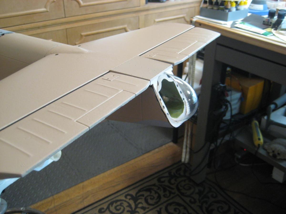

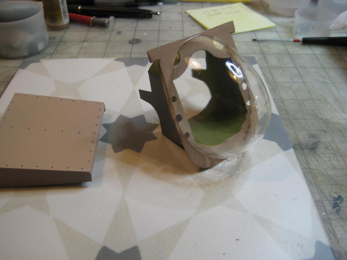

    Sized windows and doors, designed/printed frames for those and with surgical precision cutout the holes ....
    I then glued the frames to the fuselage, filled where required, primed and painted color.
    I like it a lot though I will need to do an overall quick wet sand to even out the paint lines.
    I had already cutout all the plexiglas bits, so after I paint in the window sills, I'll glue those into place.
    This is a good step forward to finishing the fuselage.
    Looking forward to finishing out the greenhouse and gluing in the cockpit glass.
    Best, LB

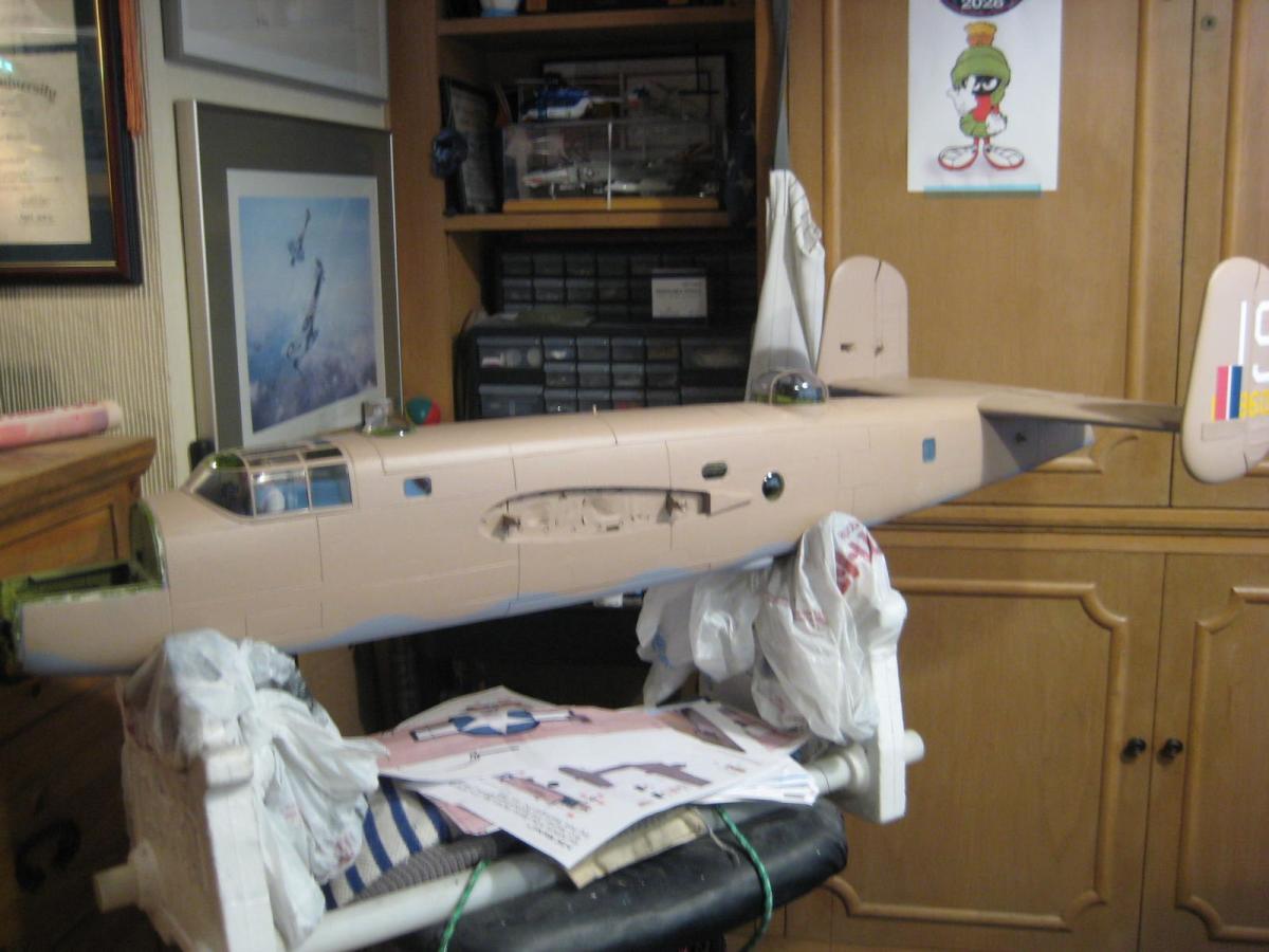

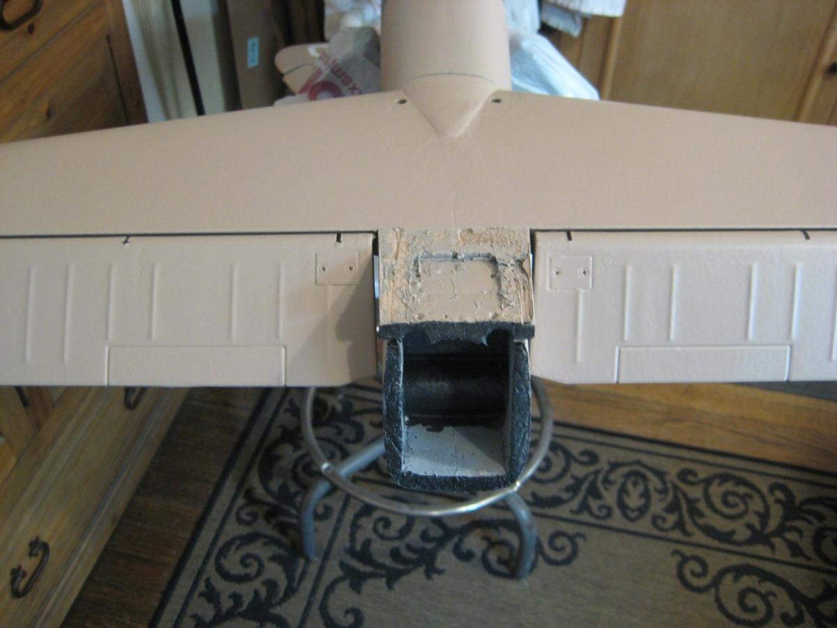

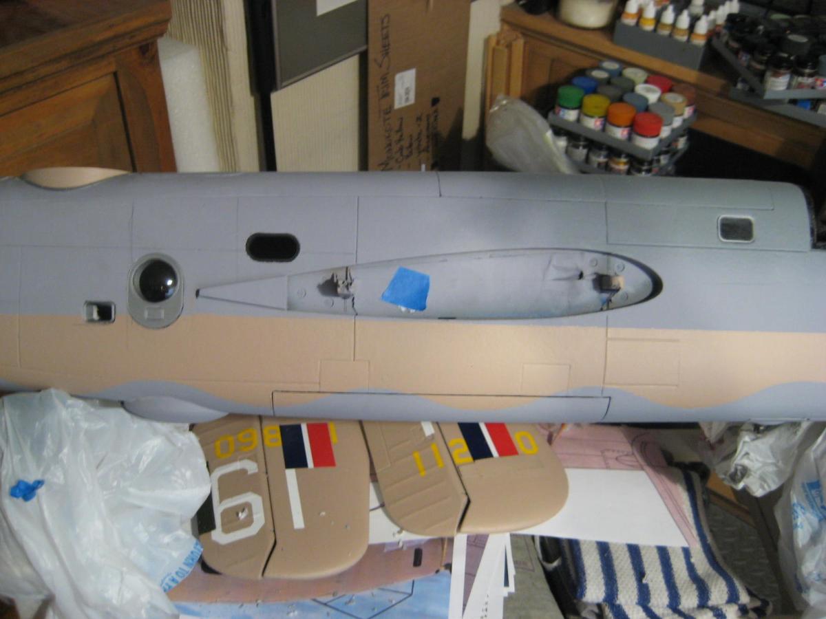

              Hey All,
              Fuselage is nearly completed.
              Got all the clear Plexiglas glued in place including the cockpit glass.
              Attached the empennage, then filled and painted all the seams and holes top and bottom.
              All the parts are finished and painted for the nose 'greenhouse', though some "assembly is required".
              Had to resist the urge to start adding markings and nomenclature, we'll see.
              More when there is more.
              Best, LB

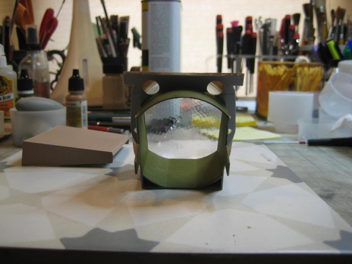

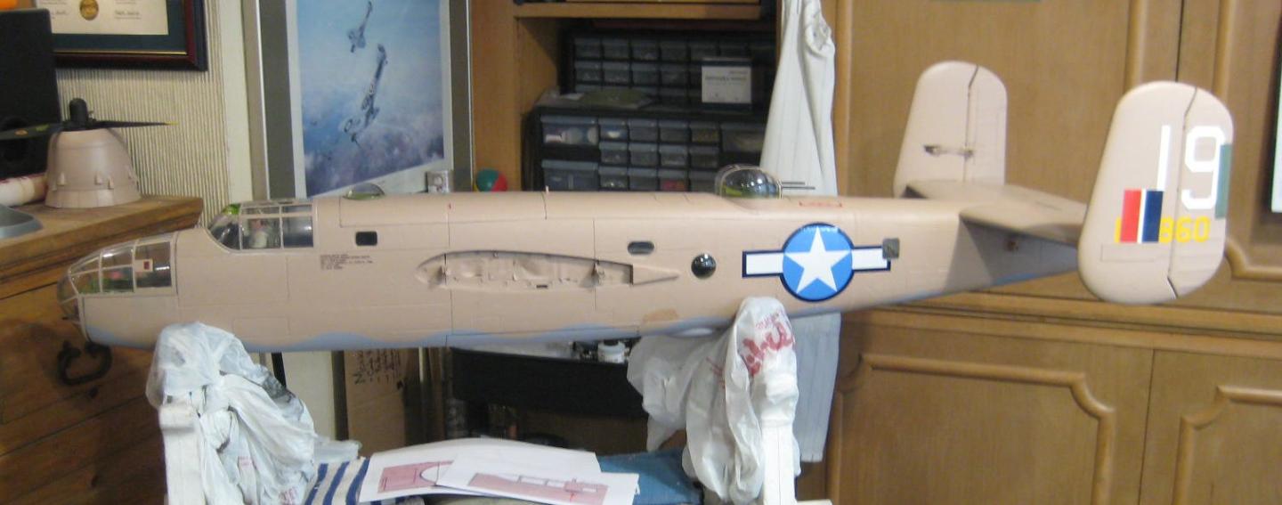

                  Bomber Bunch,
                  Happy (belated) Thanksgiving, Y'all.
                  I applied some of the Callie Graphics markings and nomenclature to the fuselage.
                  Starting to come to life...
                  Finished the hard mounted 50 cal guns and the 50 cal pivot bearings are glued to the 'greenhouse'.
                  Next is mounting the ammo boxes, nose-50 cal and belts.
                  Once that's done, the whole greenhouse will be re-glued to the fuse.
                  Best, LB

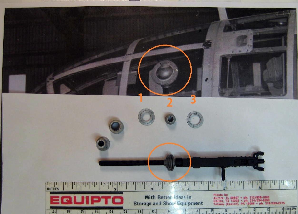

                    Fantastic, those gun swivels look great. Did you design them? I have been looking for those for my B-26 and TBM Avenger lower gun turret. Won't be long now for air to get under her wings.
                    Best Regards, Rex

                      Yeah, my design and these pivot if you're careful about how you glue 'em in place.
                      I designed a couple jig parts to hold the parts in place while the glue dries.
                      3 Actual Parts: 1. Inner Frame, 2. Pivot Ball, 3. Outer Frame.
                      Don't know what size your B-26 is, but scaling these much smaller would not allow the pivot.
                      These could be printed in any size within reason, glued in place without the actual movement.
                      Best, LB

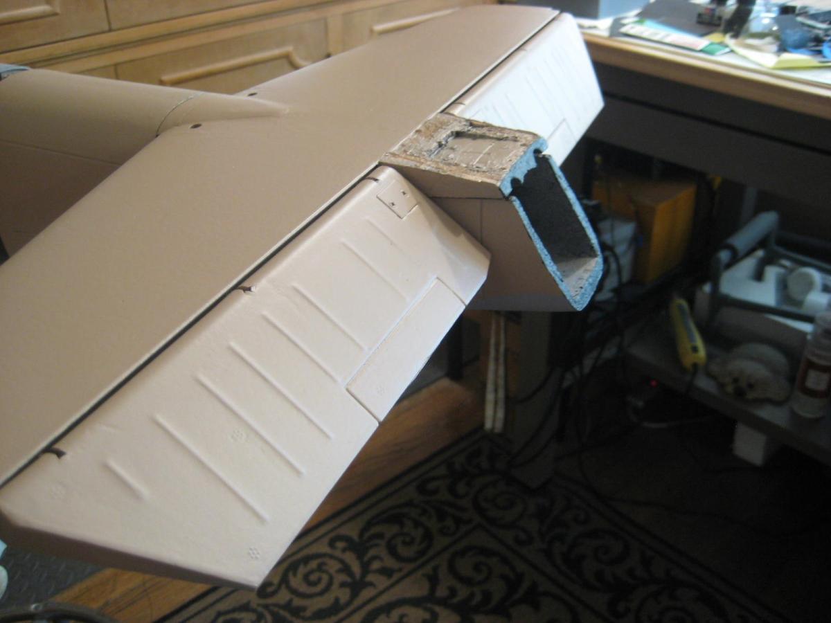

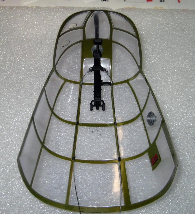

                            Hey Bomber Brethren,
                            Kwik update...
                            Installing the forward 50 Cal in the greenhouse.
                            Added the counterweight cables and pulleys each side.
                            This, along with the forward interior brace (non-scale) and the pivot bearing, should be enough support for the main gun part to allow a barrel change when I break one.
                            In any event, plan for the worst and hope for the best.
                            Best, LB

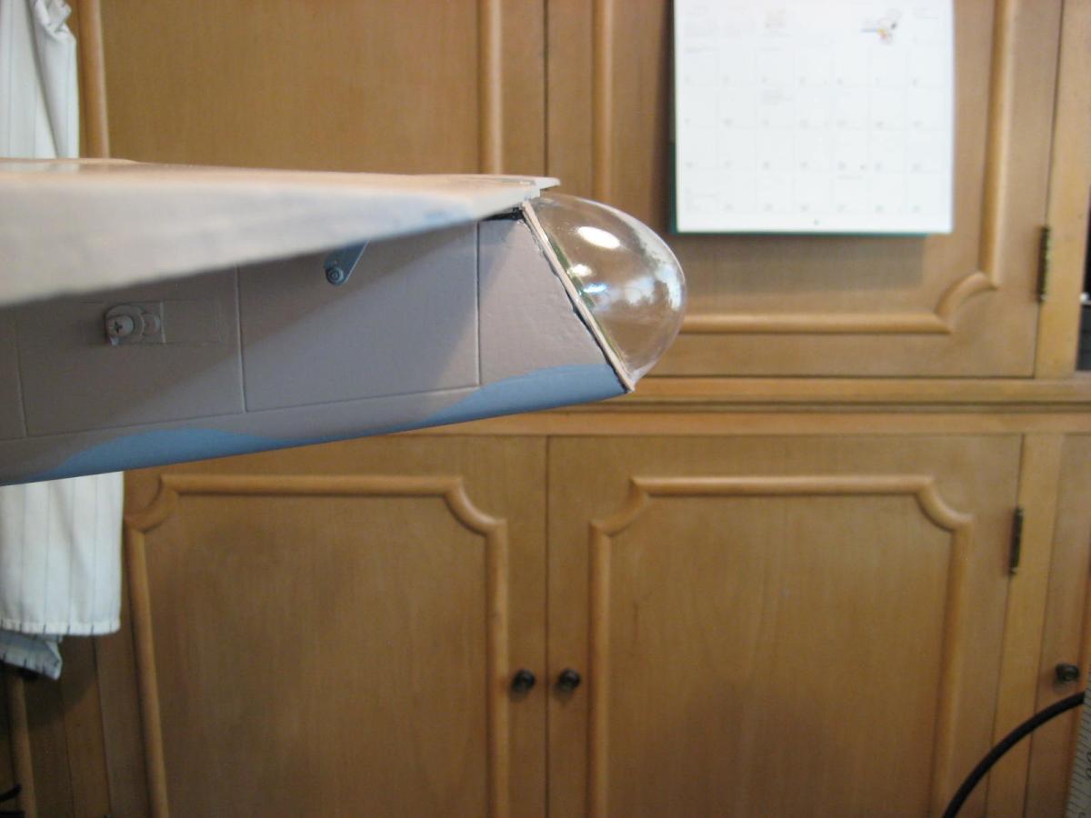

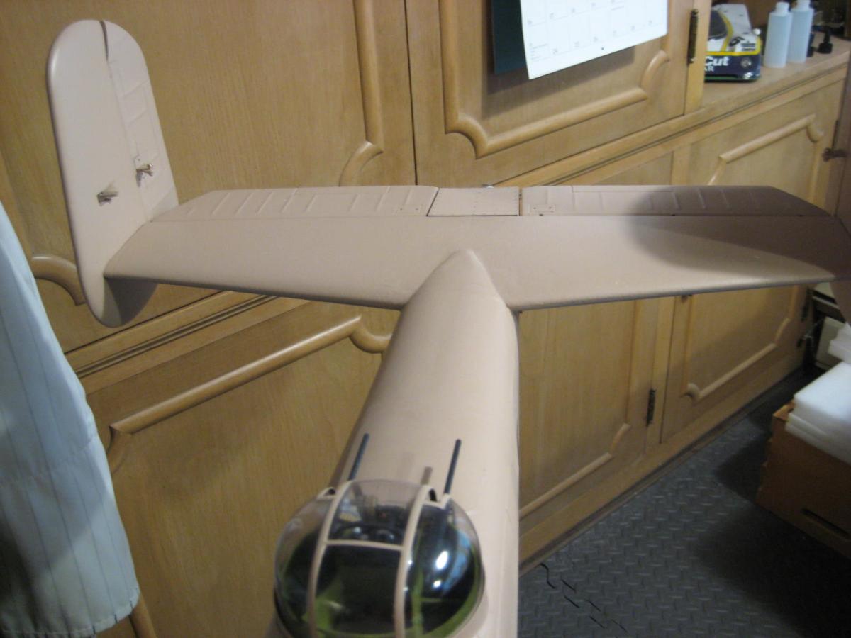

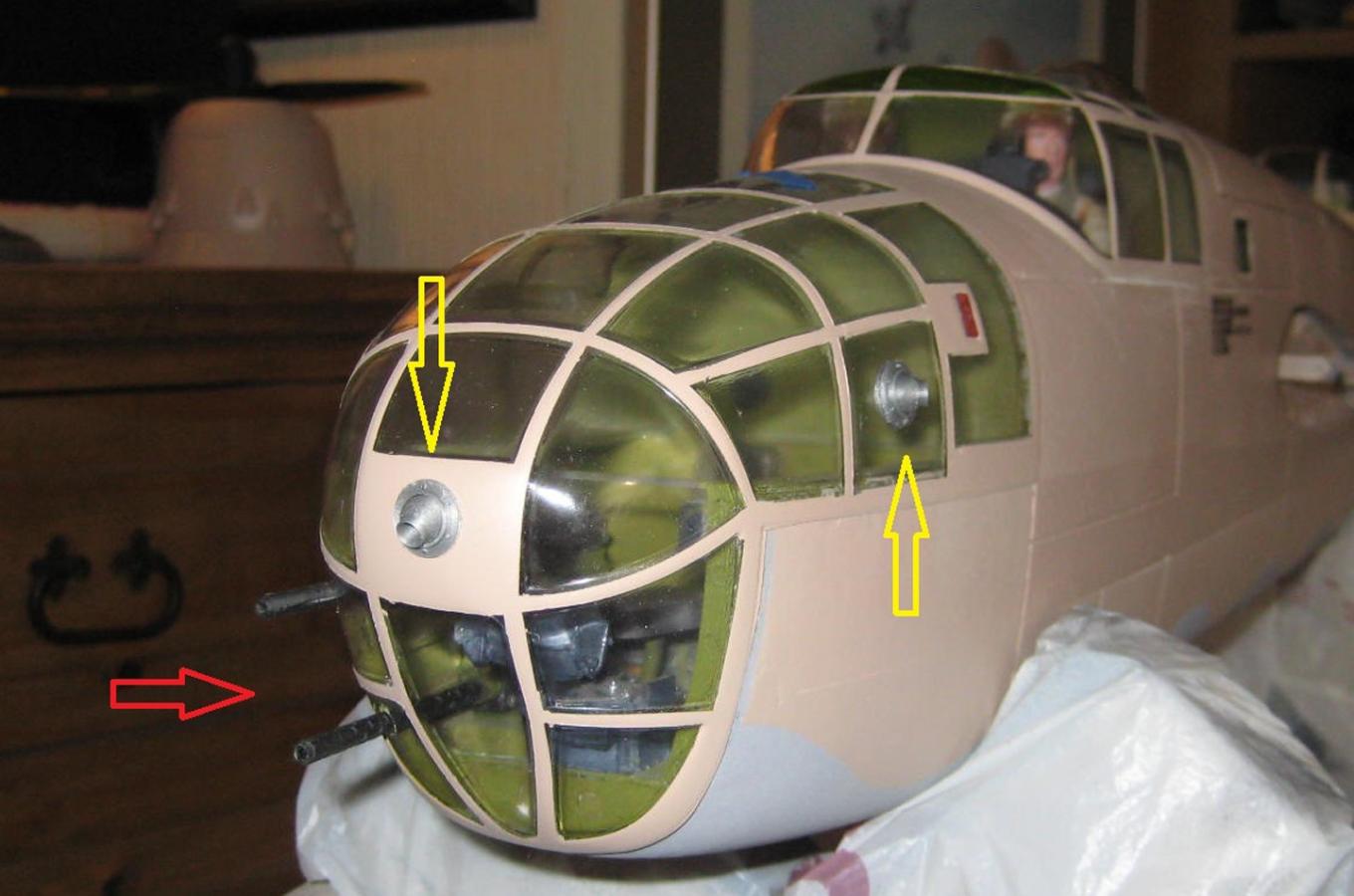

                                      Hey All,
                                      Major task (for me) almost completed.
                                      Reattached the nose greenhouse with all the new additions inside.
                                      A bit like building a boat in a bottle, I think.
                                      Needed to attach a cartridge belt from ammo boxes which are glued to fuselage to the pivoting 50 cal which is attached to the greenhouse all the while gluing the greenhouse to the fuselage, too.
                                      Might have been a better way to do it, but I didn't figure it out.
                                      In any event, everything is glued to everything it should be and the 50 cal barrels are removable which was the plan.
                                      Filling the gaps and touching up paint is next and the nose reconstruction is complete.
                                      Probably add the markings, too, before moving back to the nacelles.
                                      More when there is more...
