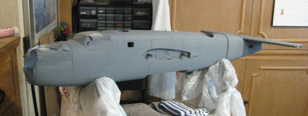

      Hey All,
      Quick update: Prime, sand, prime sand....
      Y'all know the drill.
      Disappointed in all the 'gatoring' on this model, though some of it is self-inflicted, unfortunately.
      I will soldier on, however.
      I am using the same Krylon Filler/Primer I used on the Corsair, but it is just not doing as well.
      I'll need to add a bit more filler, which slows the process.
      The picture is a bit blurry and she doesn't look quite that bad in real time.
      The good news is there are quite a few larger markings to add and she is a war weary warrior.
      More when there is more....:pop
      Best, LB

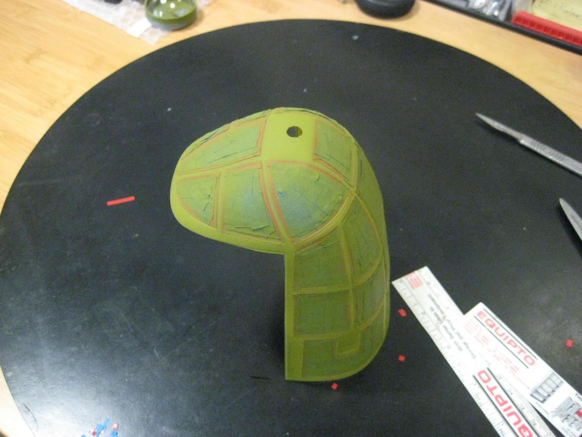

                  Medium Bomber Fans,
                  Another update.......:sleeping:...... from LB......
                  Finished a remake of the lower fuselage turret to beef it up some.
                  I know I'll crunch it otherwise.
                  Added the glass and have just finished the dry fit before glue, filler, and primer/paint.
                  Next is masking for the color line and applying the upper color Desert Sand ANA 616.
                  This is quite pinkish and as I understand it, become more so with sun fading.
                  My plan is to use both ANA 616 and Desert Yellow for the finish,:astonished: but use the yellower tone as part of the weathering.
                  As Dr Frankenstein was once heard to say, "We'll see what we will see, when we see it."
                  Or was that Stevie Wonder.:rolling_eyes:
                  More when there is more...:pop
                  Best, LB

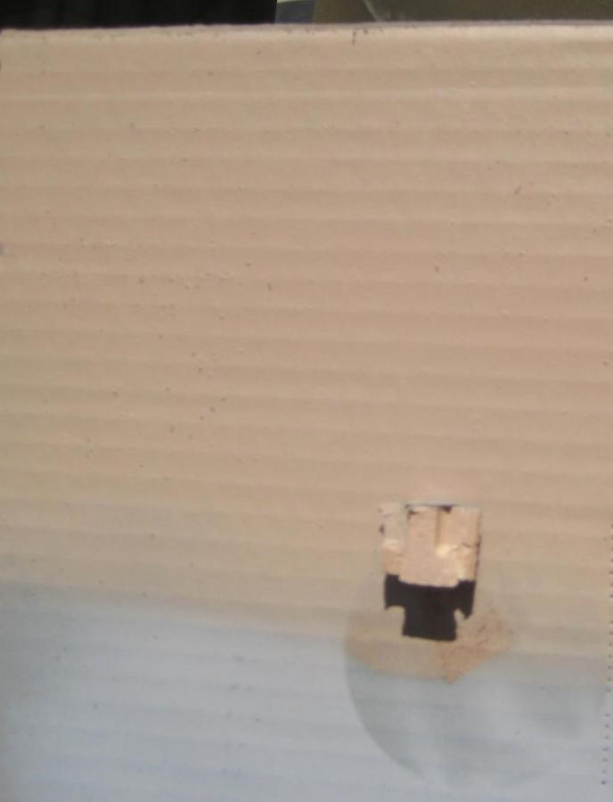

                    Color Critics,
                    This is ANA 616 Desert Sand in the sunlight.
                    Not as 'pinky' as I thought, but I can see how it would sun-fade to pink.
                    The paint is an Acrylic Enamel so I tested it on a piece of the EPO.
                    Held up just fine as did the primer coat. :clap:
                    Best, LB

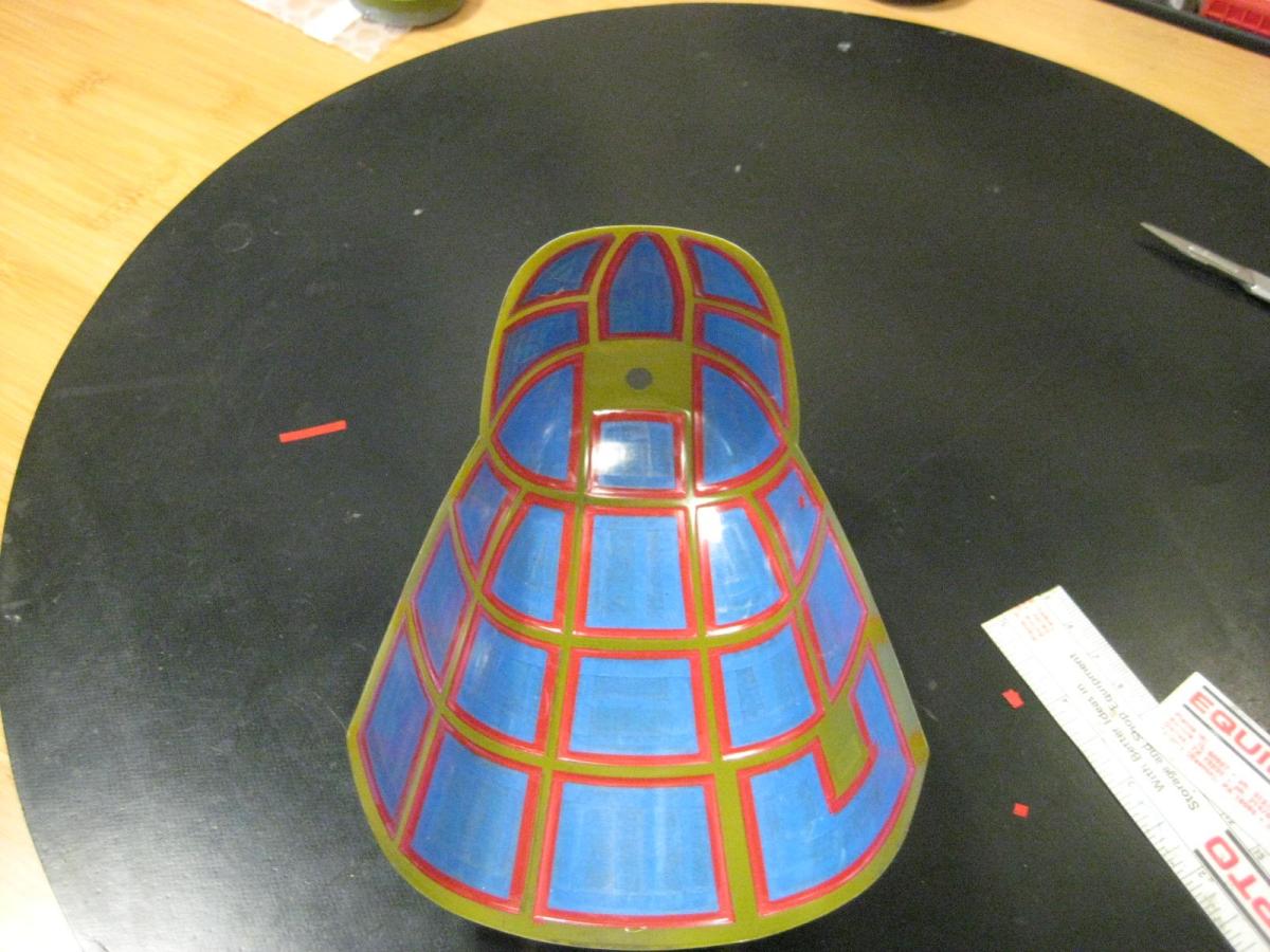

                      #171
                      Lads and Lassies,
                      WHAT?!?!?!?!
                      .....a pain to mask this little jewel.
                      Zinc Chromate down, then a quick splash of gray primer, and on to the Desert Sand.
                      Best, LB
ID:	429538 Click image for larger version

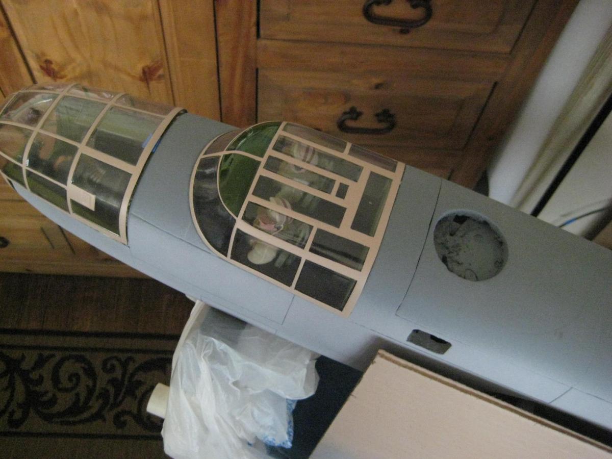

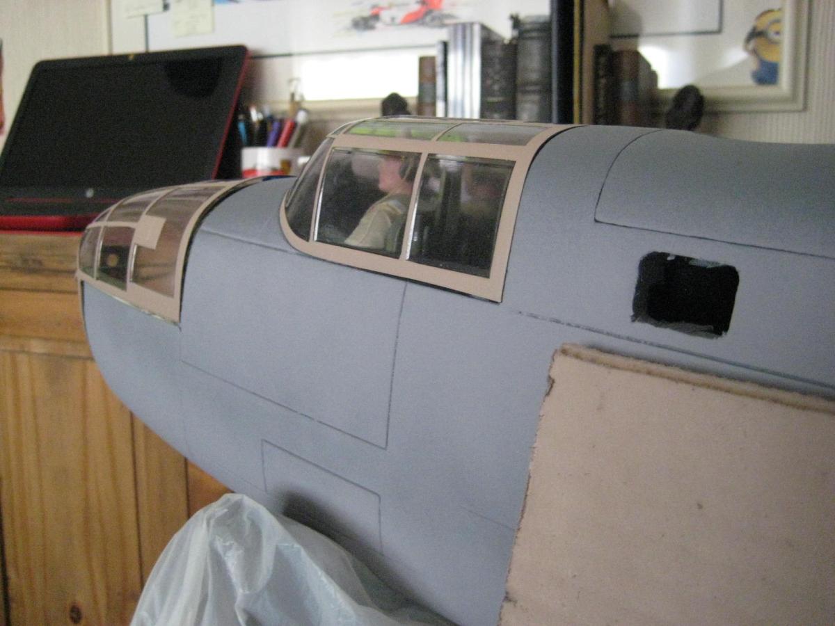

                        #172
                        Mitchell Menagerie.
                        Celebrating another small victory with the 'greenhouse'.
                        First coat zinc chromate, second gray primer, third Desert Sand.
                        No runs; however, there is some vinyl tape residue, but that's to be expected.
                        I have had this roll of 0,125" masking tape since the mid 80's and it still works great.
                        You can't leave it on the part for more than a couple days as it de-laminates somewhat and leaves the sticky behind.
                        Comes off with IPA.
                        I did get overspray in the inside and will deal with that once it cures out.
                        Next the cockpit greenhouse.
                        Best, LB

                              Hey all,
                              Thanks fellas for the kudos.
                              The photos are not centering for lack of a better term when you click on those.
                              Just continue to click on it and it will come around.
                              Also, I narrowed the 'frames' of each of the plexi-glass sections when I masked everything.
                              The OEM seem too wide and not to scale IMHO.
                              Looks much better to me.
                              Best, LB

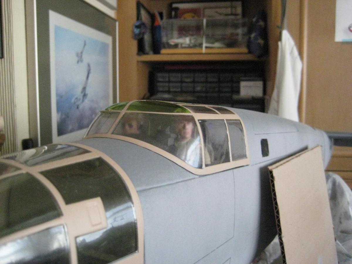

                                • 4870
                                #176
                                Hello Fellow Medium Bomber Ardent Devotees,
                                There is more, so there is more.
                                Cockpit glass still needs to cure and then get cleaned up.
                                Turned out better than I thought.
                                Still don't know why the OEM upper sections were blocked out, in fact not even molded into the part.
                                In any event, I winged it and I like the way it turned out.
                                On to the verticals, then full paint for the fuselage.
                                See you then.:pop
                                Best,
                                LB

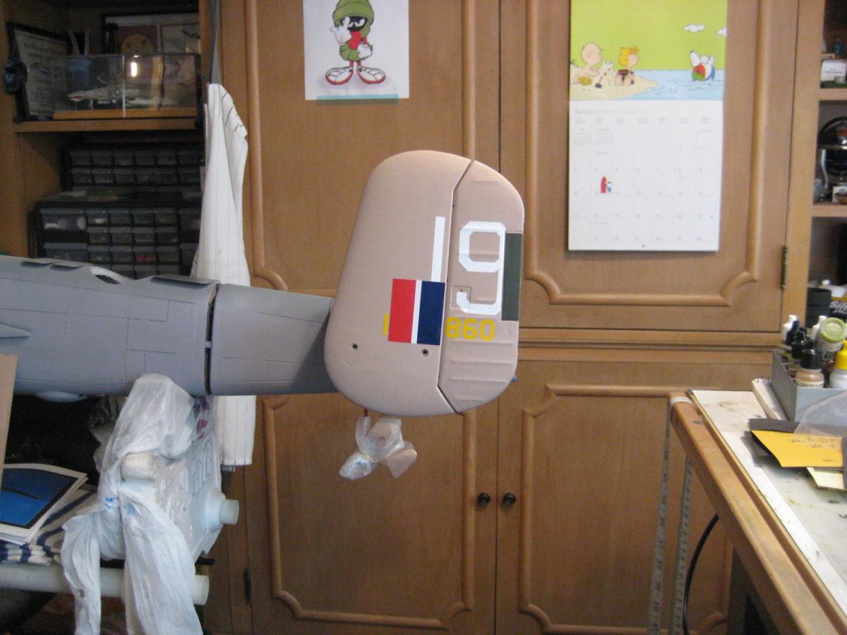

                                      Mitchell Mob,

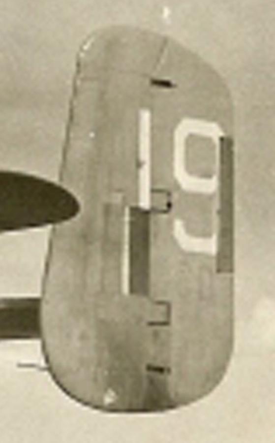

                                      Applied some of Callie Graphics beautiful work to the verticals.
                                      Found good reference photos for placement.
                                      Going to need some faded weathering for certain.
                                      Best, LB
Name:	Left Vertical Model.jpg
ID:	430151 Click image for larger version
Name:	Left Vertical Actual.jpg
