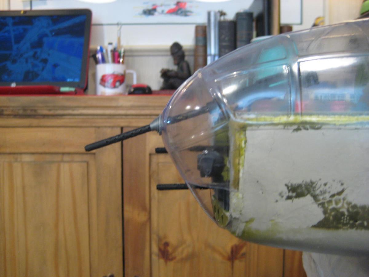

Quick Update
Parts in place and looking more like a B-25 Nose.
Finalizing the 50 Cal mounting to the Greenhouse and cleaning up the exposed foam inside and out.
I've found references to a canvas looking bag(s) that catch the empty brass from the 50 cal.
Those look to mount beneath and to the left of the gun and go all the way to the nose floor.
Could be a good secondary mounting for the hand operated machine gun and look good at the same time.
We'll see.
Best, LB

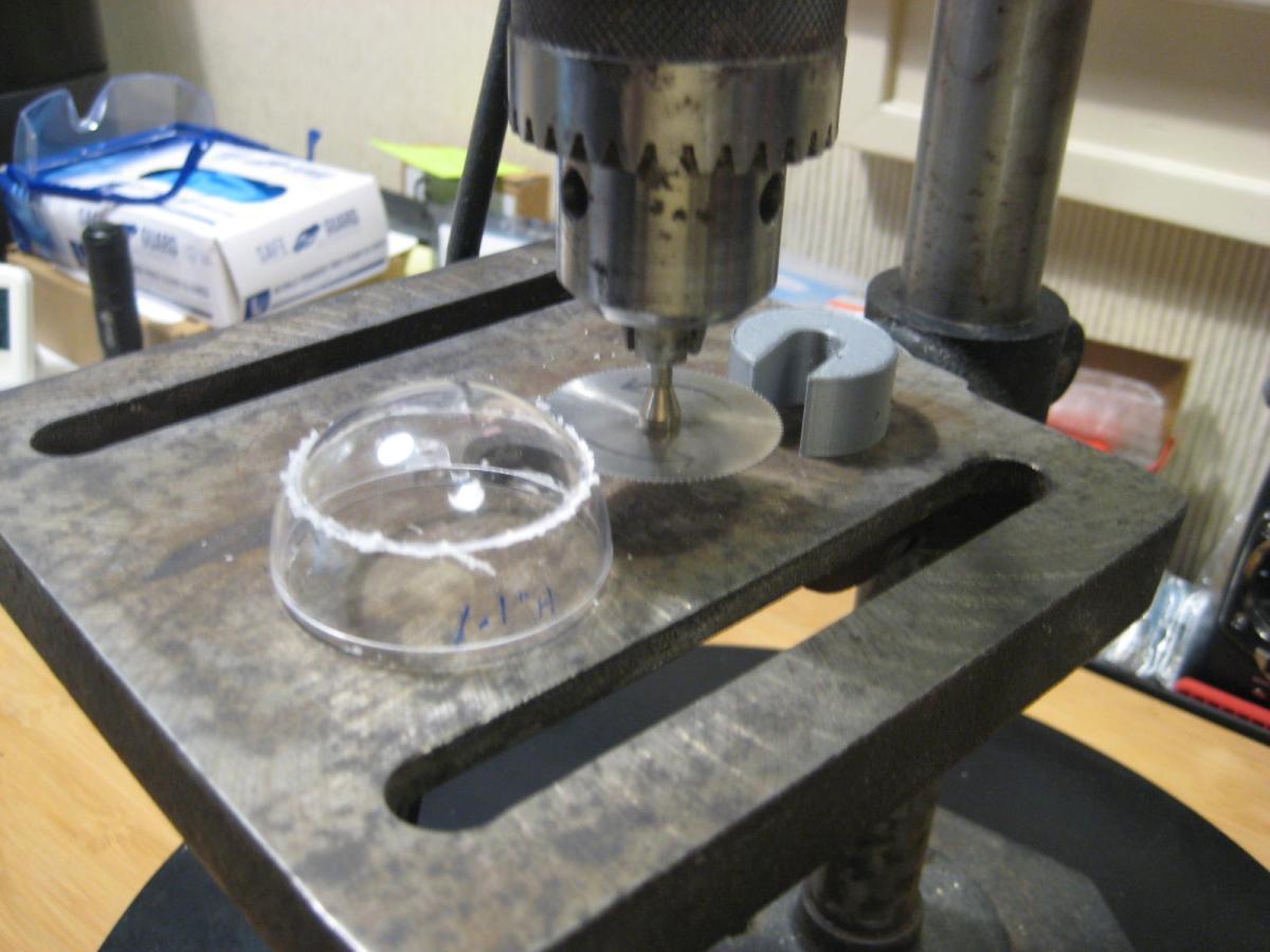

Found these acrylic ornaments which are split into 2 parts on @m@z0n.
3 different diameters and the middle size one arch is perfect for this Observation Dome.
Cut it down to 0.545+/-" on my drill press.
I made a "C" shaped 0.6 on the 3D printer to set the height correctly and cut slowly.
Looks 'spot on' and measures well against the scale drawing.
More when there is more.

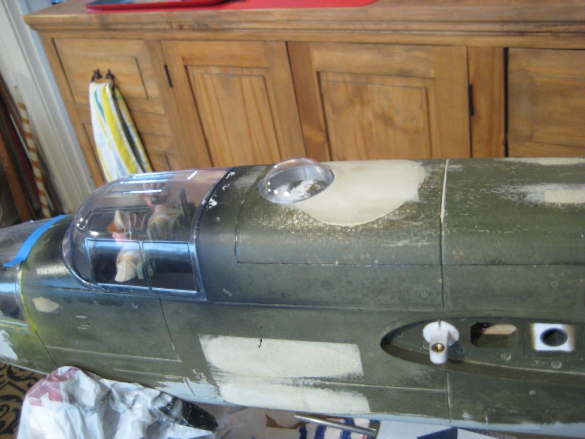

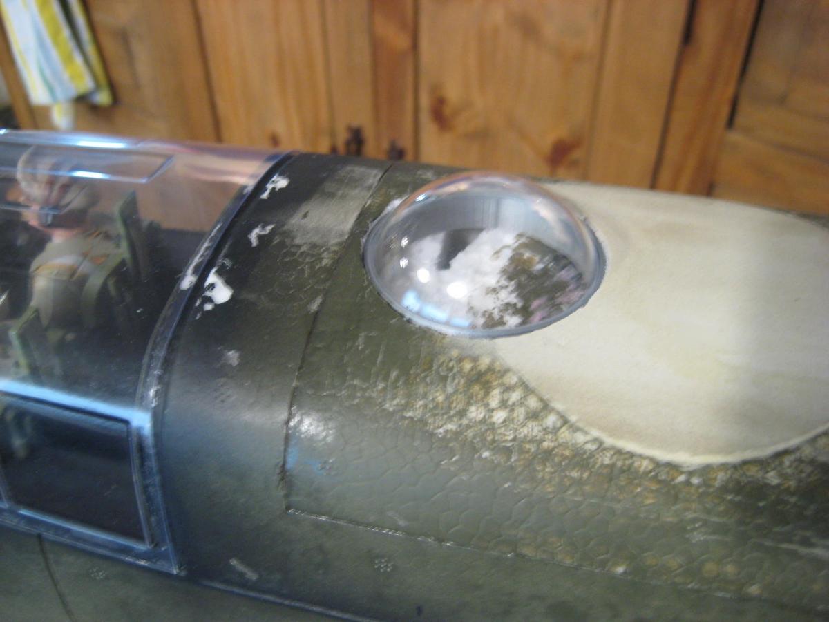

Mitchell Mob,
Observation Bubble in place. Woo-da-hoody!:star_struck:
Not sure whether to cut out the hole all the way through or just print and 'gray out' a base for it.
There's no real detail in there and the OEM view would be the battery top, so....we'll see.
Any who, more when there is more. :pop
Best, LB
