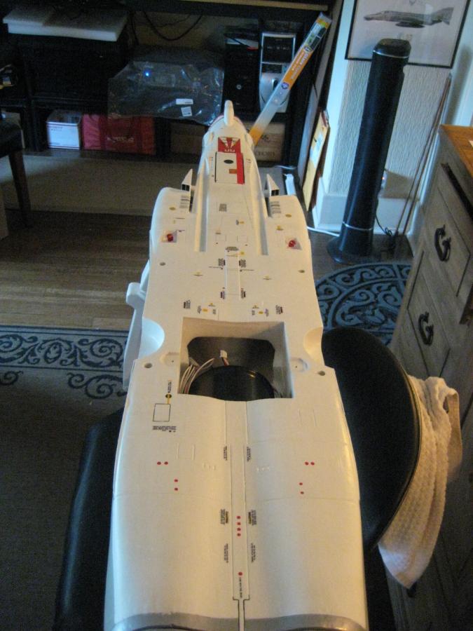

                            Yeah well, there's only like a million of the those little things on a Phantom...
                            I spent the best part of 4 sessions doing Callie's Nomenclature on my F-Phour.
                            Most of those are on the bottom as I recall.
                            If you need a placement guide, I have one around here somewhere.
                            It's generic, in that it matches F-4B/J.
                            At first it just looked like way too much stuff, but I look at her now (the Phantom not Callie) I am happy I took the time.
                            It just helps completes the illusion for me if I squint a bit
                            I'd go gently if you decide to add a few and do only those that really matter and maybe do more as time goes on, just my $00.02 USD.
                            Next on the Mitchell List will be the Outer Wings, those need a little massaging, too.
                            More when there is more...
                            Best, LB
