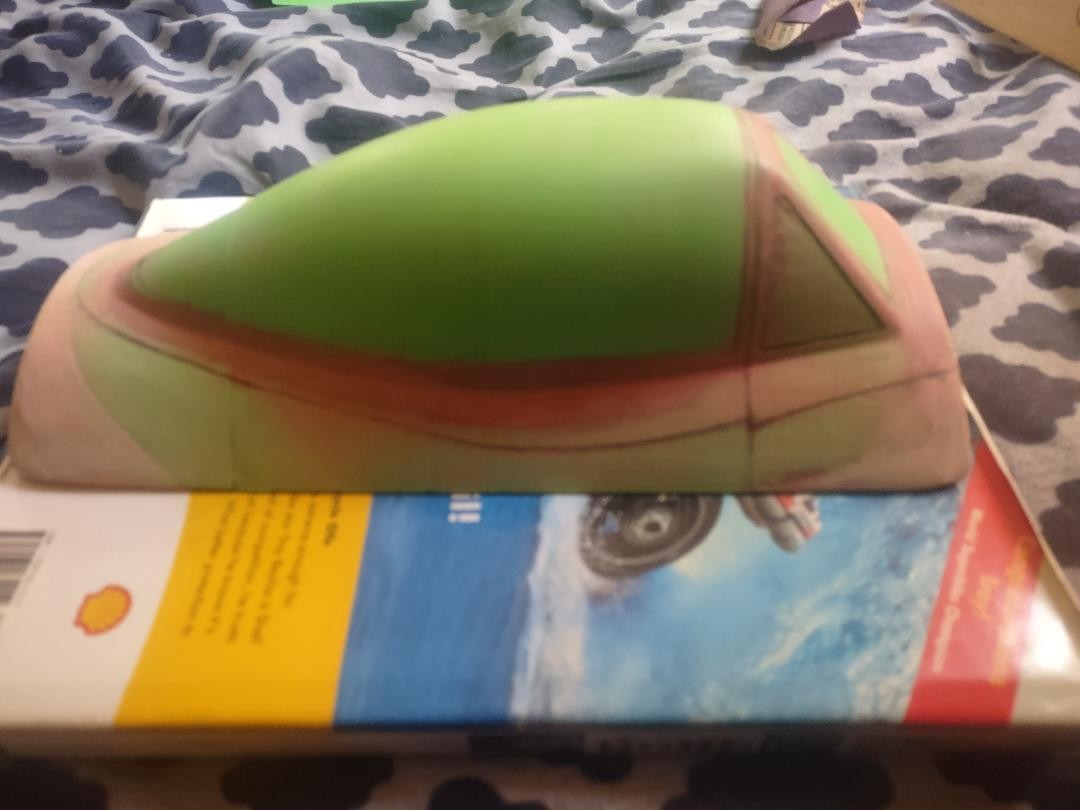

    James has been working hard on the plug for the canopy and has sent it to a small company to make some clear vacuform canopies for my Hairless Joe model. We're hopeful we'll get them to make these for us and send a couple to me, but I decided recently to look into backup alternatives if our primary canopies don't pan out for whatever reason. I decided to see if anyone else has a 1.5M P-47D bubbletop that maybe I could get a canopy from. Turns out, to my surprise there were at least two models. One is from Horizon and the other from Nexa, available from MRC.

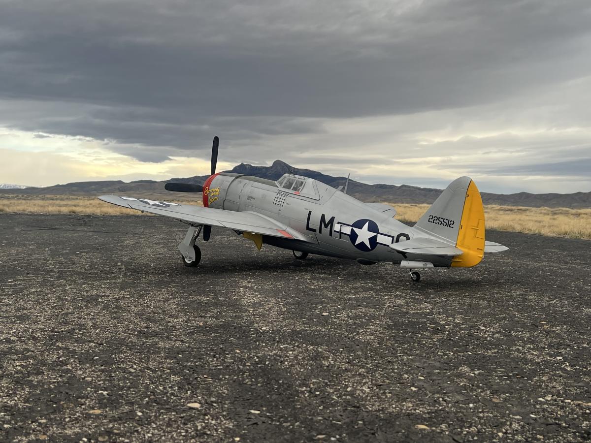

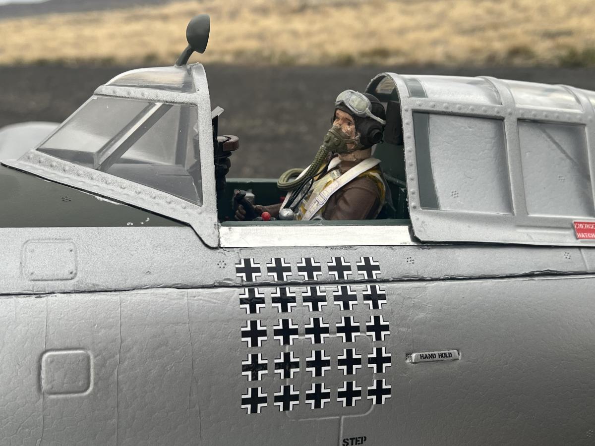

    I took out one of my FMS P-47s, "Ole Cock" for a shakedown flight today, after having the winter off hanging in the garage. I found while testing it a few weeks ago, the motor had a "grind" to it in one spot as I manually turned the prop shaft. I decided to replace that motor with a brand new replacement that I bought. I have no idea what might have gotten damaged inside there. I don't recall any prop strikes using this larger, more scale V3 FMS Corsair prop, but I didn't want to take any chances.
    I'll post a couple pics I took this morning after the flights. This has the printed scale Curtiss Electric prop and the printed cuffs (courtesy of Elbee's design) that I printed and glued onto the base of the props. It does make a slightly different noise, not sure if it is due to the prop cuffs on, but it flies great, about the same and the Hamilton Standard version without the cuffs that I have on three of my four FMS 1.5M P-47s, including the under development Hairless Joe version that I hope to fly this spring sometime.

    still waiting for Park flyer plastics to confirm my plug has been signature received on April 1st UPS, very poor communication ,must be at the up coming Toledo rc show ?? end of the story ,will badger these people Monday after i got back from Kona yesterday for 7 days.
