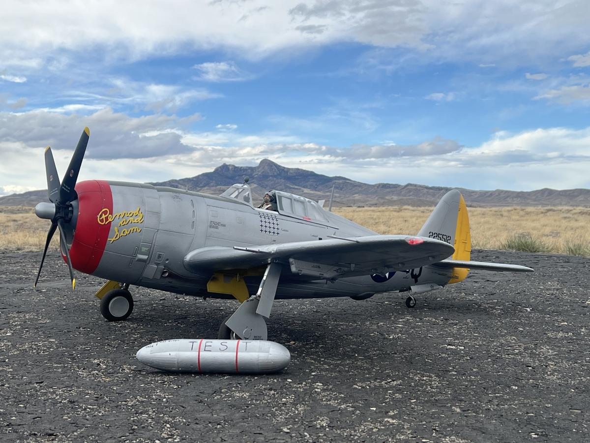

    Last night I got all the parts of Hairless Joe put back together again and screwed into place. Everything works! I have a ton of minor things to do before I call it "complete" and that will take several weeks. For instance, I have an order in to Callie for P-47 nomenclature and that won't be here for a week. In the meantime, I plan on doing the maiden on it within the next week or so, weather permitting.
    I was planning on putting the shorter stock FMS prop on it for the first couple of flights ,but when I did a CG test on the airplane with that in place it was way out of balance, tail heavy. So, I was thinking of having to put some lead weights in the cowl to get it back to proper CG, but then thought, what the heck, let's put on the big FMS 1700mm Corsair prop, instead! When I did that, the CG snapped sharply back into place. When I think about it, I haven't been flying with the little stock prop for years. I'm much more at home with the big prop on this airplane than the smaller one after all these years. So, the maiden will be done with the more scale FMS prop on the airplane.
    I have a pic of it on the table in the shop as I worked on it last night. I'll be working on various things today and next week, too.

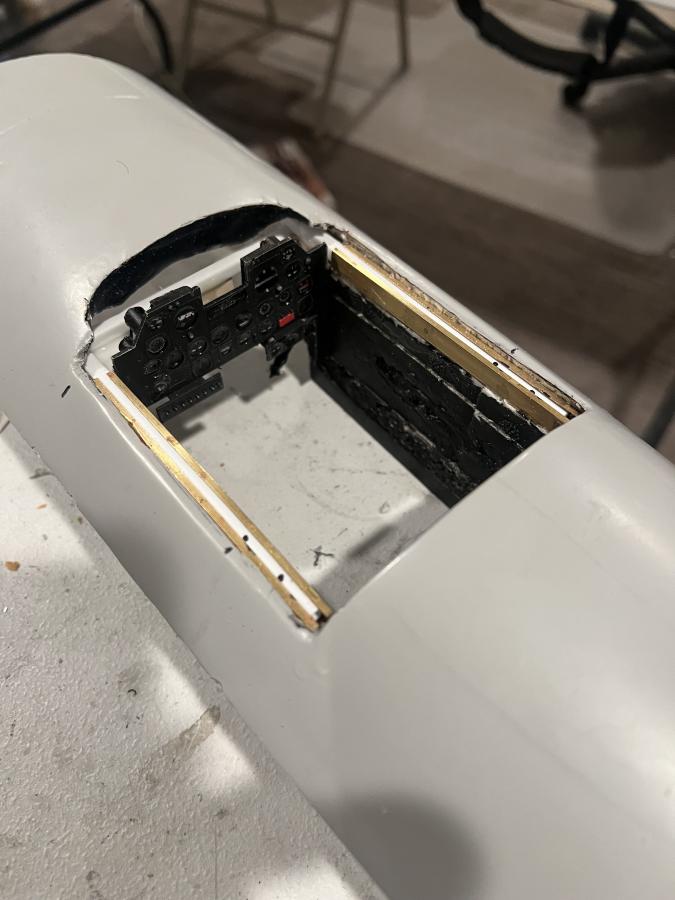

    The second photo shows the removable cockpit and the powered canopy that James in California masterfully made. He had to make a plug of the canopy/windscreen and evidently that was a ton of work, but the results are excellent and the model can be flown/displayed with a one piece closed canopy or a powered one, like I decided to try. You can see one of the Actuonix linear servos sticking out the front of the cockpit. That was the only place I could think of to put it for a working canopy. It works great. Super folks in British Columbia not far from Seattle and I highly recommend their line of first rate products. Ask for "Ian!" He's the boss, I guess, and he LOVES P-47s and model rc flying!

    Wow that looks very scale glad i spent the extra time using filler to get the frame contour way closer than is started as stock
    Yes, I was quite impressed with the close and accurate fit. I think you hit it out of the park with this one, and it wasn't overly hard to convert it to a motorized canopy.

    Awesome job I can't see any of the mechanism
    I was able to hide it pretty well so most people would not notice any non scale features of which there are a couple.

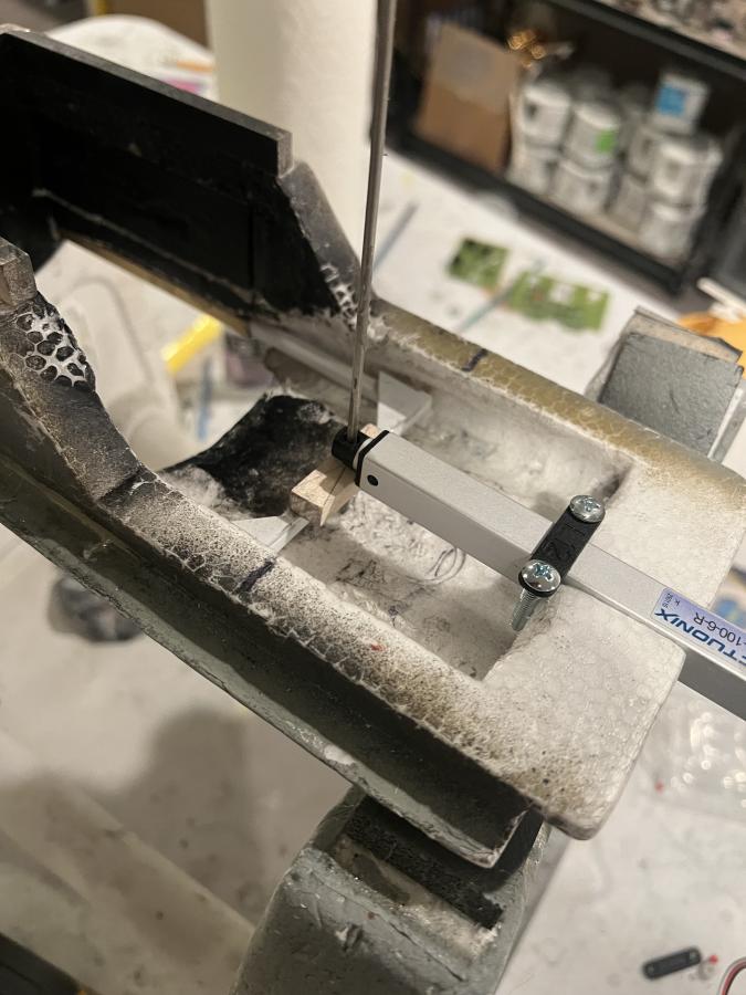

    There was definitely some brain damage figuring this out for this airplane! The last one I did 20 years ago was for a 1/5 scale Yellow P-47M that had LOTS of room in the fuselage to put things in. This had some head scratching moments! I'll take a few pics of the mechanism in case it helps anyone else down the line with similar ambitions.
