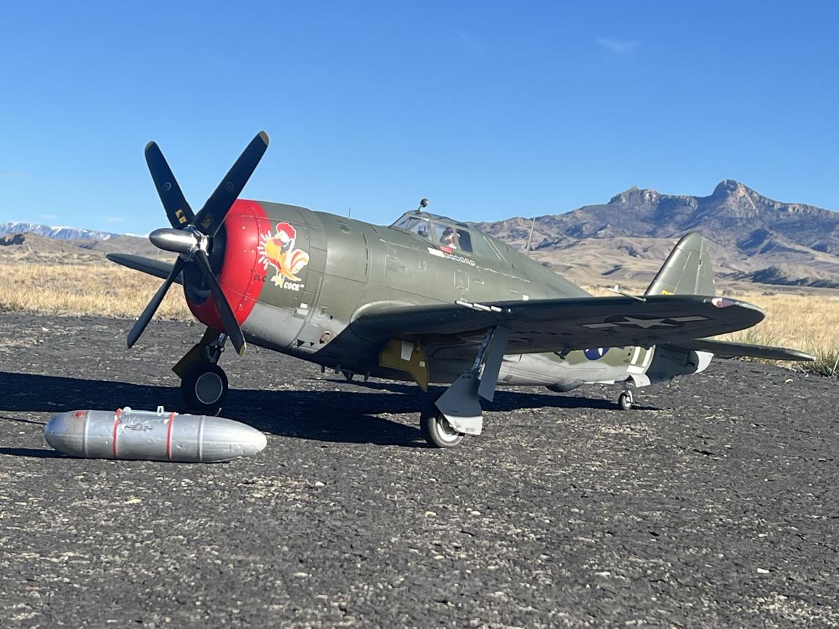

    I got a lot done on the cockpit canopy and servo driven movement open/closed. I have it all glued and taped down until I check it out tomorrow to see how it came out. The movement of the canopy works pretty well, and I'm hoping that when I remove the tape the canopy will make a good tight fit to the windscreen.
    After that is all worked out, I still have a lot of small details to add to the cockpit, like the emergency release handle for the canopy, and more camo details using photos of the real aircraft as a guide.
    Click image for larger version  Name:	IMG_3629.jpg Views:	0 Size:	71.3 KB ID:	448002 Click image for larger version  Name:	IMG_3630.jpg Views:	0 Size:	67.9 KB ID:	448003
    Is this depiction accurate or just a guess for the right side P-47D Thunderbolt 56th FG, Col. David Schilling, Hairless Joe, England, June 1944​
    James, there are only two or so photos that I have ever come across that showed any of the right side of Hairless Joe. Having said that, there was enough to make an educated guess, at least as far as the front half of the right side of this aircraft. Regarding the tail area, we can only do our best to continue with similar camo patterns that were on the left side ad are well documented with photos. I think mine is as good as I or most anyone could get with such limited photo references for the whole airplane.
    Regarding that diecast steel model, it is quite a good model (I have one), but a lot of those camo patterns are inaccurate. I started using that on the green camo bands using the model as a reference, but then started to change them going directly from period photos from that time period. Due to tremendous battle damage that summer, this airplane changed a whole lot as they changed out wings, tail, engine, etc. Even so, in December of 1944, Schilling shot down 5 enemy fighters over Germany making his total kills up to 22.5. Those were the last recorded kills in this aircraft or by Schilling himself.
    See below photo of Hairless Joe after crash landing at Boxted Air Base, Essex, after taking heavy AA fire in the Netherlands on the first day of Operation Market Garden, September 17, 1944.

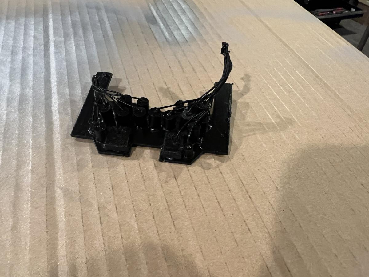

    Been busy working on the cockpit and details the past couple of days. Most of it is done, I think the pilot will fit in ok when the parts I just glued in are dried and ready to install it. Will send pics with the pilot installed and then I'll start working on the powered canopy. I'm keeping my fingers crossed that that will work out as I am hoping.
    Most of the cockpit parts are 3D printed, some are just old fashioned modeling like the pilot seat that is adjustable on its aluminum tubes and the control stick is attached to the floor with a small piece of surgical tubing so it is moveable and will be placed in the pilot's hand for display and flying. The placards inside the cockpit are cut out from photos of real P-47s.
