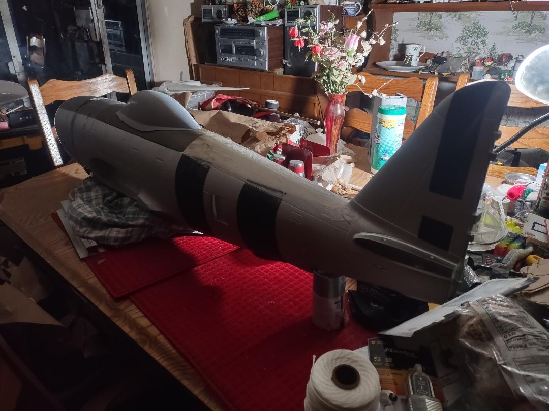

    While work is being done by James in California on the bubble top redo of the fuselage, I'm getting busy on detail items that I wanted to include on the rest of the control surfaces like the wings and the horizontal stabilizers/ elevators.
    I have already applied three layers of acrylic Minwax and sanded lightly between each coat. Used a reasonably good bristle brush from Ace and it went on smoothly. It really fortifies the strength of the foam to resist bumps and dings a little better. After that, I've been using a spray Tamiya primer and am continuing to smooth out the surfaces so that they can be painted and look smoother that way. I circle with a pencil any rough or high spots that I will sand and respray with the primer to prepare it for eventual final painting.

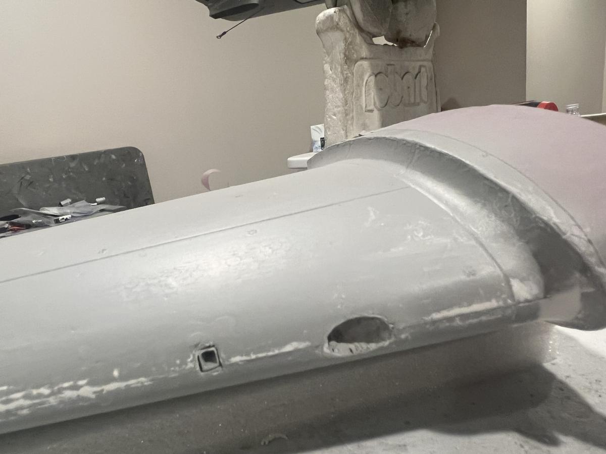

    In the first picture, I am roughing out the fresh air vent on the forward right wing leading edge. Also are the beginnings of the gun camera port indicated by the small square to the left of the fresh air vent.

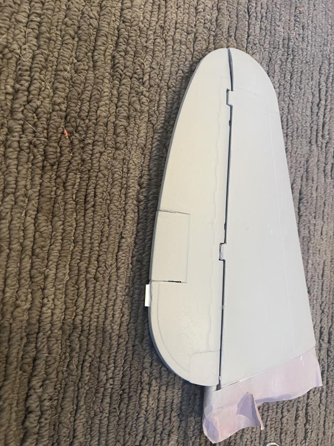

    The second pic shows the fixed trim tab that is on both elevators just inboard of the cutouts for the elevator trim tabs. They are unpainted white plastic at this stage. These were part of the factory installation on each airplane, and then initial flight tests where they could bend the thin tabs slightly to refine trim characteristics. They would normally not be adjusted after that time. There are even placards painted above these pieces that admonish everyone NOT to alter them as they were fixed at the manufacturer.

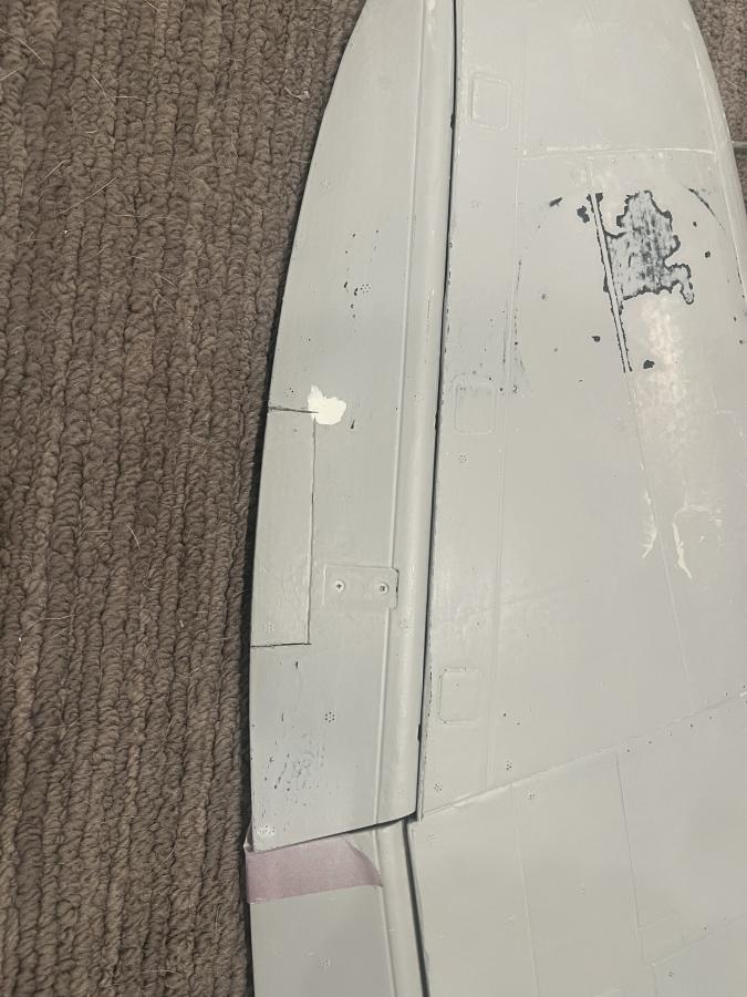

    The third pics shows a cutout for a aileron trim tab (only one installed on the left aileron, only, back then). For the right wing aileron, there was no trim tab installed as was typical with American built aircraft of the day, but it did have a fixed trim tab installed similar to what was done on the elevator fixed trim tabs.

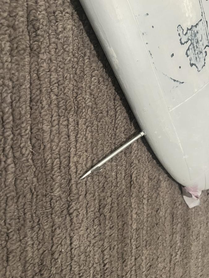

    The fourth pic shows a scratchbuilt removable pitot tube installed in an aluminum tube mounted in the leading edge on the left wing tip. If the plane ever gets into the weeds for any reason and it breaks off, it is easily replaced. I made a bunch of them over the years!

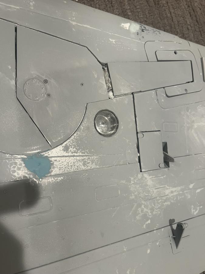

    The last pic shows a scale landing light which was installed aft of the landing gear on the left underneath wing on the earlier models of the P-47 Later models had it moved to near the left wingtip. (Note to Rex: if you do a later model P-47 or M model, that is where you will want to place the landing light.) I used parts from a flashlight to make it look realistic. The real ones would rotate down 90 degrees for use at night, but this one is static and stays in the retracted position.
