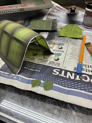

    I think the cuffs I have will work fine. The primer did its job, and the flat black paint is drying overnight. Really adds the look to the plane.

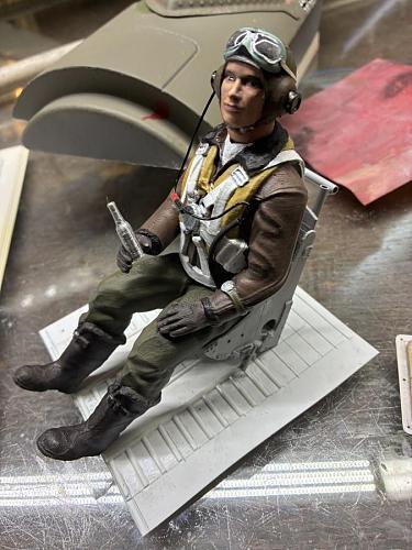

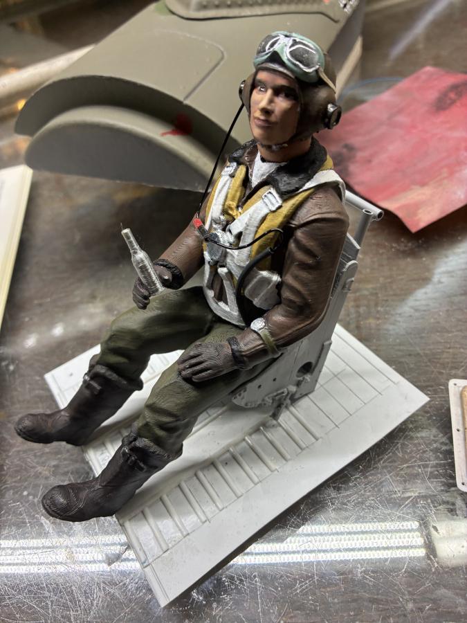

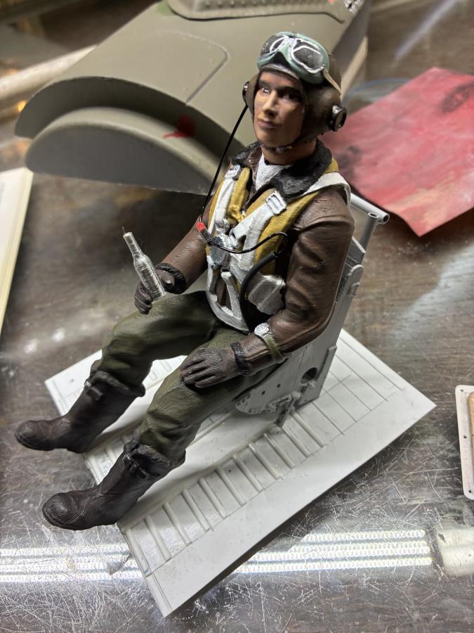

    Meanwhile Bob is now installed in his cockpit waiting for the next sortie.

    I have installed the armor glass and canopy. waiting on both to dry, Used RC-56 canopy glue and it takes time to set.

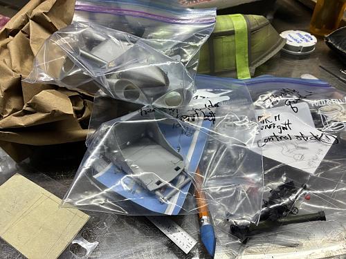

    Callie sent me a quote for the Phantom and P-47 things I need. Ordering these tonight.
    Cockpit is really looking good with all the items installed. Bob is now strapped in the seat and will be installed as the last thing. Extended rudder pedal arms will be tricky to install but going to try. Another item that very few see ....Buuut I know it's there. LOL

    Bob is looking excellent in the cockpit! This will definitely be one of the focal points for the judges to stick their noses in for a closer look.

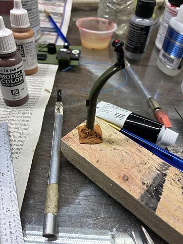

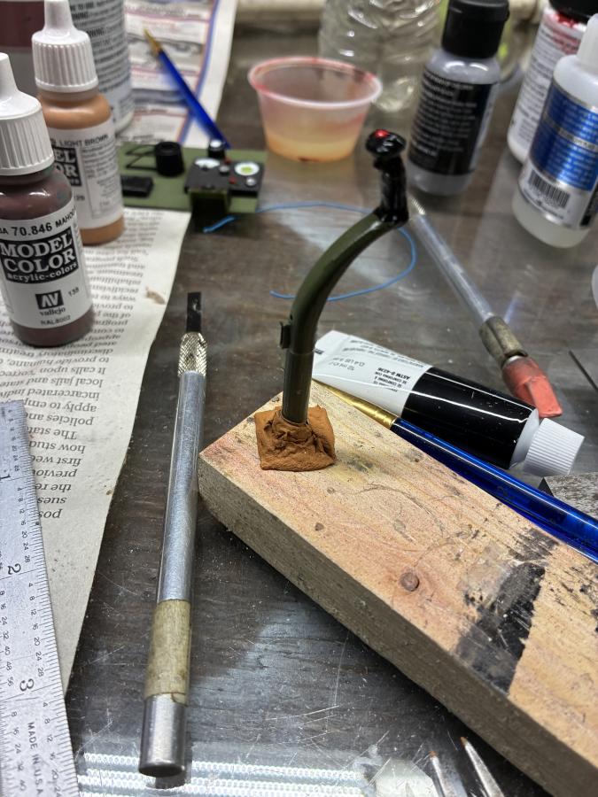

    Yes, gunsight is waiting to be installed after the armor glass. It is very detailed. I painted the bump guard per a picture I found. It sets the gunsight off.
    good. Little details like that should help with the judging, I would think. I think most of us who fancy warbirds, especially fighters, like to see things like gunsights in the cockpits.
    Hi Rex: did the Mk.II gunsight make it through the shipping ok? Should be pretty easy to mount once are ready to do that. I try to glue it on so when seen from in fornt of the cockpit, the pilot's eye is looking right through the reflector glass on the gunsight. Then you can just glue it on at those two points that I painted on the mounting lugs on the sight. Let me know if you have any questions. It should be pretty accurate for what Bob and the others at that time were using in combat.

    I think I have the cockpit about right for the pilot. Bob isn't glued in yet, but he is feet on floor and head and shoulders like my photos. Headrest glued in and looks like the time period at that time.
    Dave, I think the armor glass sits at a 45' angle, correct me if I'm wrong, and glues to the frame of the canopy and base to the fus.

    Hi Rex: great job resizing the headrest. Looks much better!
    Regarding the angle of the armored glass in the windscreen, I think 45 degrees or so is a good estimate. Looking at it from a 90 degree angle in that in-air photo you posted, it looks like the armored glass frame approximately parallels the line of the sloping frame of the windscreen. I think that is a pretty safe and reasonable angle to put your armored glass and frame in position at about a 45 degree angle. Makes sense when I think of it; if it was perpendicular to the glareshield (straight up and down), it might be weaker to a direct bullet or flak hit. If less than 45 degrees, it might also be weaker to a direct hit. Just my guess.

    Thanks for the info. I have flat black on hand and plan to get matte black this week for the triangle aera. Decided to have Bob strapped in with harness & seatbelt. I cracked one cuff so adding a little filler to hide the seam. Your cuffs look great. Callie will send a quote for the Curtiss decal and nomenclature on the prop. I was looking at photos today to see how the tips were painted. I have the FS# for the yellow. Will prime/sand props and re-do.

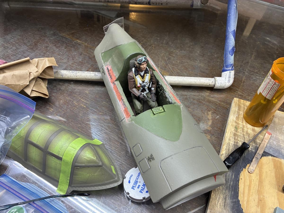

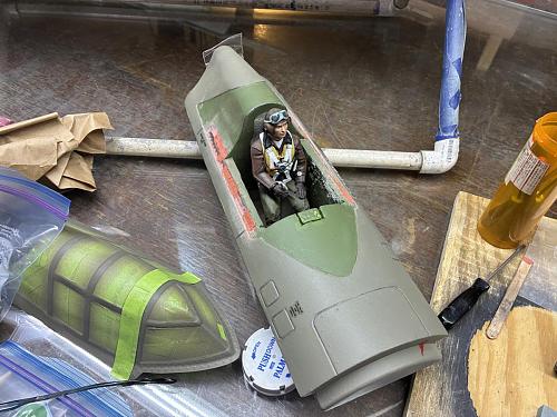

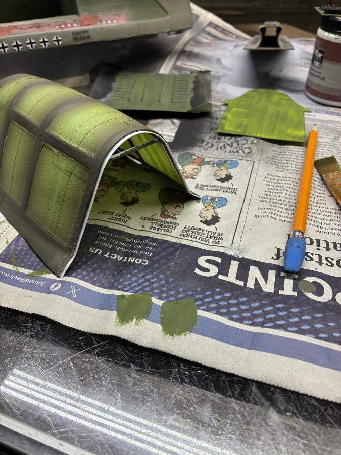

    I have started installing the cockpit parts. Glued .010" styrene strips over foam cockpit edge, gives a smoother look. Back styrene former glued in. Cockpit side walls decreased 1/4" to allow clearance underneath floorboard. Pilot was pre-fitted in cockpit and the brace under seat was shortened to 1 3/16" to give correct stance in cockpit, shoulder and head height.
    Will paint touch up areas and install front canopy, armor glass and gunsight
    Installed cuffs on propellor, will refinish paint
    more to come later.

    looking great, Rex. You're probably already planning for this, but the glareshield is almost always matte black on almost every airplane from WWII to the present day. I'm talking about the triangular piece where you will install the armored glass. You probably are already planning on doing that, but just checking. It's really coming together in great shape!

    The main hatch profile is looking good with a first layer of primer to identify all the imperfections, lots more finish work to go on the main fuse
    looking good, James. In the second picture, can you cover over the cutout where the OEM gunsight used to be? I'll be putting in a totally different printed gunsight and it would be better if the entire glareshield is smooth before I begin installing that and other stuff, too.

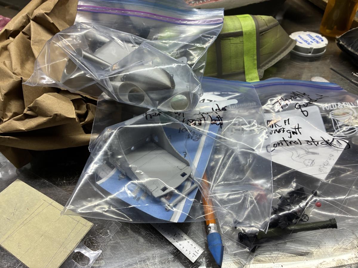

    The cockpit parts are all fitting well but my extra 3/4" depth is almost too much. I am going today to get the height correct so there is more room below the cockpit. Now it is less than 1/8" and wiring underneath has to be correct so I want more clearance so moving the seat/. pilot a little will need to be done.
    The instruments fit fairly well and look great. I will use some of my wifes clear craft epoxy for the glass. Dries crystal clear.
    When I have side depth, pilot/seat height all set I will give all my dim. on here for others. There is plenty of room just need more clearance.
