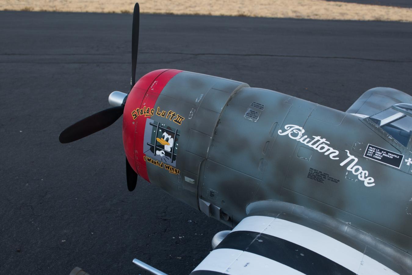

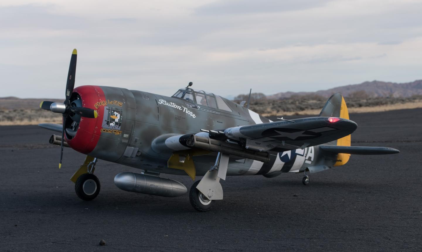

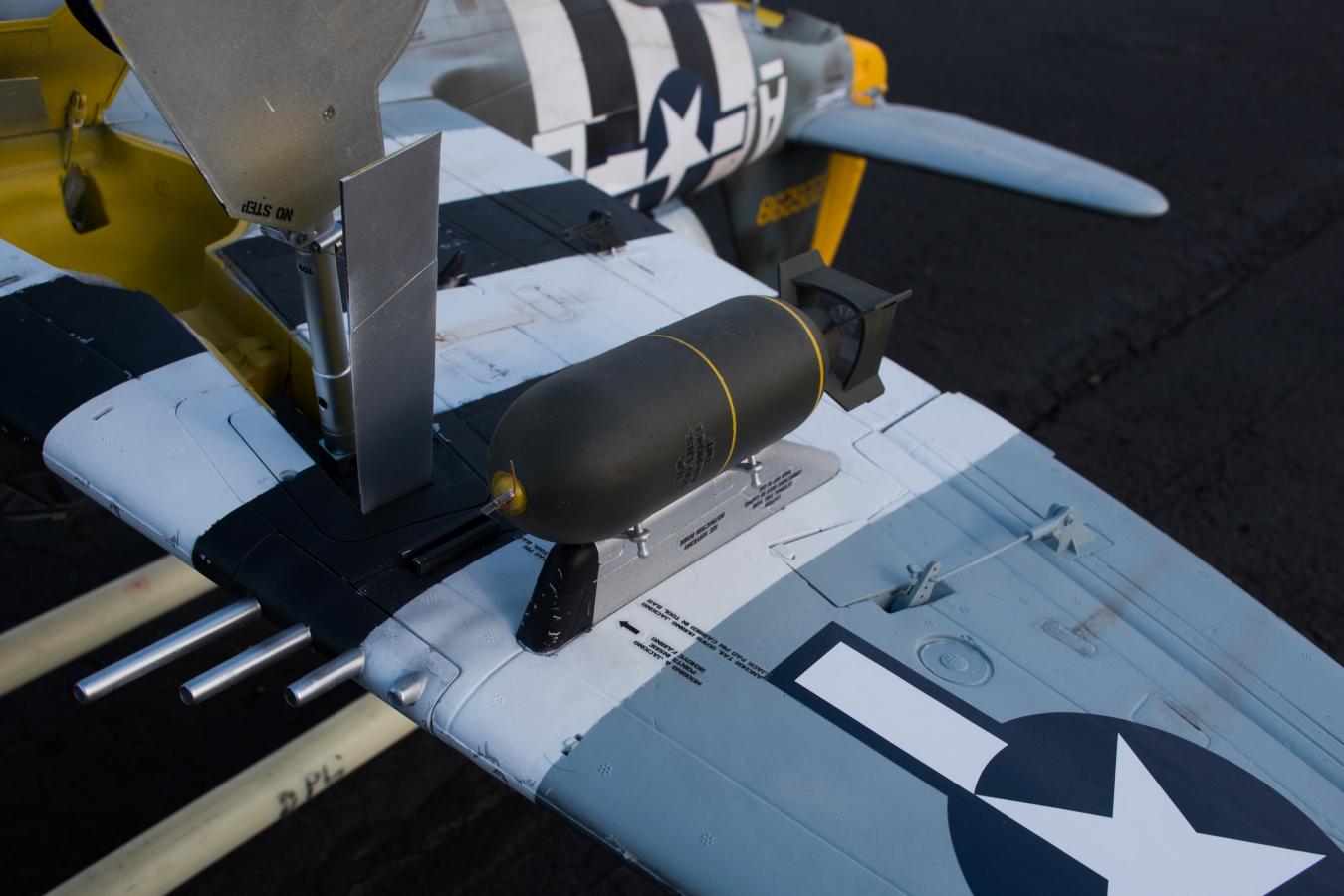

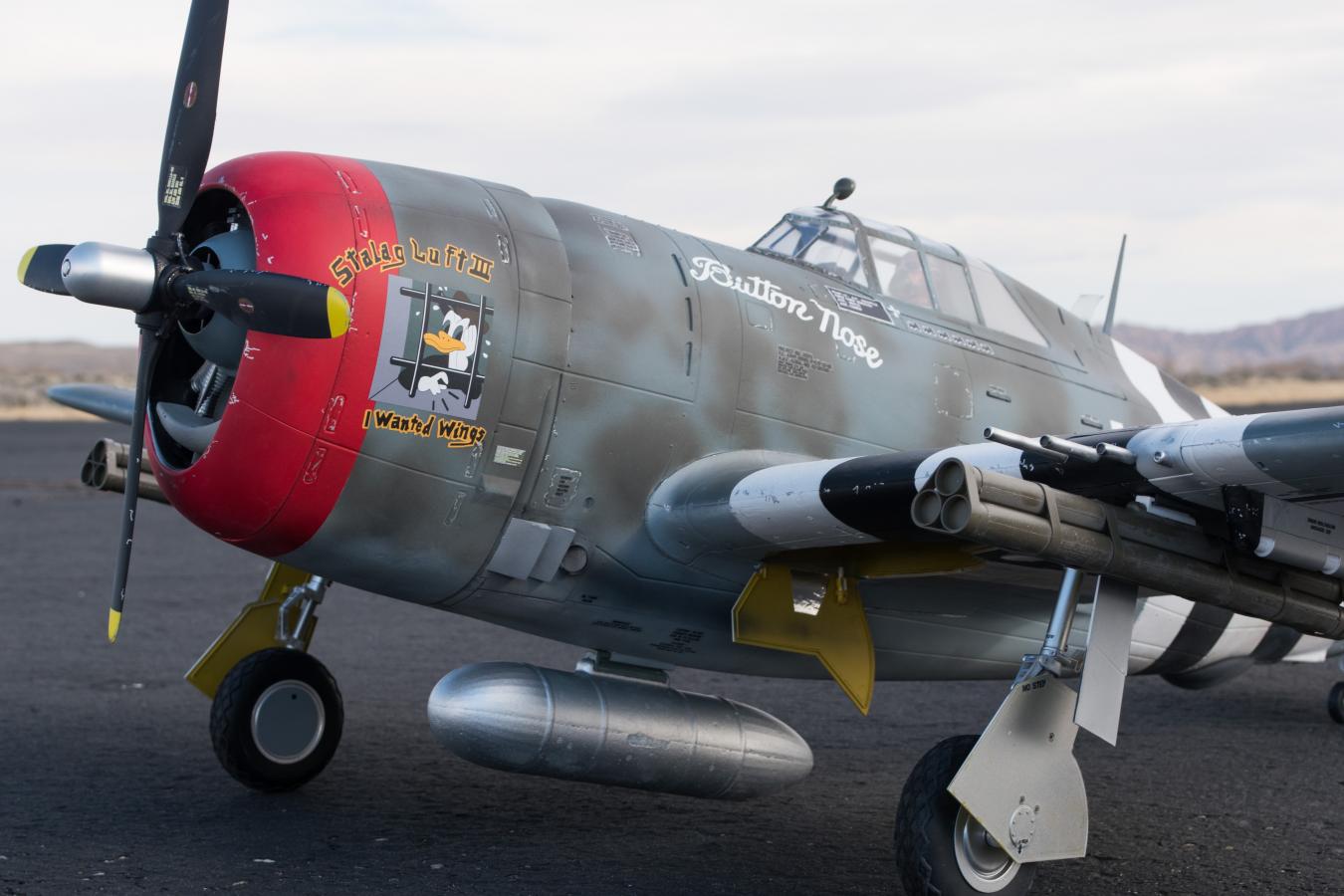

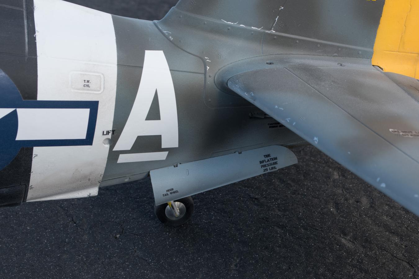

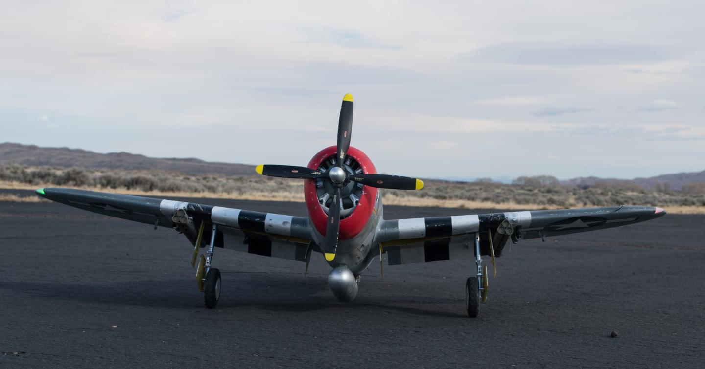

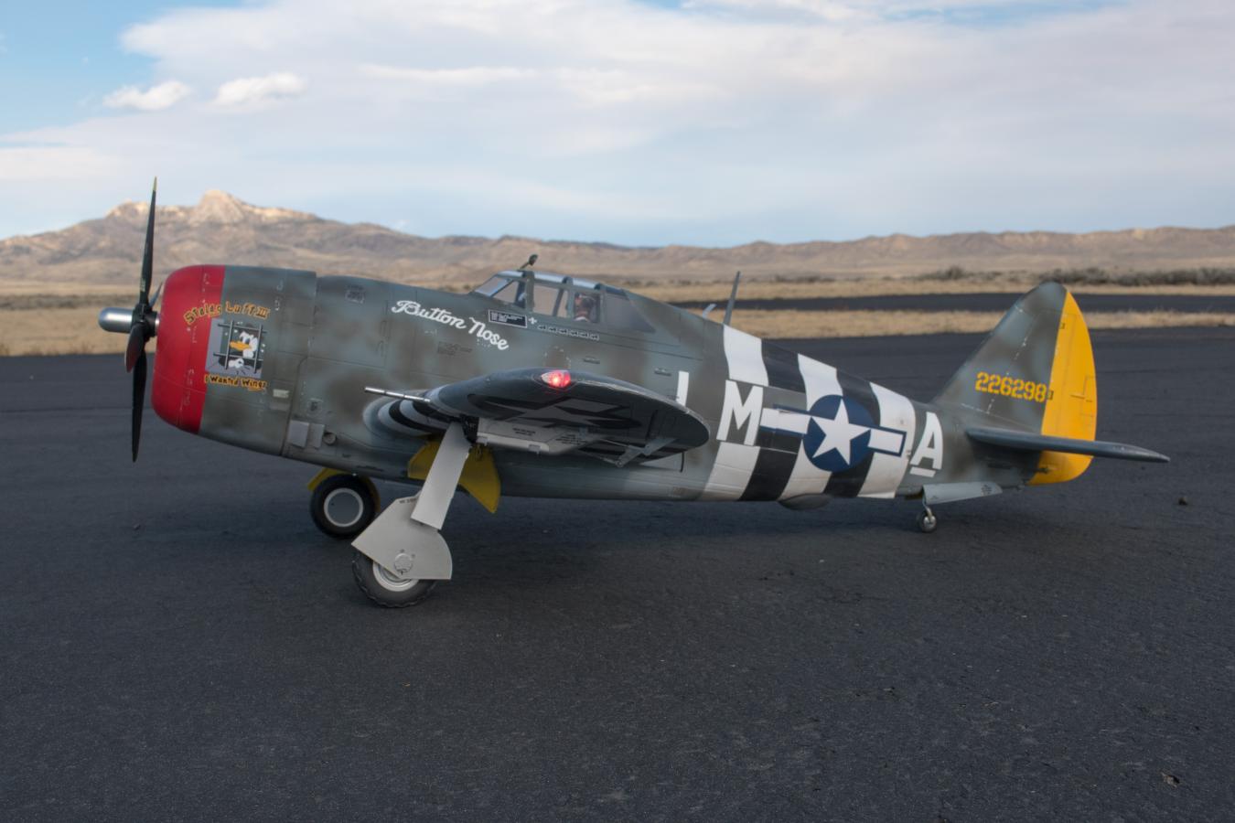

      Finally got my decals/markings through the mail from Callie (the USPS is a mess right now!) and went to the field to take some pics of the plane, more or less completed now. It was a fun exercise in researching an actual aircraft that flew in WWII and adding a lot of detail items to this model, just for the challenge. The plane has 3 flights on it now, and I look forward to many happy hours flying it in the future. Click image for larger version  Name:	_CAM0508adjsuted.jpg Views:	0 Size:	99.3 KB ID:	286572

        Excellent work, looks fantastic!

          Thanks, it was a fun and challenging project.

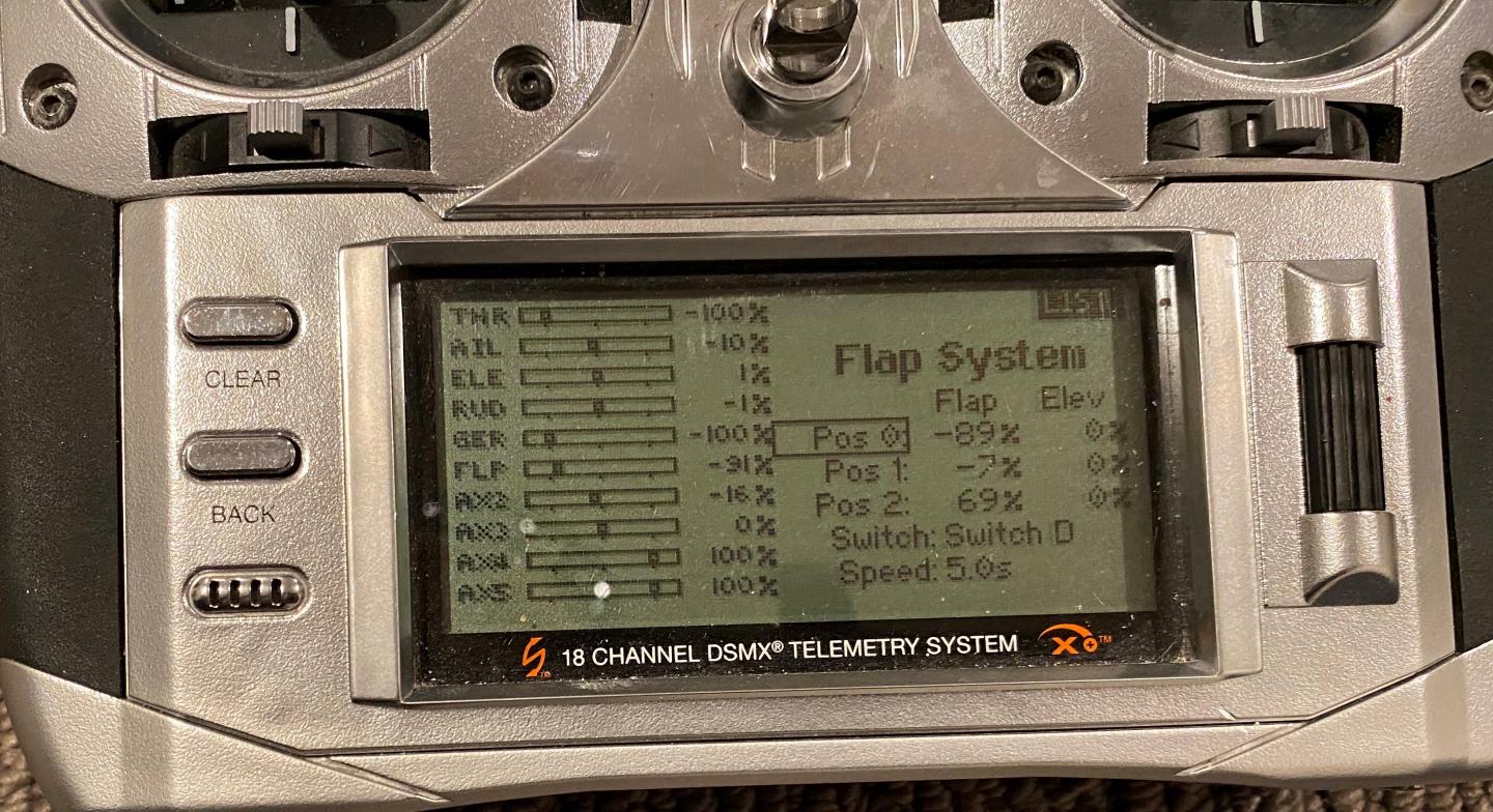

                        Hi ICM: I took a pic of the settings for my flaps. I hope this might be useful. I have used these for about 20 flights on my FMS P-47D razorback. I fly at 5,000 feet MSL, which might need slight adjustment at your field elevation, I don't know. My full flap setting is approximately 33 degrees deflection, and I have an intermediate flap setting of about 15 degrees down deflection from retracted position, as measured from my protractor. I don't use any elevator down mix, although if I go right to full down flaps from fully retracted at a fairly high speed (which I try to avoid), I do get a momentary minor pitch down, which is easily controlled.

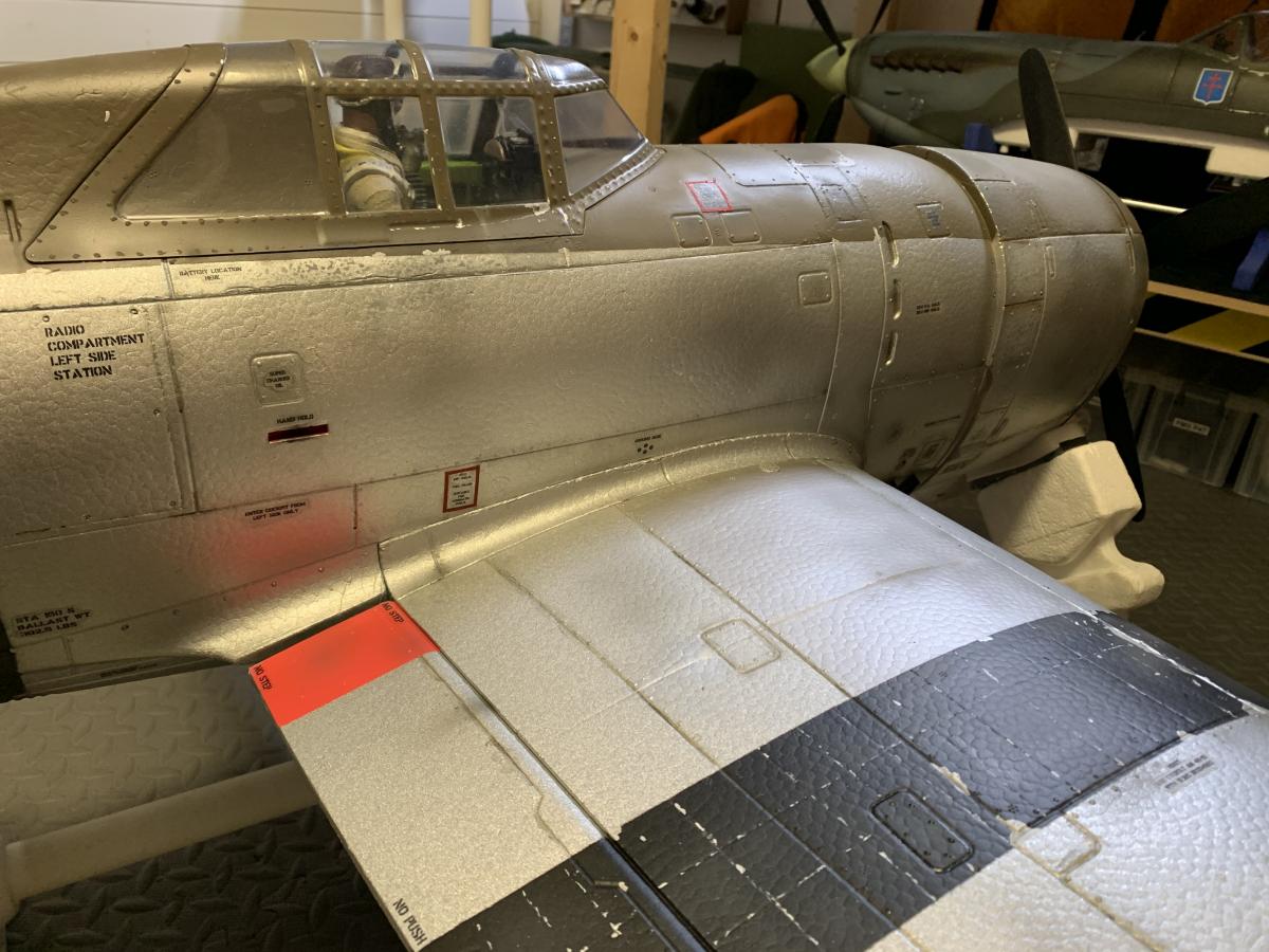

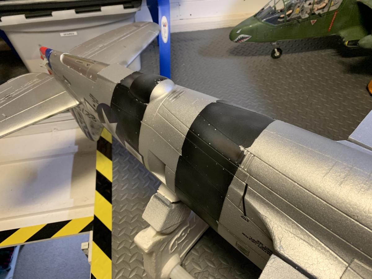

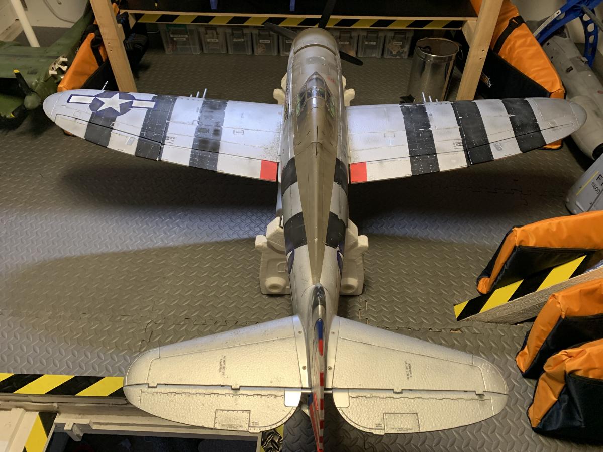

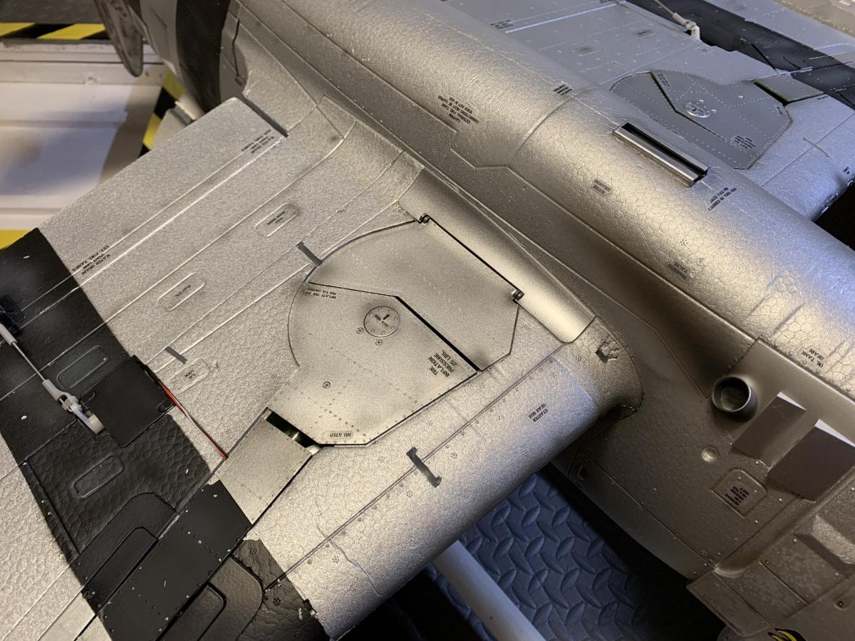

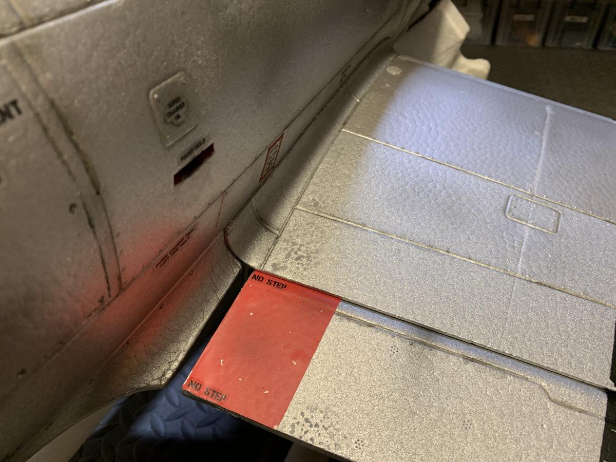

                          Second Jug is ready for this season. Daylight photos and a walkaround video should follow soon.

ID:	297824 Tried to upload photos but for some reason they are not in the above post so I try again.

                                    Thanks for uploading the pics. Looks like a nice plane, and I enjoy flying my I Wanted Wings/Button Nose whenever the Wyoming winds and winter will allow!
