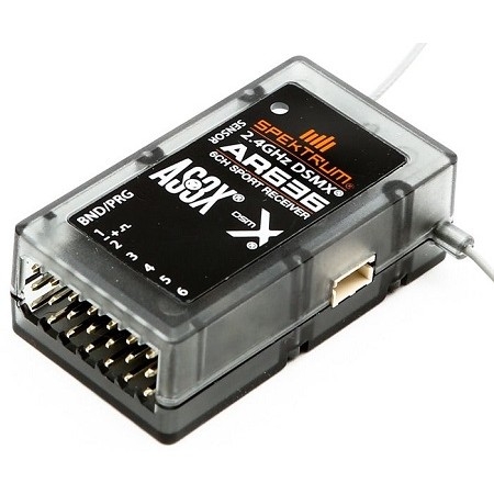

        Hi everyone. I'm new to the FMS line of planes, and just got my P47 form Motion today. Nice plane, and went together nicely.
        I'm having an issues getting my Spektrum DX6 and AS3X to work in this plane. Flaps not working and channels are now swapping inputs. Is there a setup procedure I could follow for this? I did a search on this here, but that yielded me nothing...
        Thanks for any help!

          #364
          Also, does anybody know how your servo wires and throttle wires were labeled? Mine is different than my other planes I have. They have Ch1 as Ailerons, Ch2 as Elevator, Ch3 as Throttle, Ch4 as Rudder, Ch5 as Gear and Ch 6 as Flaps.
            Mine are labeled the same but the Channels being identified is basically inconsequential anymore.
            A channel on a Spektrum may or may not be the same as on a Futaba or any other brand.
            Plus with these programmable Tx you can move channel/ports around whereas you could plug an aileron into for example what is typically a flap position which usually was port/channel 6
            Just plug the labeled control surface connector(ie aileron throttle etc) into its corresponding labeled port on the receiver and forget that old school channeling. ;)

              Welcome to Hobby Squawk WB!
              Can you post a pic of your receiver?

                So talked to Michael this morning at Motion. He and I seem to think the circuit board in the plane is messed up. So he's sending me one out this morning, and I paid to have it over nighted. Should be here tomorrow hopefully.
                Here's a pic of the Rx...

                    #369
                    You and me both! The ESC also went south in this bird today as well. This thing must have been built on a Friday! I tell ya, if it wasn't for bad luck..
                    Is there anywhere I can find a good setup for this thing using my Spektrum? Since the manual only mentions measurements of throws and not percentages.
