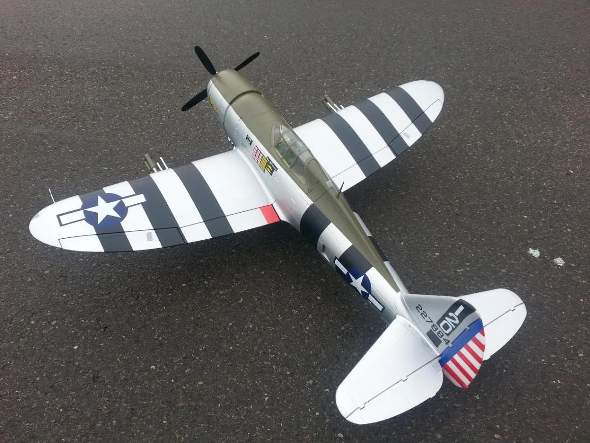

                    That's a good question...Anyone know what the stock motor is rated for amperage-wise? Mine's all ready for (the rain to clear) maiden but that stock prop just don't look right, lol...

                      I am guessing around 70 ish Amps? Just by the size of the ESC. People have run the 650kv motors from the P-40 up to 100A or so, but I wouldn't go any higher than that. If you really want 6S power and a better scaled prop, get the 360kv 5060 motor from the FMS Pitts and a 100A ESC with the 1700mm P-47 prop. The Skyraider prop might also fit on the larger motor, but would need to be drilled out. Or you could swap shafts with the stock motor. This has been the optimal power combo for the 1700mm series, so it should provide more than enough performance for this model. However, the motor is too long to fit in the stock cowl as TI noted earlier in the thread. However, it would only take minor trimming around the cowl opening to allow the larger motor to fit. Otherwise, the Skyraider prop on 6S on the stock system will pull over 100A on the stock system according to ecalc. It might be fine if you aren't pushing full throttle the whole flight, but it would be risky.

                        As I indicated back on post #101 it is 70A.
                        https://www.hobbysquawk.com/forum/rc...7807#post57807
                        That number came directly off the FMS PDF data spread sheet for all their motors they provide.
