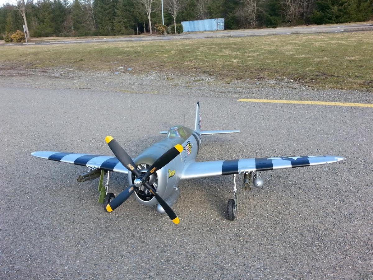

                      I maidened her today. The maiden was completely bone stock (6S 5000 on stock prop). Flies very lightweight. I think the CG was a touch too tail heavy...Once I trimmed her out she flew great. Stock power is definitely not going to win races but works great for scale flying. Looks really good in the air. Nimble and gentle. With flaps she lands easily. No pucker factor.
                      We then went back to my buddy's place to get the HSD A-1 prop on her. After some finagling (his reamer wasn't quite large enough) with the dremel and a couple attempts with heat shrink and having to add a washer, the prop was finally seated right and ready to turn some RPMs. We threw his 5S 3000 40C LiPo in her and ran her up static on a wattmeter. 75 amps @ 1200 watts. So pushing the motor but thinking since it's static, the amps will relax once unloaded in flight. Took her back to the school, started the takeoff roll and she really cranked over left from the torque and although I thought I was giving enough right rudder she was headed for the curb and school...I pulled up at WOT and she just barely missed the curb, I was able to negotiate her around trees and the school and got her out of there and flying but you could definitely hear the motor was barking.
                      I pulled back the power to around 55-65% where she felt very sluggish. I kept her in a couple pattern flights and brought her down. I was surprised by the lack of thrust and power. There's no way I could see how a 4S would even have the authority to get her off the ground. If the 5S struggled, how could a 4S possibly work? Granted it was an older battery but still...Definitely going back to stock for now until I figure out the perfect motor replacement.

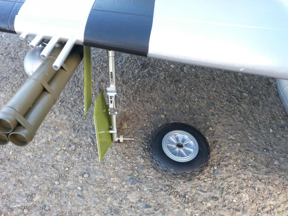

                      Just for shiz and giggles I lost a C-clip on my starboard gear where it collapsed on the taxi back to my car. Thankfully it happened on a slow taxi. Now I need to find a C-clip the right size for it. Also noticed I have tiny screws missing that secure the retract fairings to the struts.
                      The good news is she flies fine stock. I will just have to live without a more proper-scale-sized prop on her for now. Wing-loading feels light with this one.

                        Wow Aros. Sorry to hear about 5s seeming not to be right as well as lossing the c clip. The Dang wind and rain kept me on the ground and the forecast says it's going to be worse tomorrow. How was the speed vertical on stock though. I'm hopeful it is at least better than the mustang stock.
                        Dewey l
                          • 8203
                          #212
                          Speed vertical was marginal. Feels like your typical FMS stock warbird speed to me. That's not necessarily a bad thing as I really enjoy scale flying but if you want this girl to really zip a power upgrade will be necessary on some level.
                          Here's the numbers today from the wattmeter test for both 4S and 5S using the HSD A-1 prop...
                          4S 3000mAh 35C - 49 Apk, 629 Wmax
                          5S 3000mAh 40C - 75 Apk, 1267 Wmax

                            A drop of med super glue on the C clip will do the trick..I learned this after 32 years of RC car racing...As far as lacking power IDK..I am fairly new to planes.:)

                              Aros, that sounds very familiar. I maidened mine this morning with the stock motor, 4S and the 1700mm prop and had almost identical numbers to your 5S setup, with the same results. Very lackluster speed and climb, a bit tail heavy, and I busted the prop on landing. The constant rains here have turned our geotex runway into a minefield of potholes. I am going to try putting in the 360kv setup and 6S, my motor made some no-so-pleasant noises during my flight, and I am not going to risk further flight with it. On top on that, my belly tank became stuck on the model, and I ended up ripping a good sized chunk of foam out of the bottom of the fuselage when I was trying to get it off. And that was despite trying to hold the rail from moving with a pliers.. Not the greatest day of flying. I guess I'll try again next week after I order a few more blades.

                                          Bummer F106DeltaDart...We've all had those days we wish the flying would have turned out better. At least we didn't come home with her in pieces. I would advise those about to maiden with any upgrade prop to not bother if you are running the stock motor. The only way a larger prop will work is with a more robust motor, period. The good news is you don't notice the stock prop size when she's flyin'. ;)
