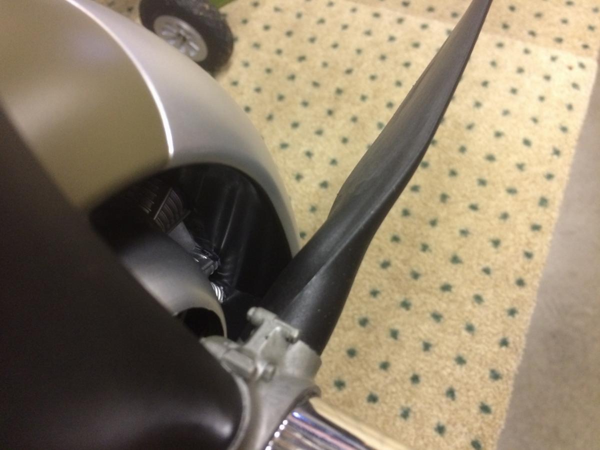

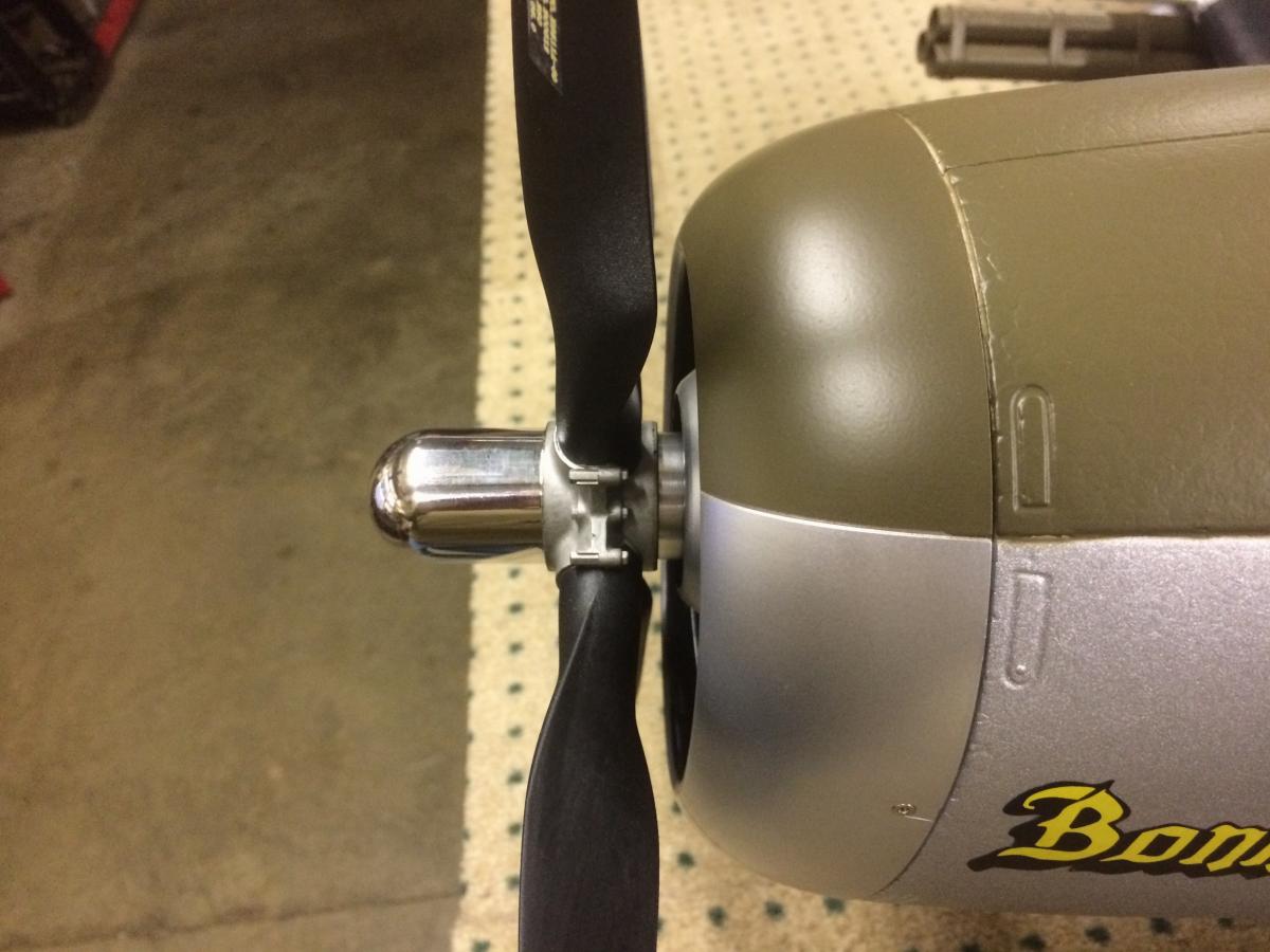

      See what I mean about this not looking like a six pitch but rather maybe an eight?

        #143
        Yeah, definitely looks higher pitched than 6.

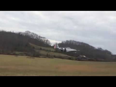

            Not the best shots but here's the fly-bys..
              #146
              SWEEEEEEEET..........4S and the 16" Raider prop IS A WINNER. THANX TI
                #147
                Very nice. Has a unique sound to it. Thanks for the vid.
