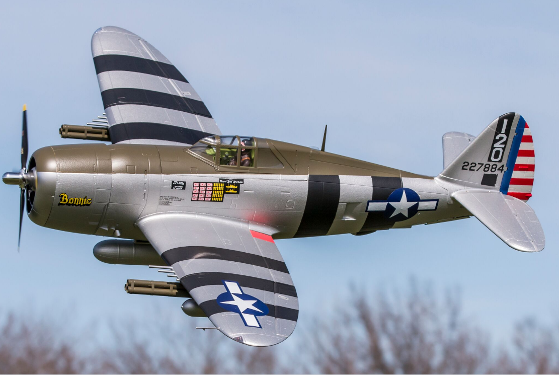

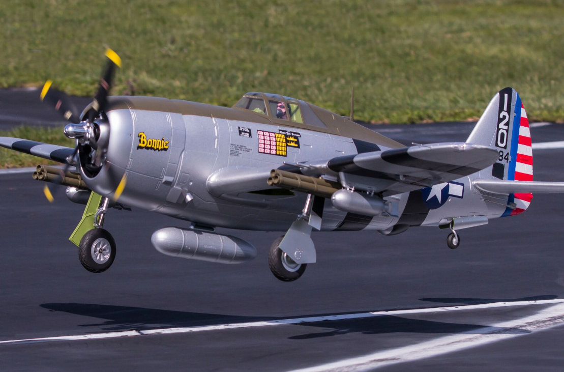

                            Great day for a photoshoot!

                              Yeah my weather took a turn back to chilly today so I did not get back out. Nice pictures as always. Waiting for that 4k 60fps footage ;)
                              AMA 1102566
